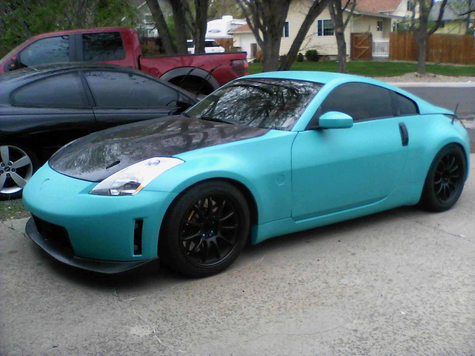

I had my old car dipped teal, it held up for a long time in CO climate. I sprayed it using a LPHV gun and compressor and it turned out really well.

I have a buddy that plasti dips his entire car a different color about once a year. It holds up pretty good but if you ride trails with brush rubbing it and such it wouldn’t hold up to that, or a drive through carwash. The good thing is you can peel back a corner and basically pull it all off an entire panel in about 2 minutes, so if you don’t like it, it’s easy to pull off and redo. That said I’ve never put it on over a poor surface, I’ve only put it over a real good clear coat, so if your clear is broke down and you have bare base coat I’m not sure how that would change things as compared to what we’ve done.
Also, what I’m referring too is the plasti dip you buy in gallons and use a spray gun....we used the sprayer that plasti dip sells. That kind of setup is MUCH better than a rattle can from Home Depot.
Both of these cars we did in 2 coats of Plastidip....
