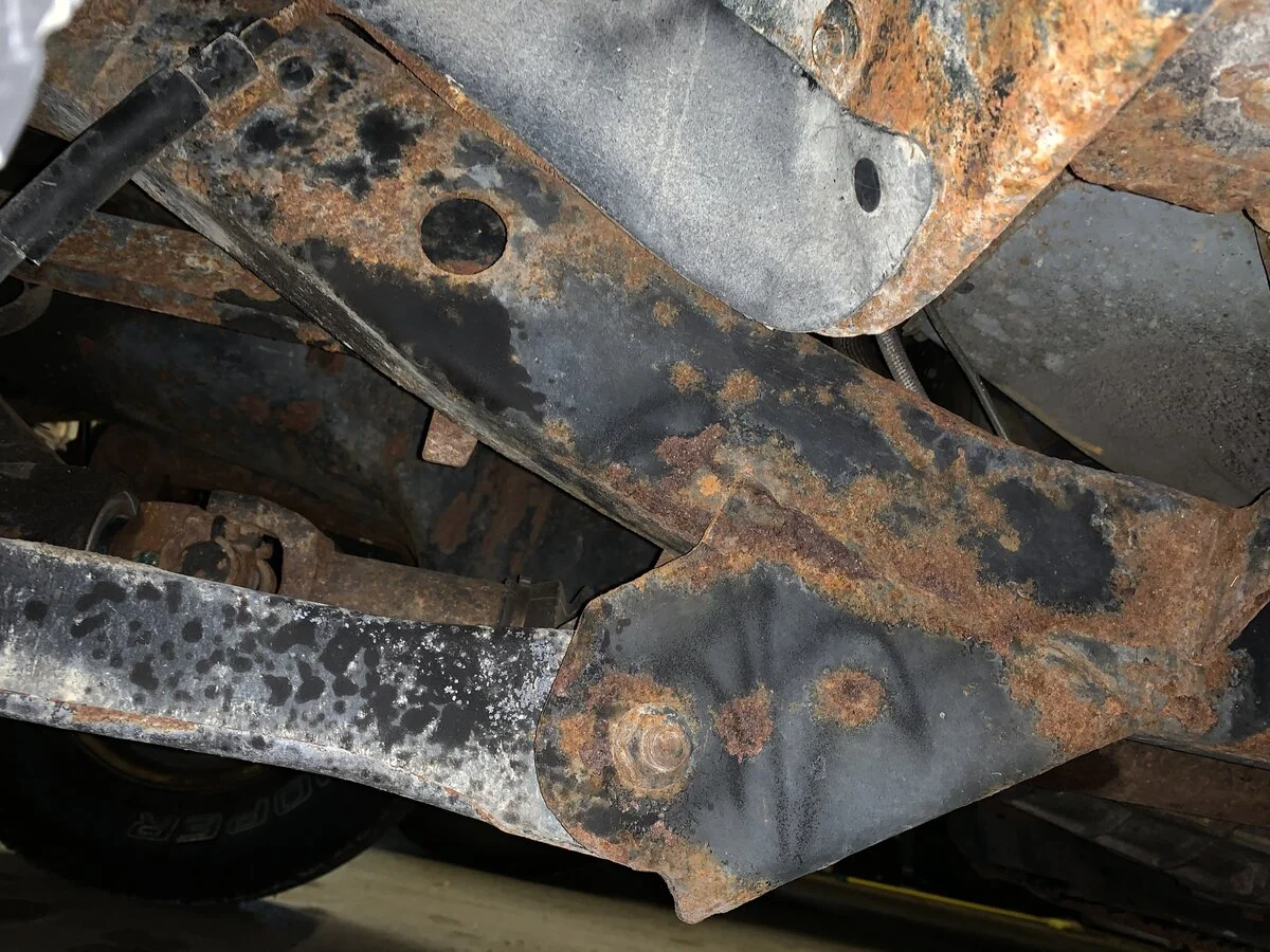

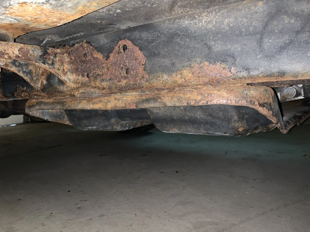

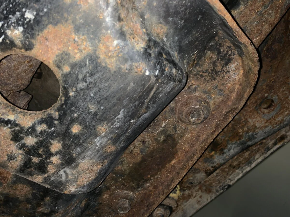

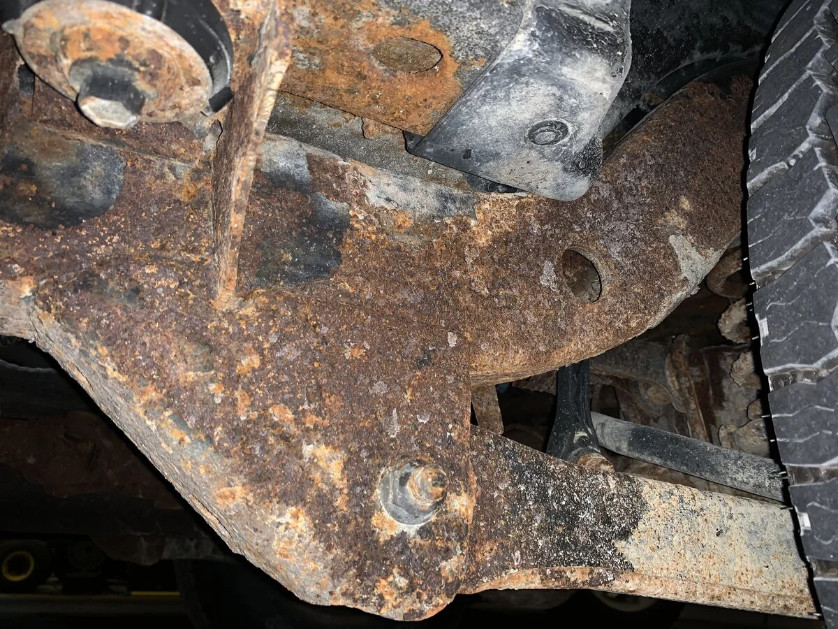

Let me know if this tells you anything. Starting with front passenger and going clockwise around vehicle:

Look, would I have bought that Jeep? No. But you have it now, so here we are. Send more pics of the skid plate when you can. Assuming it's not about to pull out, you'll probably get a few years out of the frame—that's if you drill drain holes and flush all the crap out inside. I would douse the inside with fluid film and hope that it slows the rust. These frames rust from the inside out, so it almost certainly looks worse on the inside. Then I'd POR-15 the outside and keep your fingers crossed.
Yes, Safe T Caps could fix that frame, but you're looking at minimum $2k to install them, depending on where you go. How is the rest of the tub? Those torque boxes don't look great. You don't want to invest in caps if the rest of the Jeep is falling apart.

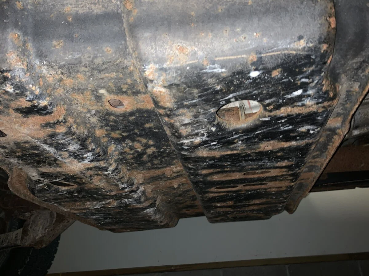

Definitely wouldn’t sell it to someone who didn’t know if the frame were deemed unsafe by a mechanic. Thanks for the feedback, everyone. See pics of skid plate - I tried pulling on it, pounding it, stabbing rusty areas with a driver - nothing happened. I don’t know the best screwdriver method but I stabbed the crap out of the rustiest areas on the frame and it didn’t really make a dent. Felt and sounded like I was hitting a steel beam with a screwdriver. I don’t mind making a project out of stuff like suspension, axles, etc, but I’d rather not do any frame-off work myself.

The area where the frame meets the skid plate is a problem area for rust. Remove the skid plate, being careful to support the transfer case or transmission with a jack. Then put a screwdriver on the bottom of the frame where the skid would go and hit the screwdriver with a hammer. If that causes no issues, you should be ok for a while. Though, it is just a matter of time.
If you stick a finger in one of the holes of the frame, what do you feel resting inside?

I'm going to play devil's advocate here and say not to remove the skid plate. I think we should assume much of the frame is rotted away underneath having seen those pictures. Removing the bolts might break free the nutserts. At this point I think you want to milk as much as you can out of this frame before determining whether to do a safe t cap job.

If you are not able to remove the skid plate, the Jeep is not safe to drive. Either you decide to not remove the skid plate and immediately patch the frame or you remove the skid plate to check for rot. You can't drive a rusty TJ frame around the road blind to how rusty it is. Better to know your frame is falling apart than to have it happen on the highway.
