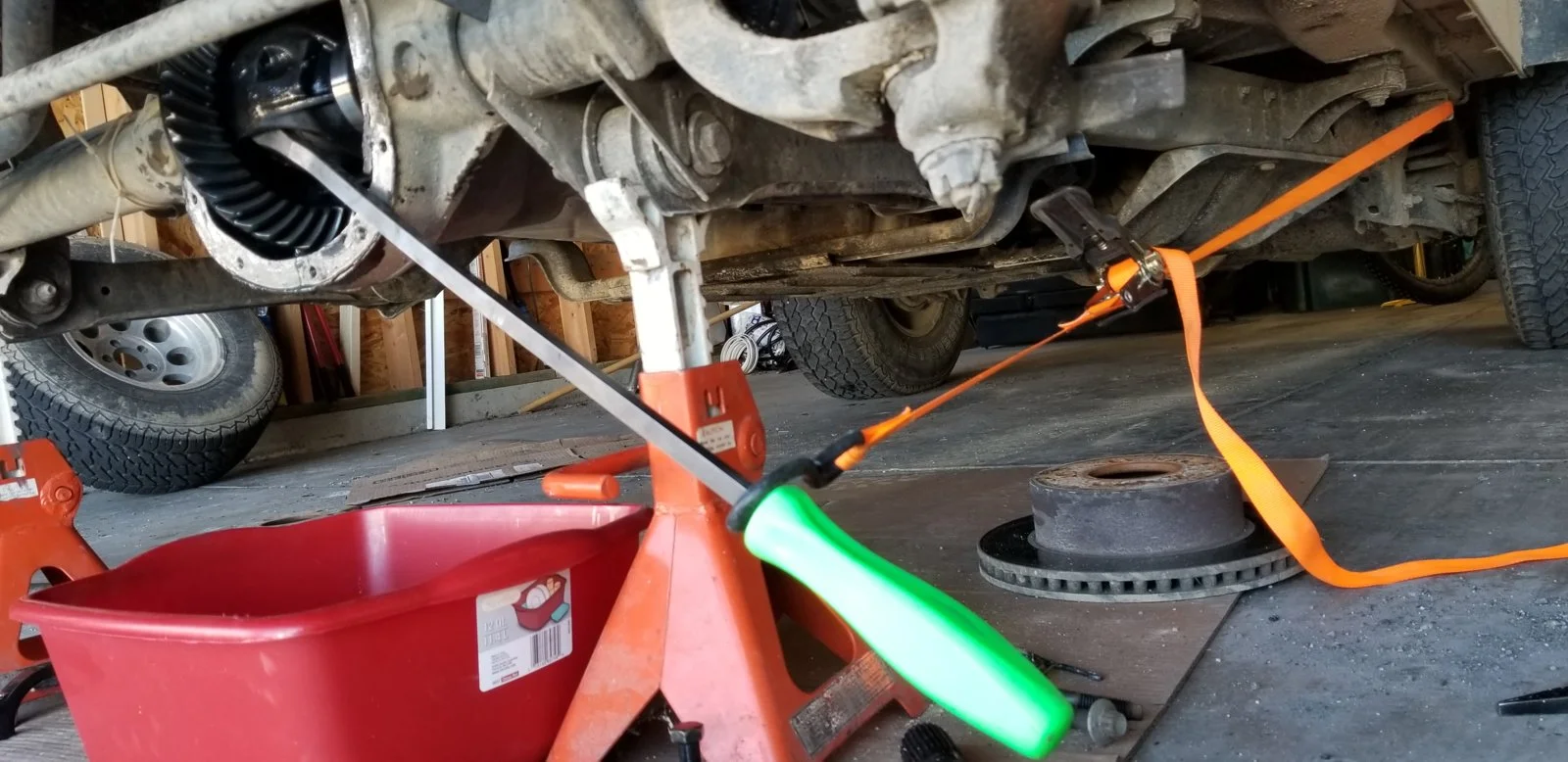

Another solution I have used more than once. Pry bar with a ratchet strap to the rear frame on a really stubborn carrier so you can maintain tension hands free, then tap outside of the housing with a dead blow hammer and it pops right out.
