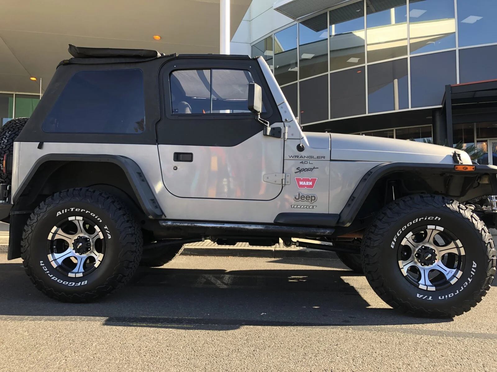

Hey All!
  1. How often do I need to take my TJ for a run?
  2. And for how long do I need to drive it?
  3. what maintenance procedures should I put in place?
For the most part the TJ now lives in it's natural habitat, in the garage with the hood up connected to the battery charger as we now have a new vehicle (Elantra GT USA/i30 N-Line AU)
I'll be doing a few things to the ole girl like a reconditioned NV3550 that's ready to go in and a few cosmetic fixeruppers over the next few months to get it ready for our next adventure into the bush and I'm not sure how long I can leave it standing still and what maintenance procedures should I put in place when it's not getting much use.
At this point my maintenance procedures list is...
  • Drive once a week for 30 min - would prefer to leave it longer then this but not sure if it's OK to do so?
  • Change oil at 10,000 or 1 year.
  • Drain and clean windscreen washer system.
  • Slow charge battery every two or three days.
I don't wan't it to depreciate from sitting still for too long so let's know if I need to add to my list?
Thanks in advance :)
