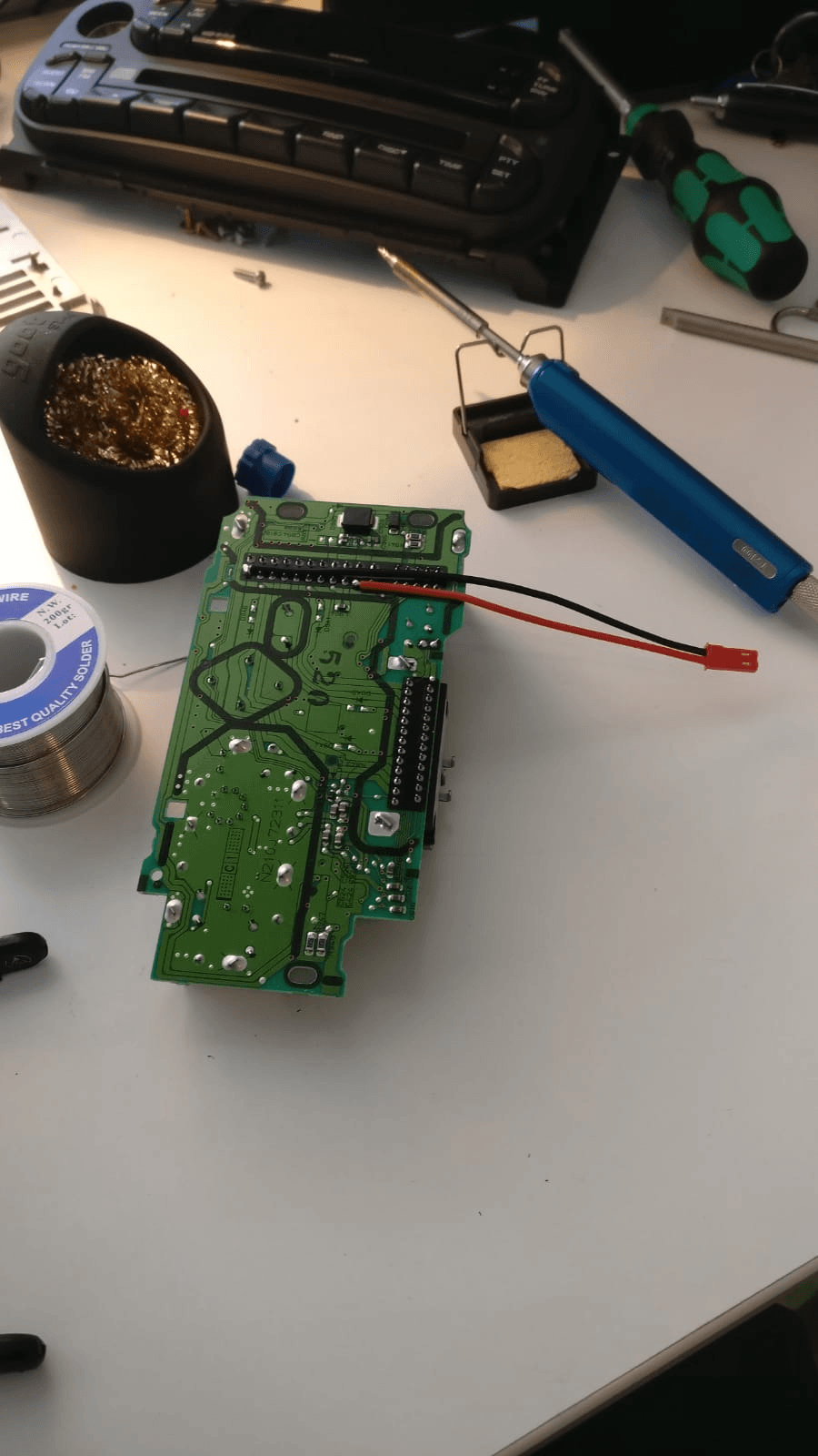

This is the back of the left board and where you will be soldering the + and - of the module:
83351
Just copy where I soldered these cables. You can also figure this out by looking at the wiring diagram sticker on the top radio panel.
The - is on the 1st pin on the second row.
The + is on the 10th pin on the second row.
Now that you soldered this you have a power source that switches with the ignition switch.

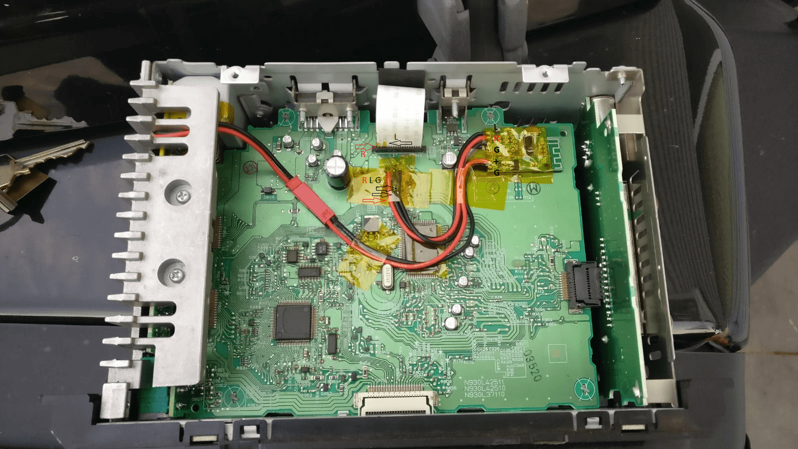

Next is to solder the L, R and another ground.
What we basically do here is mask the L and R signal from the CD changer with tape (thin Kepton tape in recommended).
Gently pull out the Flex cable from it's place.
Stick a thin strip on the 1st trace from the left. This will mask the R signal.
Stick another thin strip on the 3rd trace from the left. This will mask the L signal.
Push the flex cable back into place, make sure the masking is inline with the contacts of the connector.
Now we will hijack this line and stream our own music by soldering the R and L cable from the module to already exposed pads on the PCB.
Simply follow the 1st and 3rd traces from the flex cable connector on the board and you will find those pads. you can use a multi-meter to confirm.
The last soldering will be the second Ground.
I did not document unfortunately which pad it was exactly, but you can easily find it with a multi meter by touching the previously soldered Ground with one probe and a bunch of those pads with the other until it beeps.
83355
To hold the module in place I used 3M double sided glue, and a bunch of Kepton tape to secure the cables in place to not put strain on the delicate soldering.
From a couple of tests I did, mounting the module inside the radio had no affect on the quality of the link at all.
Well, you are pretty much done. Before putting everything back, test to make sure everything is wired correctly.

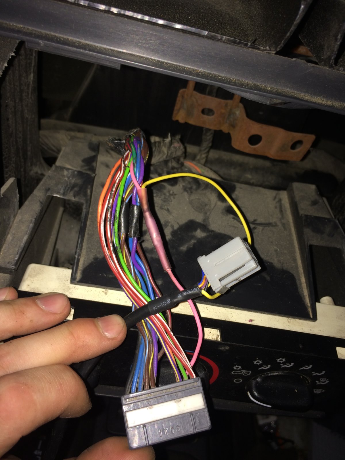

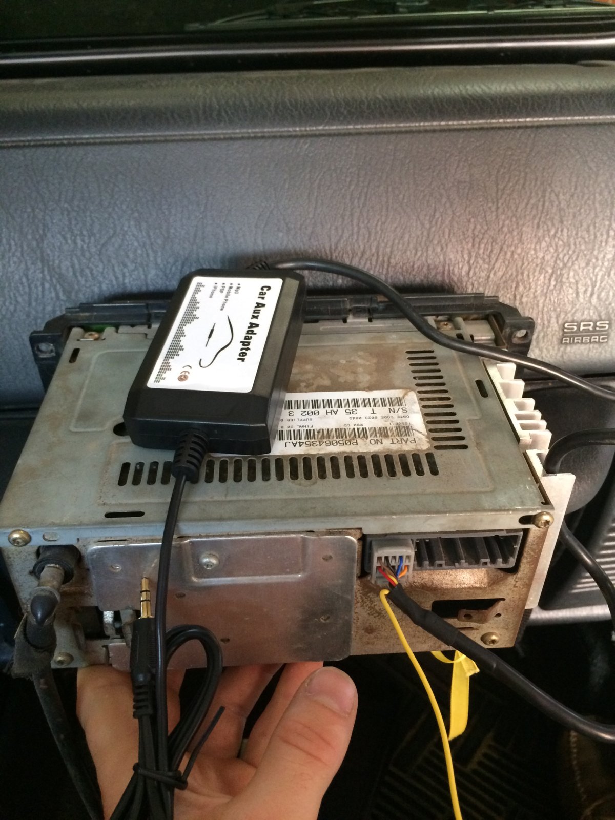

So i added an Aux line to the CD changer port in my stock RBK radio but i would really prefer the Bluetooth!
I wonder if i can wire this Bluetooth module into this aux mod rather than the radio itself.
The way its set up right now I can still play CD's, use FM/AM radio, and switch over to the AUX. I would like to keep the option of CD's just in case.
89229
89230
Schwifty, not sure how your wiring is and if there is a more efficient way of doing it, but you can easily use the aux cable to connect to a bluetooth module.
Either buy a different module that come with aux input, or solder one to the module I linked.
It's pretty simple.
