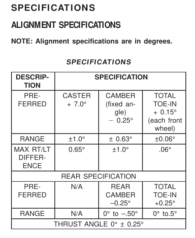

A nice thing about this is you could mark at lengths that are really easy to measure. Meaning that 0.15" is much harder to measure than 3/16" (at least on my measuring tapes) - assuming you want to be precise, so mark your bars at that distance for when you measure. The manual for the 06 says 0.25 degress +/- .05 - so maybe it doesn't really matter.
Reactions: TJim and JMT
0.25 degrees for front?
I guess 0.30 total +/- 0.12 (total)?

You definitely could do that. But since we want degrees over a distance. A little algebra and you can get round numbers from the formula, mark the center and the distance (radius from the middle). You're in the money for any tire size.
If everything in that column is Total, then yes, +/- 0.12, so 0.18-0.42 would be acceptable. That brings 1/16" back into spec since the angle would be about 0.246* for a 29" tire.
