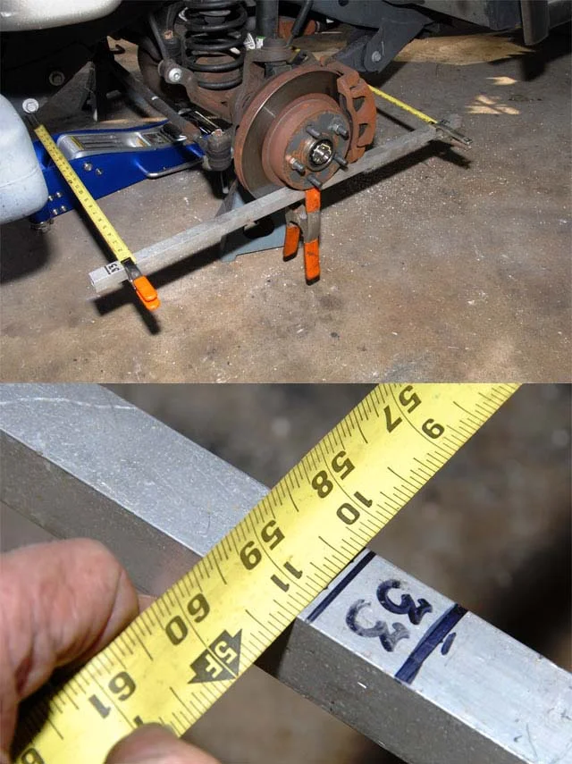

For an easier and more repeatable way of measuring your toe-in than measuring between the tires, use a pair of 1" square aluminum tubes as in the below photos and use them to measure between. Center and hold the square tubes to the rotors with spring steel clamps after marking them at points equal to the diameter of your tires.
Using just a little care, your toe-in setting will be just as accurate as an alignment specialist can produce using an alignment rack. Plus you can be done in 5-15 minutes from start to finish, quicker than you can even drive to the alignment shop. Not to mention you can do this on your own for free vs. the $70-90 an alignment shop charges for something that is far easier to do than most people would ever guess.

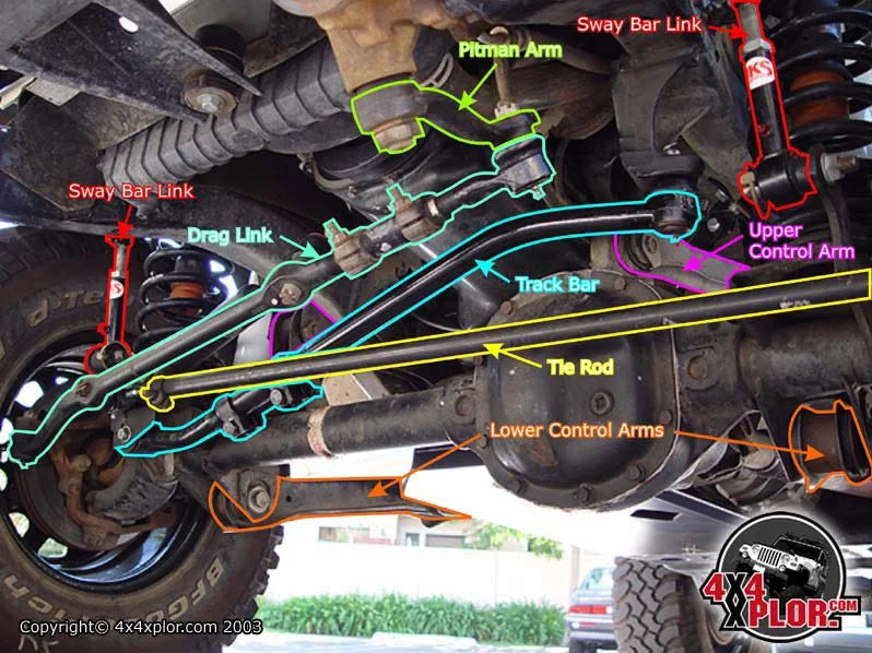

This is all that an alignment shop can do to your TJ, this is the sum extent of an alignment where a TJ is concerned. Neither your caster angle nor your camber angle is adjustable without aftermarket parts so without those, only your toe-in is adjustable. There is no real need to waste your money by paying an alignment shop for an alignment since all they're going to do is set your toe-in and center your steering wheel. Both of which are too easy to do for anyone here to pay for.
Re-centering the steering wheel is required whenever the toe-in is adjusted or when the suspension height changes. That is easily done by rotating the short adjustment link on the drag link after loosening its two clamps.

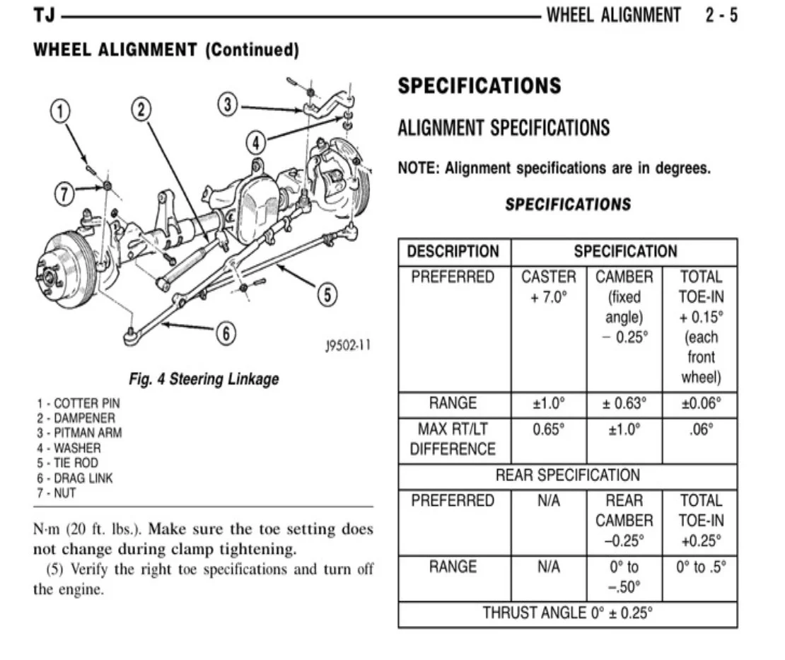

According to this page, toe-in is 0.15° each front wheel. So to find the correct distance for any tire diameter use the sine of 0.15°. For example, a 33 inch tire would be:
sine(0.15) * 33.0 * 2.0
0.002618 * 33.0 * 2.0
0.1728"
or just under 3/16"
