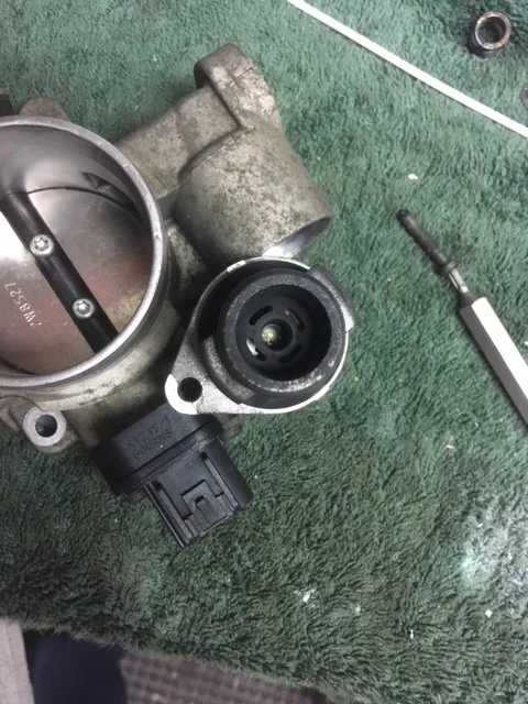

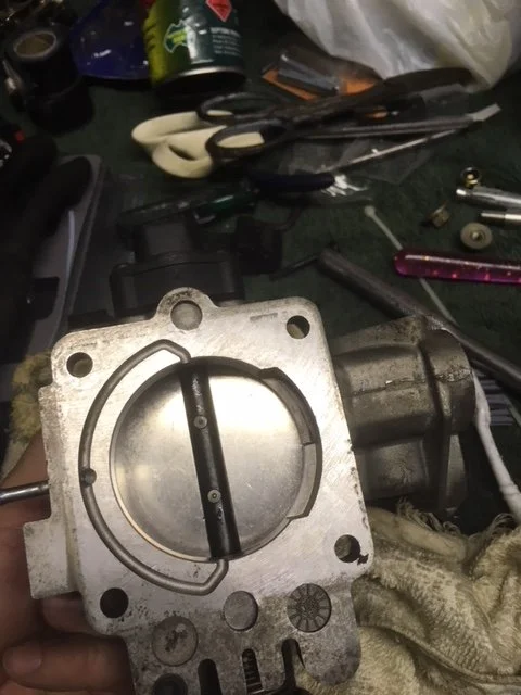

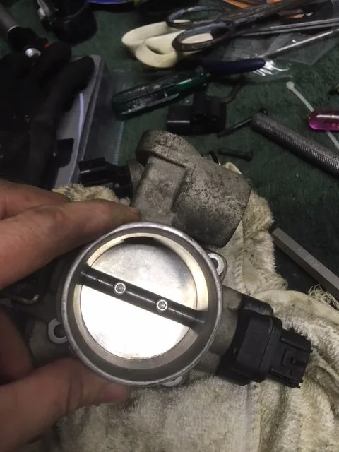

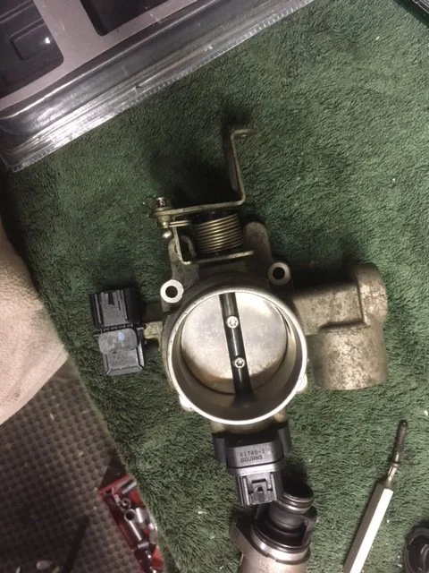

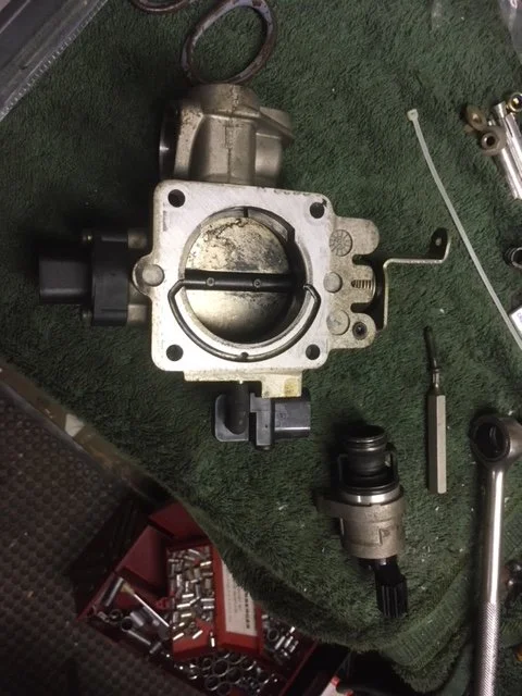

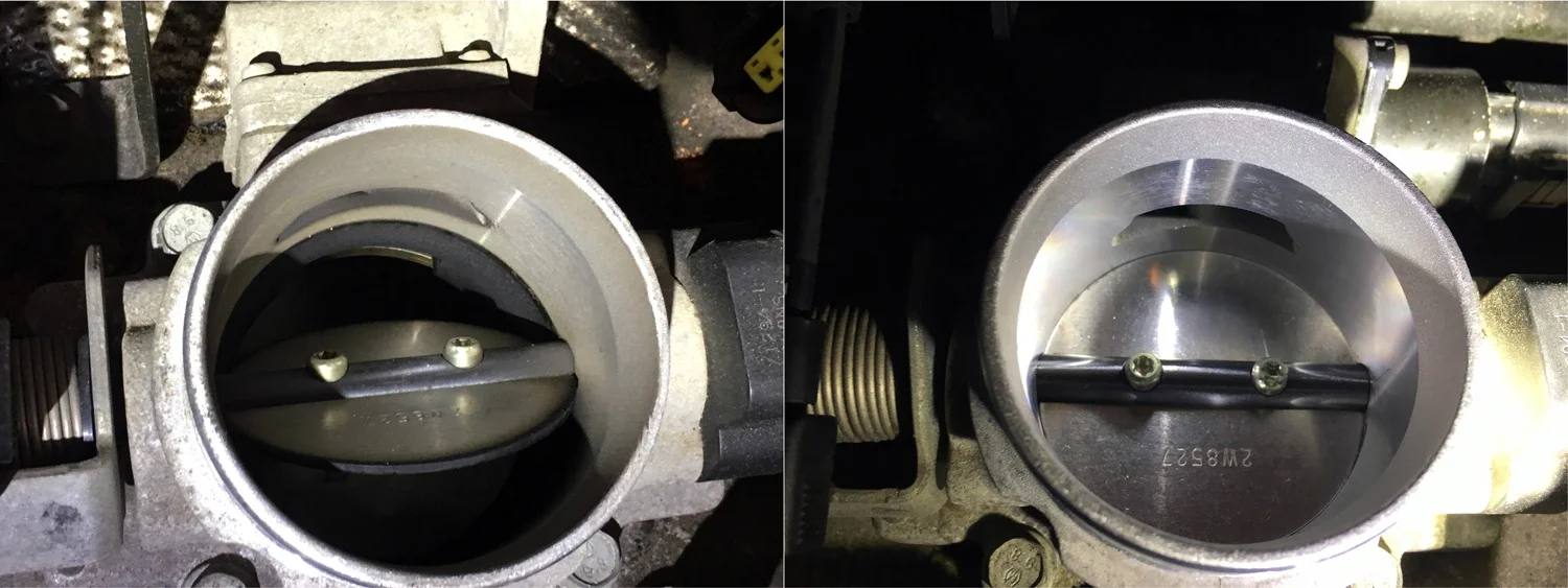

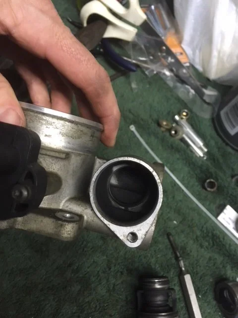

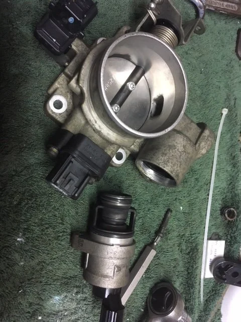

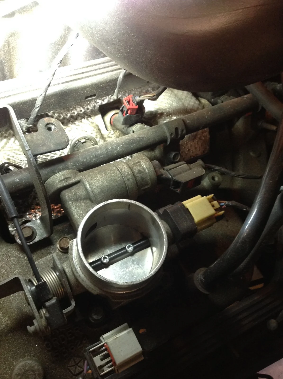

Just wanted to say thanks for this thread and the very knowledgeable folks on this forum. I completed the IAC and throttle body cleaning today with great success. IAC was removed for cleaning, but not the throttle body. A couple before & after pics:

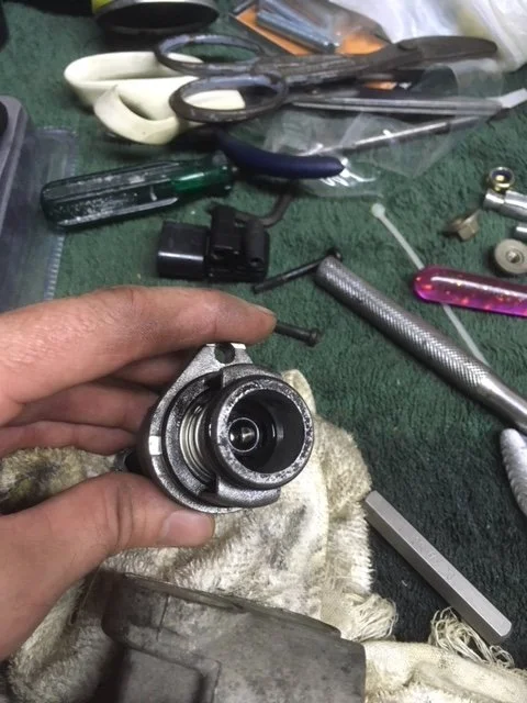

Thank you everyone for such a great forum!! I did the IAC today, but the top nipple came off to expose a screw and spring, with some lithium grease in there. I don't think I was suppose to disassemble it, but it went back together......I guess. Took off and cleaned throttle body, that went well. Ordered a new IAC, considering the original equipment on the entire vehicle is 19 years old, so it won't hurt to pop in a new $20 part, plus I may have messed it up. Also ordered a new a new MAP sensor and TPS and Coil Pack for good measure. Got them from 1A Auto, links embedded. Reviews looked decent and the prices were the best I could find. Anyone use this online parts store before??? Figure I will pop on the new coil pack when I do plugs Tuesday evening, got Plugs Jerry B. recommended.

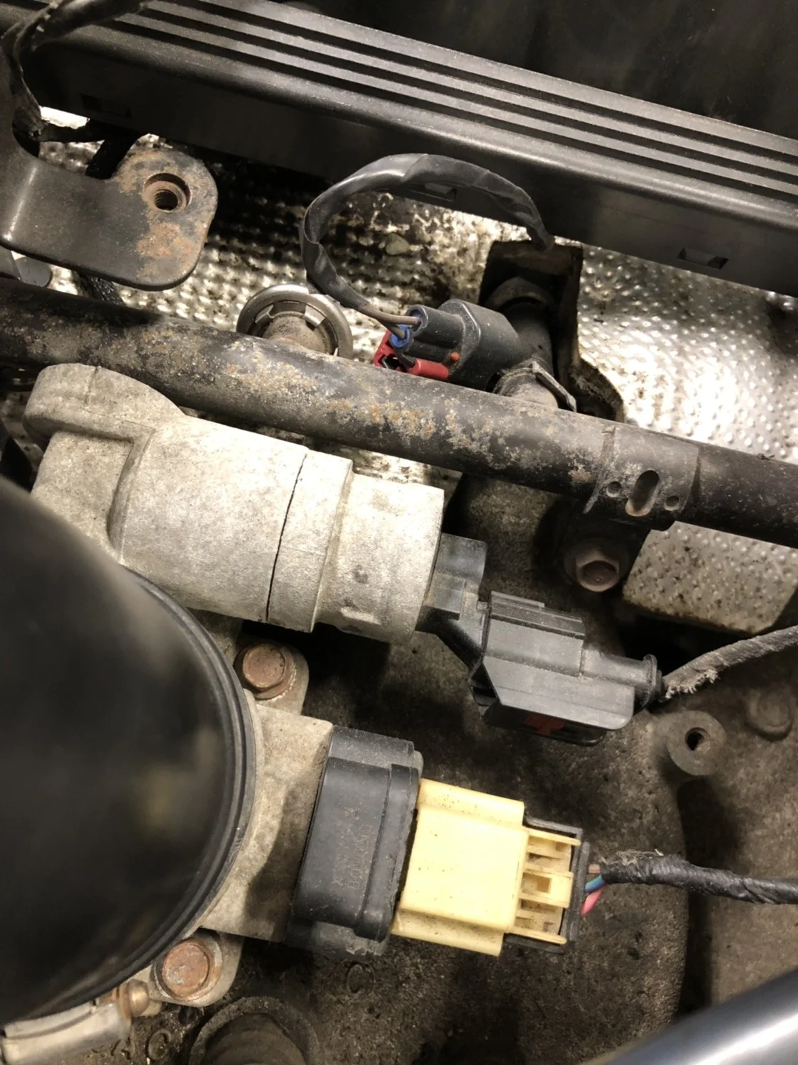

If you're experiencing idle issues on your Jeep Wrangler TJ the most likely culprit (and the first thing you should check) is your IAC (Idle Air Controller). Often times the IAC gets very gunked up causing the Jeep to idle improperly. A simple cleaning is usually all it takes to get it running as good as new.

Below you'll see a diagram of the top of your throttle body with the IAC sensor labeled.

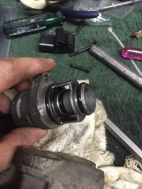

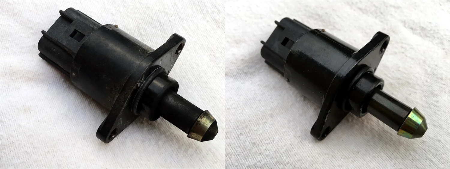

Take your IAC off (it's held on by two small torx screws). Clean it with your throttle body cleaner, this is what it will look like before and after.

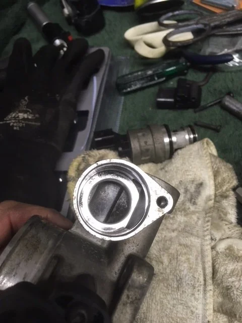

Then take off the IAC housing and both sides (house and throttle body). clean that too. before and after...
Put it all back together and you're good to go. Very, very simple. It doesn't get any easier than this!

260k on my 03 Sahara and the idle had gotten low and rough over the last couple of months. Pulled the throttle body and disassembled the IAC. Cleaned everything up and it's idling like new. Thanks!
Pulling the throttle body is about a 3 minute job and makes disassembly and cleaning much easier. And no screws dropped into oblivion.
