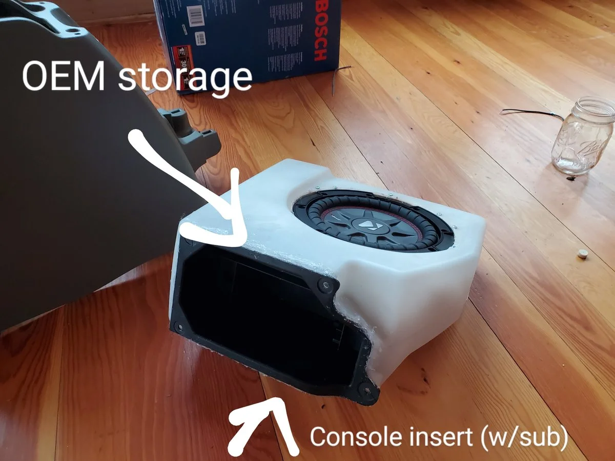

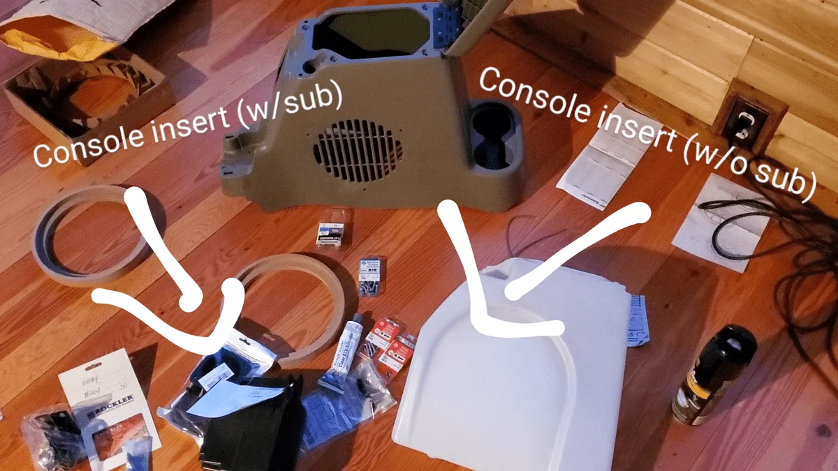

My Jeep did not come with the center console subwoofer; it came instead with the polyurethane storage container. I considered making an MDF enclosure to fit inside the center console but the storage container seemed too perfect in size/shape. The material is also pretty thick plastic that could make a fine speaker enclosure. I thought it could work if I could mount a recessed subwoofer bracket, some terminals, and seal the enclosure while maintaining storage. Sealing the container while maintaining storage was solved by combining the storage container with the insert from a TJ console which came with a factory subwoofer.
I started by drilling out the rivets and removing the white plastic center storage container from the storage center console. I purchased the top insert from a TJ subwoofer center console off Ebay. I did this to still have some storage after the job is done and to seal the OEM storage compartment. Combining the storage container and the subwoofer console insert made a perfect subwoofer enclosure.

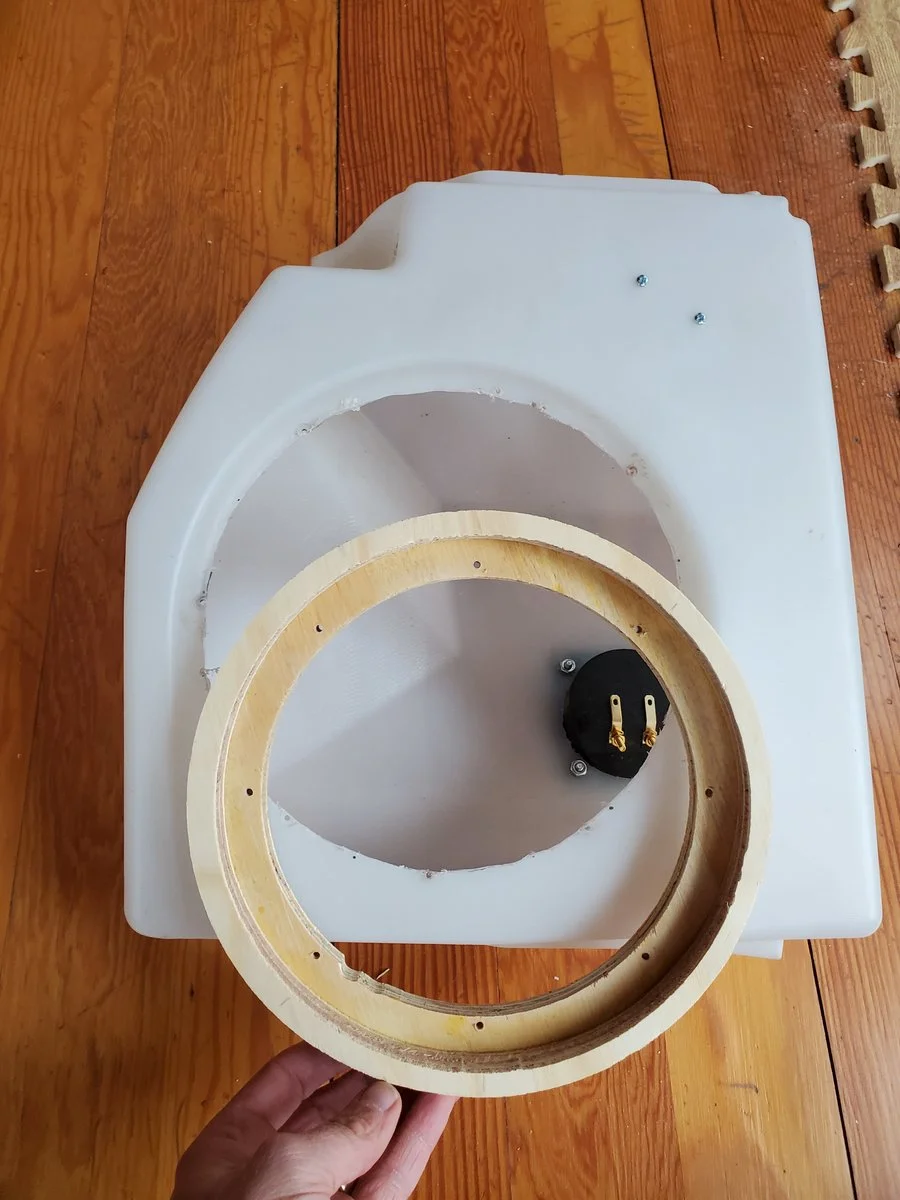

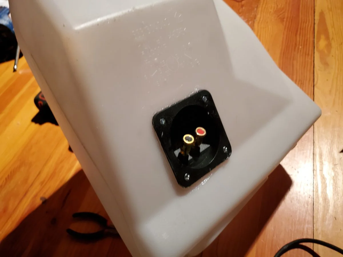

First I cut a hole and mounted a speaker terminal with RTV silicone:

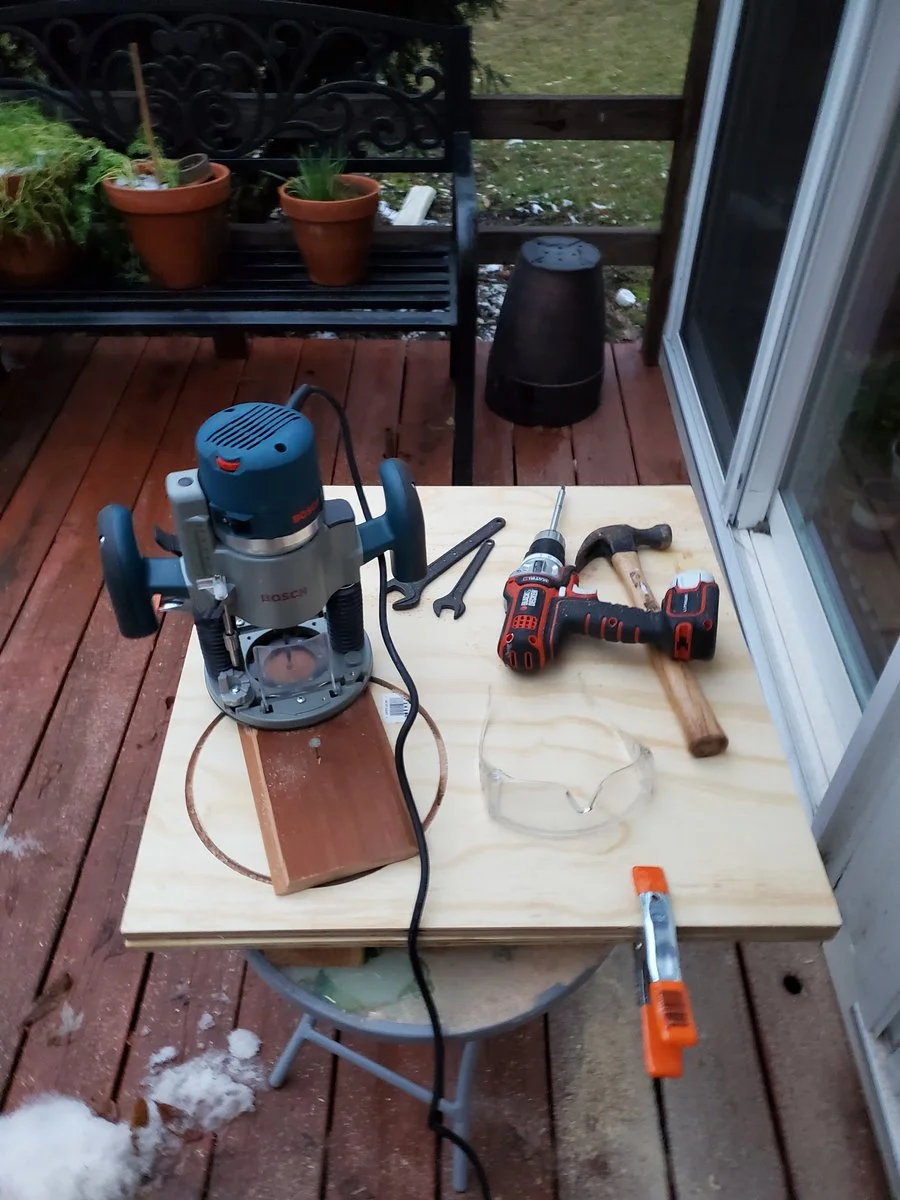

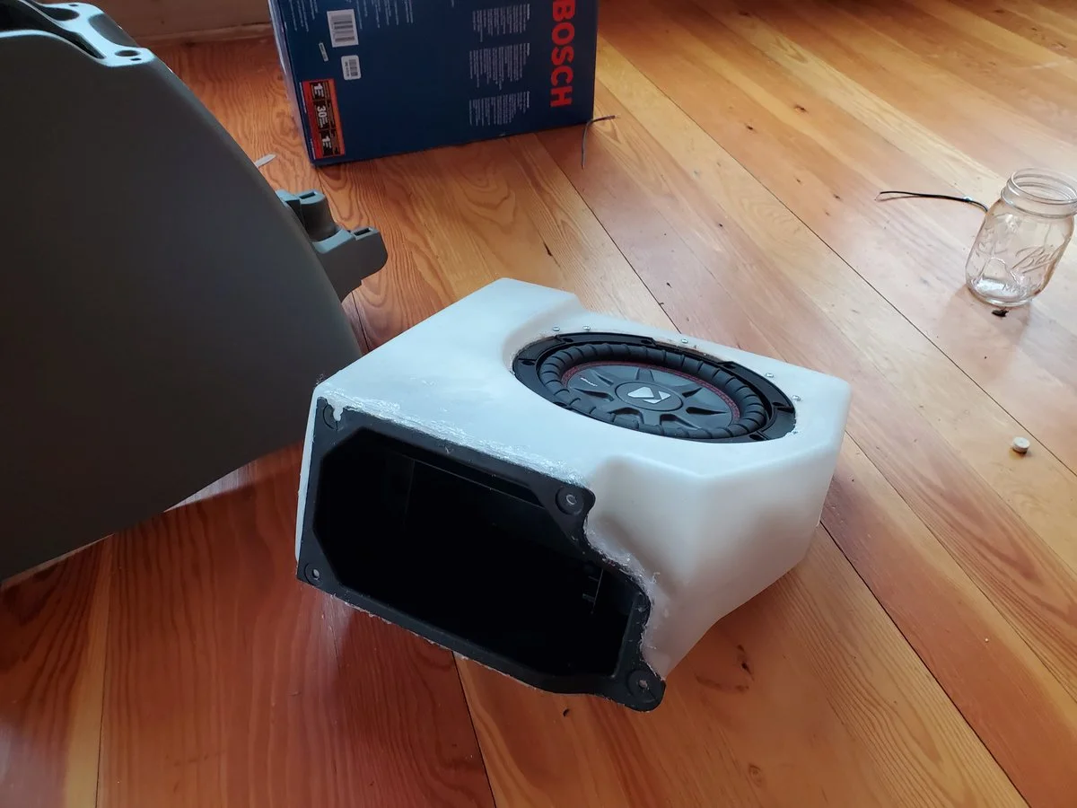

I made a jig myself to cut the recessed bracket to mount my speaker.
I tried finding a recessed bracket on Amazon but only found MDF in the wrong size. Plywood is much stronger for such a small part. I cut it custom to fit my Kicker 8" shallow mount sub:

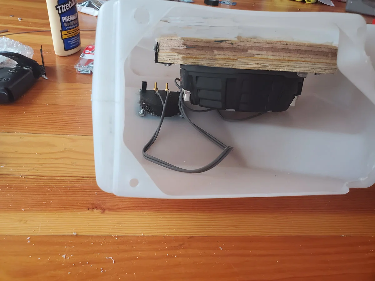

I was forced to cut the recess mount in half to fit inside the hole i made in the storage insert. I then reassembled it inside the container using metal brackets. I mounted the brackets before cutting the recess to make sure it would reattach at the same exact diameter. I used the thinnest jigsaw blade I had to make the cut. I then used gorilla glue to fill the empty space when reconnecting the recess inside the container. Gorilla glue expands a lot to fill the space, which is why I used it. I use RTV silicone to seal around the recess.

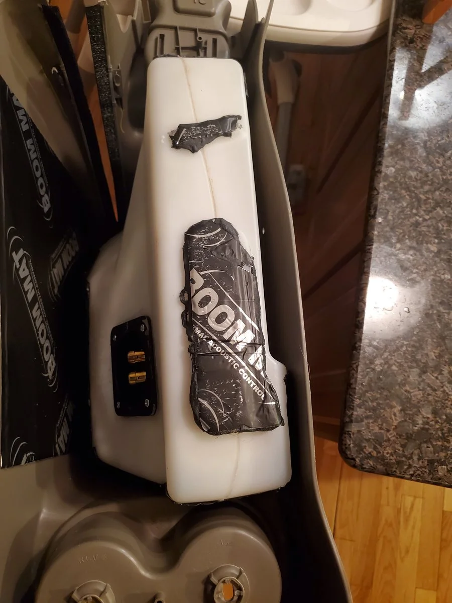

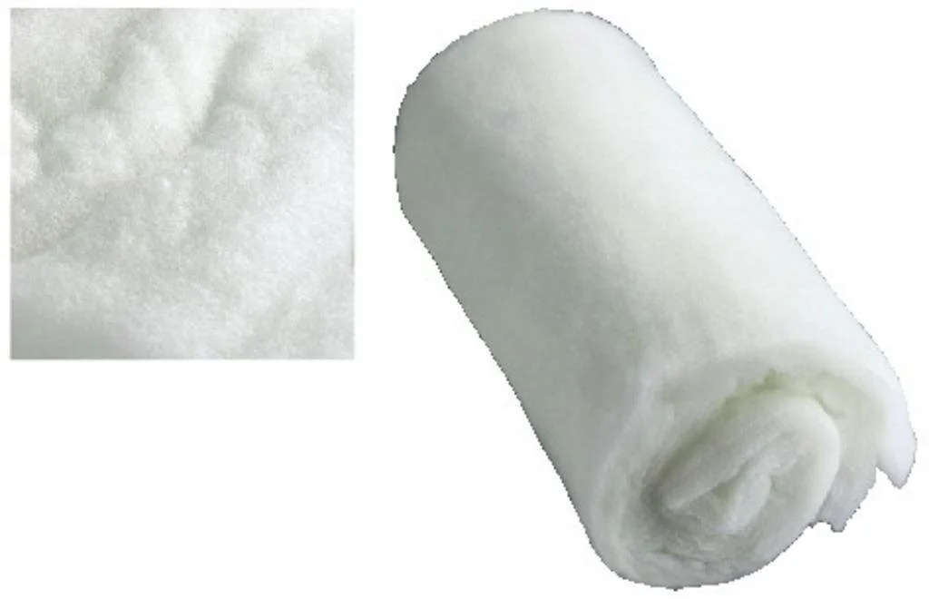

Next I filled the space will Polyfill, to dampen vibration, before sealing the subwoofer insert onto the enclosure using RTV silicone
I then mounted it to the center console using automotive panel fasteners where the existing (drilled-out) rivets were. (in this pic not mounted yet so speaker is sitting low)
The terminals are still accessible from below even when attached to the center console. I bring it to the car and install! It bumps!

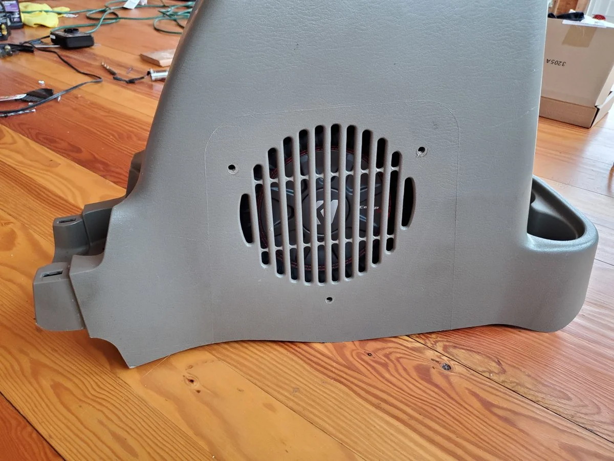

I would also shorten those grey cables and wrap them with tesa tape as they look like they could slap. there is also the point where the speaker meets with the grille on the side of the console, you will have plastic on plastic contact there.
you may be getting flapping because the volume of the enclosure is not enough for woofer, could try making sure its completely sealed (with no ports) and dampening the walls inside the enclosure

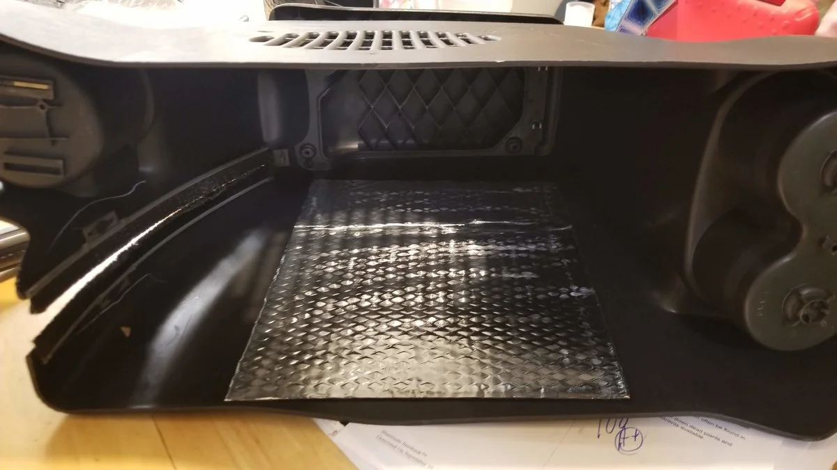

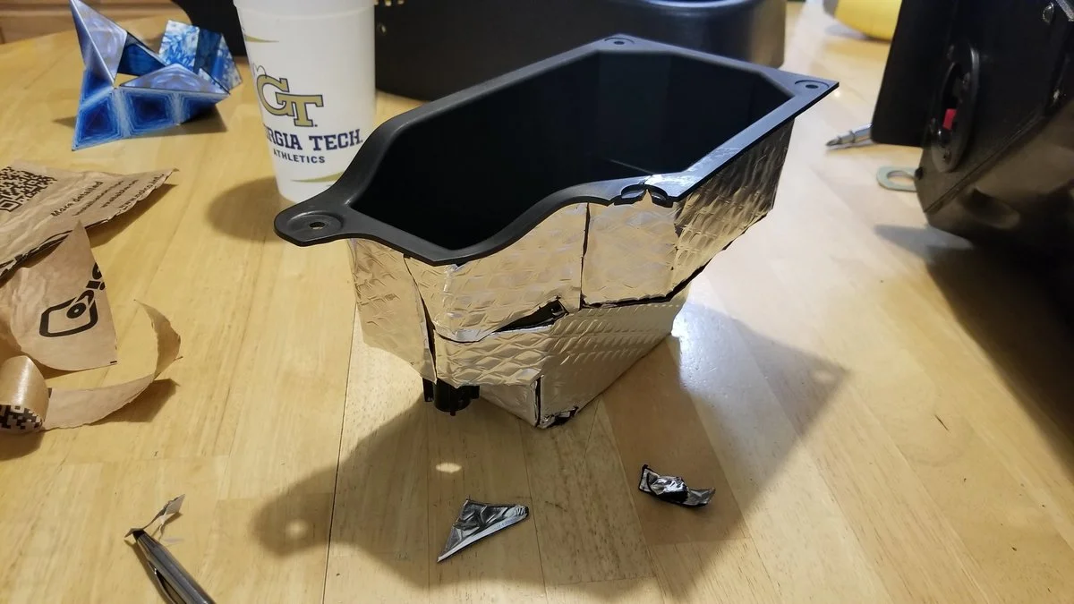

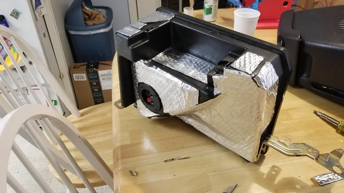

I covered both the box the sub is in, and the console tray with the sound deadening material. It helped tremendously with the rattling.
I also pus some on the passenger side of the center console.

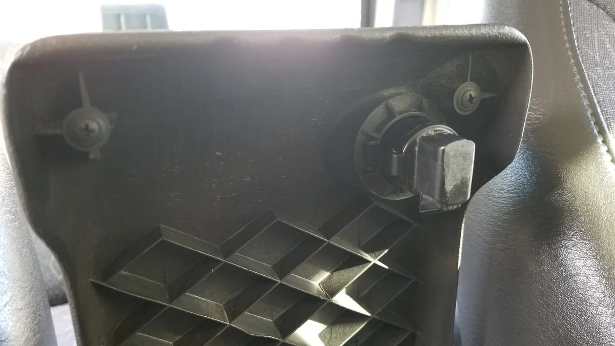

To stop the lid from rattling, I ran a screw up in the hole on each side by the lock mechanism. That let me adjust the stop so the lid was tight when the latch caught.

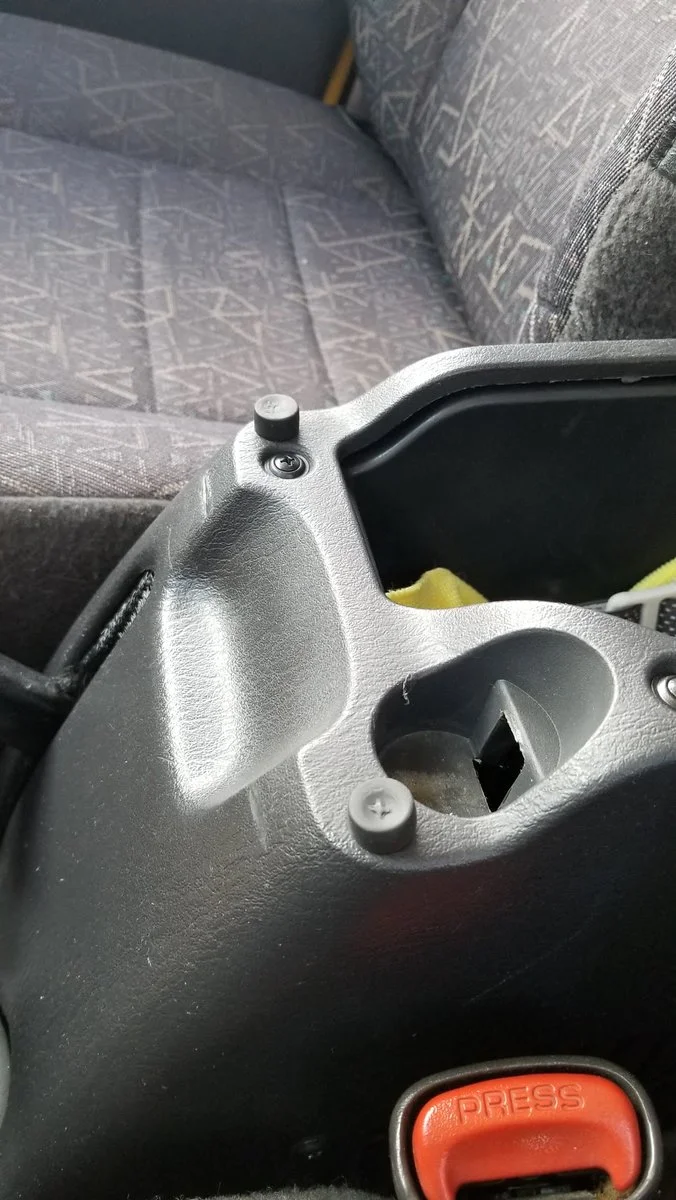

I noticed the rubber stopper pads where missing on yours in your photo. This is where the screws from above make contact to keep the lid snug. I purchased replacements at Advanced. (They were with the screws and trim parts. )

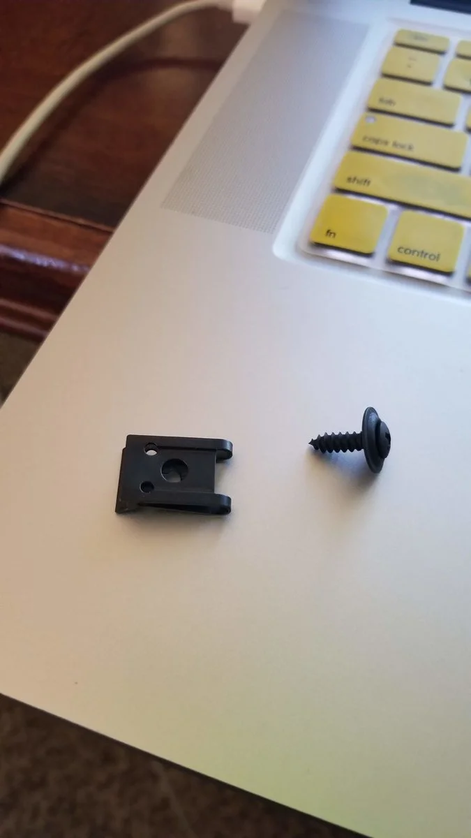

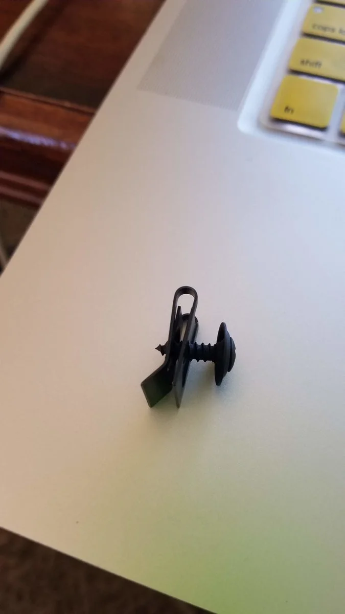

To attach the instead of the Xmas tree clips, might I suggest clip nuts. They are with the trim screws at Advanced. They give you a metal clip that slides over or behind the holes on the console tray & will let a metal screw pull up tight in them.
View attachment 136497View attachment 136498
Was wondering what those holes were for.

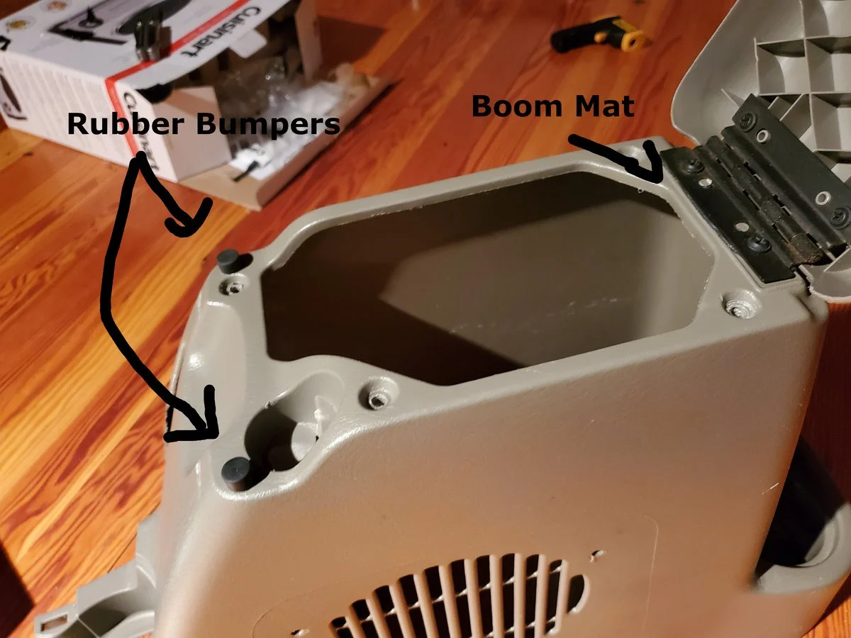

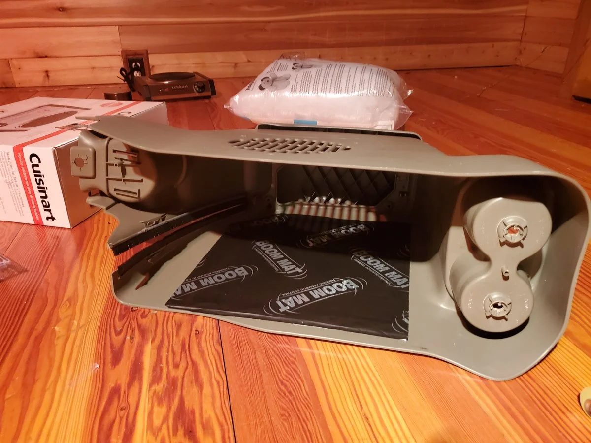

Thanks for all the advice! I managed to fix all the vibration using boom mat, clip nuts and rubber bumper stops for console lid.
I fixed the console lid vibration by adding rubber bumper stops and adding boom mat where the lid attaches to the console (thanks @GaTechTJ):

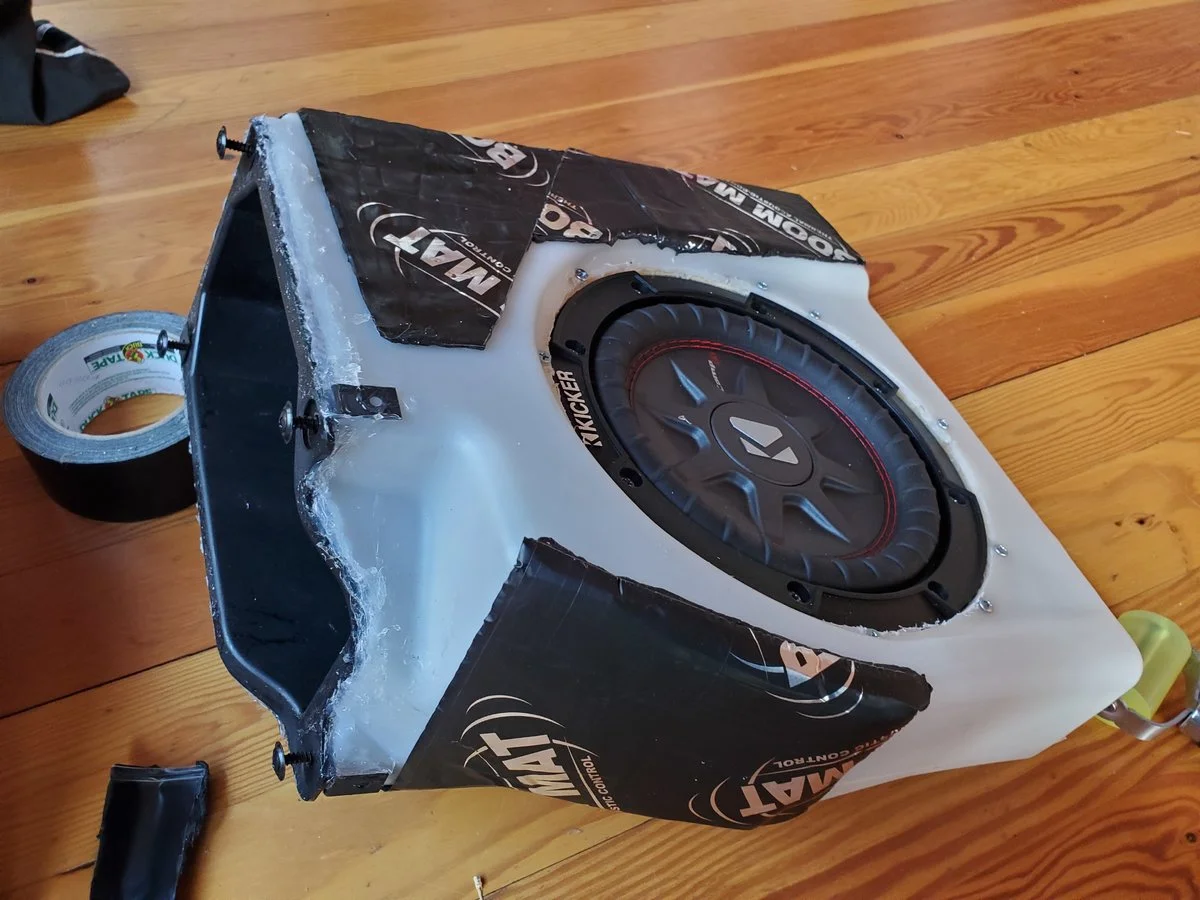

I replaced the xmas tree connectors with clip nuts w/ trim screws and covered the enclosure with Boom Mat. (thanks @GaTechTJ and @bobthetj03)
This almost did the trick... but I still had vibration in the large open side of the center console, so I added some boom mat there.

I also added a bit more polyfill inside the enclosure because it was punching hard. the 400 RMS in that tiny space packs a punch! (thanks @Reign Mack)
