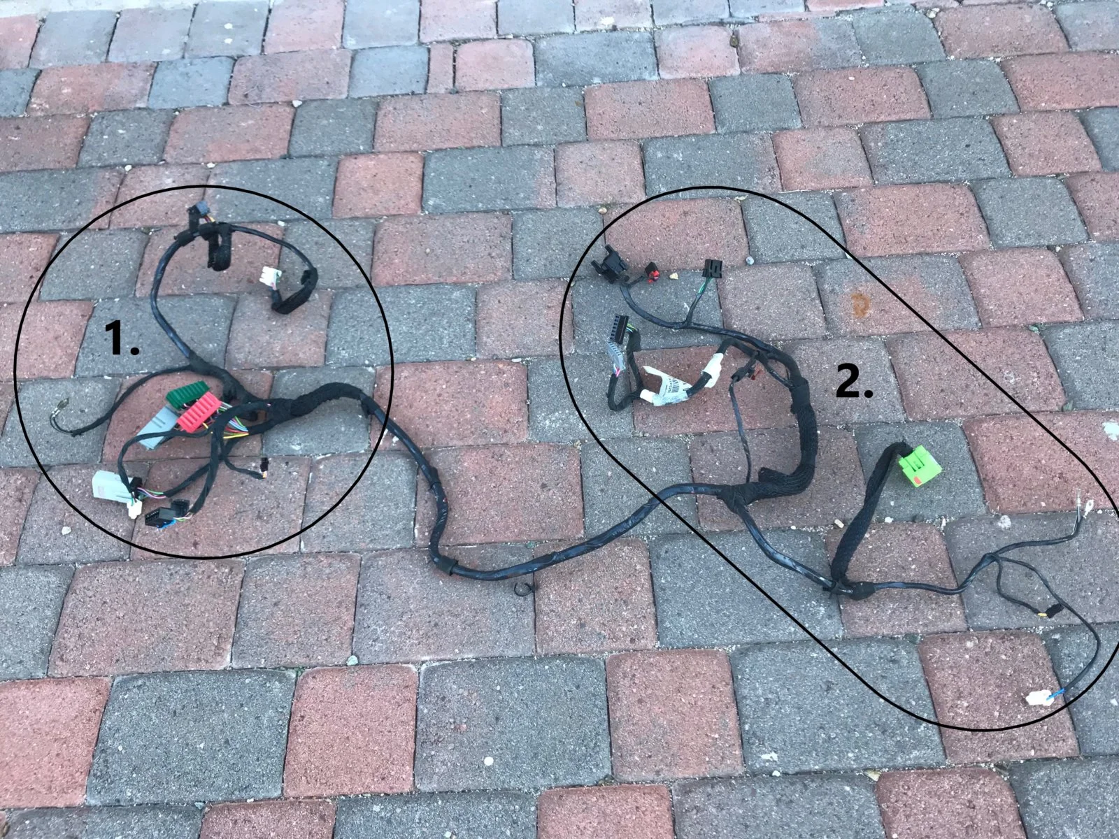

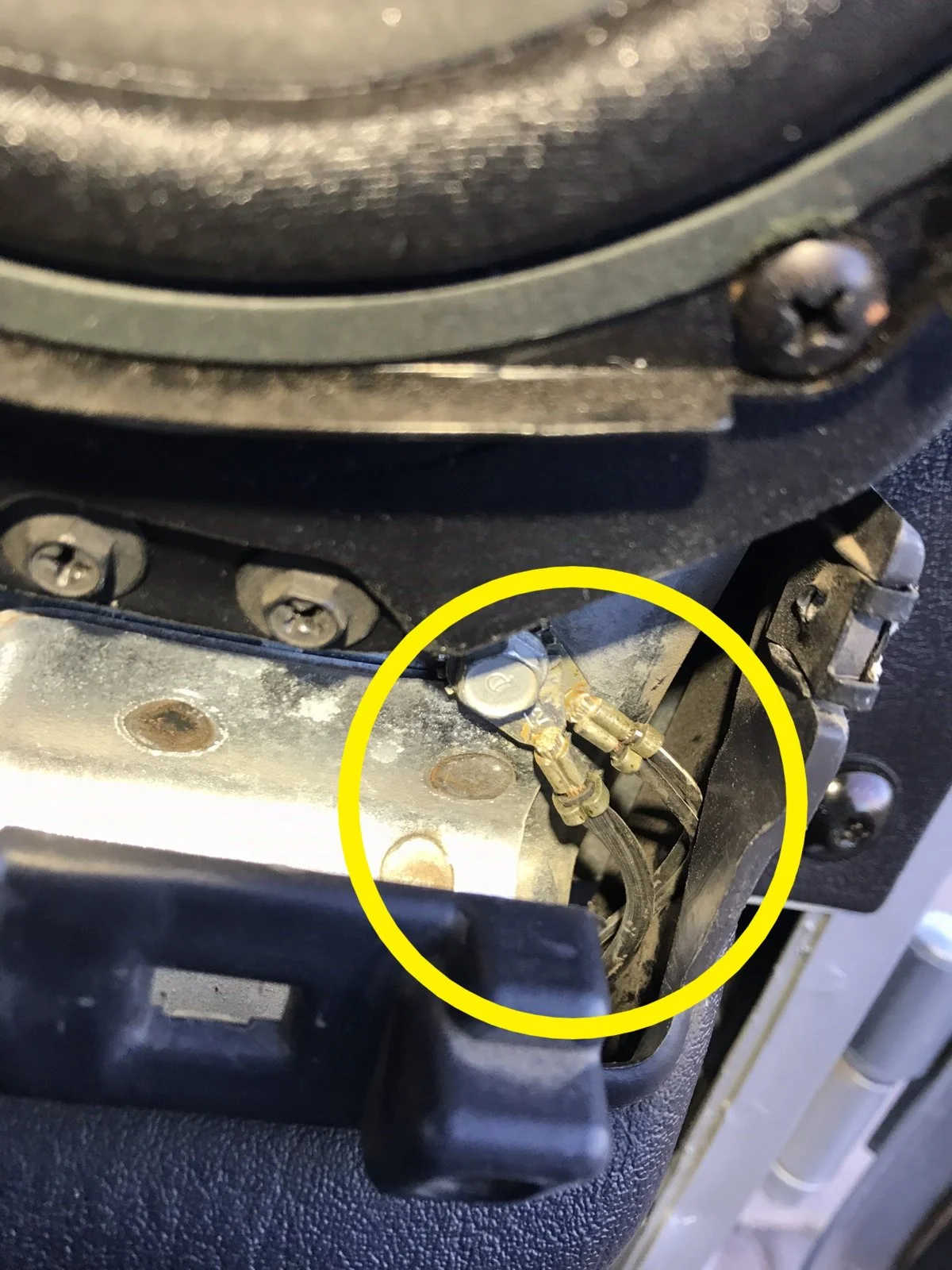

We're going to focus on the dash harness today. The dash harness is known as the HVAC harness, which is split into two parts.
Side 1:
Red, green, and grey 100-way connectors

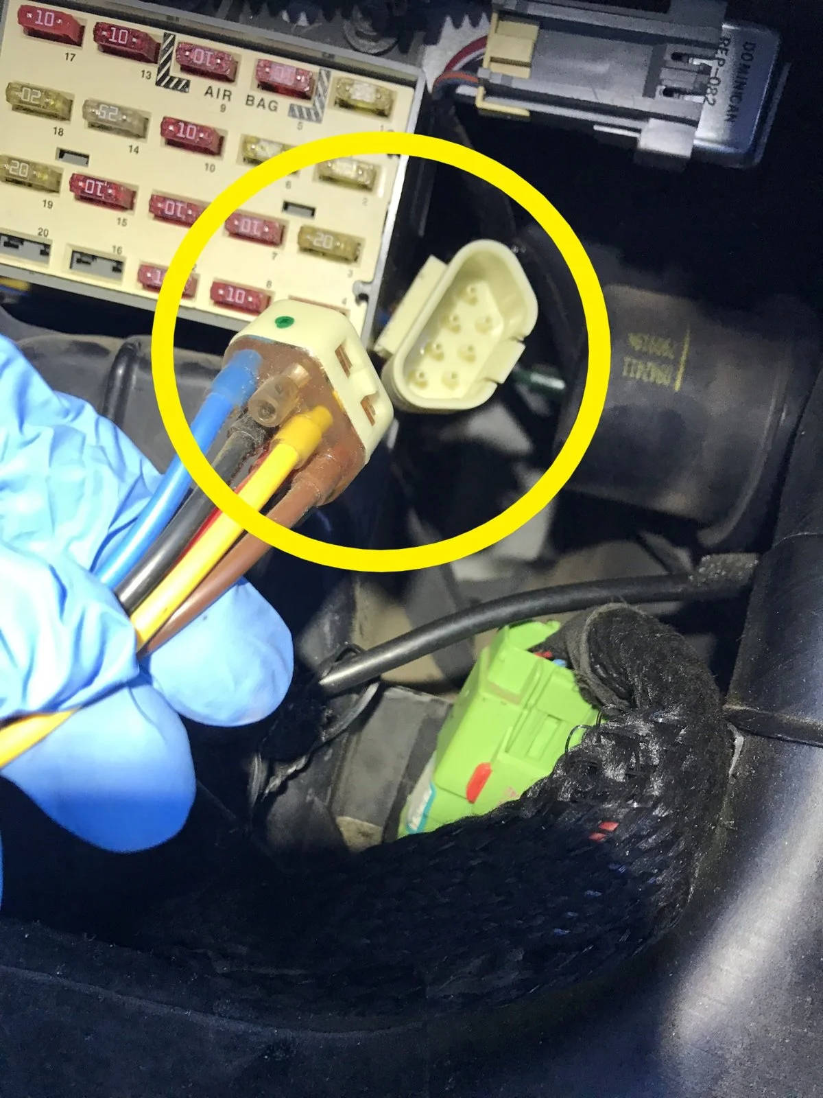

Grey 10-way connector going from fuse block to PDC (power distribution center)
IPC #1 and #2 (instrument panel cluster)
Left front speaker
Left courtesy lamp
OBDII port

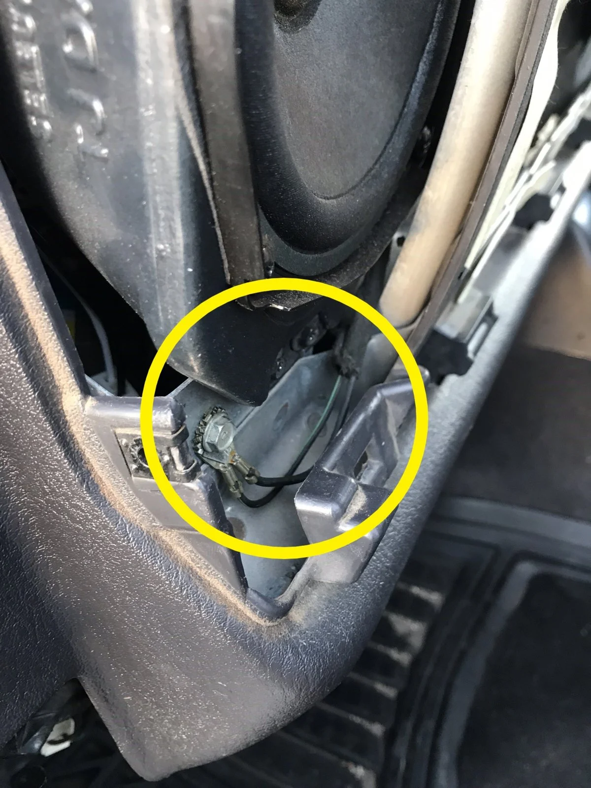

Left side ground
Side 2:
Radio
Blower motor
HVAC various electrical
AC compressor
Any factory rocker switch (rear defrost, rear wiper, fog lights, OD, axle lockers)
Cigarette lighter
Right courtesy lamp
Right front speaker
Green 10-way connector going from fuse block to PDC
Right side ground

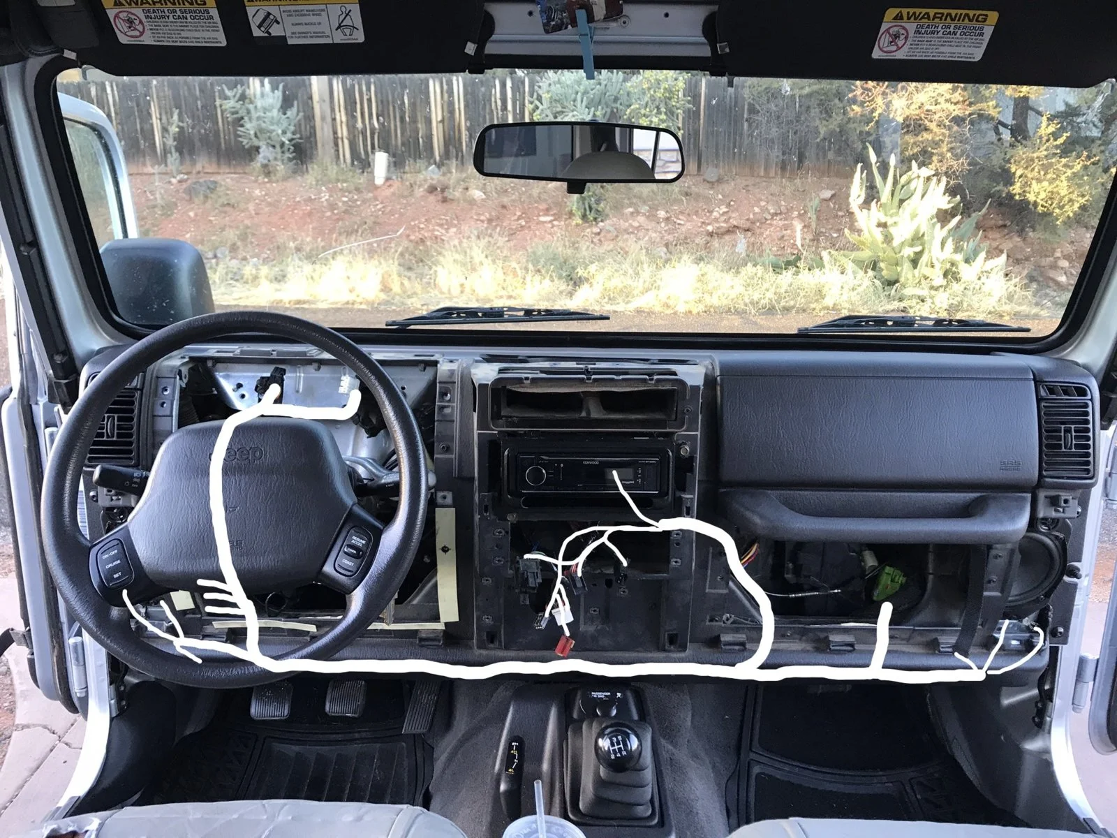

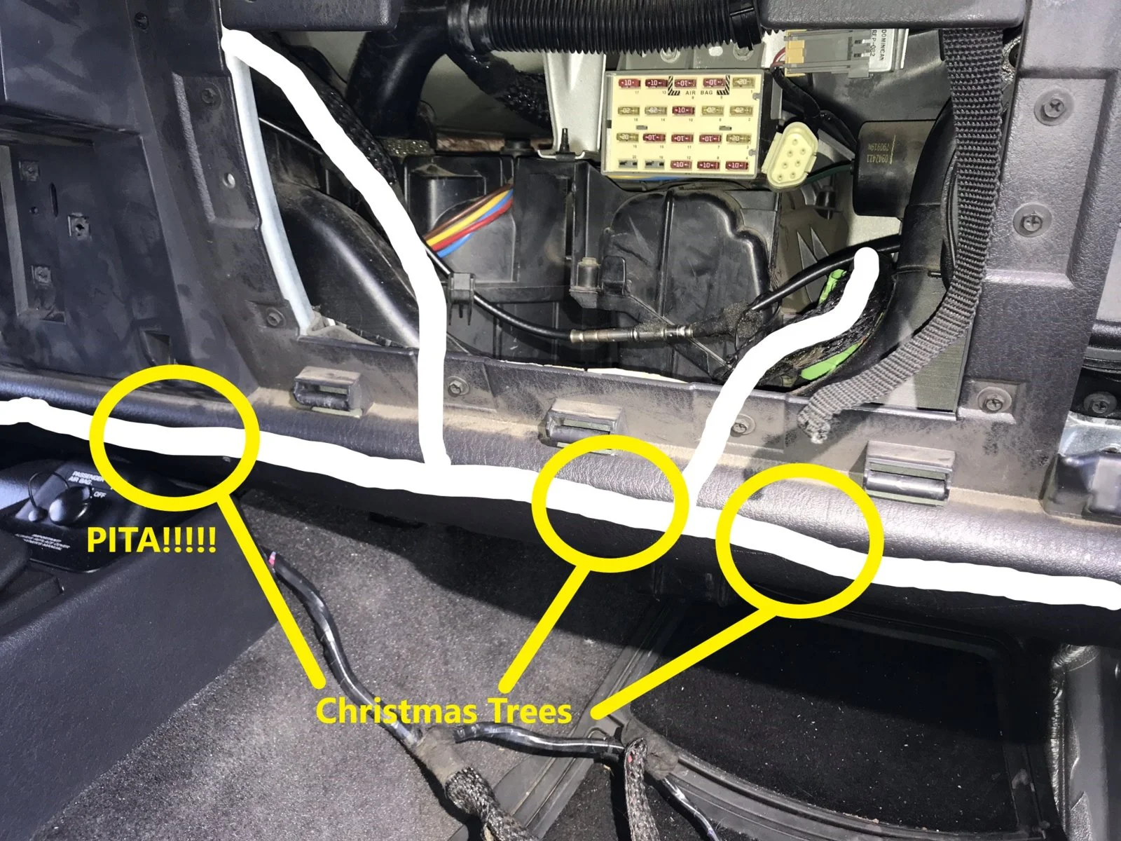

Remove your defrost trim, center bezel, glovebox, kick panel under the wheel, your IPC housing, your IPC, radio, HVAC, switch bezel, and both the left and right speaker covers. Your dash should now look something like this. I'm not going to go into how to remove all these parts since there are 100s of threads out there on how to do it.

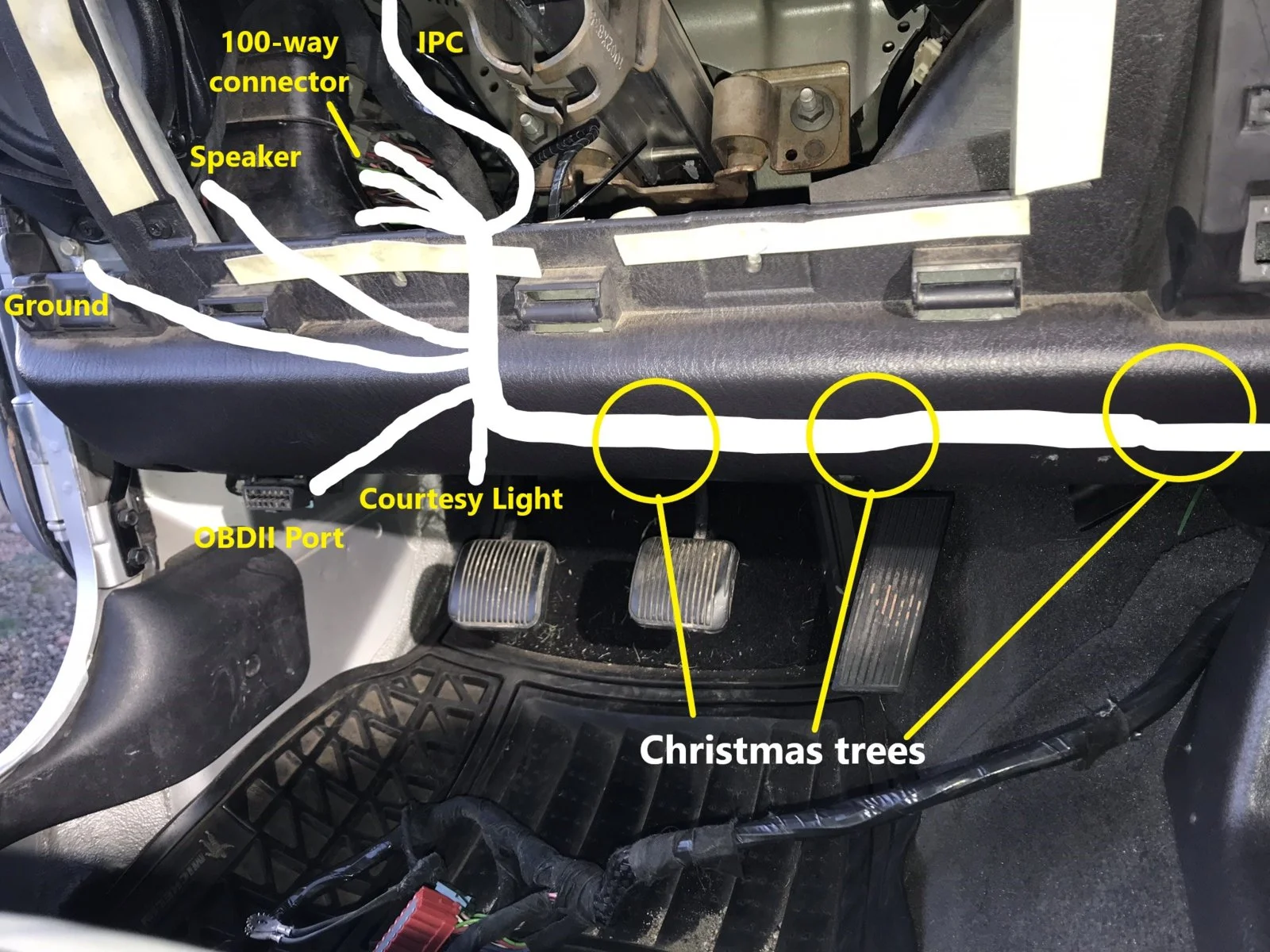

In white, I have traced the outline of how the harness runs through the dash. As you can see. it's very straightforward. Whenever you're working with electrical like this, you should always disconnect the battery. Next, unscrew the grounds from the metal dash frame, located beneath each front speaker.

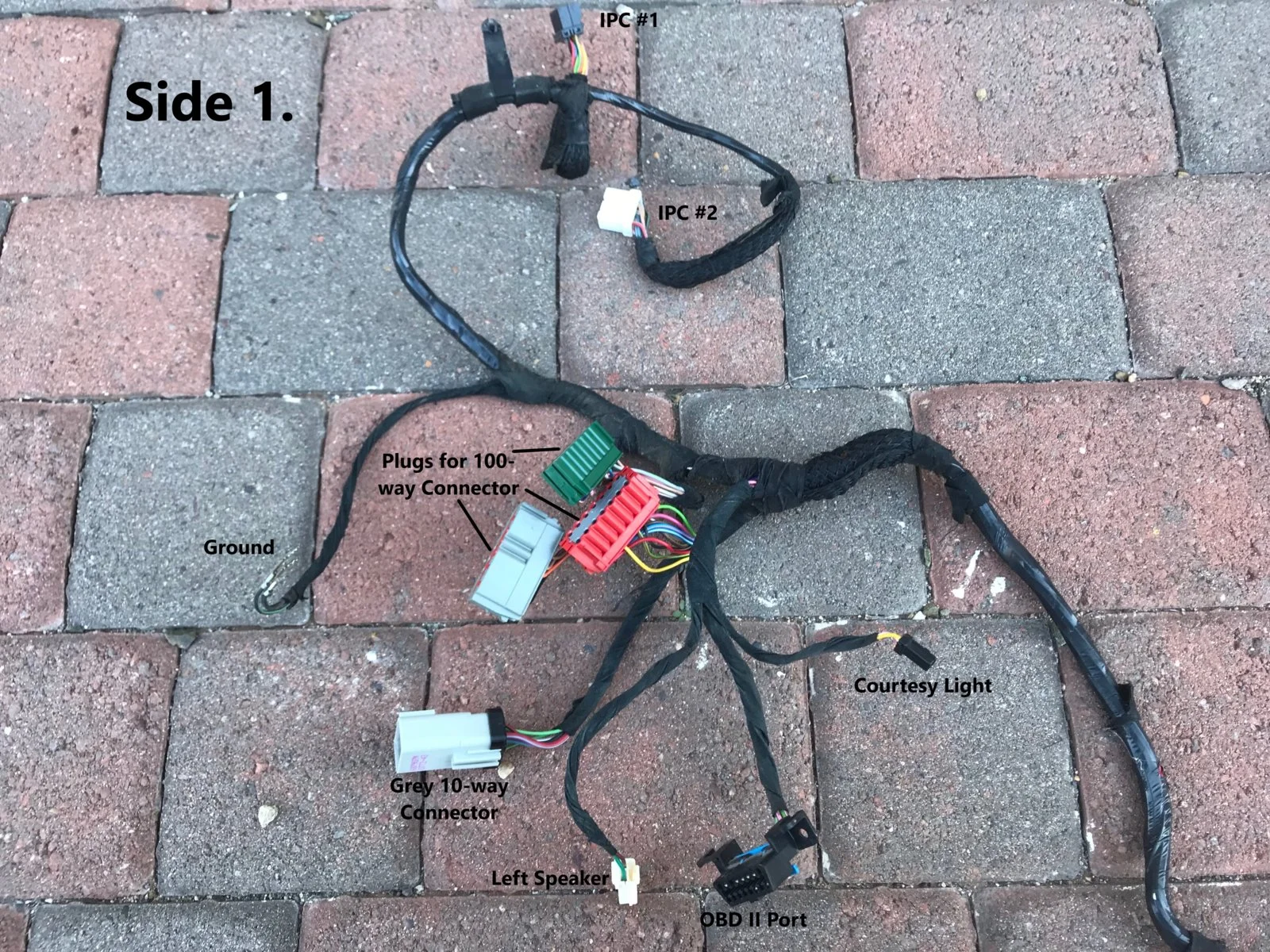

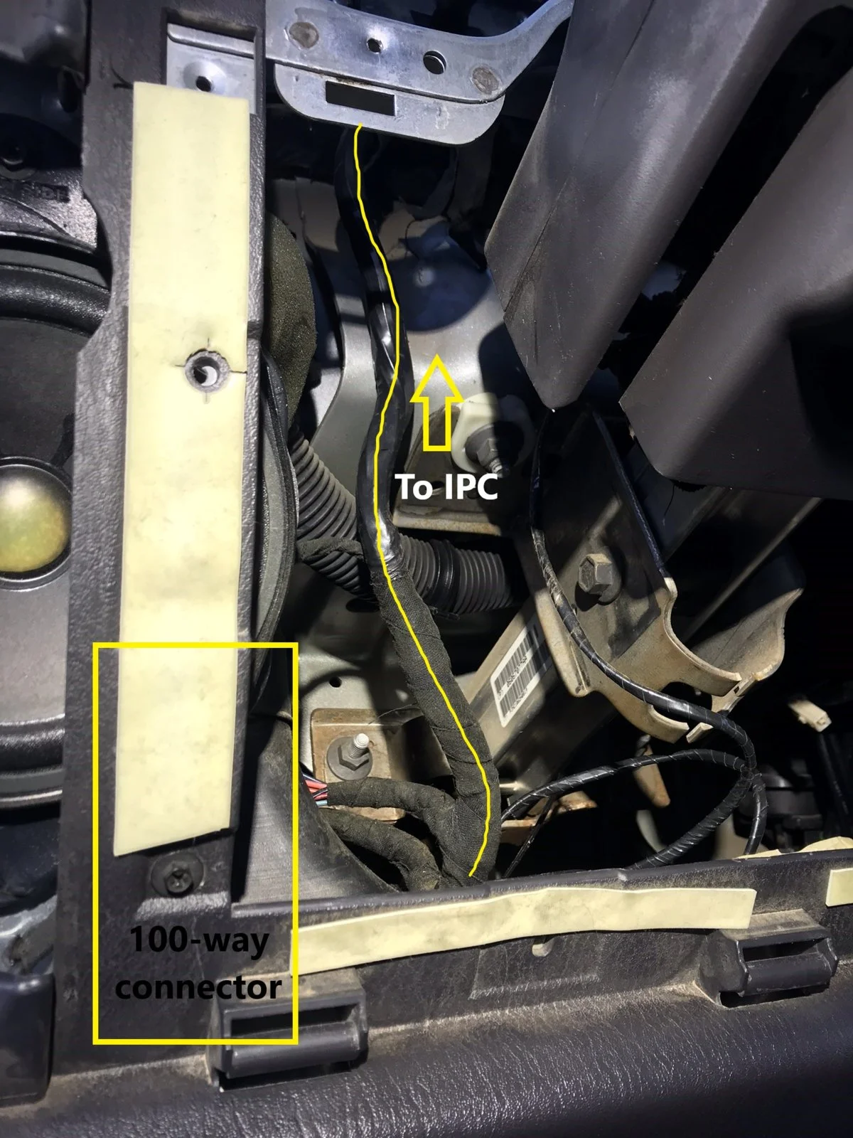

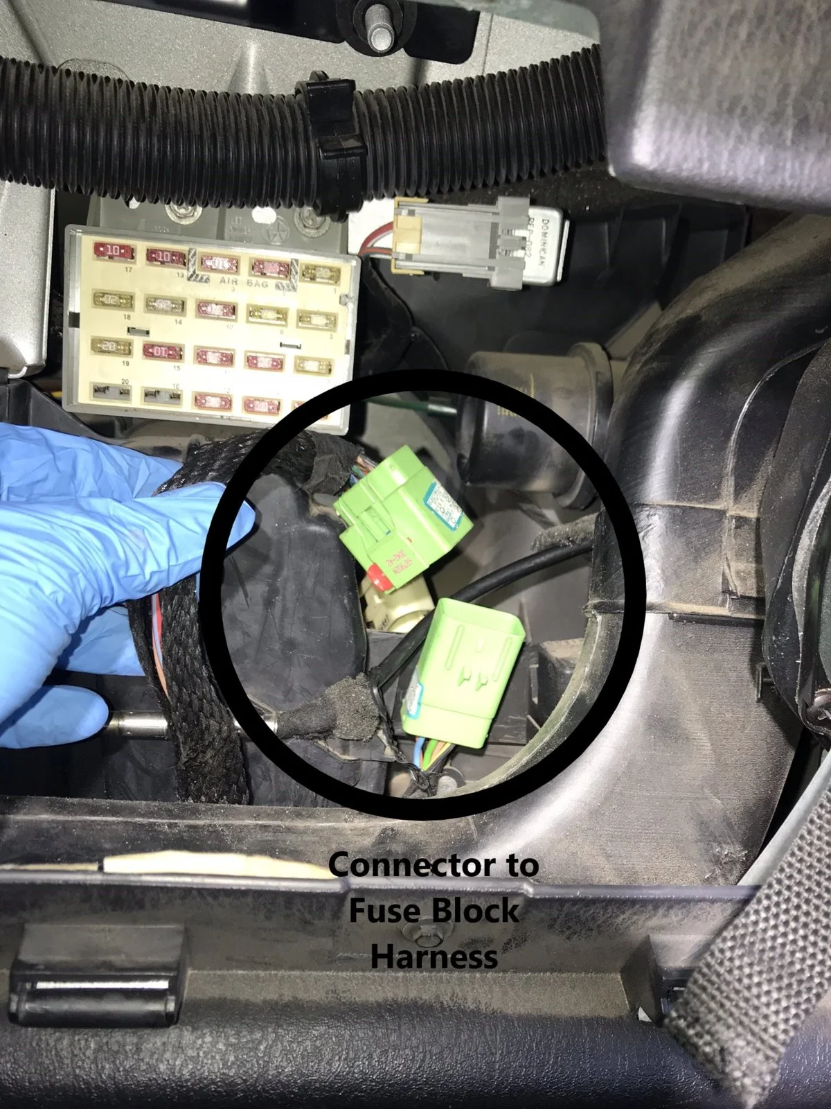

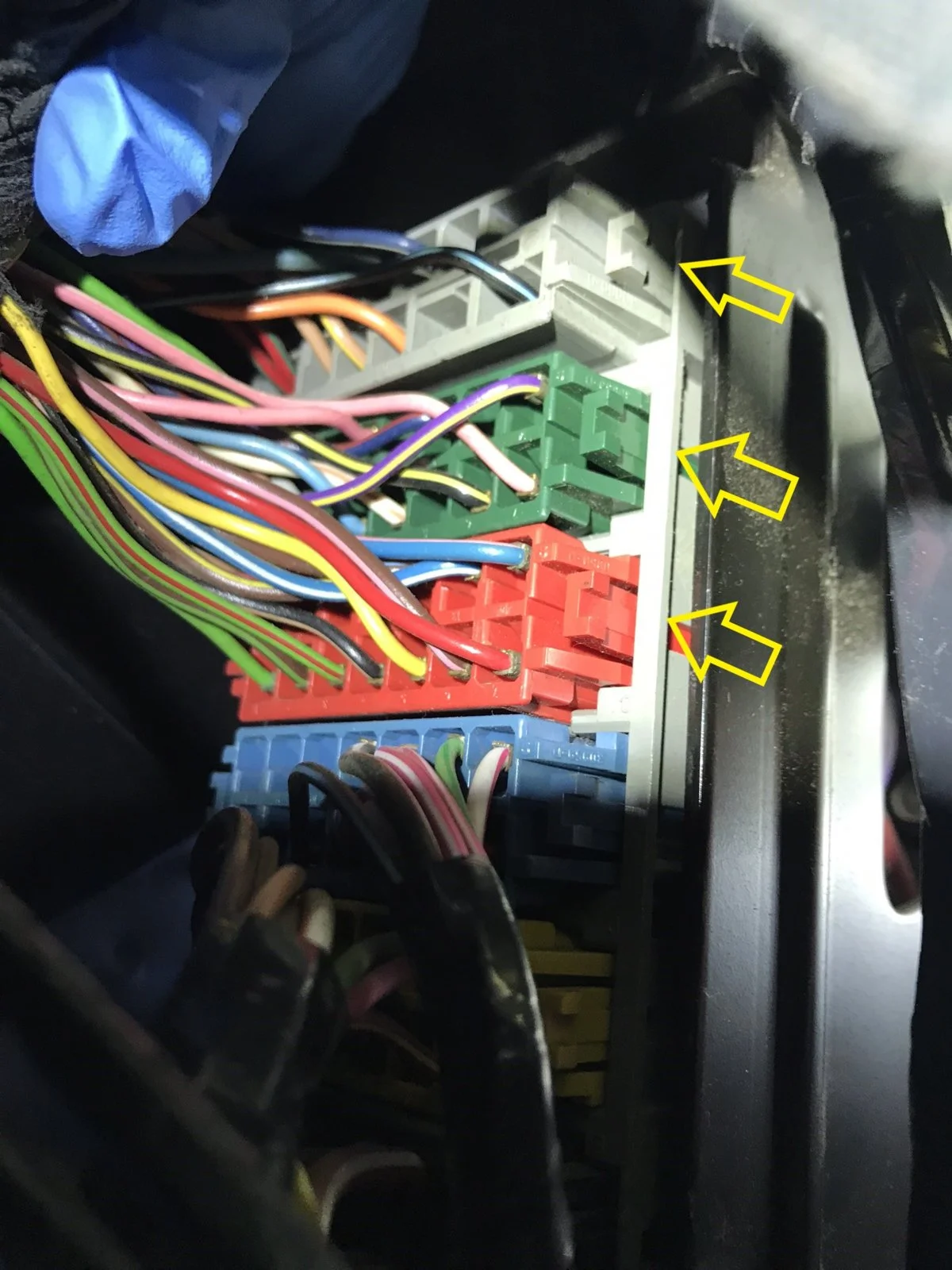

This is where the fun begins. We're going to start with side #1. Start by removing the grey, green, and red plugs from the top of the 100-way connector. The 100-way connector is below the dash by your left leg.
These connectors are the core of this harness, everything you trace and follow starts here. Plug in the connectors from your new harness the exact same way. They will only plug in one way despite looking symmetrical, so don't worry about getting them upside down. Just don't plug them into the wrong color spot.

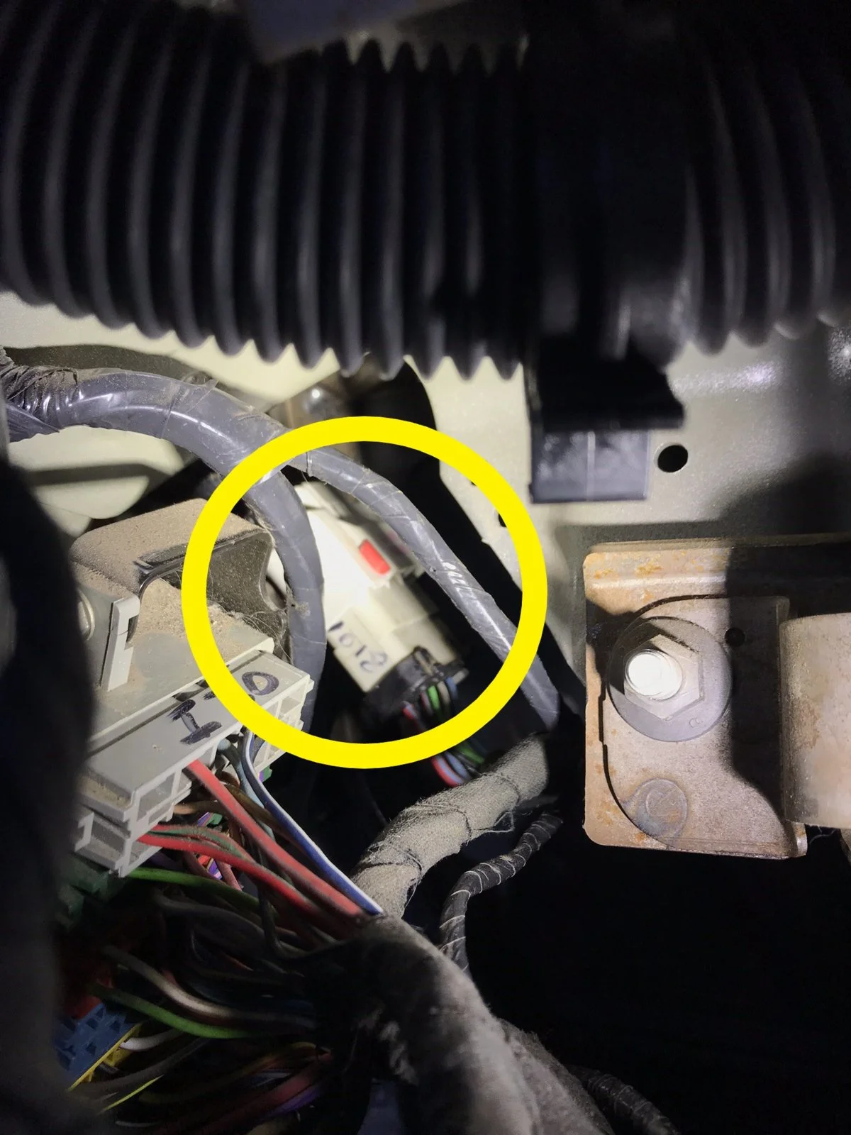

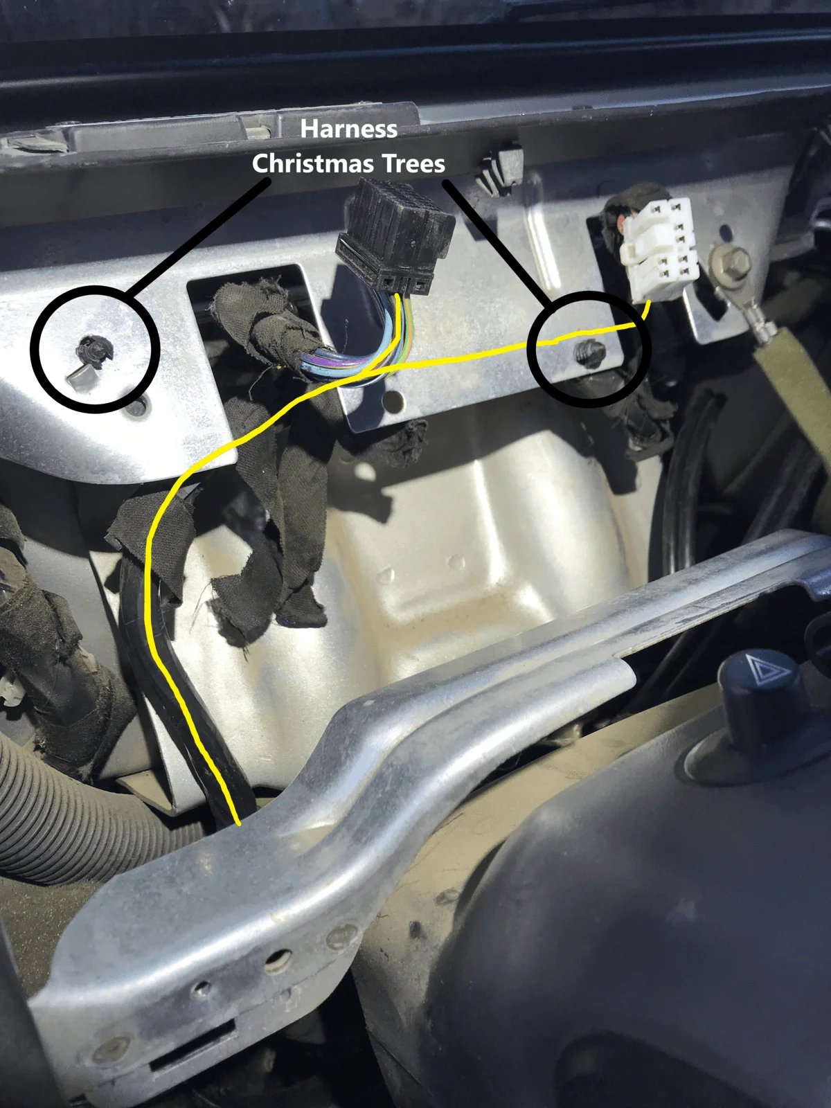

I couldn't get a good shot of it, but behind the 100-way connector close to the firewall is the grey 10-way connector. Remove this connector and plug in the new one. FYI this has the little red safety lock on the plug.
Once you have these plugged in, there will be four little wires veering off to the left from the old harness, ground, speaker, courtesy lamp, and OBDII. Simply follow where the existing wires go, remove them a plug at a time, and run the new wires in their place. The OBDII port does not plug in but is simply fastened to the dash by two screws. Unscrew the old one and screw the new one into it's place.
Next up is the IPC. This loom runs up the left side of the steering column. There might be a couple of small wires zip tied to this loom (in this picture they're to the right). Just cut the ties and let them hang for the time being. Here's the IPC loom.

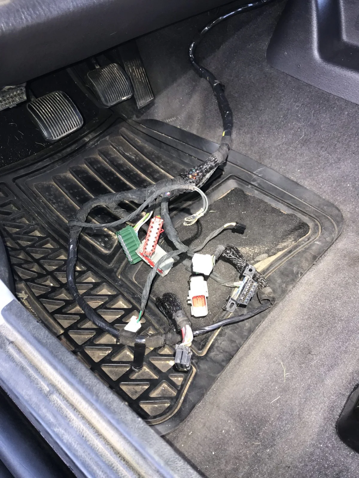

Congratulations! You have finished side #1 and the old harness should be laying on the floor like this. You're halfway done. Now's a good time to grab a beer

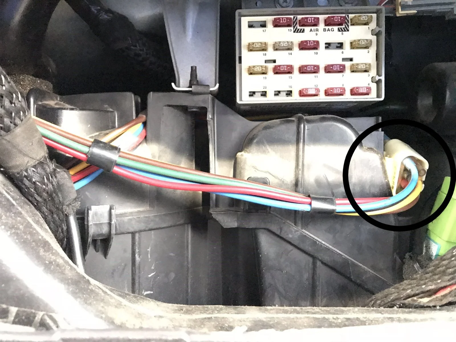

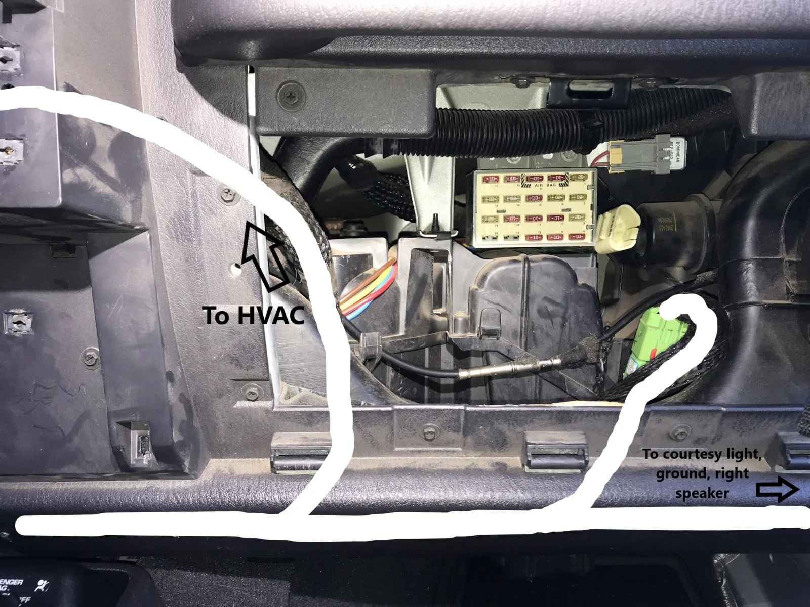

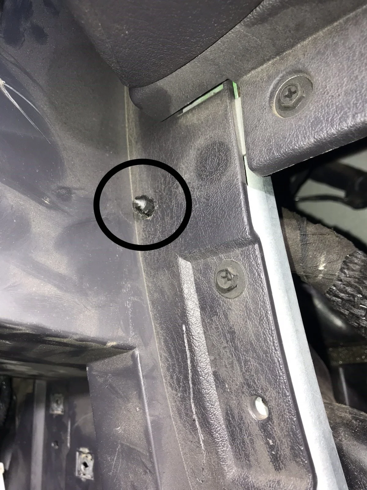

Now, your harness runs through a narrow channel underneath the dash to the other side. Pictured is side #1.
It is held into place on side #1 by three wiring harness clips, their locations are circled. The clips look like the ones pictured below.

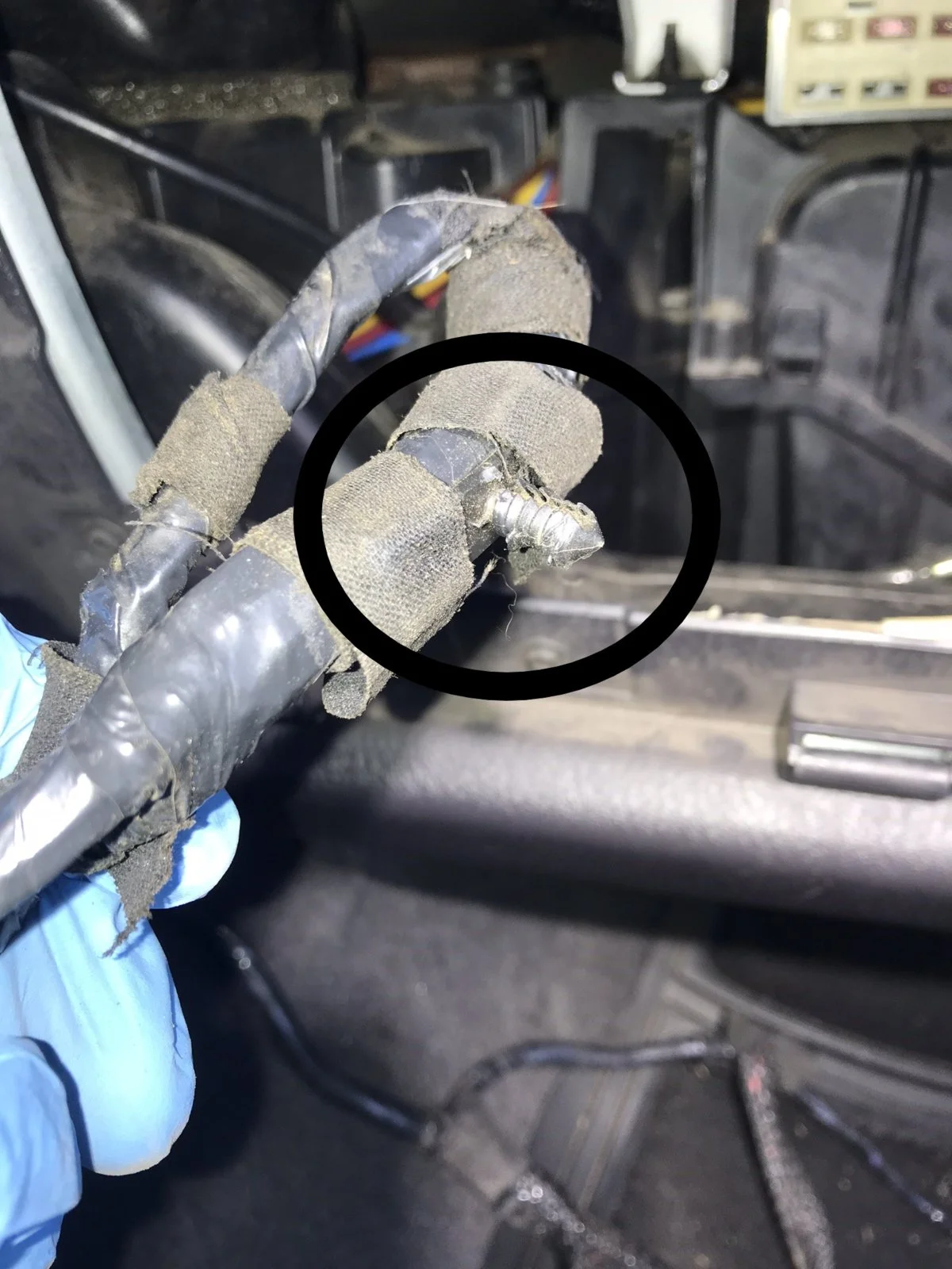

As you're pulling the harness out of it's channel, odds are the tape holding the clips to the harness will give way and leave the clips in their place. Not to worry, grab a pair of needle-nose pliers and yank those puppies out. Again, they are extremely durable and could probably be re-used if your new harness did not come with them attached. Or you could buy new clips and play it safe. The tape that was holding them should still be on the harness, use that tape for reference when attaching the clips to the new one (if needing attached). Use electrical tape. Go ahead and mount the new harness into place, securing it with the clips.

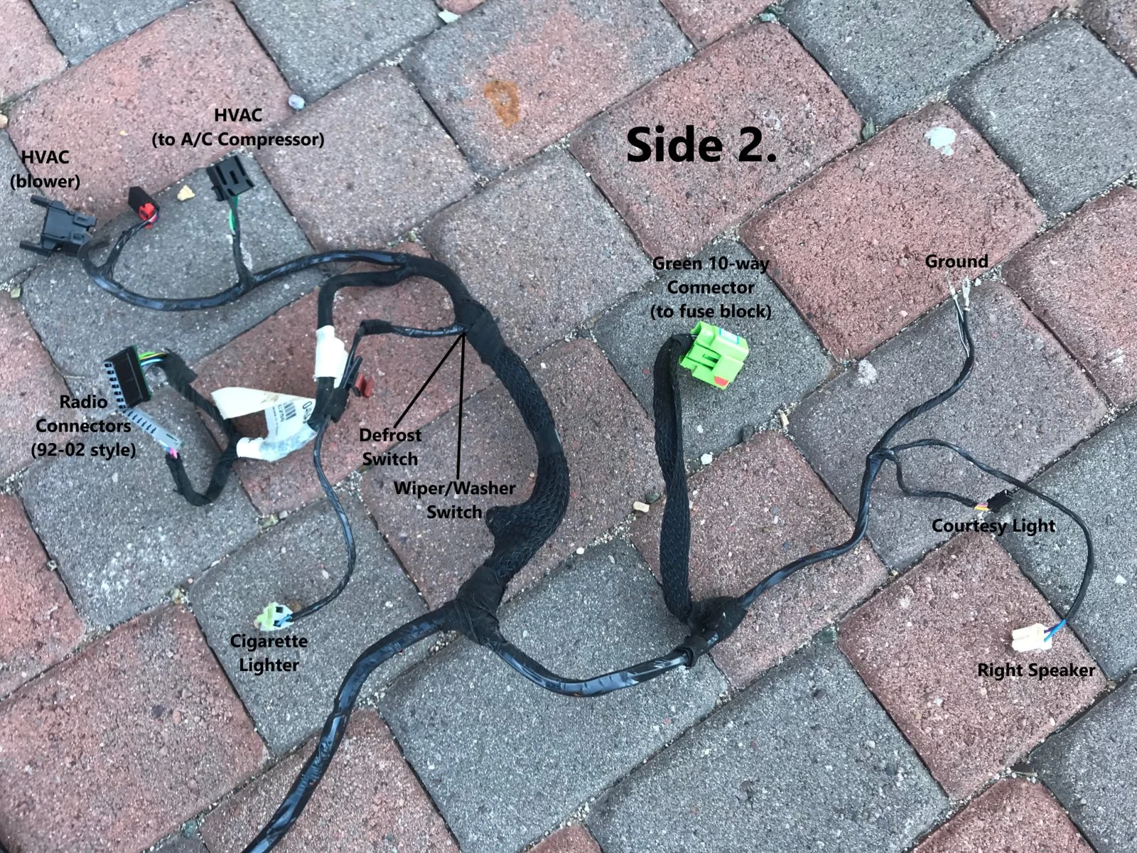

On to side #2.
At this point you have completely freed side #1 and attached the new harness into it's place. Now you will need to remove the wiring harness from side two. It's easiest to just pull the harness loose from the clips, and remove the clips after. You will notice one with PITA next to it. This clip is extremely hard to reach, but it's doable.
Once the clips are removed, attach them (or your new ones) to the new harness if no clips are present. Now you can start removing the rest of the old harness. Disconnect the green 100-way connector. This has the same red safety clip as the grey plug on side #1.

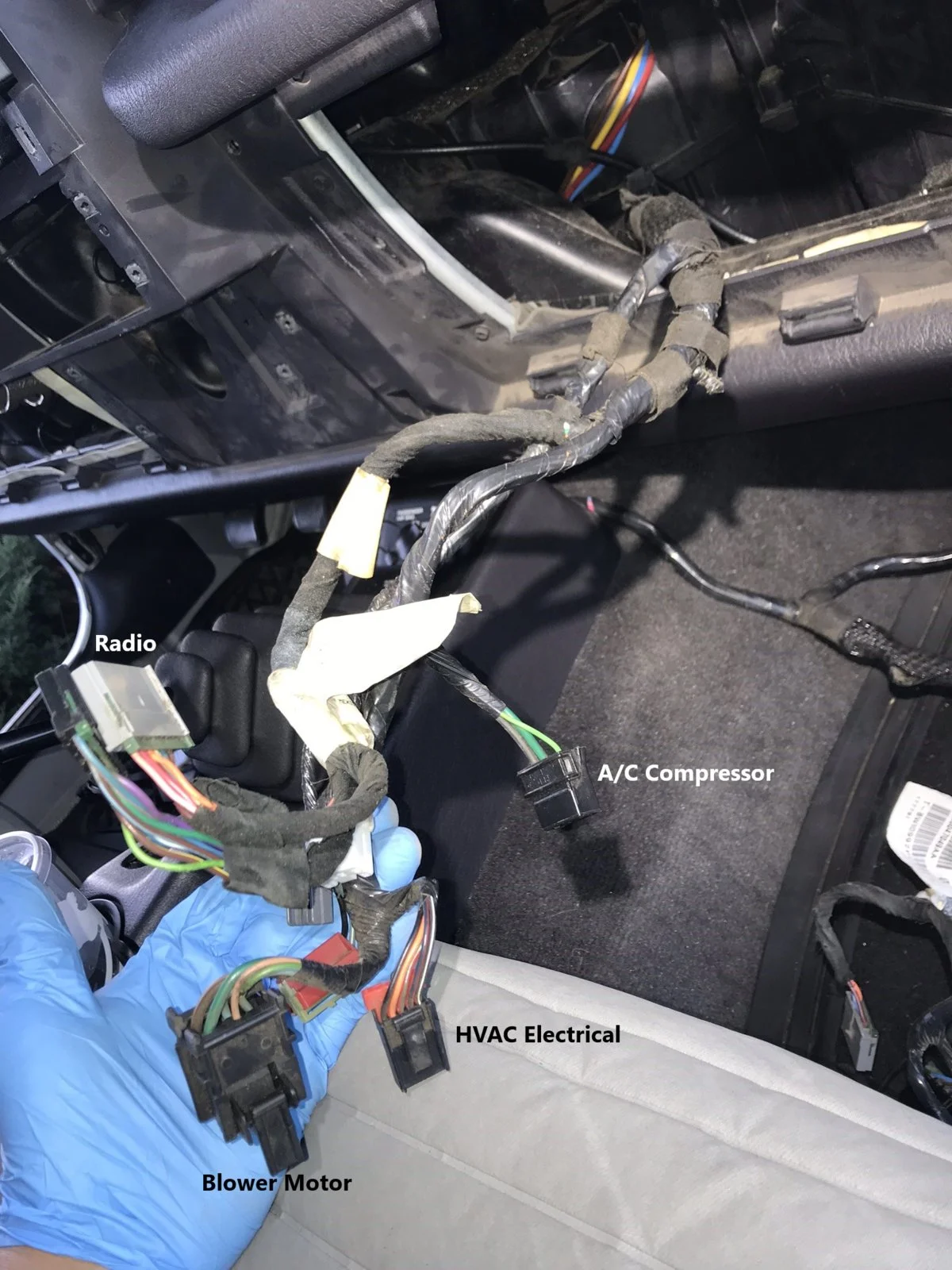

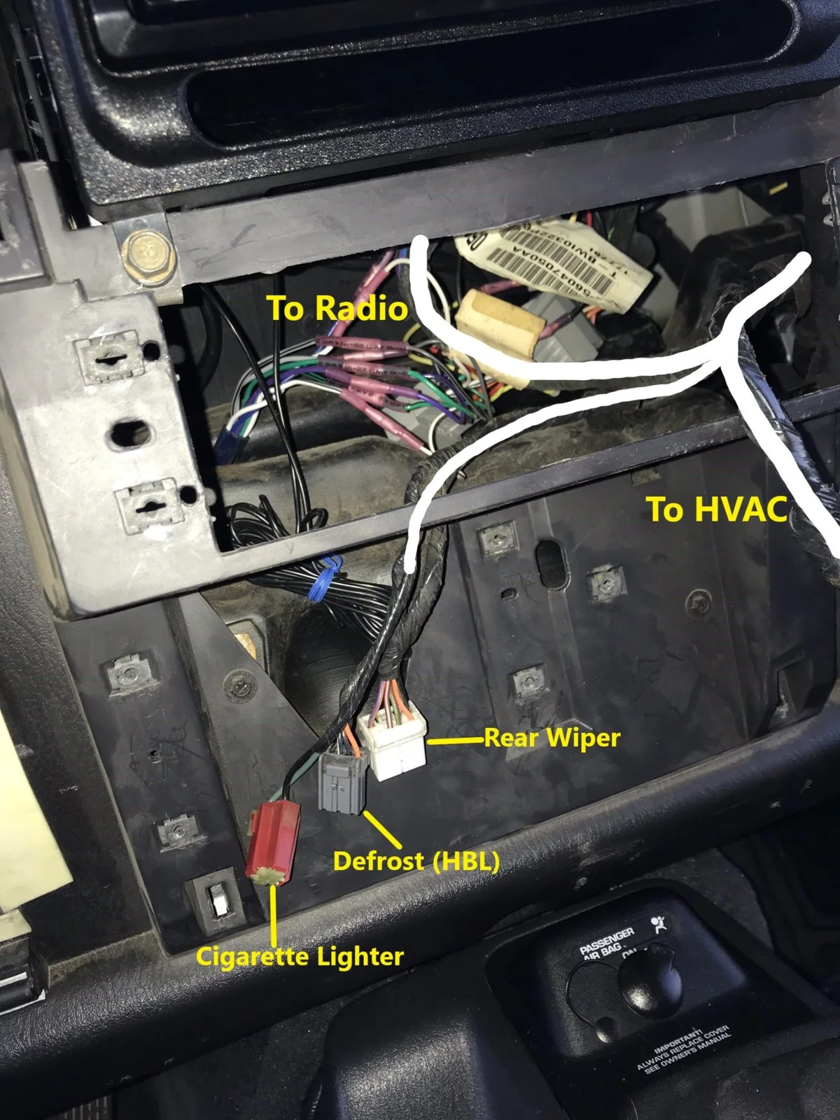

If you follow the main harness all the way to the right, you can also unplug the right courtesy light, right front speaker, and unscrew the little ground below the speaker if you haven't done so already. You can pull this section of the harness out and let it hang below the dash.
Then pull the HVAC/radio loom from the dash.
This loom is held into place by another harness clip which is easy to pop out. On the new harness, this loom is what will contain the wiring for all of your factory rocker switches, as well as the new hardtop switches.
This clip is located on the upper left hand side of the glovebox cutout.

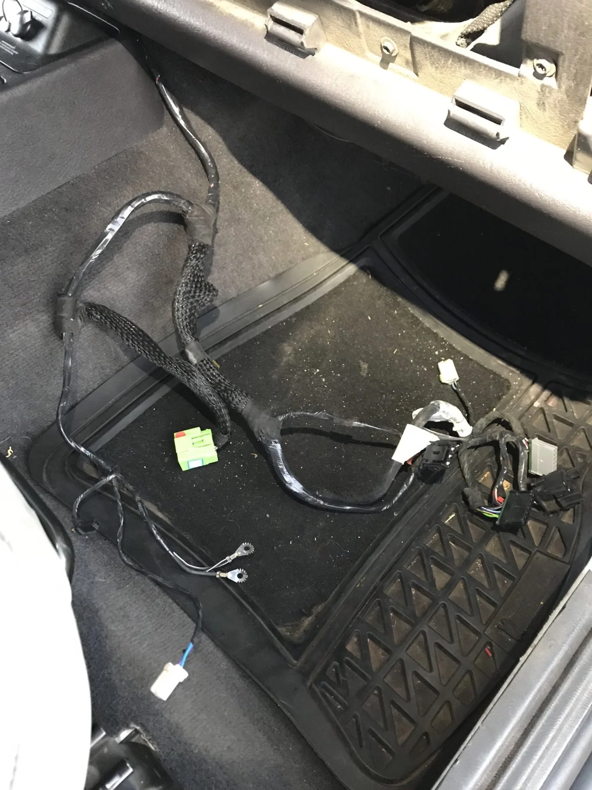

You should now be able to remove the entire harness from the jeep and out of the way. You will be left with the new harness on the floor like this.
Go ahead and start routing the main harness through the channel at the bottom of the dash, pushing the harness clips into the place of the old ones (they should be taped to your harness at this point). Reconnect your green 100-way connector as well as the courtesy light, speaker, and ground.

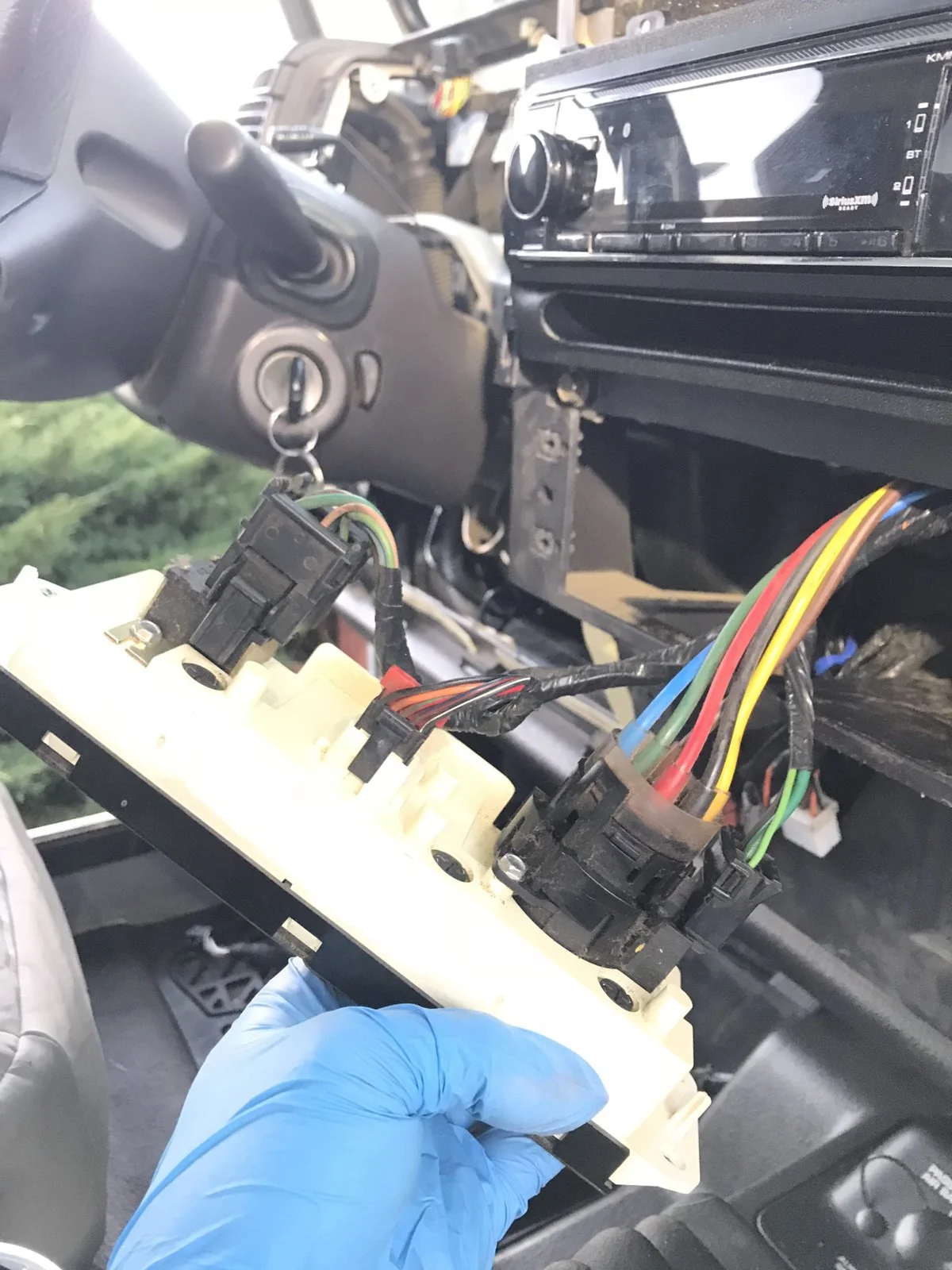

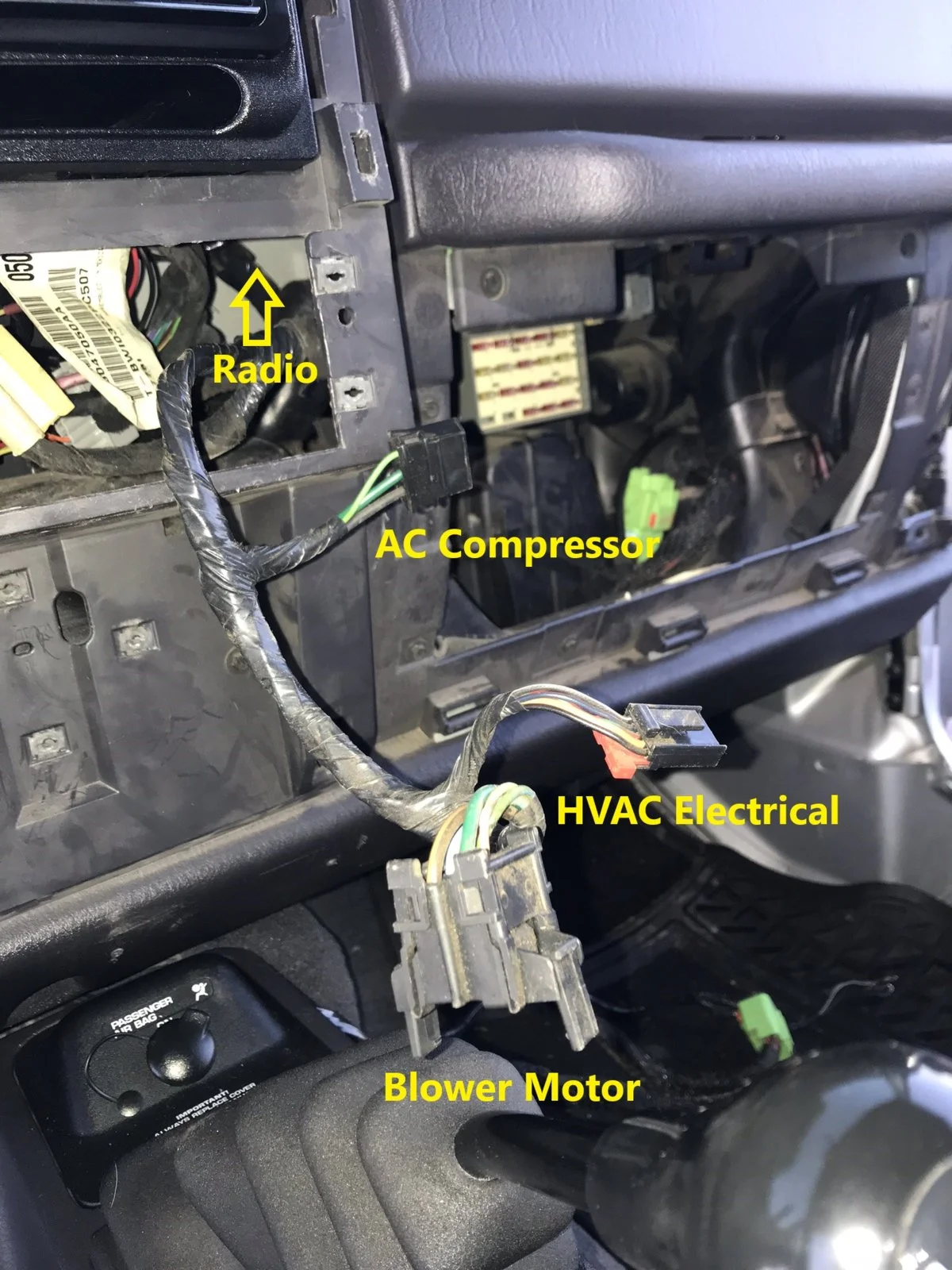

The only loose wiring you should be left with now are your HVAC, radio, and switch wires. Go ahead an pull these through the dash where you removed the old ones.
You will notice you have a couple extra plugs on this harness. In my case, these were just for the rear defrost and rear wiper switches. Pull these through the little hole below the left side of the HVAC cutout.
Go ahead and reattach your radio and HVAC plugs, and fasten the two units back into place. Remember that your vacuum lines are already attached to the HVAC unit.
Route your vacuum lines back down and behind where the glovebox would go, and plug it back into place. These lines hang freely and there is no clip to secure them into place.

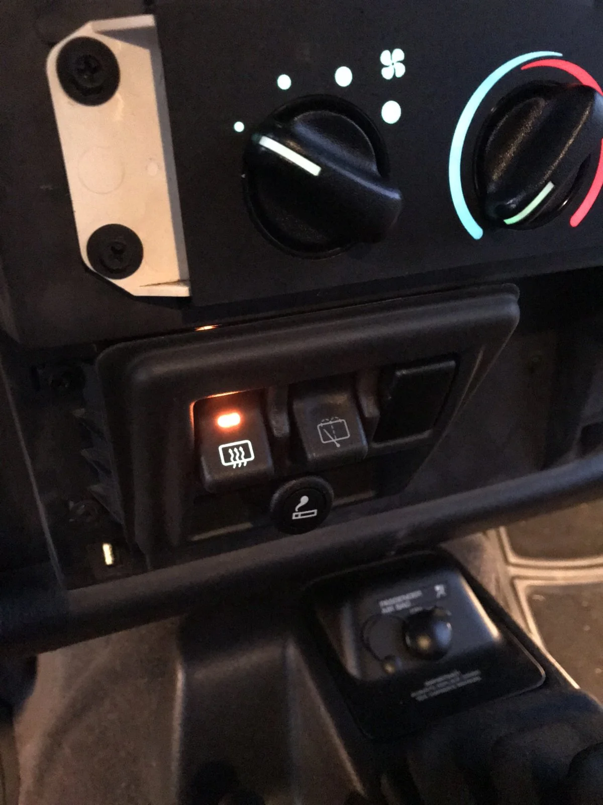

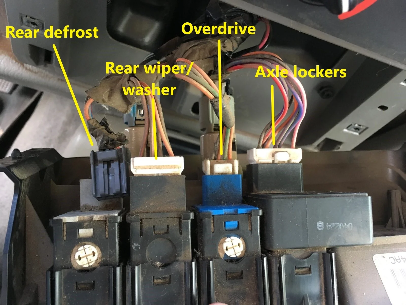

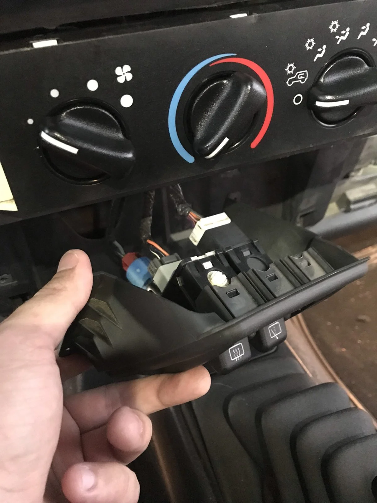

Grab your switch bezel and remove the the first two blanks. Insert your new (new to you) defrost switch in the left-most spot, and the rear wiper switch right next to it. Go ahead and plug them into place along with the cigarette lighter, then reattach the switch bezel.
At this point, your new harness should be entirely installed and fastened into place. Go ahead and reattach your battery to make sure all of your electrical components are working. Make sure the grounds below the speakers are secured tightly. If everything checks out, go ahead and put your dash back together!

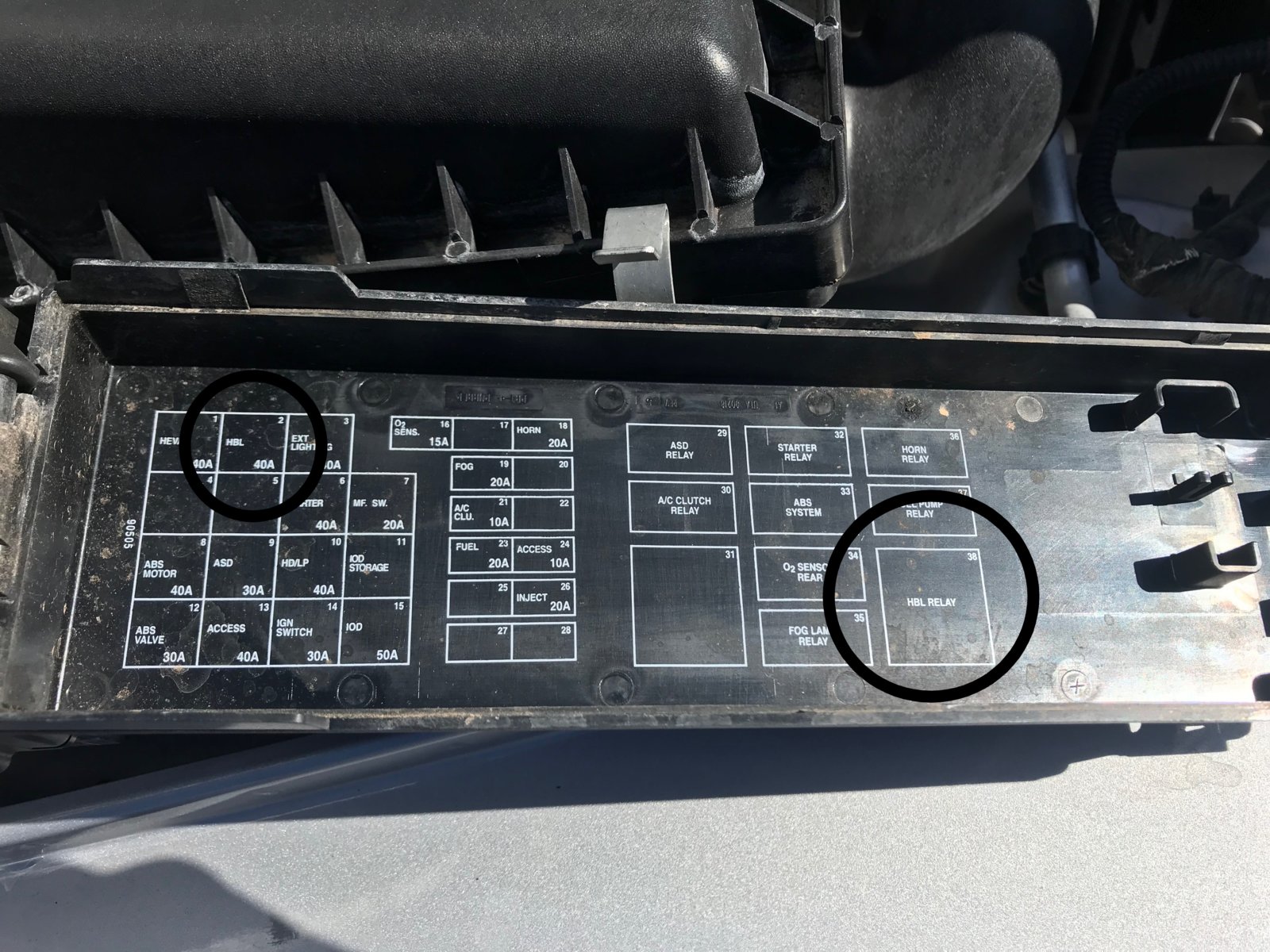

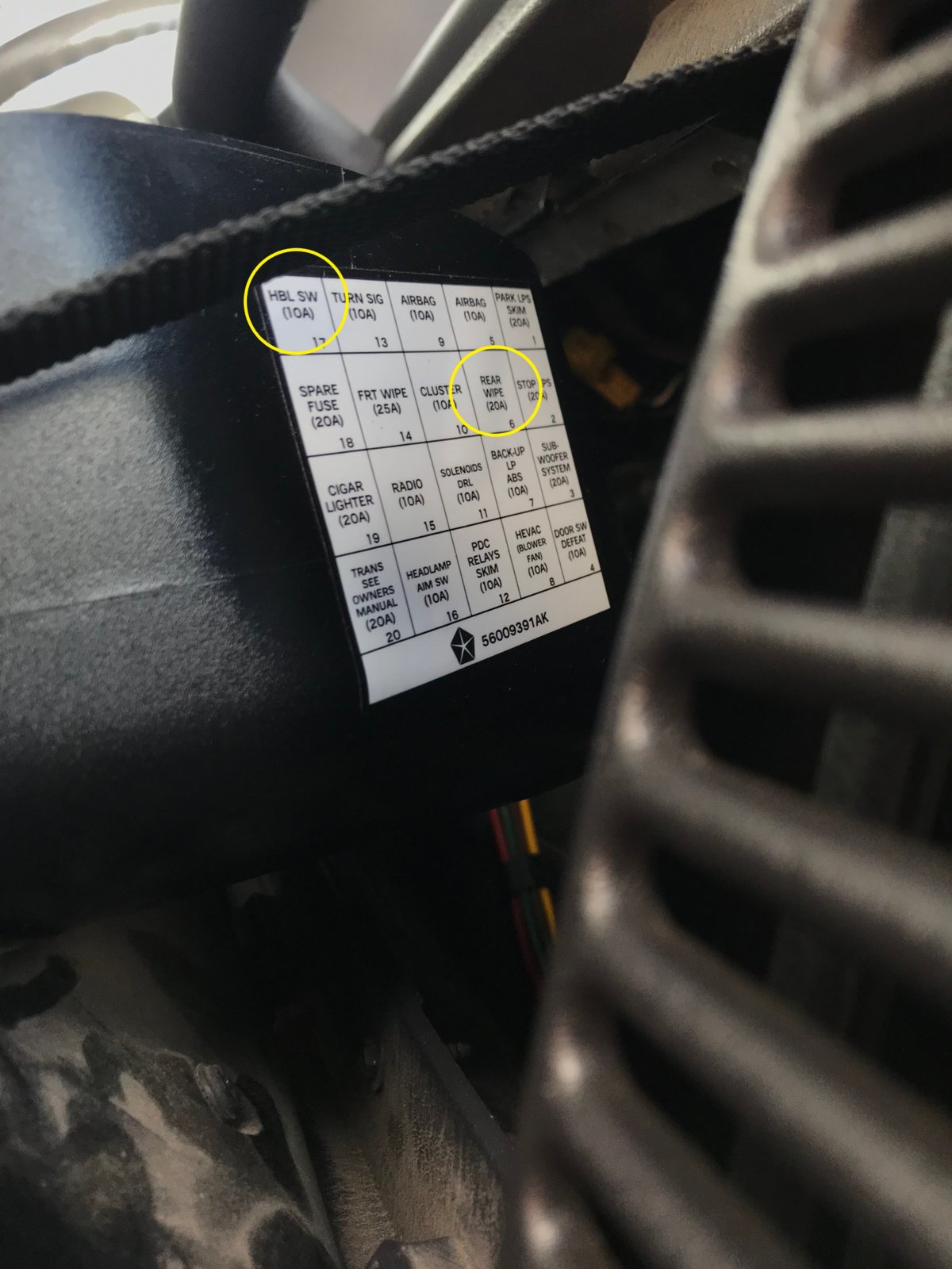

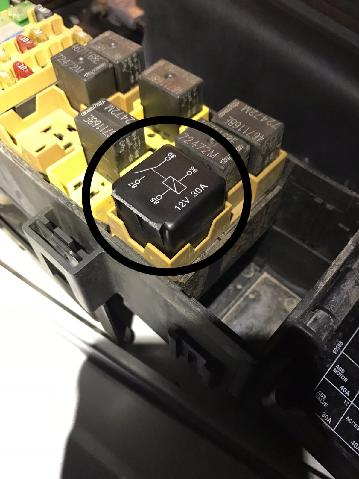

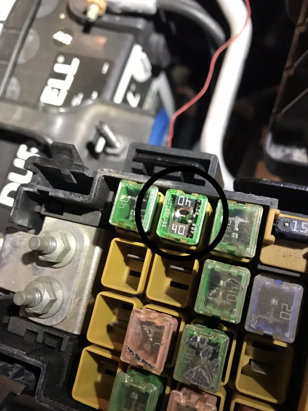

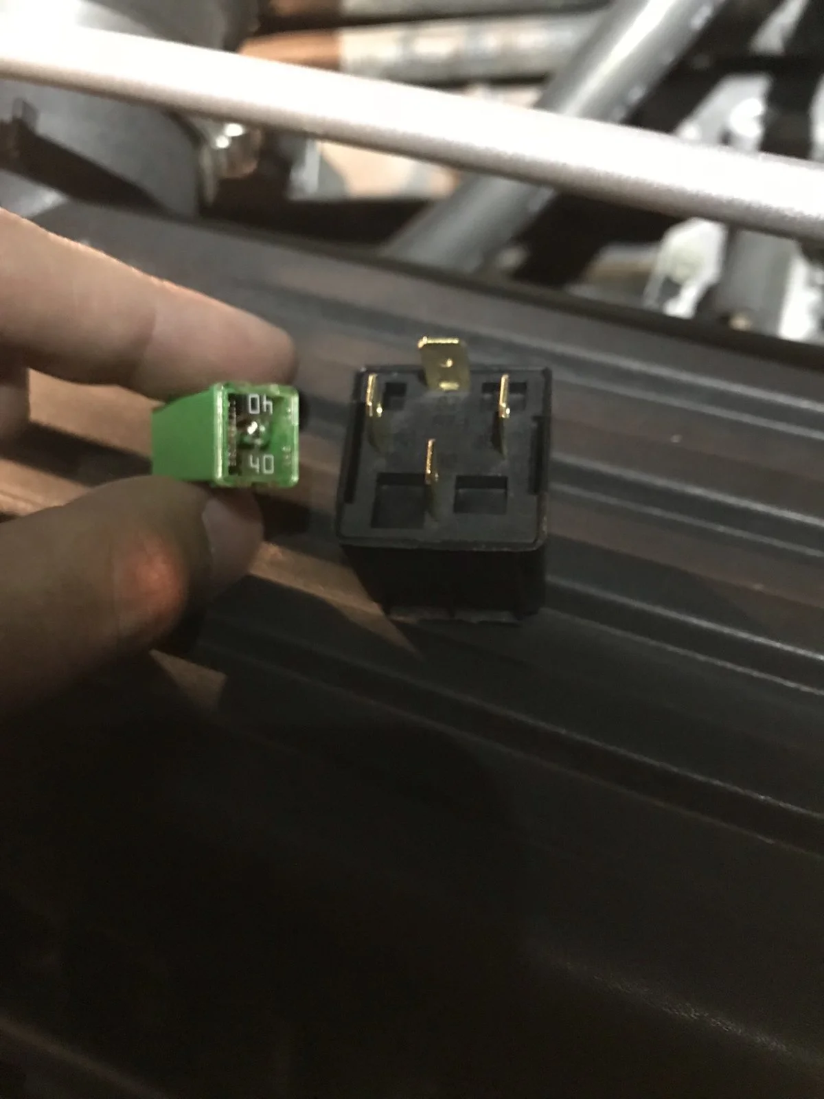

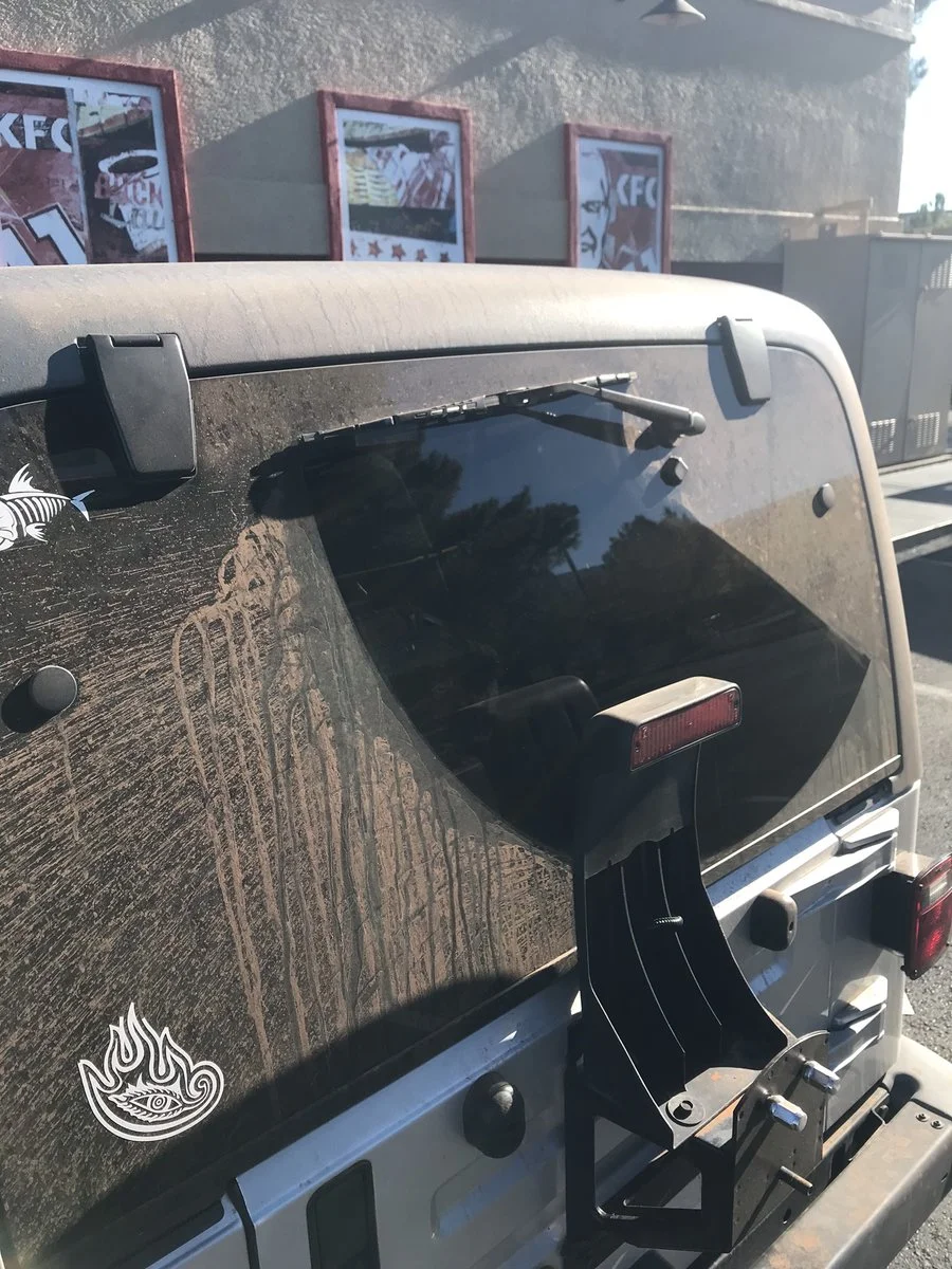

Last step to the dash conversion is installing the proper fuses in the fuse block and PDC. Different years had different style fuses and locations. Reference your fuse block and PDC diagrams for the correct spots. Rear defrost will be listed as HBL there is one spot for it in your fuse block, and two in your PDC. There is only one spot for the rear wiper and that's in the fuse block.
This is where you will need your 30A four-prong relay and the 40A maxi-fuse for the HBL in the PDC.
Insert them into the appropriate spots.
Now go check your finished product.
There's no way to test the wiper until the hardtop is plugged in. However you'll know if your HBL is working. Your HBL sends a signal to the IPC which has a timer built into it. When this timer is activated, it sends a signal to the relay in the PDC to open power to the rear defrost. This timer shuts off after ten minutes, and will run an additional five minutes if you hit the switch again. I heard the relay click when I hit the switch, and it clicked and shut off after exactly ten minutes. Hitting the switch again, it shut off after exactly five minutes. It works! My rear wiper switch was good too the light had just burnt out. If you've made it this far, you're all done!
