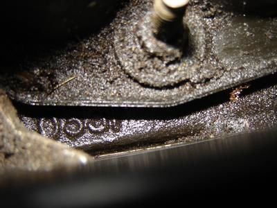

For the casting number, look on the driver's side of the head near the center, and you'll see a number peeking out from under the valve cover, like so:
Again, the original will have this number, and the replacements with the fixed deck will also have this number. The only way you won't see "0331" there is if someone has swapped in an earlier head.

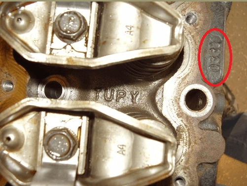

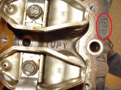

A TUPY head will have "TUPY" cast into it right there, like so:
