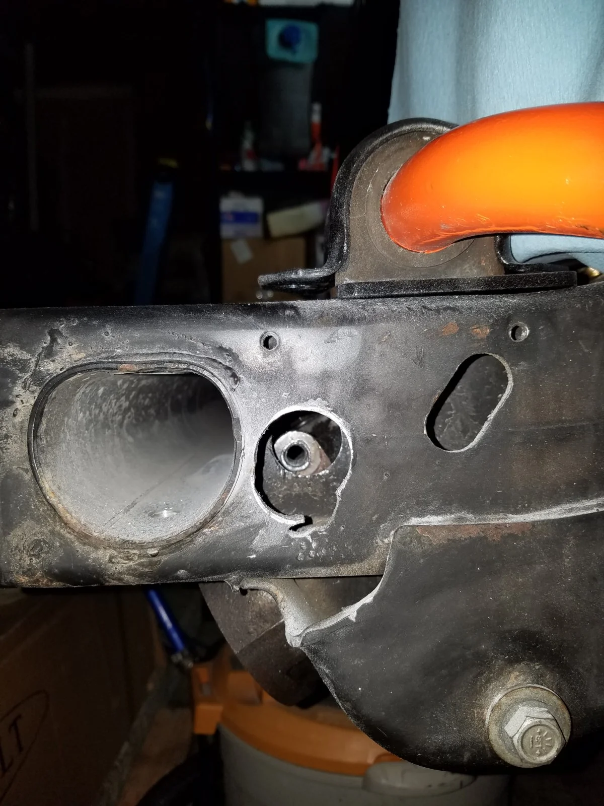

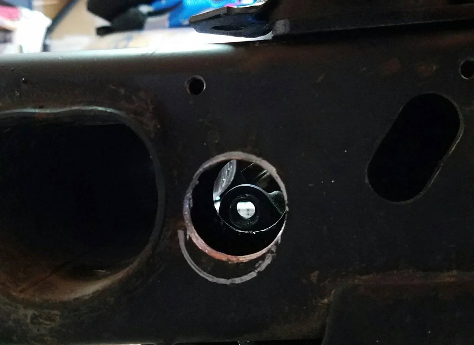

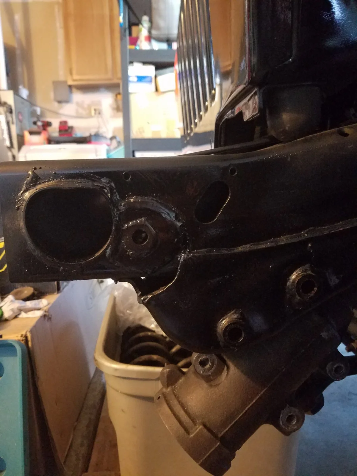

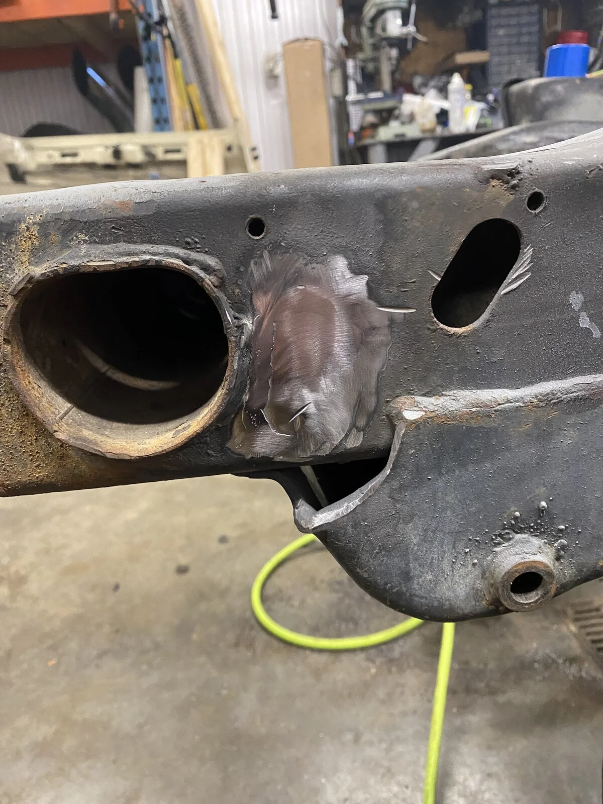

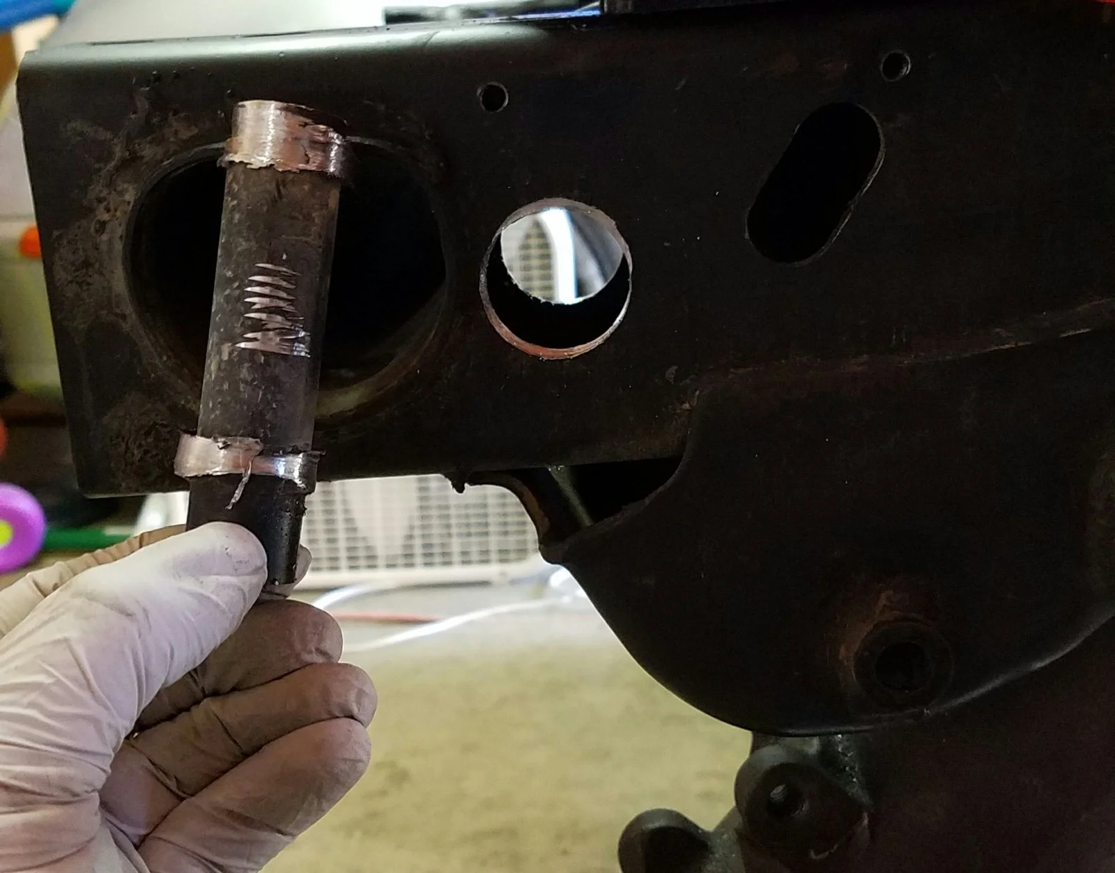

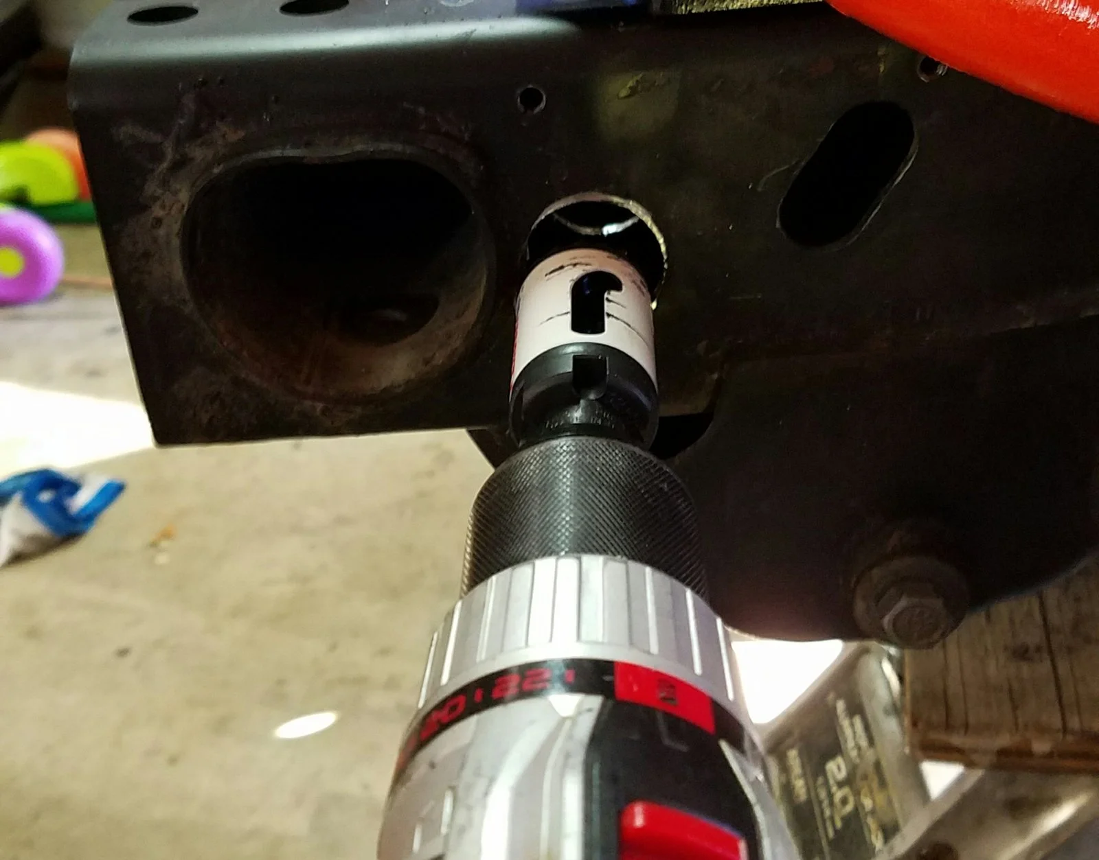

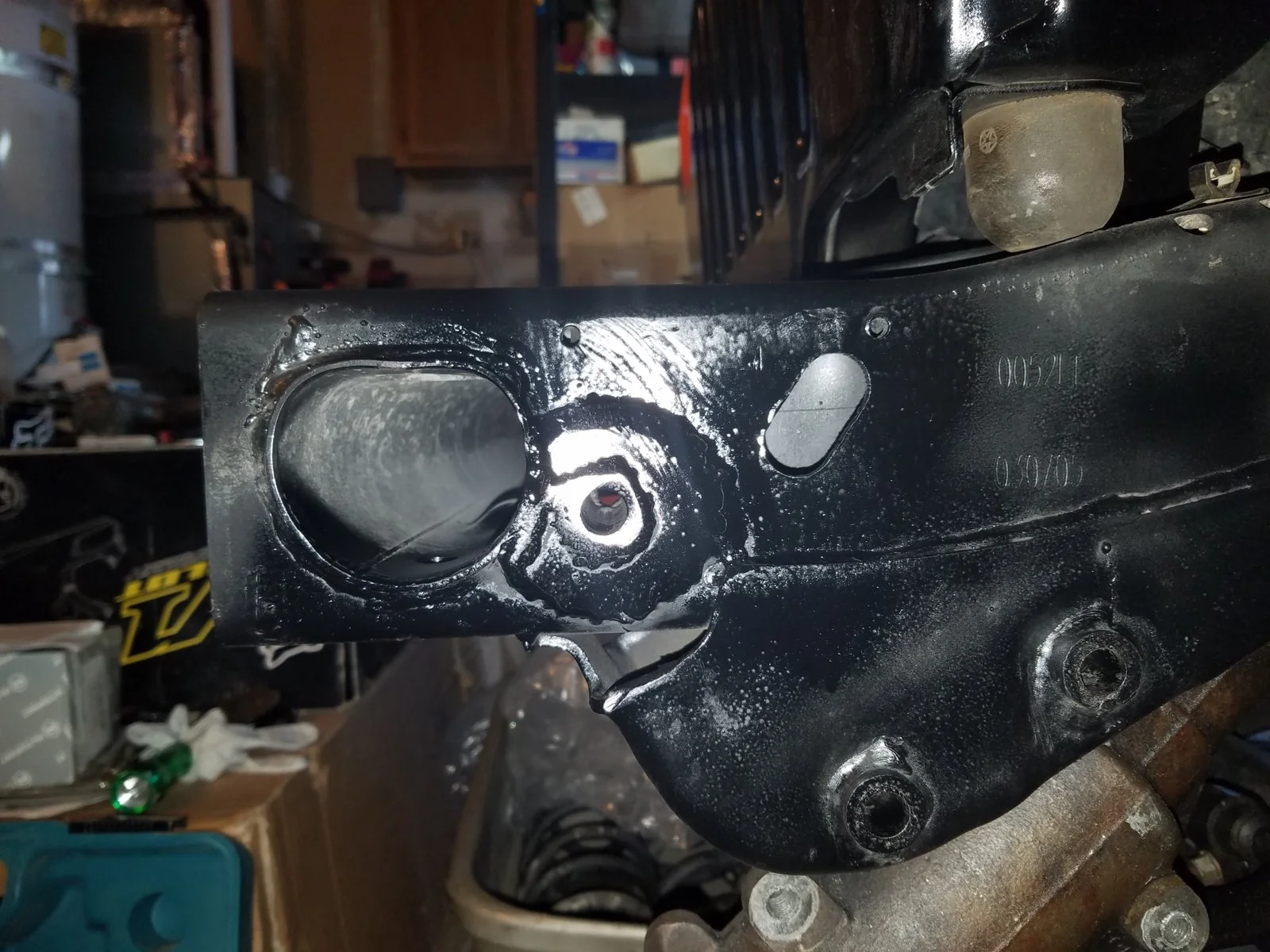

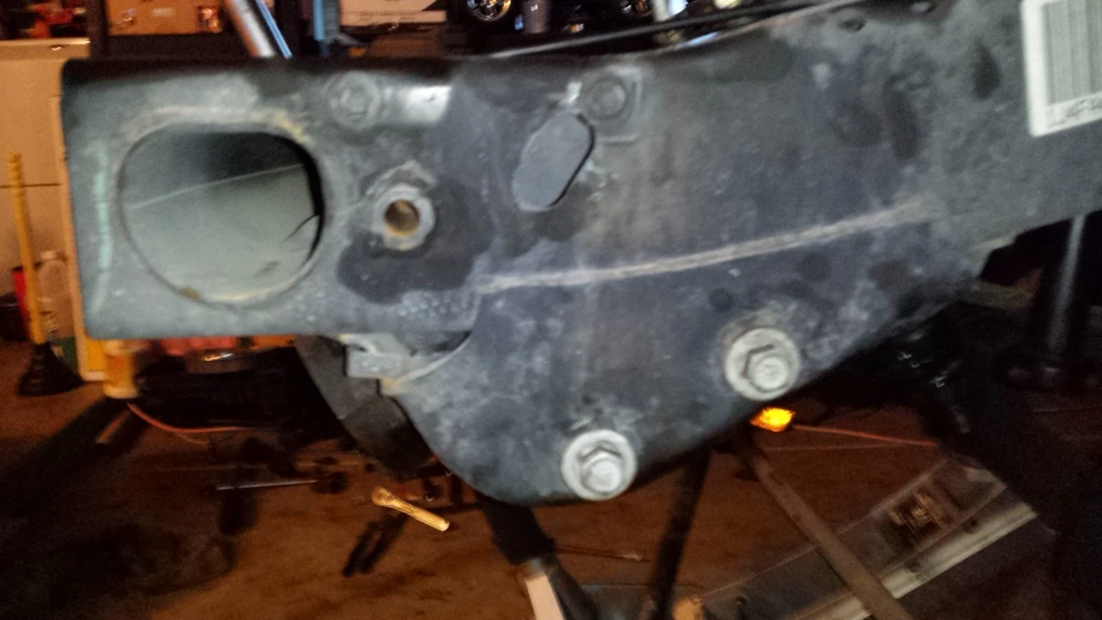

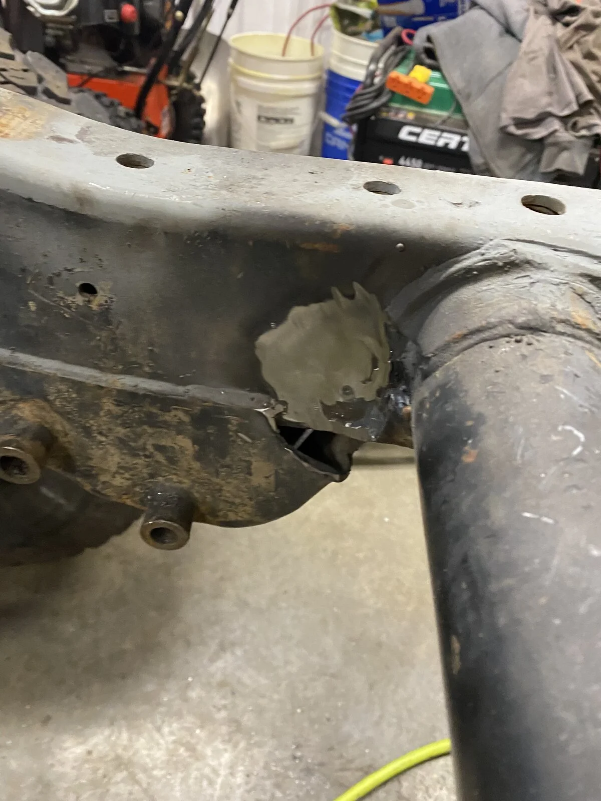

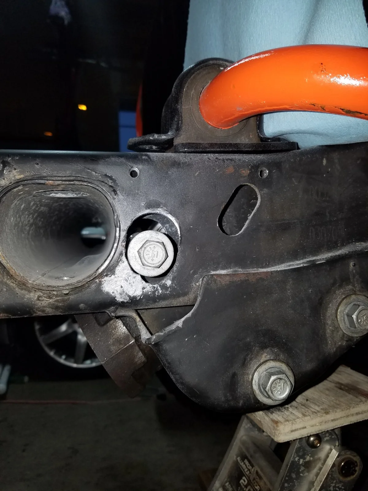

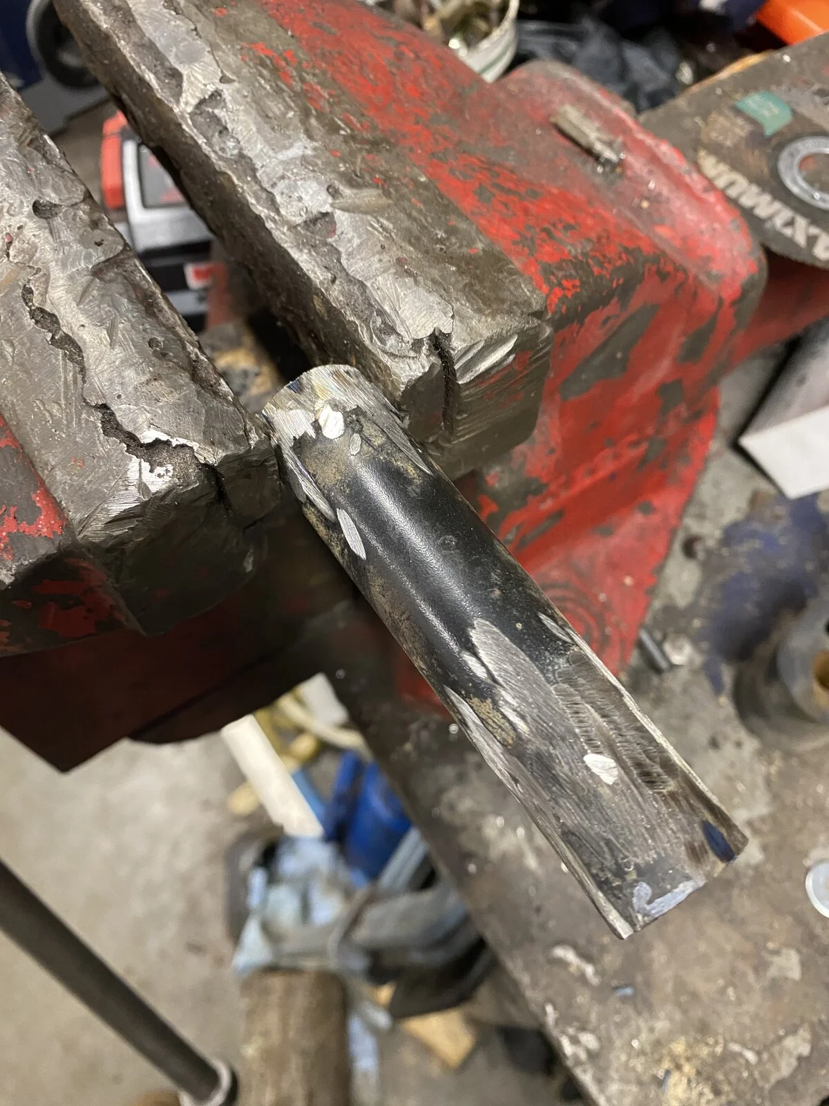

So, just to say a big thank you to jeepaholic to this post...i follow this procedure after a frame swap from a 1999 to a 2003. I drop some picture for any future help to someone else...
