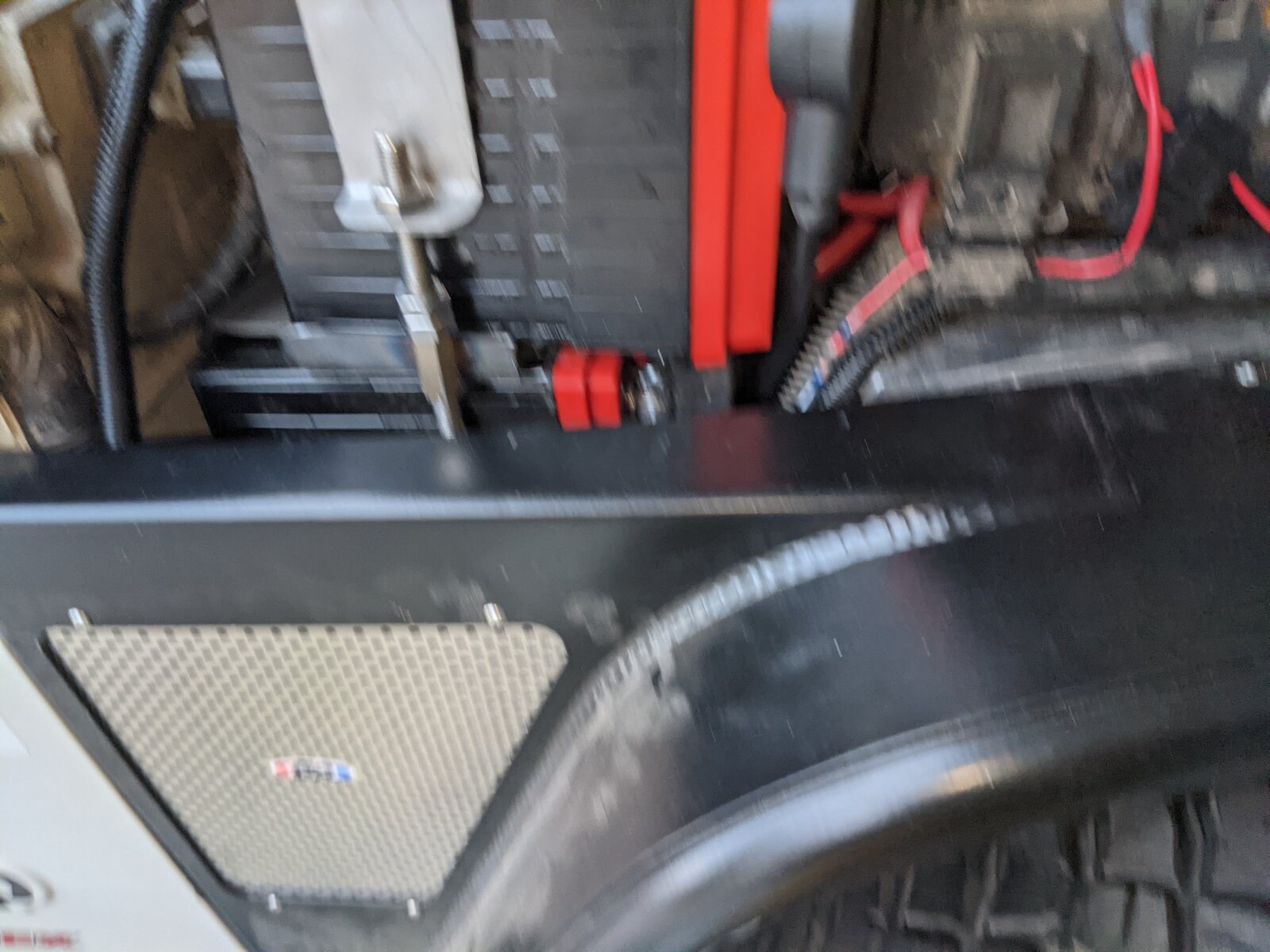

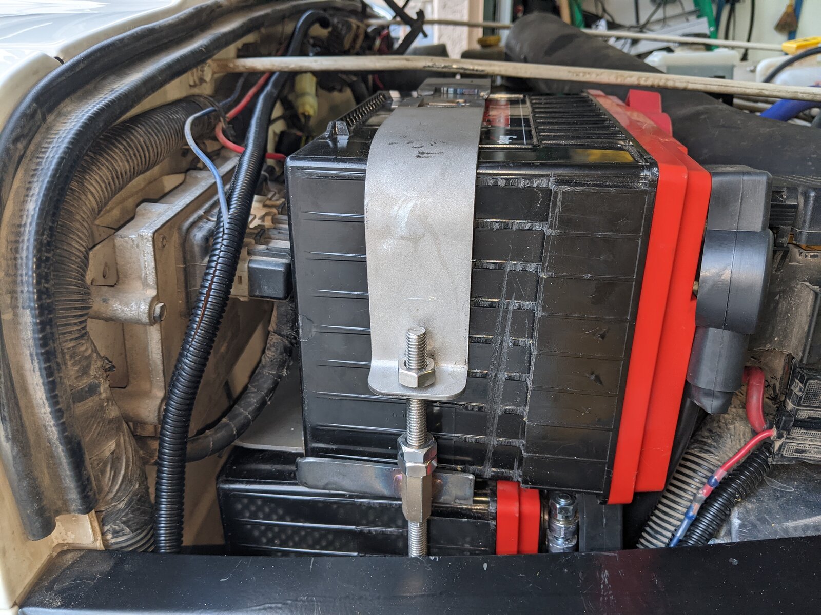

I went with Odyssey batteries and hacked up my Rugged Ridge dual battery tray to get them to fit. I have Genright fenders and inner fenders now so there's plenty of room but as you can imagine the trays aren't going to be all that pretty. As a welder I'm a great grinder. I'll post some pics after it's powdercoated so I can save a little embarrassment lol.
Well I got them both in but looks like I'll need to take it all back out and move the tray closer to the engine. I had just enough room when I was mocking it all up as I went but when it came time to actually tighten things down it's all a little higher than I thought and the hold down is hitting the hood. I have almost an inch I can go closer to the engine so it shouldn't be a big deal though the damn AC lines are going to be tight. The Genright fenders and inner fenders helped a lot.
Hacking up the tray for the Odyssey's wasn't all that hard though as I forewarned it's not going to be pretty. I had to trip the extra plastic on the Odyessy's too as the fins they put on the side are right where the threaded rods go.
What I don't get is the Painless instructions say to wire all your accessories to your primary battery including the winch and basically just leave the secondary sitting there as a backup. I would think you would want to run all the accessories off that one and have the primary just used for starting. I think a power block would be the best option as I have a power inverter and my air compressor wired directly to the primary battery and if I move the winch there too it's not going to be enough room. Anyone have a recommendation for a water tight power block?
Reactions: ac_ and reddvltj

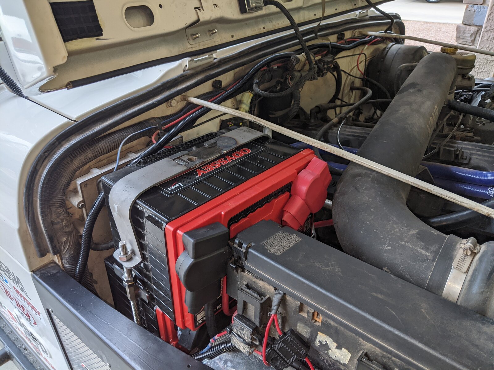

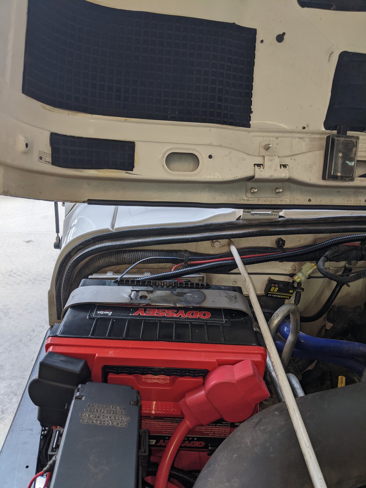

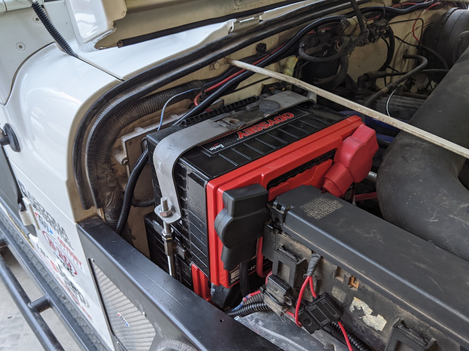

Pics of the install.
That is awesome. I love good hacks! I am glad I was able to help with this project. It looks great!!
