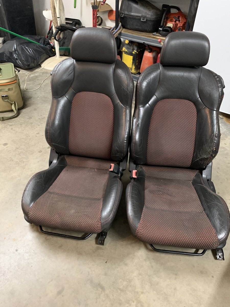

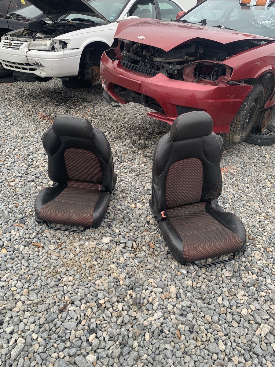

Finally got to the pick n pull today. There are only two pick n pulls in my area. Only 3 Tiburons total in both yards.

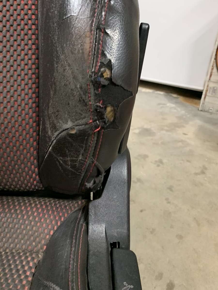

One had already lost its seats. One had full leather! But the drivers seat was shot. Completely torn up.
Then the red 2005. They came home with me. They are a lil rough but hopefully I can find a cheap seat cover.
Very comfortable. Install pics to come. I may be asking some questions.
Anyway... here’s the pics.
Edit- Cost me $75 even out the door. Can’t beat it!
Anyway... here’s the pics. View attachment 131974View attachment 131975View attachment 131976View attachment 131977
Those are nice. I like the fabric inserts and they're pretty tough. You're going to like the "comfort". I wouldn't let the roughness bother you. If you find something you like better in the years ahead another $75 will seem cheap.

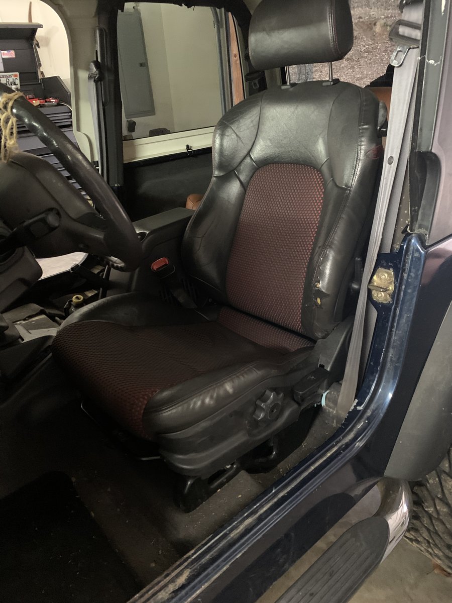

Drivers seat is in. Passenger seat needs final mock up
$75 for 2005 Tiburon seats from pick in pull
$50 for 16 ft of flat bar, nuts/bolts
$30 for new chop saw blade and drills bits
$155 total for Tiburon seat install
Cross pieces cut to 18” for the front and back of the seat
Pieces bolted to the base are 16”
I took both the front bracket and rear bracket off the tiburon slider. Makes the seat sit lower. Maybe too much so.
I used a plumb-Bob off the steering wheel to its center. Matched that to the center of the seat. This let me know where the final positioning would be.
Big thankS to @PCO6 for showing us the way.

Passenger seat is in.
This one was tougher. I had to use spacers to clear the fold forward bracket on the passenger side
I kinda cheated because I broke out the welder. I could have gone the no weld route but this was just easier.
As you can see from the pics the seat still folds forward to allow Rear seat passengers to ingress and egress.
I am very pleased with the seats and how they feel and function.
Oh and I sold my old seats for $100 so I’m officially $55 into this swap. $25 if you don’t count consumables like cut off wheels and drill bits.
