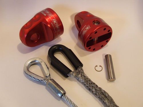

I have a factor on mine and it has a small locking ring you remove to take the pin out. you put the loop of your winch line in, slide the pin back in and replace the lock snap ring

Okay, so I looked into this and it appears there is two different installation methods here depending on which safety thimble you have.
The Factor 55 safety thimble has a backend that accepts the factory eyelet / ring on the end of most winch ropes. Therefore you the install is easy just like show above in the video @Serbonze posted.
However, if you have a TRE safety thimble (and correct me if I am wrong @Garza) you aren't so fortunate when it comes to a simple install (okay, maybe it's not that hard, but if you're like me and don't know much about tying knots then it would suck). It looks like the TRE safety thimble won't accept the factory eyelet / ring on most winch ropes so you have to remove it similar to these instructions in the attached PDF.

Actually installing the Safety Thimble is quite easy and an invaluable skill should you ever need to make a repair splice of your rope on the trail. I include fids with every Safety Thimble or rope/thimble order to help the install. The method is simply called a buried tail eye splice.
The original Safety Thimble 2 we manufacturer has been in use for over 10 years. We consider it to be the strongest and safest method. We are opposed to introducing failure points along your rigging like a shear pin while also not ignoring the 1st and foremost rule of vehicle recovery/rigging which is minimal attachment points create the strongest and safest connection!

I apologize for not answering the direct question....absolutely you can use it on your existing rope! The method used to attach most of the standard eye thimbles is called a Brummel eye splice. I install many of our Safety Thimble's in place of these for our customers and simply undo or cut out the Brummel splice. I should mention one Huge mistake I see commonly made when using a hook or other "bolt-on" thimble with a standard eye thimble. People don't pay attention to what that steel eye thimble is doing to the fairlead surface when it travels in and out of the fairlead. This damages the smooth surface of your fairlead where your expensive synthetic rope travels. Essentially damaging the rope or abrading it enough to cause possible failure. For those that always store the rope end accessory on a d-ring or hook away from the fairlead...this isn't as big an issue but something to consider. You will never have this problem with the Safety Thimble 2!
