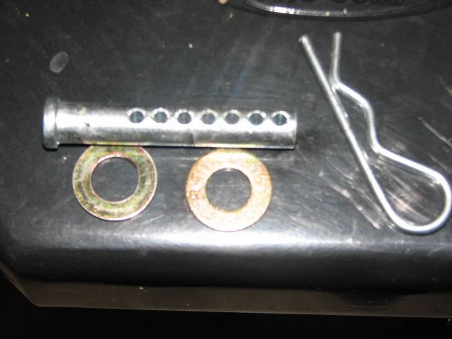

Parts you'll need:
2-1/2"x7/16" Clevis Pins (2)
Cotter Pin (2)
7/16" Grade 5 or better washers (4)
You can get these parts at ACE Hardware. Just make sure to get the highest grade you can, Grade 5, but preferably Grade 8.
Here's a photo of the parts you'll be purchasing:

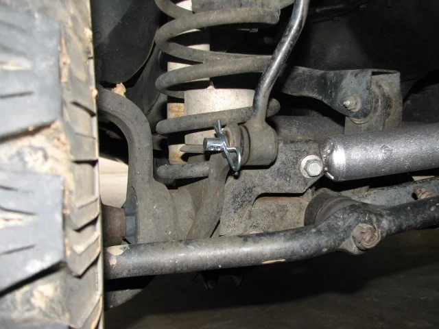

Once installed, they'll look like this:

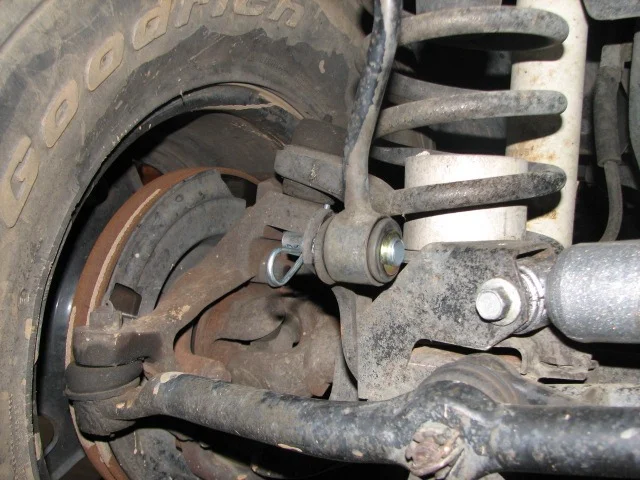

Here's another shot too:
All you're doing there is removing the torx bolts that connect the stock sway bar links to the sway bar. Once that's done, you're replacing them with the clevis pins. That will allow you to easily slide the clevis pins out (once you remove the cotter pin) on the trail, therefore disconnecting your sway bars.

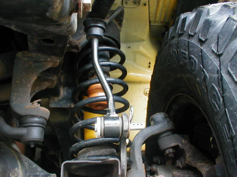

My DIY disconnects had the pin bolted securely to the axle mount and allowed the sway bar to mostly do its job while connected.
