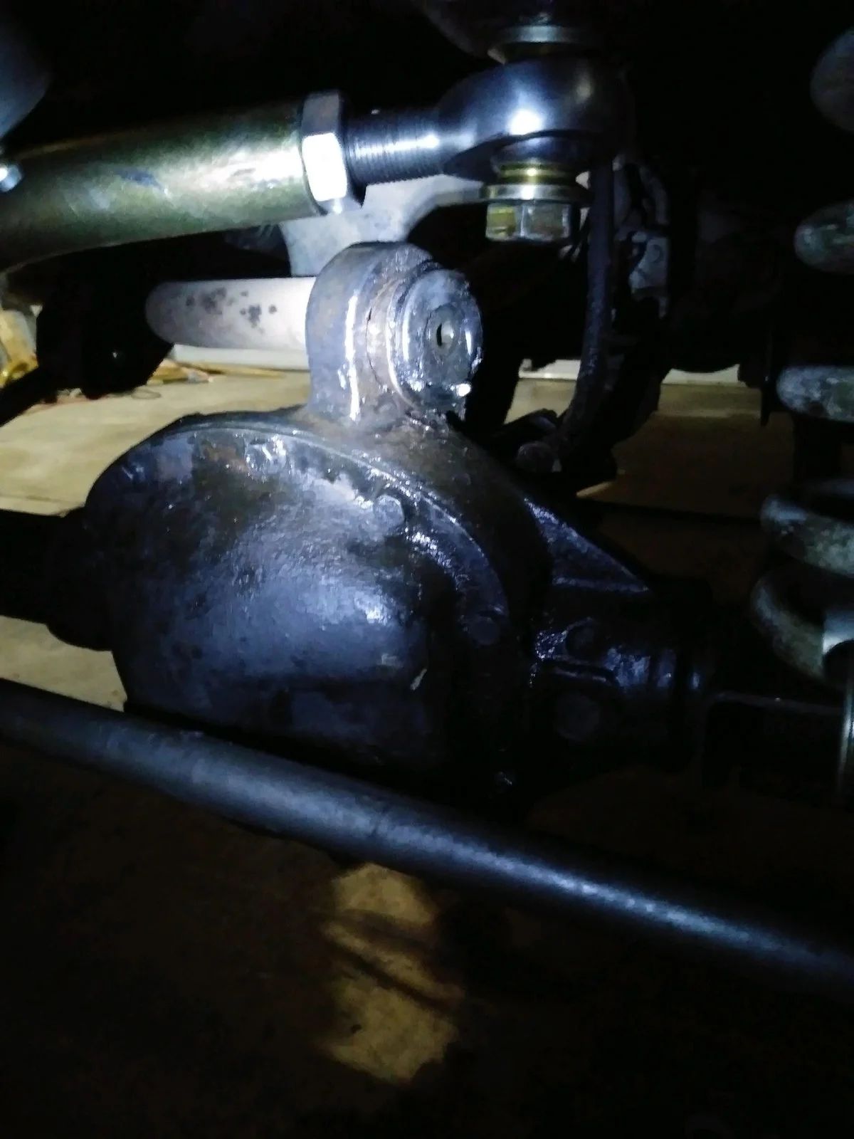

as the title states. what is the best/ easiest way you gurus have found to press out the old upper control arm bushing on top of the differential (driver side). i have tried PB blaster and heat combined with a ball joint press but no dice! figured i might as well put a new one in since im installing my curried kit! any help would be greatly appreciated.
Thanks!
picture for clarification
The easiest way is an actual press... the stand up kind you see in most shops. Without that, could you just take a reciprocating saw (sawzall) to it and cut it out?
Last one I replaced I drilled a bunch of holes in the rubber until it could be knocked out, then a hammer and chisel to deform the sleeve until it came out. Pita but it worked.
i soaked the bushing in pb blaster last night. will see if i can press it out one last time before attempting the sawzall method. thanks guys!

thanks all who replied. was able to use a saw zall with a diablo rescue blade to cut the protruding side of the bushing in half. this helped me push out the center support and then went to town with a baby sledge and a socket to push out the rest of the bushing! was a little time consuming but i got er done. thanks for all the suggestions
