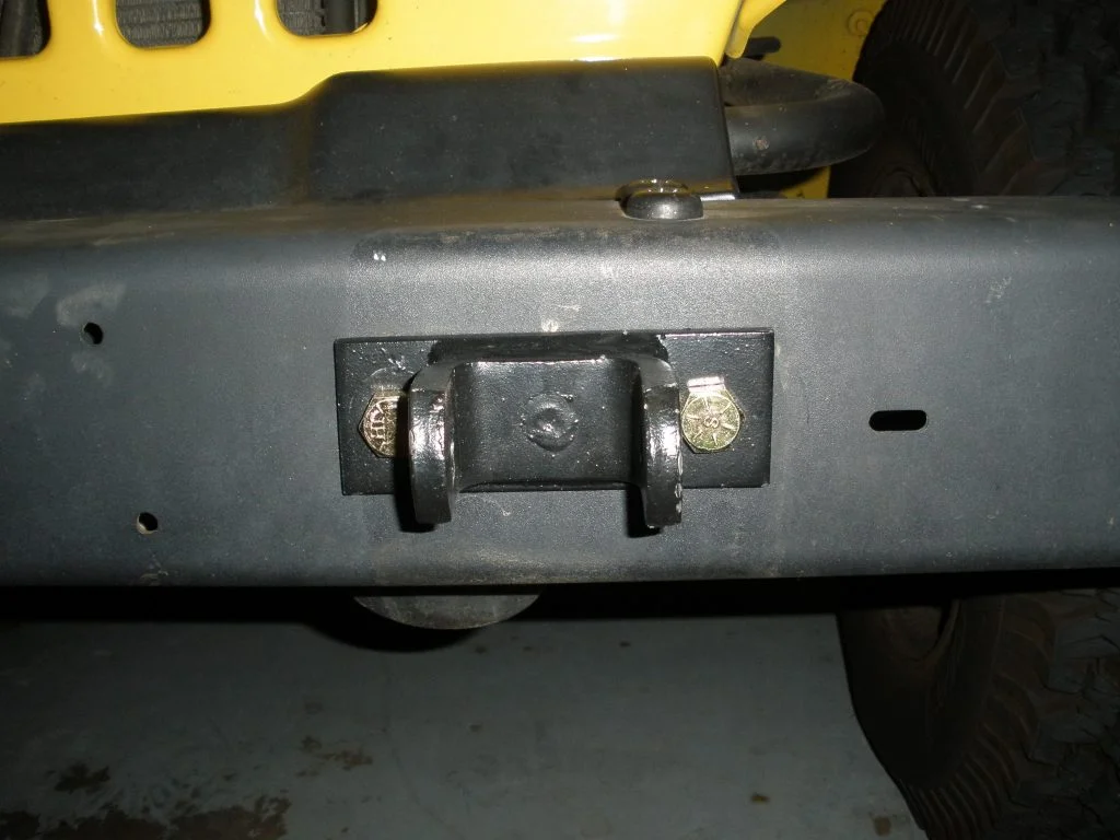

I use simple trailer spring shackles. Mount goes into sub frame, bumperettes get moved outboard into new holes.
Cheap & effective!

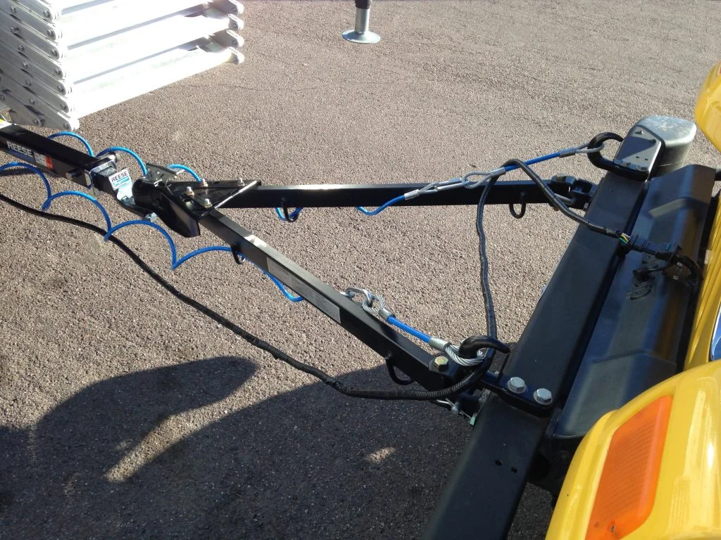

I run one when towing my TJ, which you can see in the first pic.

One of the great things about owning a truck camper is the ability to tow things like boats, trailers, and Jeeps. With several trips planned for the winter and spring, getting our 2004 Jeep Wrangler rigged for towing was a high priority for us. These preparations included the installation of electrical wiring for the Jeep’s tail lights, purchasing a Class III adjustable tow bar, mounting the tow bar brackets and safety hooks to the Jeep’s OEM front bumper, and purchasing an 18-inch-long hitch box extension for my Ford F-250.
After researching this topic, I decided to tow the Jeep flat or “four down.” It wasn’t a hard decision, actually. The Jeep Wrangler is built to be towed four down and is one of the few vehicles built to be able to do this (I considered buying a small trailer to tow the Jeep, but I didn’t want to deal with the additional tongue weight as I’m 200 pounds over my GVWR already with a fully loaded truck camper). A tow bar is the main piece of hardware that you need to tow four down. After looking at numerous tow bars, I decided to buy a simple Reese Class III adjustable tow bar
View attachment 7109 for around $110. I could’ve spent $700 for a fancy Blue Ox, but why? My Reese tow bar is rated to tow 5,000 pounds, which is more than stout enough to tow my 3,450 pound TJ.

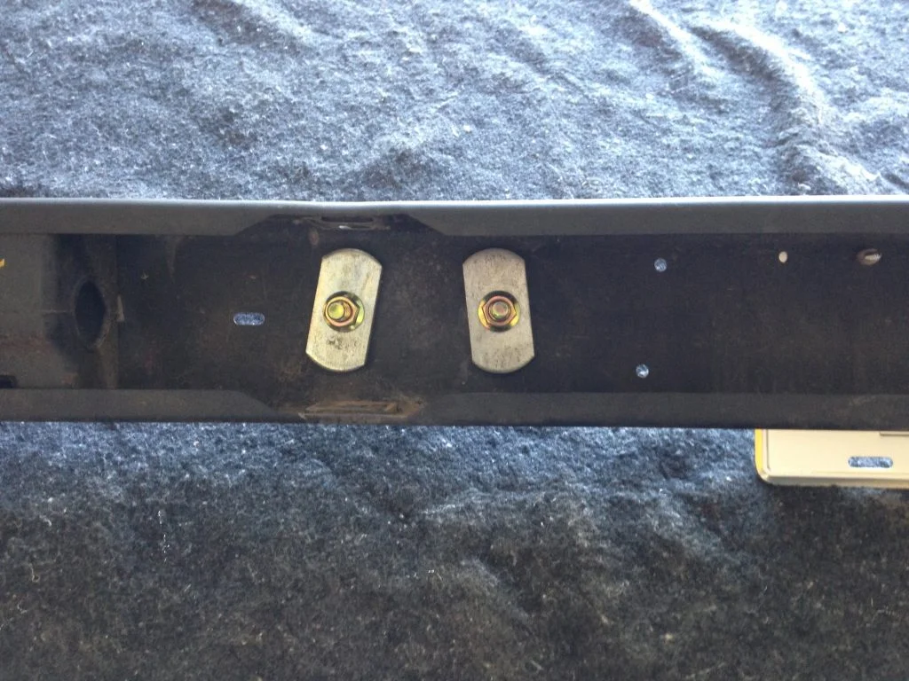

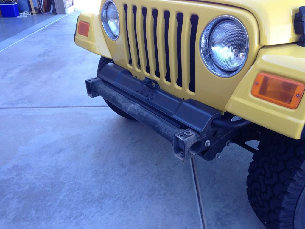

Installing the tow bar brackets on my Jeep’s OEM bumper was pretty simple. First, the bumper had to be unbolted from the Jeep using a T-55 torx fitting. Before installing the brackets you’ll first need to remove the two bumper pads from the bumper (if you’re lucky, like me, you’ll be able to use the existing bumper pad holes for the tow bar brackets). The installation instructions state that the tow bar brackets should be mounted between 24 and 41 inches apart on the bumper and mine are centered about 35 inches apart–perfect! Some TJ owners question the strength of the 1/8 inch thick bumper and its ability to support bolted tow brackets and withstand the forces that will be exerted against them. That’s a valid question and one I had, too. No, the bumper metal isn’t very stout, but if you reinforce the backside of the bumper with support plates, such as the ones that were included in my tow bar kit, you’ll be fine. Many TJ owners who have gone this route over the years have towed for thousands of miles with zero problems.
Backside of bumper showing the backing plates.
Bumper mount with bumper removed.
Close up of an installed tow bar bracket.

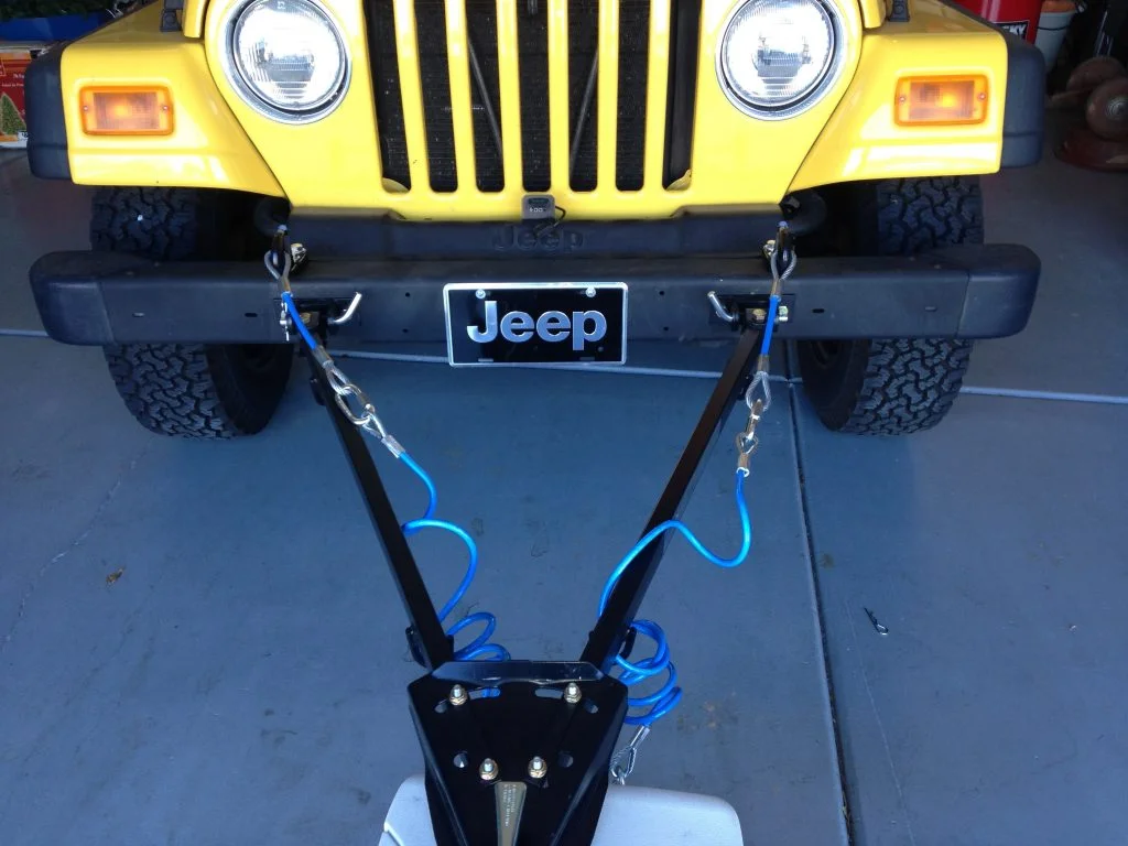

Safety Chains

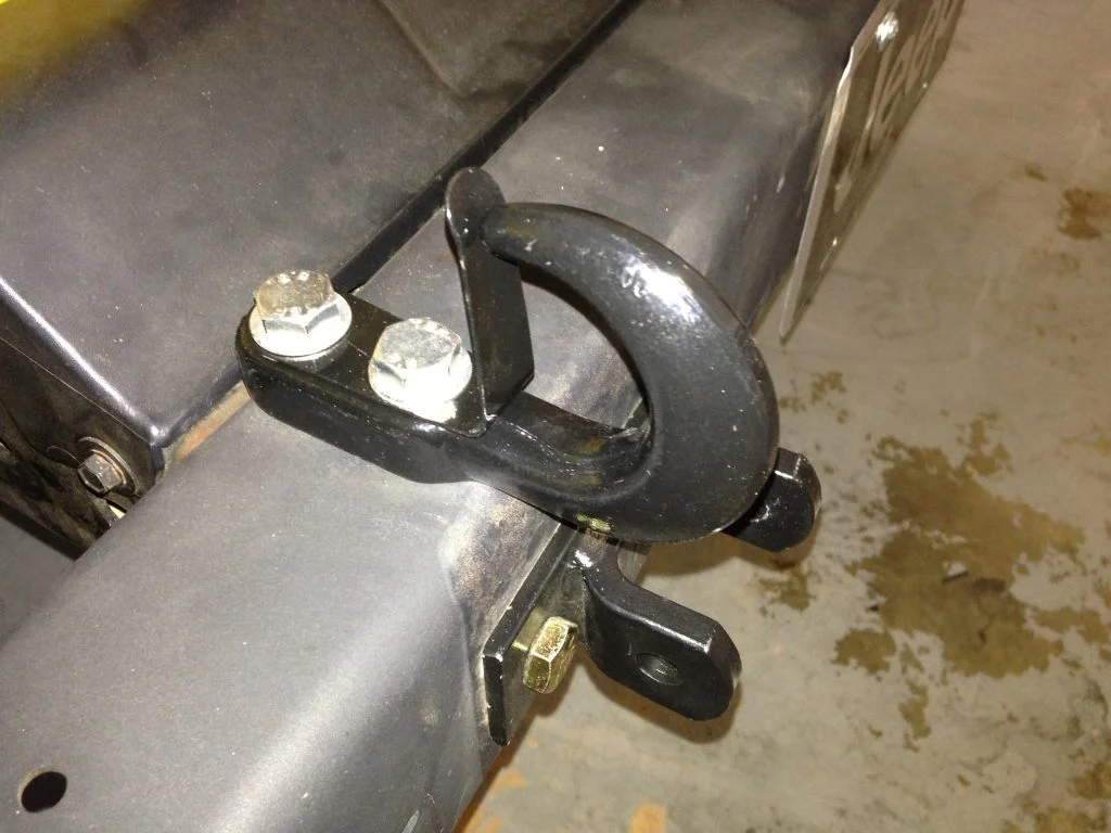

Having just a tow bar isn’t enough when flat towing–safety chains are also needed as an emergency backup in the event that the tow bar or hitch fails while in-motion. In order to use safety chains, I needed two attachment points on the Jeep. These can either be tow hooks or D-rings. Unfortunately, my Jeep had neither, so I had to find something that was suitable that bolted to the Jeep’s frame. Fortunately, a pair of Curt tow hooks can be purchased for $7.99 at Harbor Freight that mount directly to the top of the bumper (see pic below). Rated for 10,000 pounds these hooks are pretty beefy and also include a retainer clip. You can also purchase Curt Tow Hooks on Amazon.com. In addition to towing, these hooks can also be used for recovery in the event that you ever get stuck while off-roading. Getting stuck is something that happens to every Jeeper, eventually, so having a good set of tow hooks provides extra peace of mind.
The Curt tow hook installed on OEM bumper.
Tow bar and safety chains hooked up.

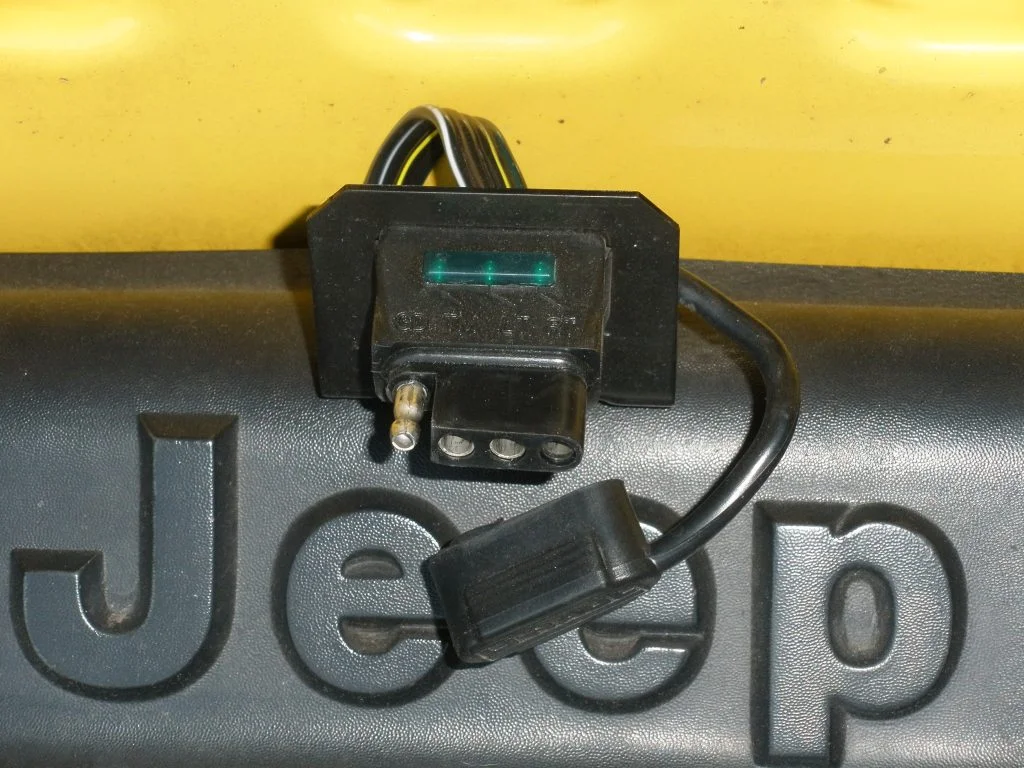

Towing Lights
You can go two ways to meet this legal requirement: buy a set of removable tail lights–the quickest and cheapest option–or permanently tap into the Jeep’s tail light wiring using a hard-wire diode kit. I chose to go with the latter as I wanted a more permanent, “hidden” solution. What’s the purpose of the diodes? They prevent the truck’s electrical impulses from being back-fed and causing damage to the Jeep’s electrical components. I do have one recommendation when hard-wiring: make sure that the wire run through the Jeep’s engine compartment is protected with flex tubing as this area can get pretty hot during vehicle operation. I should also point out that the common four-wire system is used for towing lights. As for the length of my umbilical (the cord that connects the Jeep to the truck), mine is 80 inches long and is protected with flex tubing wrapped in insulating tape.
The mounted 4-wire electrical interface plug.

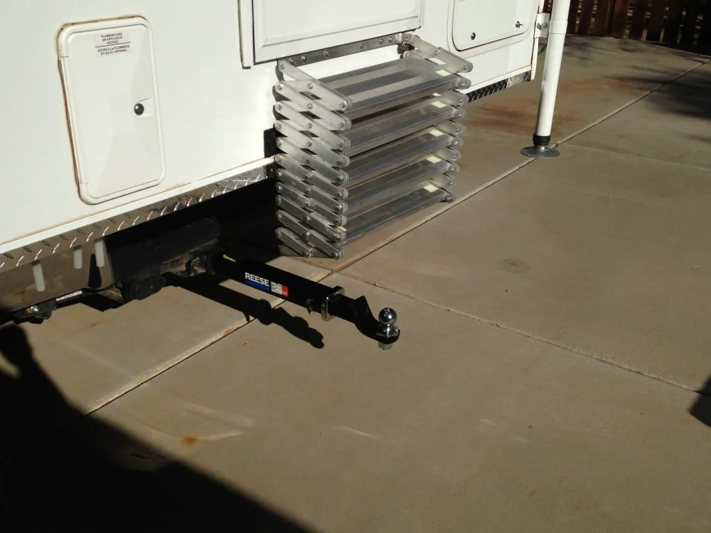

Hitch Box Extension
This piece of towing hardware isn’t needed in all cases, but it was for me as I usually tow with a truck camper which extends two feet beyond the rear bumper. I decided on an Reese 18 inch long hitch box extensionView attachment 7117. With both the hitch and extension installed, the total length from the rear bumper to the hitch ball is 26 inches. Along with the tow bar’s length of 41 inches, this provides me with the required amount of clearance between the Jeep and camper even on sharp turns. Here are a couple tips when choosing your hitch box extension and hitch. First, if you need an extension with a length greater than 40 inches, you’ll want to make sure that the extension has support chains to prevent side-to-side movement (this may require that a special plate be welded to the extension to accomplish this). For the hitch itself, you’ll want to make sure that the hitch ball is the correct size and that the shank is large enough to support the weight of your Jeep. You’ll also want to ensure that your tow bar is fairly level when hitched up, especially if a supplemental braking system isn’t being used. Doing so will improve handling and stopping.
The Reese Hitch Box Extension and Hitch.
Close-up view of the Jeep Wrangler flat tow hitch set-up.
Safety Chains

Hitch Box Extension
