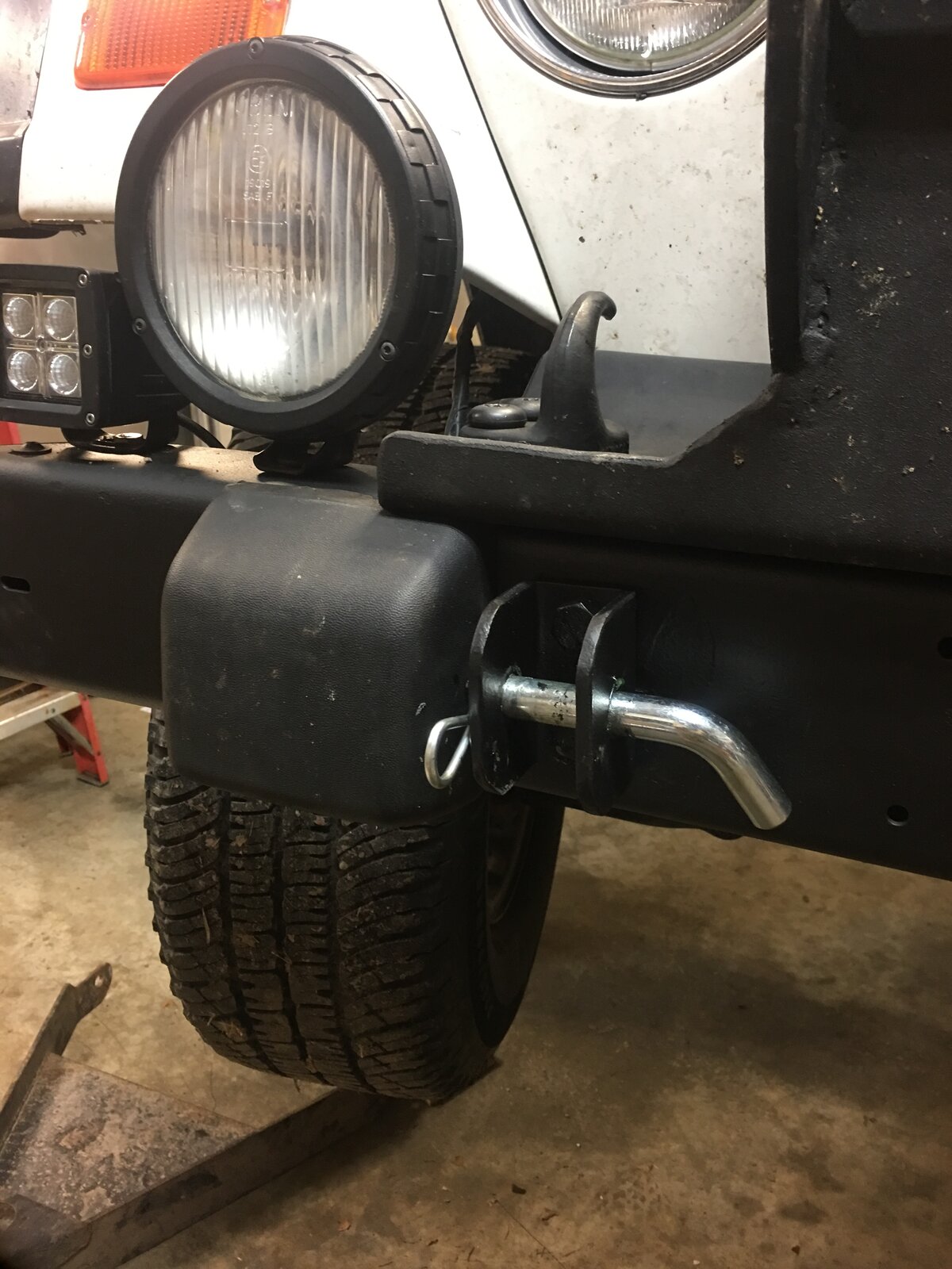

I use simple trailer spring shackles. Mount goes into sub frame, bumperettes get moved outboard into new holes.
Cheap & effective!

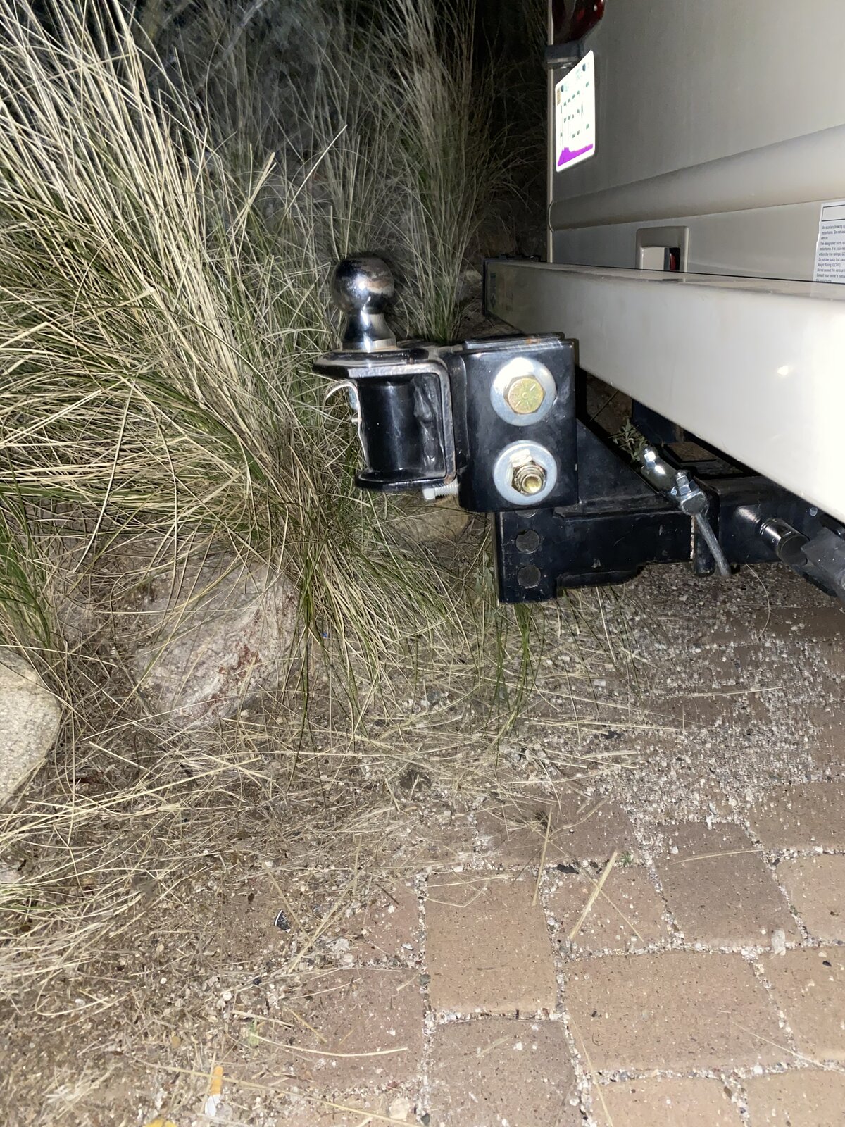

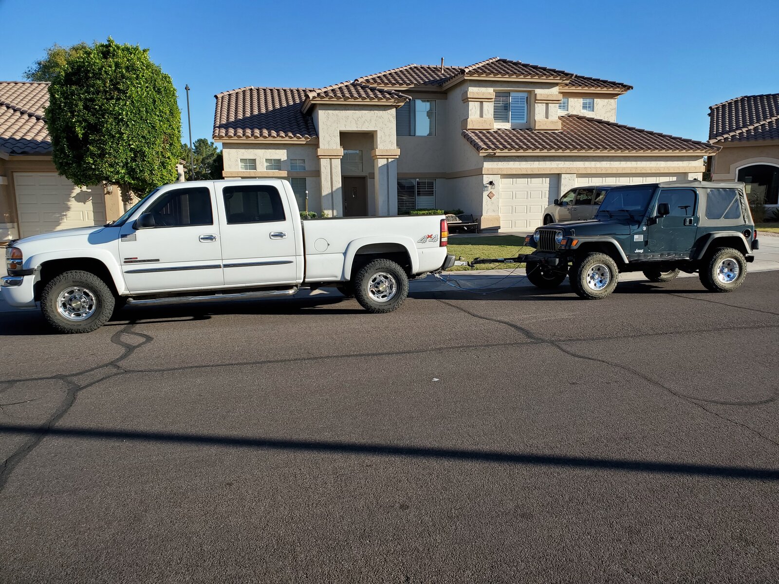

Just got TJ towing. Thank you! I followed advice to the T. Huge help. Question: am I doing something stupid? Manufacture of Hitch says flipping upside down is Okay. But… just seems wrong. If incorrect how do you tow with 3” lift and keep your tow bar level. Or is level tow bar a secondary concern?
that looks like a weigh distribution hitch head, not needed for flat towing
Tow bar should be as close to level as possible, no more than 2" off. You're fine using what you have there. If it doesn't get you close enough to level, grab a drop hitch that fits your specific need. Here's just one example.

Perfect. In this hitch configuration, the tow bar is dead level. Thanks for confirming.

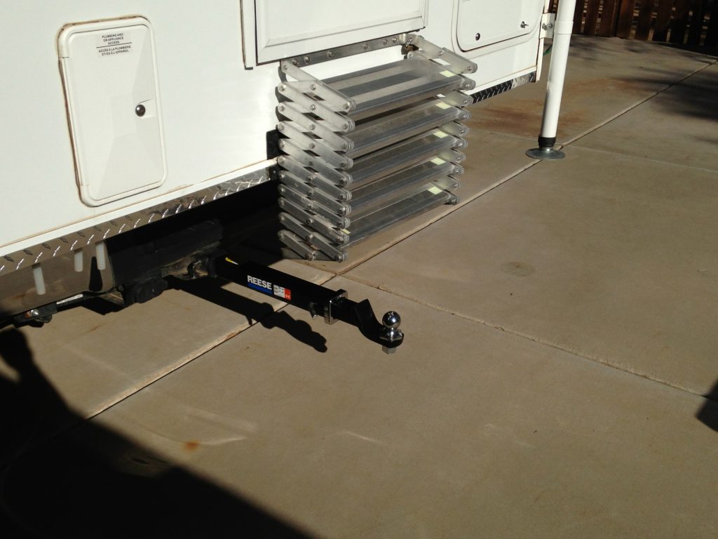

View attachment 7109 for around $110. I could’ve spent $700 for a fancy Blue Ox, but why? My Reese tow bar is rated to tow 5,000 pounds, which is more than stout enough to tow my 3,450 pound TJ.

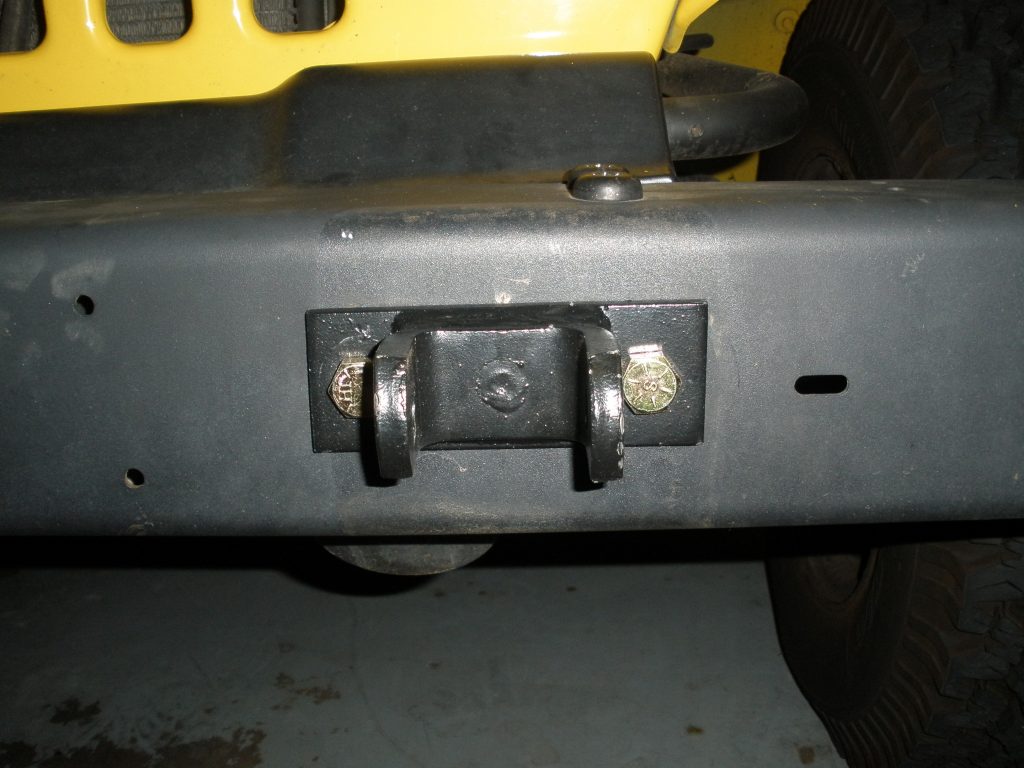

Installing the tow bar brackets on my Jeep’s OEM bumper was pretty simple. First, the bumper had to be unbolted from the Jeep using a T-55 torx fitting. Before installing the brackets you’ll first need to remove the two bumper pads from the bumper (if you’re lucky, like me, you’ll be able to use the existing bumper pad holes for the tow bar brackets). The installation instructions state that the tow bar brackets should be mounted between 24 and 41 inches apart on the bumper and mine are centered about 35 inches apart–perfect! Some TJ owners question the strength of the 1/8 inch thick bumper and its ability to support bolted tow brackets and withstand the forces that will be exerted against them. That’s a valid question and one I had, too. No, the bumper metal isn’t very stout, but if you reinforce the backside of the bumper with support plates, such as the ones that were included in my tow bar kit, you’ll be fine. Many TJ owners who have gone this route over the years have towed for thousands of miles with zero problems.
Backside of bumper showing the backing plates.
Bumper mount with bumper removed.
Close up of an installed tow bar bracket.

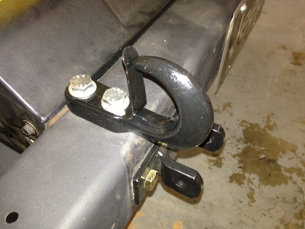

Safety Chains

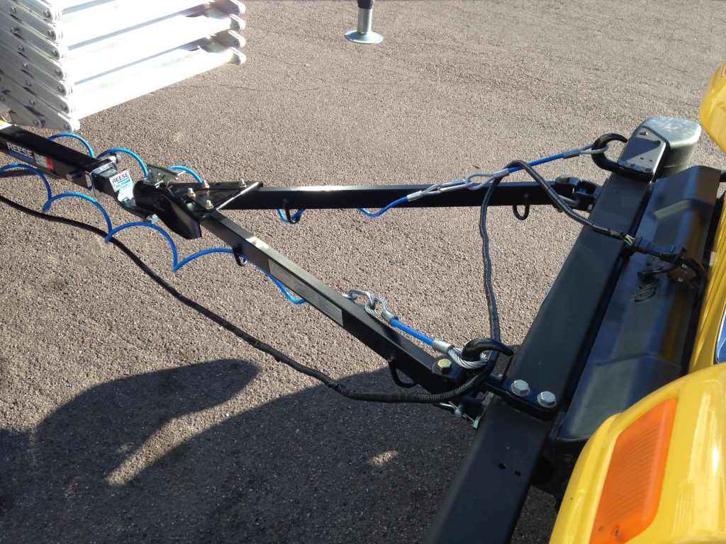

Having just a tow bar isn’t enough when flat towing–safety chains are also needed as an emergency backup in the event that the tow bar or hitch fails while in-motion. In order to use safety chains, I needed two attachment points on the Jeep. These can either be tow hooks or D-rings. Unfortunately, my Jeep had neither, so I had to find something that was suitable that bolted to the Jeep’s frame. Fortunately, a pair of Curt tow hooks can be purchased for $7.99 at Harbor Freight that mount directly to the top of the bumper (see pic below). Rated for 10,000 pounds these hooks are pretty beefy and also include a retainer clip. You can also purchase Curt Tow Hooks on Amazon.com. In addition to towing, these hooks can also be used for recovery in the event that you ever get stuck while off-roading. Getting stuck is something that happens to every Jeeper, eventually, so having a good set of tow hooks provides extra peace of mind.
The Curt tow hook installed on OEM bumper.

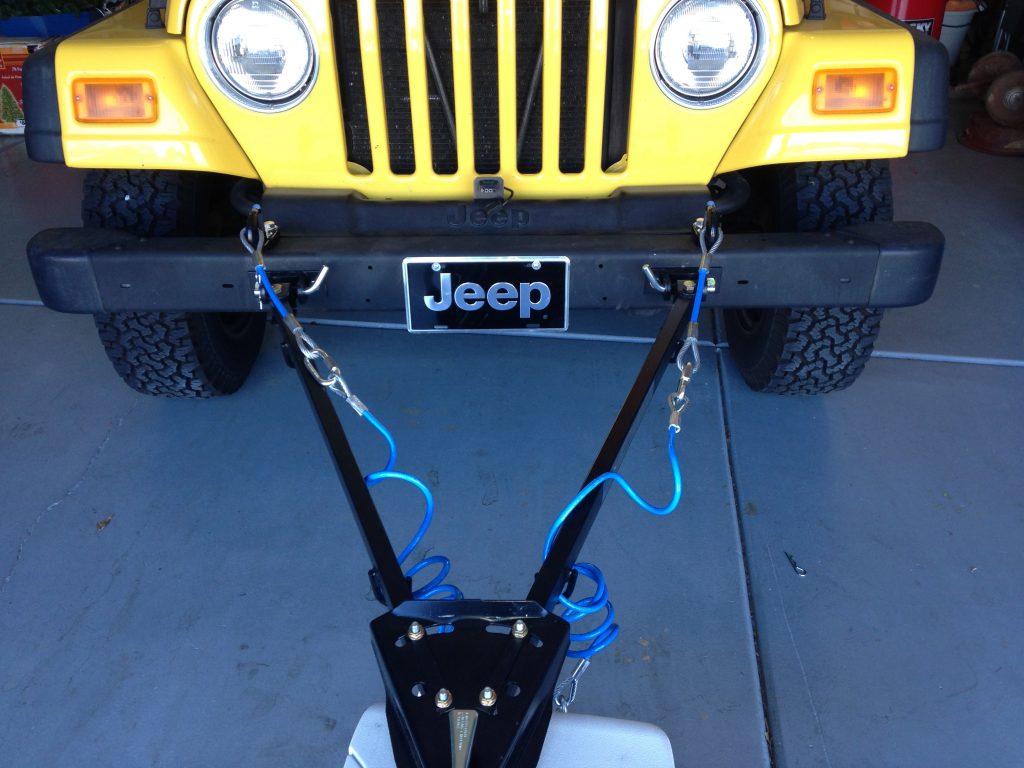

Tow bar and safety chains hooked up.

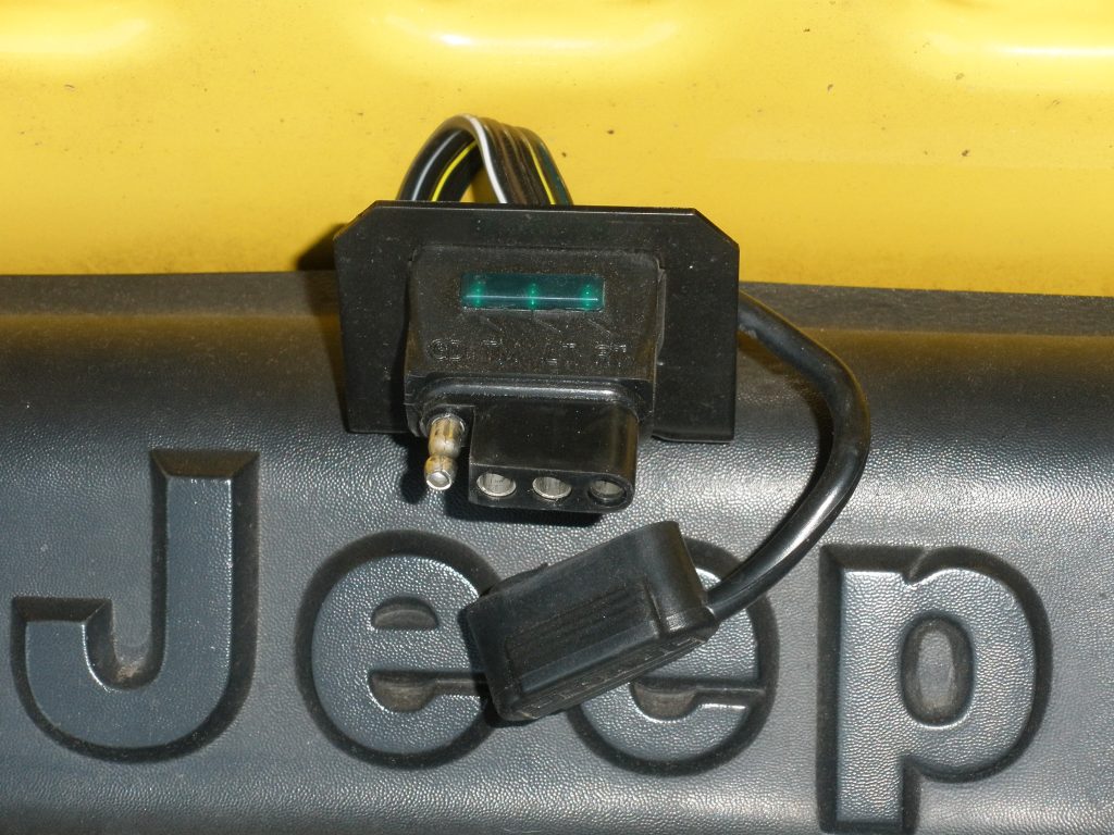

You can go two ways to meet this legal requirement: buy a set of removable tail lights–the quickest and cheapest option–or permanently tap into the Jeep’s tail light wiring using a hard-wire diode kit. I chose to go with the latter as I wanted a more permanent, “hidden” solution. What’s the purpose of the diodes? They prevent the truck’s electrical impulses from being back-fed and causing damage to the Jeep’s electrical components. I do have one recommendation when hard-wiring: make sure that the wire run through the Jeep’s engine compartment is protected with flex tubing as this area can get pretty hot during vehicle operation. I should also point out that the common four-wire system is used for towing lights. As for the length of my umbilical (the cord that connects the Jeep to the truck), mine is 80 inches long and is protected with flex tubing wrapped in insulating tape.
The mounted 4-wire electrical interface plug.
