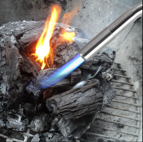

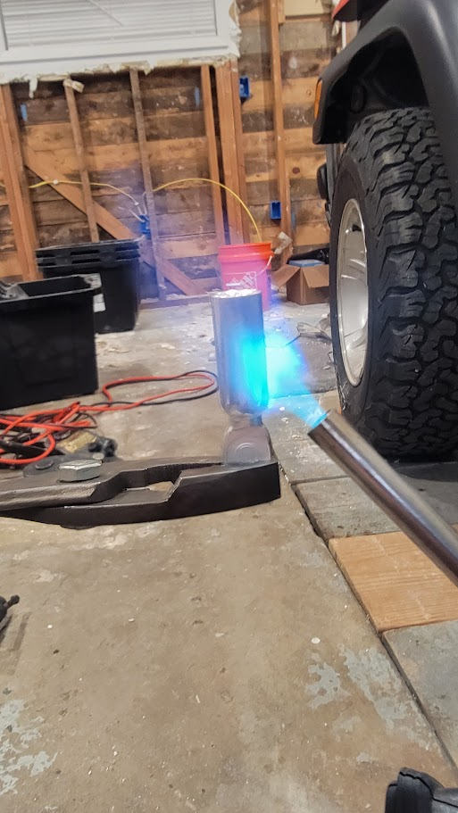

So last year I bought a $25.00 propane torch and it has proven to be one of the most useful tools in my tool belt;
from fire starting, camp cooking, loosening a suborn bolt, and creating electrical terminal connections (see link below)¹ the range is as far as your imagination².

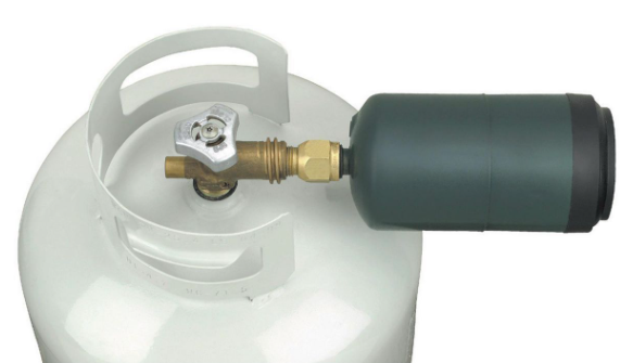

But alas the propane torch has finally run out instead of going out and buying a new one and adding to the problem of landfills and hazardous waste you can refill them.
What you'll need is:

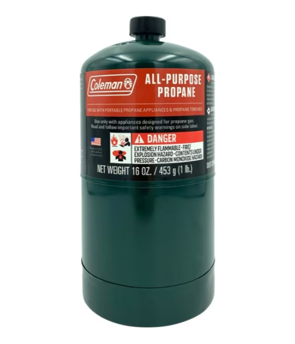

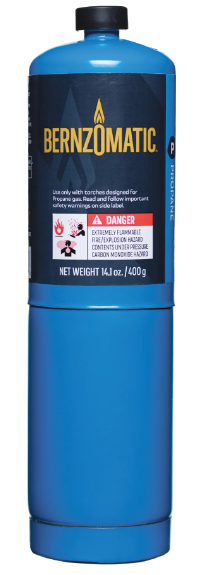

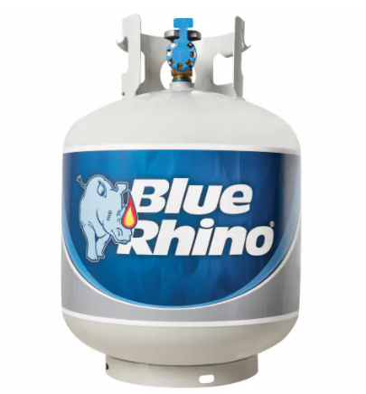

*Propane Tank : (Propane Source) *4/4 to 1/4 full tank*.
*Propane Torch / Camping 1lb Tank : (Propane Receiver)

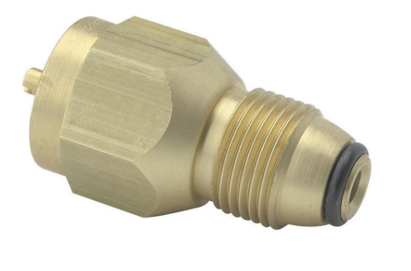

*Propane tank adapter
and a freezer:
step 1: Place the receiving propane tank in the freezer for two hours.
step 2: Place the adapter on the 20-lb propane tank with the control valve closed.
step 3: Remove the receiving propane tank from the freezer.
step 4: Screw receiving tank onto the adapter.
step 5: Rotate the propane tank upside down
step 6: Open the control valve on the 20-lb tank.
step 7: Wait till the tank is full.
step 8: Close the control valve.
step 9: Rotate the propane tank right side up.
step 10: Remove the receiving tank from the adapter.
step 11: Remove adapter.
step 12: full tank.
