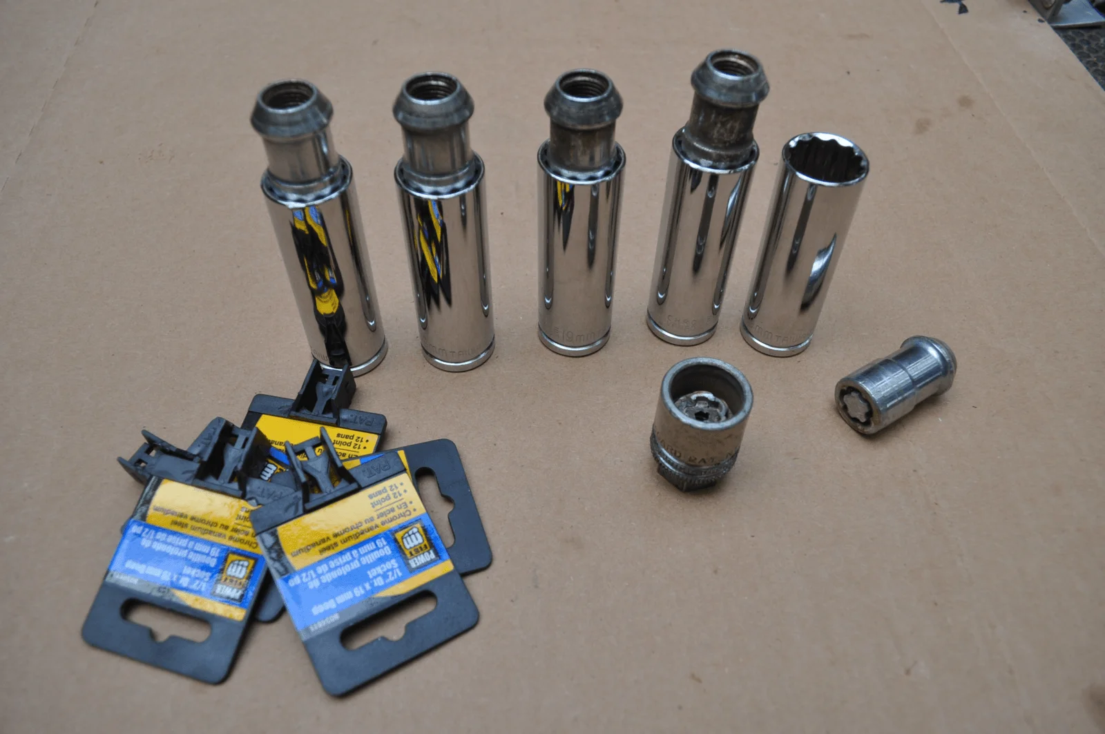

I started to rotate my wheels a few days ago. The left rear came off easily using my DeWalt 20V 1/2" drive impact gun. The right rear lug nuts however would not budge. I resorted to my 24" breaker bar and they were on TIGHT! Just as I was thinking ... "something is going to break" ... that's what happened. The keyed socket snapped and rendered itself useless. I now had one wheel off and three wheels plus the spare that I could not get off.
I had a flat in my right rear tire repaired back in May. I went back to the tire store figuring they over torqued my wheel and to ask them for "help"! They said they always snug wheels up and torque them down at 110 ft. lbs. I always torque mine to 100 ft. lbs. but figured what they did wasn't that bad.
Their advice was to buy some cheap 12 point sockets, pound them onto the locking lug nuts with a 5 lb. sledge and then remove them using my breaker bar. I wasn't too sure about this but they were right!
I bought one 19mm (3/4" is the same) socket for $5.99 and had the first one off in about 3 minutes. I went back to Princess Auto (cheap tools) and bought 4 more sockets. The young girl at the cash said (condescendingly) ... "you know these are all the same ... don't you?". I told her I was on a NASCAR pit crew and she bought it.
The guy at the tire store told me this happens all the time and the best thing to do with locking lug nuts is to throw them out, which is exactly what I did.
BTW - the only lug nut I could remove from the socket was the spare. The others are in there for good.

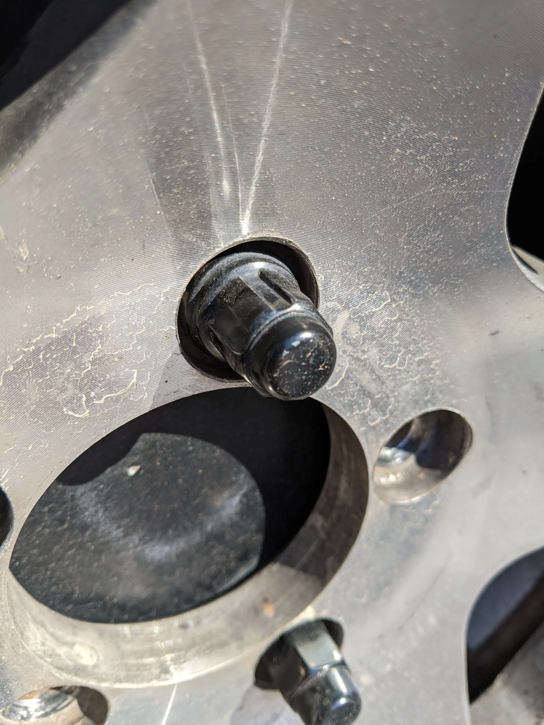

Well, it's my turn, I guess.
I don't know if it was me or my kid that lost it or the tire store kept it when I had them balanced in July but the key is nowhere to be found. Guess I'll be buying some throwaway sockets to get these stupid things off.
It's not the McGard style, it's an external splined set that I got from Quadratec about 6 years ago and 17mm is the largest socket that won't slip over it so that's what I'll be getting.

If we are trashing the locks anyhow, why not use a rounded nut extraction socket built for something like this? Surprised that owning a Jeep, we all don't have these in the tool box already
I made a last minute call to do exactly that. My local Harbor Freight doesn't sell individual sockets so by the time I bought 5 of them anywhere else it would have cost as much or more than the lug nut extractor set.
Haven't used it yet, waiting for the new nuts to arrive so I have something to put back on.

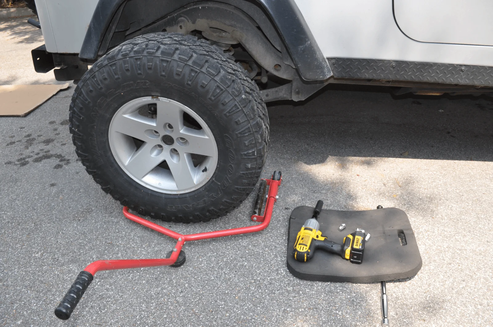

While I'm at it, if you can get a tire dolly like the one below they are well worth having. I saw it at Princess Auto for about $80 and said ... "no way". I wasn't sure if it would work and figured I could make one for less if I wanted to.
A few months later they were on sale for $15! I guess a lot of people figured they would work. Any way, they are great for jockeying tires around your garage, driveway, etc. When putting wheels on simply lift the handle and rotate the tire to line up with the studs. Works great!
Does anyone know who carries these wheel dollys in Canada? Absolutely great idea! I quit doing wheel changeovers at home due to the weight and my back. Thanks!
Where can I get one of these wheel dollys in Canada? Great idea to save my back!
Amazon has them but the reviews are overwhelmingly horrible. I have found that a short, round point shovel with a "D" shaped handle works great, I use that method on heavy motorhome tires. Fix the jack so the tire is barely 1/2" or so off the ground, put your shovel in there and lever it into place. You can twist the D handle a bit and move the shovel handle fore and aft for stud alignment. Even the little 18" shovels work.
