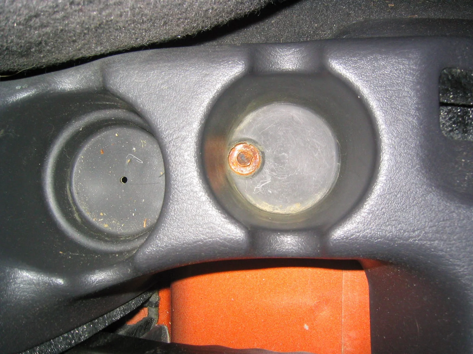

We started by removing the first screw, located in the front cup holder.

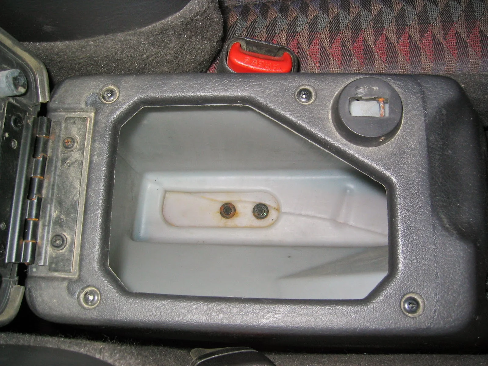

We then removed two screws located in the center console storage compartment.

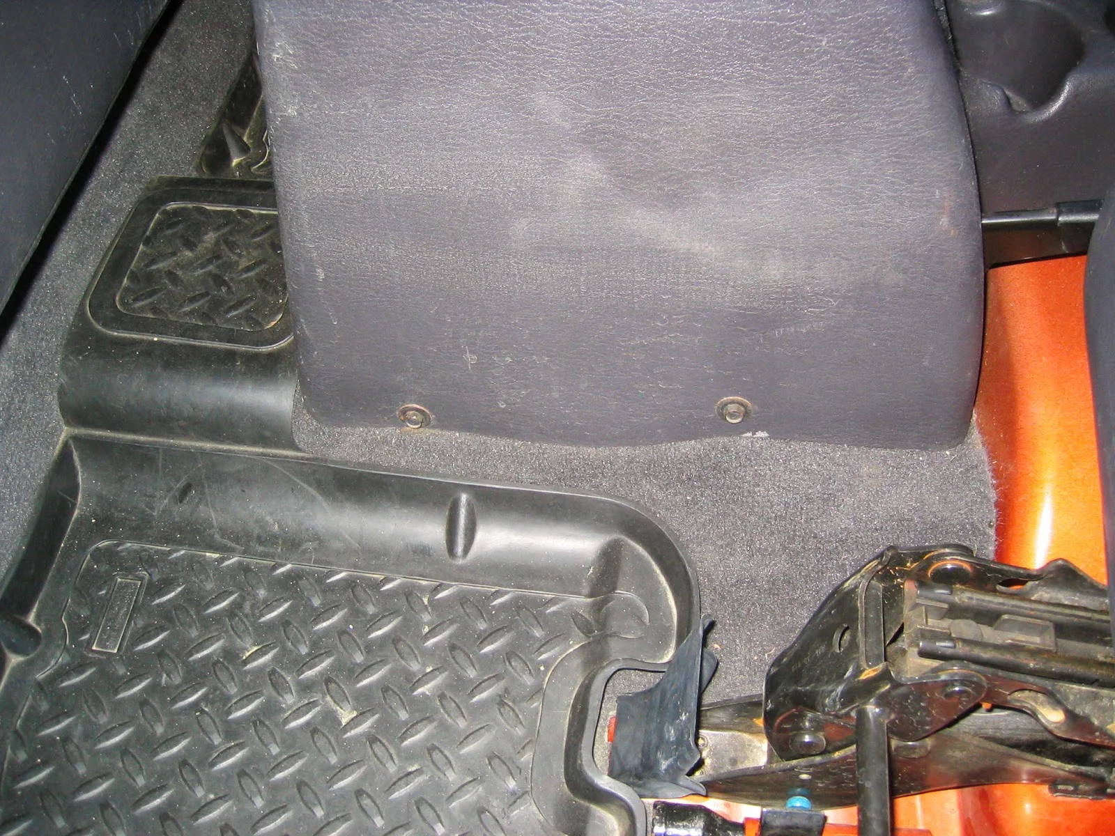

Then we removed the screws at the based of the center console. We slid/collapsed the front seats forward to access them.

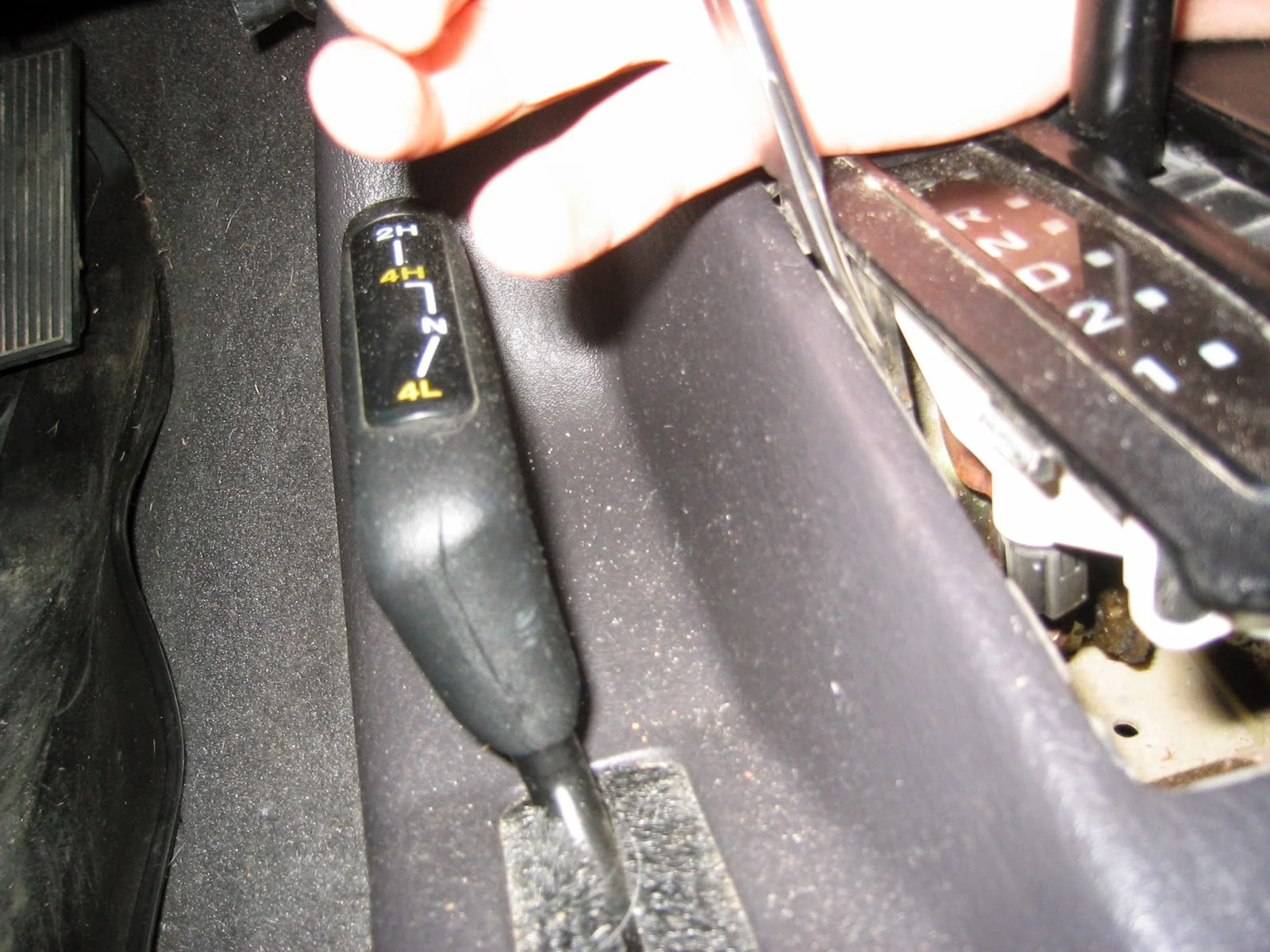

We then pried out the display of the automatic shifter with a flat screw driver.

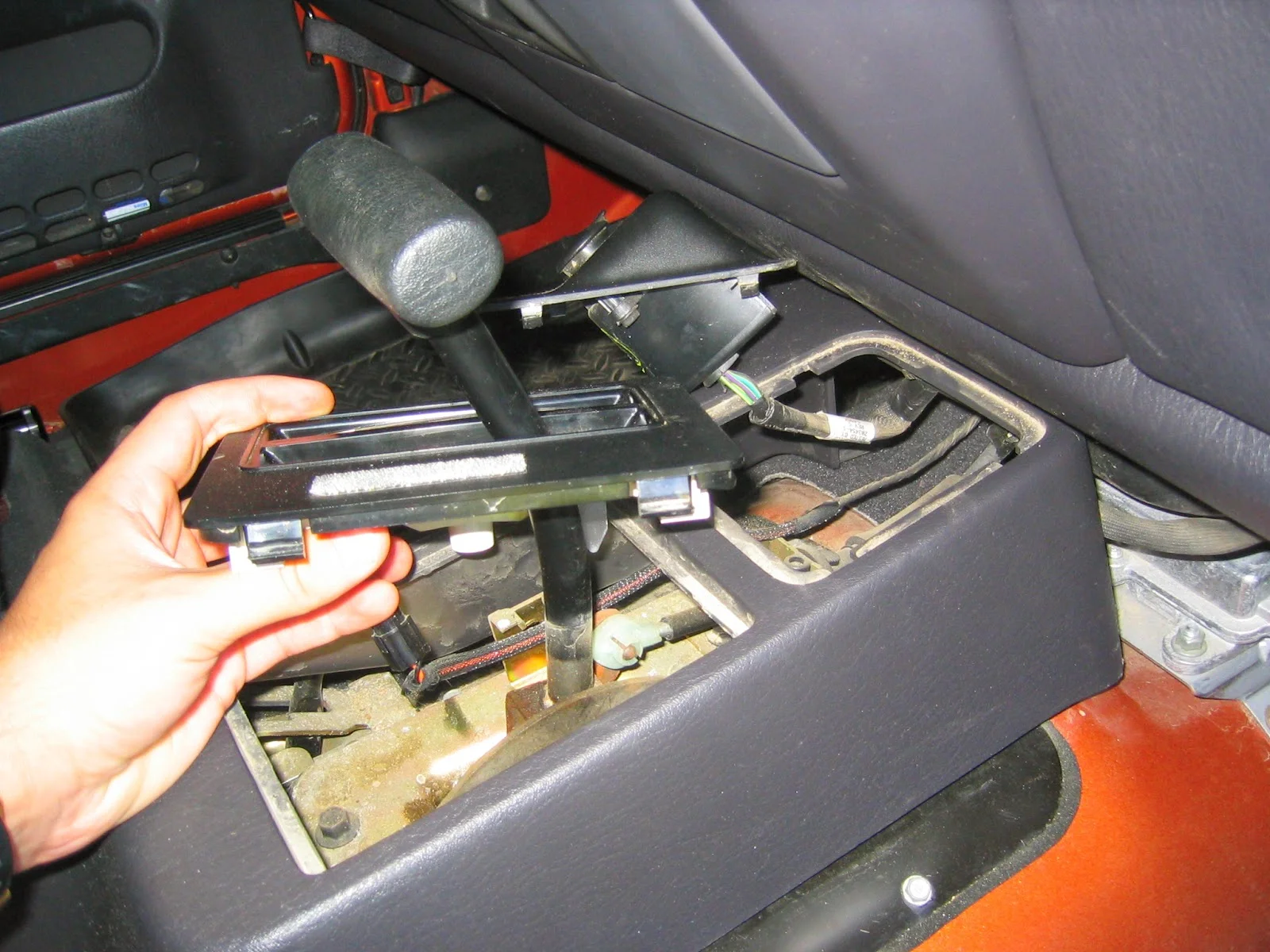

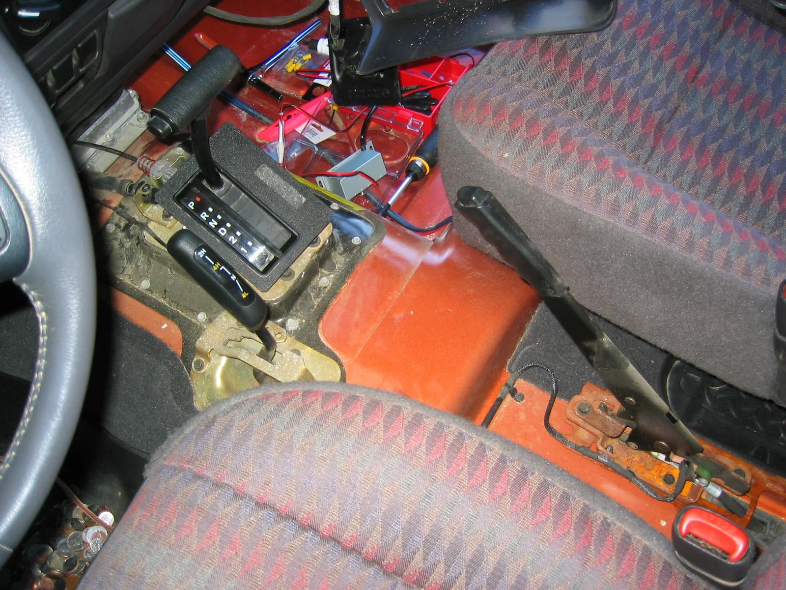

We also popped out the airbag panel that sits in front of the automatic shifter.
STEP 6

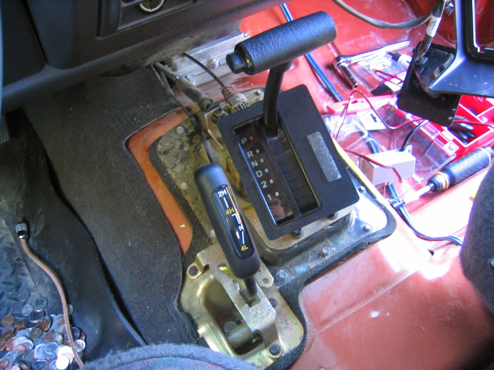

Before we removed the center console, we put engaed the e-brake, put the transmission in 4-low, and removed the automatic shifter handle. This helped with being up to simply pull up on the console assembly and slide it up and out of the area.
The shifter T-handle is shown still attached in this picture. To remove it, we simply pulled up very hard and it popped off. If we left the shifter T-handle on, it's possible to remove the console, but it takes time to get the angles correct. We re-installed the shfiter T-handle by placing it on the shifter stem and pressing down.

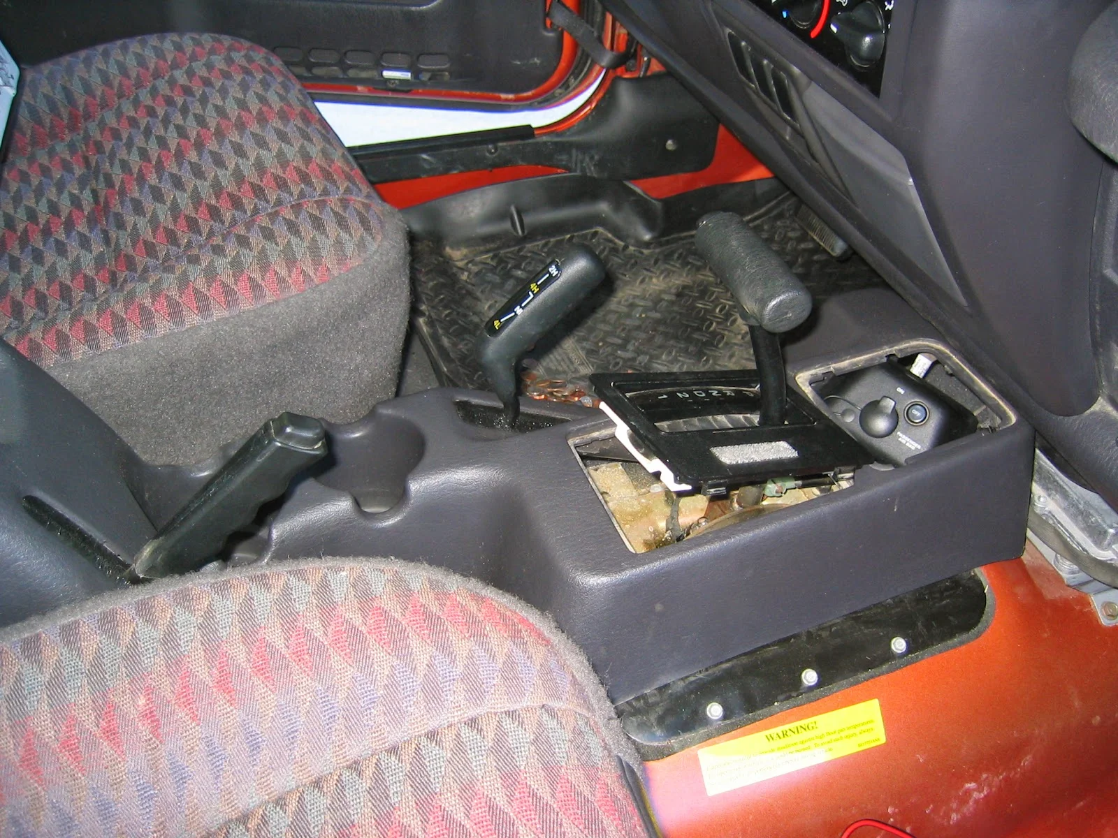

This image shows the center console removed.
