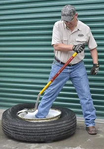

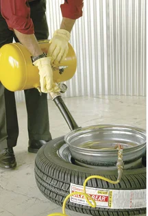

Update: Consensus so far is that it's more work than it's worth. But if you're not in a hurry and want to try it yourself, here are the kind of tools you'll need. Or for removal only, consider one of these, or get creative and build something like this. Of course, mounting and balancing is another story.

Any pro tips on swapping tires?
Assuming you're not talking about emergency/on the trail type of stuff, and you're doing multiple tires at home, you're going to need something to break the bead (big tire hammer, I think the one I used to swing was 12lbs), tools to remove and remount (spoons for smaller, golden toll for bigger), and enough air to remount and seat the bead (a cheetah and compressor). There are other tools and ways to accomplish the same, but these tolls are the standard for hand tools. Lots of labor, especially with big heavy tires.
