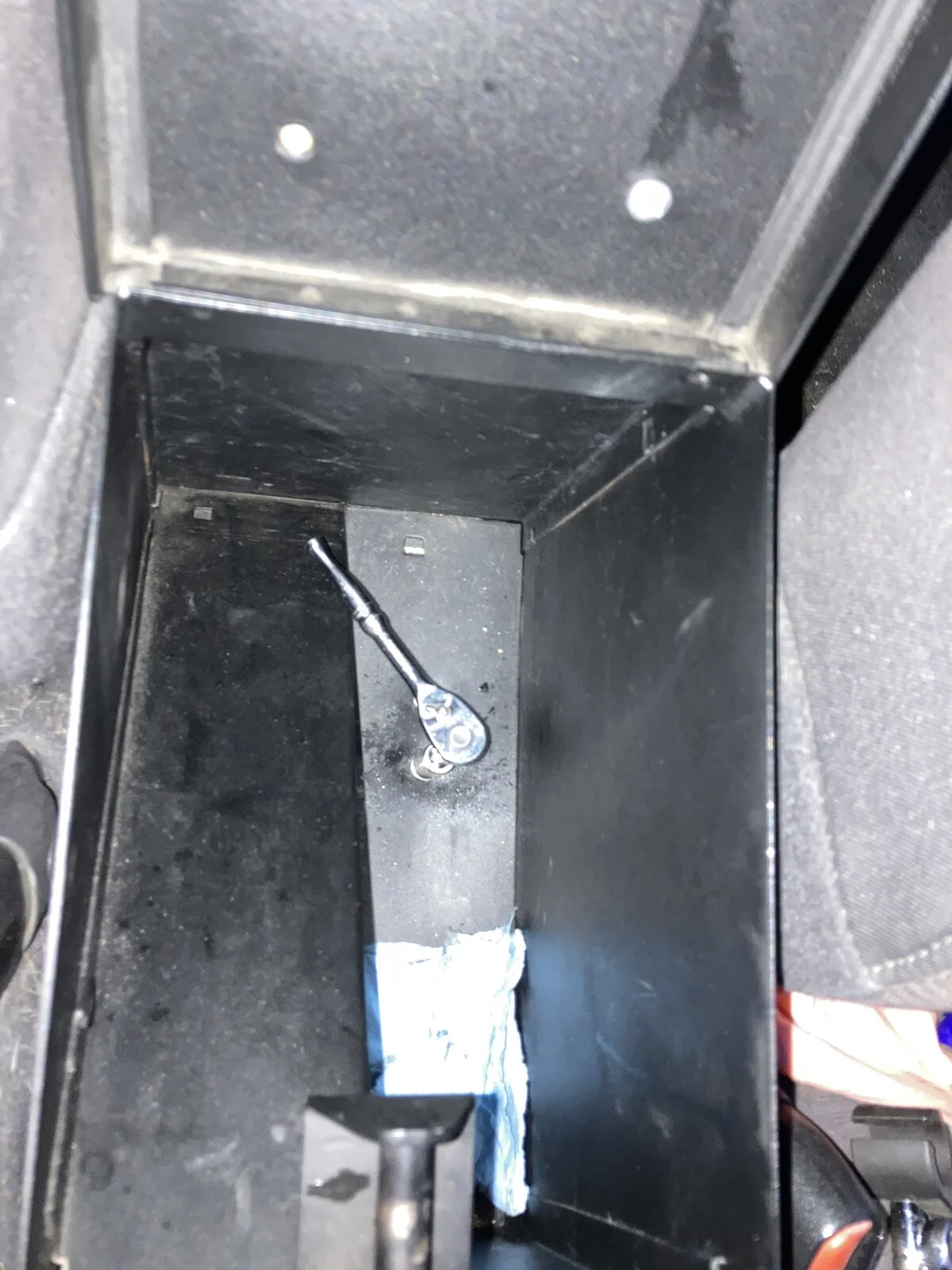

Hello all I bought this Jeep recently and I don’t have much of it’s history except for what I’ve done. My problem now is I want to change the filthy rug with a bedrug I bought but I can’t remove the Tuffy security console to fully remove the carpet. It ripped out and I can’t seem to get the console to loosen at all. I went at it for a good 15 minutes before I stopped lying to myself that it was unscrewing.
Anyone know how to remove this? I checked under at a glance but did not see anything

Figured it out. Since there’s nothing online about it. You must go under the Jeep you’ll see two screws. The nut must be held on the inside of the console and then unscrewed from the bottom. Got it off. Tuffy series ii Incase anyone needs held in the future

aha thanks guys! I decided to put the answer so as to help others in the future. I searched just about everywhere for the answer and figured it out by sight lol
as you can see my rug and surrounding area was disgusting... all cleaned up now.
