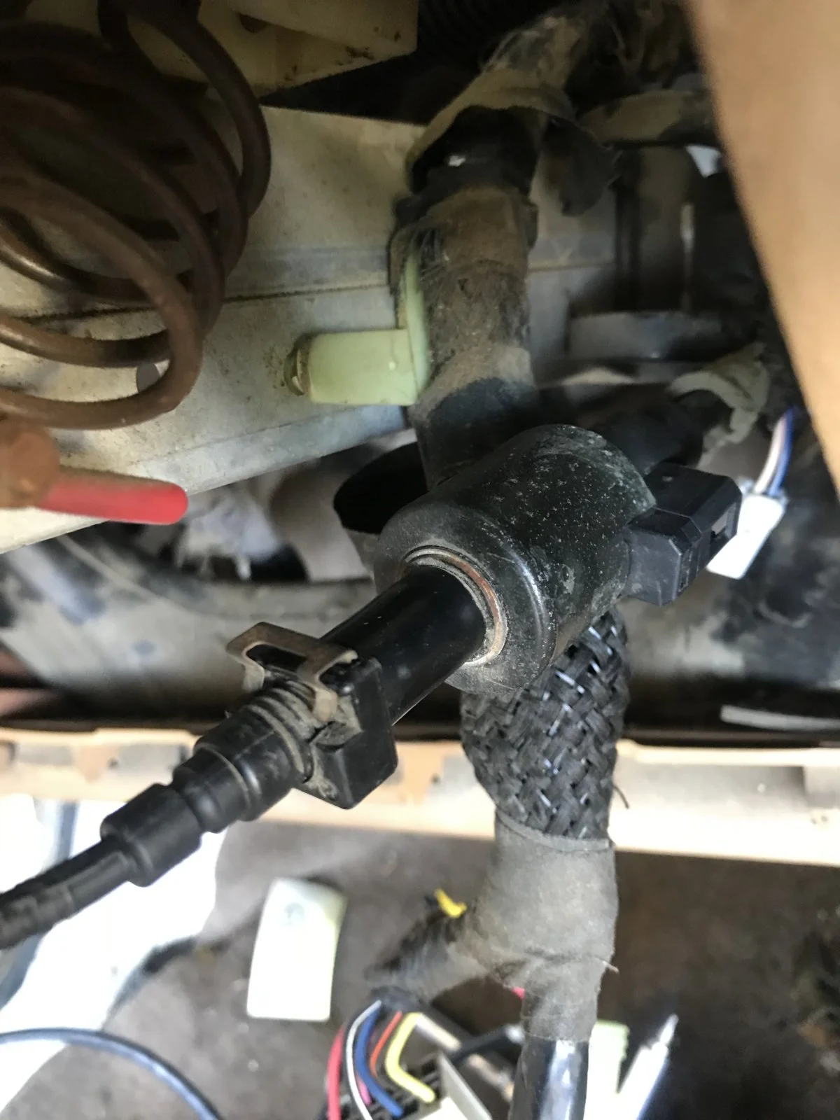

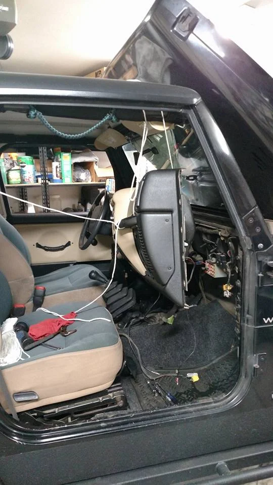

No, you have to pull the dash and steering column to change the heater core.
Might be in the right spot.
No you don't
