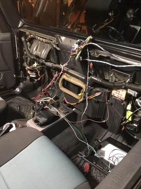

Looks like you didn't have to drop the steering column? How hard was it to snake the HVAC box out like you have it roped up? I need to replace my AC evaporator, so might as well change the heater core too.
Yes , simple to pull steering column prob didn’t need to but I have to replace ignition only hang up for me is that cable, I haven’t got HVAC box out yet but if you rope up dash like I did to roll cage it’s easier to un hook dash components and re install
If I had that cable off column steering would out and dash off about 3 hours
Piece of cake. You might hear some creaking of the dash but it was pretty easy.

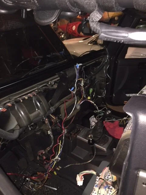

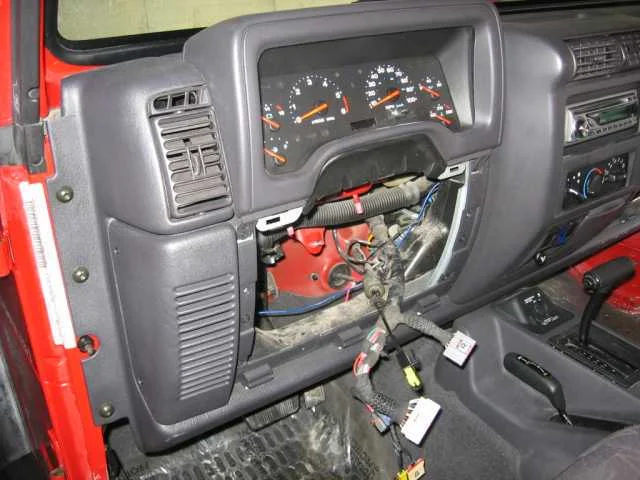

- Once the wheel has been removed, your Jeep should resemble this:
Figure # 1

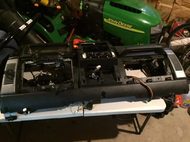

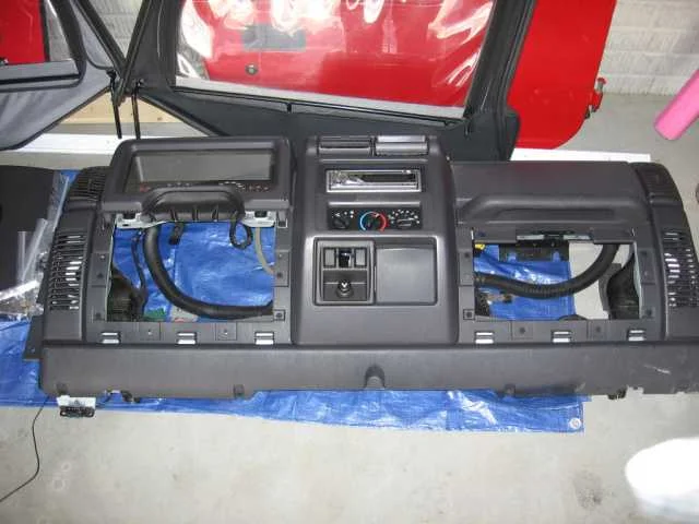

12. Straddling the middle console, lift the dash up and out, being careful that all lines/connectors have been removed. If needed, get some assistance when removing the dash.

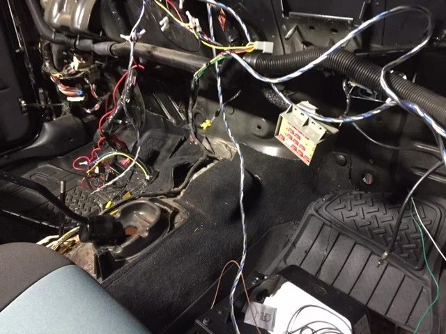

13. The dash, removed as an entire unit, will look like this:
14. Your Jeep, however, now looks like this:

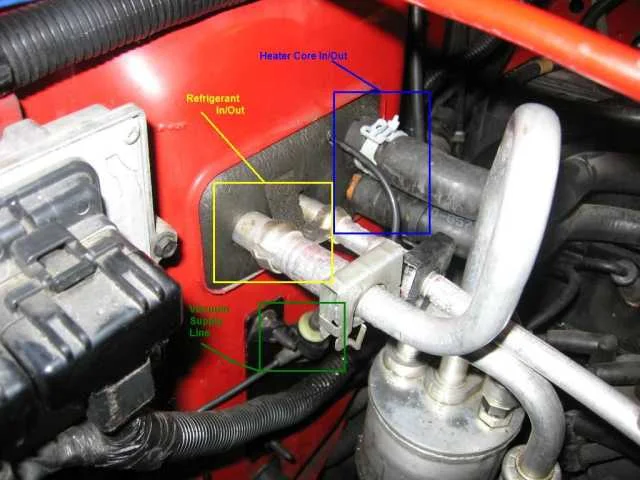

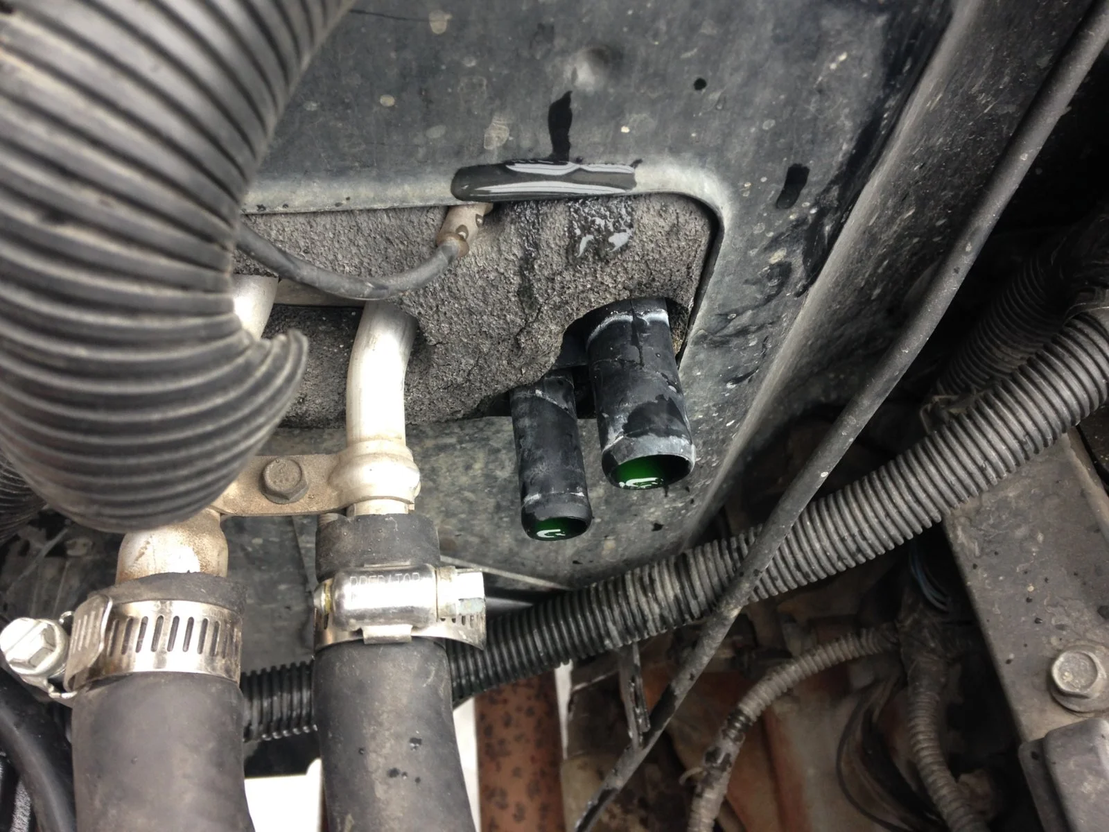

16. Disconnect both heater hoses from where they enter the interior cabin. Notice that the top hose is larger in size, while the lower one is smaller. Take note of the hose orientation. The two ends of the spring clamps may be squeezed using a channel-lock pliers. Note that you may need to twist the hose to loosen it up. A coating of warm, soapy water may also do the trick, although you should avoid getting this into any openings. [See Figure 4]
17. Disconnect the vacuum supply line connector. [See Figure # 4]

Figure # 4

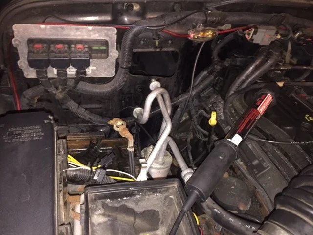

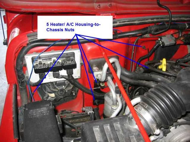

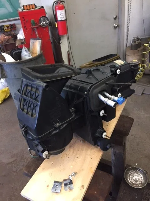

19. Remove the five (5) HVAC housing-to-chassis nuts using a 7/16 socket or wrench. [See Figure 5] They are found (when viewing from the engine compartment):
- To the left and bottom of the blower fan (1)
- Holding the evaporator canister bracket (2)
- In the middle, above the engine (1)
- In the middle, just above the cylinder head. Note that this one holds the cowl plenum drain tube. The nut holding the drain tube must be removed, the cowl plenum drain removed, and then there is another nut underneath. (1)
Figure # 5
20. From within the cabin, remove the floor duct from the bottom of the HVAC unit. This can be done by removing the two (2) front and one (1) rear screws with a 7/16 socket or wrench. The duct can then be slid to one side and removed.
21. Remove the screw holding the HVAC unit to the firewall bracket, near the fuse panel, using a 7/16 socket or wrench.
22. Straddling the center console, slide the entire HVAC housing toward you, being careful to clear the center air ducts. Remove the entire system and place in a suitable area where you will now begin the disassembly.

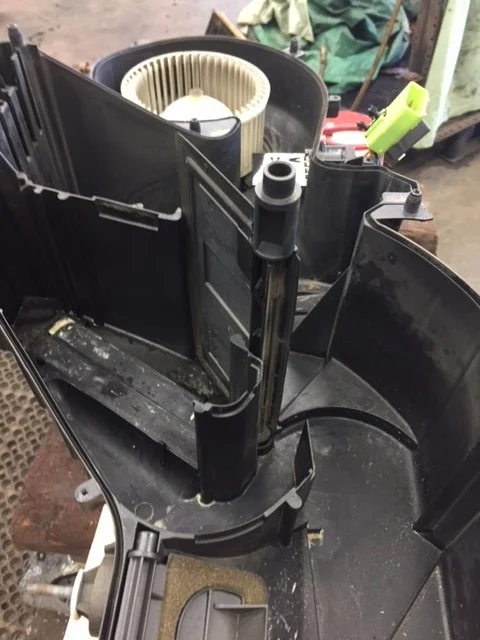

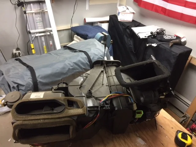

23. Using a 7/16 nut driver, remove all screws holding the upper and lower HVAC housing halves together. Gently remove the top cover of the unit. I'll be honest; I had a lot of trouble here and had to gently pry the thing apart.
24. Remove the leaking heater core from the housing. When viewing the HVAC unit as it appeared in the cabin, the heater core runs across the back from the left side to the middle, where the tubes exit the housing.
25. If possible, clean the housing of any oil/antifreeze leftover from the formerly leaking core.
26. Replace the leaking core with the new unit.
27. Refit the upper and lower halves of the HVAC unit together and replace all screws.
28. Repeat all prior steps in the reverse order to reattach the unit, refit all hoses/lines, reassemble the dash, and reassemble the steering column.
29. Replace your coolant or have it flushed by a professional.
30. Crack open a cold one and give yourself some credit. Use the $500 you saved and treat your Jeep to some new goodies.
Your write up is spot on......however, I got down to the last five nuts to remove and only one came off. Any suggestions on how to remove the remaining 4 nuts from the firewall?
I just replaced my heater core in my 05. I had been smelling antifreeze for the last two years but never saw anything on the floor. I did find a small amount of dried antifreeze inside of box and on the heater core itself. It took about 5 hours or so. I was meticulous in assembly not wanting to miss any plugs and also cleaning all the dust and dirt off of panels. I had also rerouted some accessory wires, fog light, speaker wires, etc. I did this over a period of a week in my spare time since it's not a daily driver.
I also went as far to replace the evaporator, fan motor and relay, since I didn't want to do it all over again in the near future.
You can learn a lot about your jeeps wiring and function by doing it yourself and save $$$. It's not a hard job to do just takes time to get everything out of your way to get to heater box.

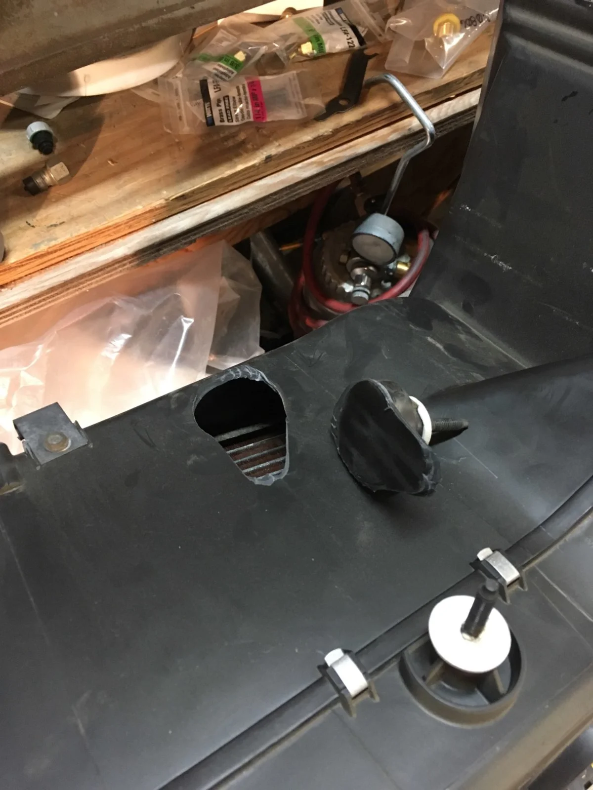

So I got my heater core out, in the process, I broke out a mount. What adhesive would work to repair this? Is it a ABS or other type of plastic...
Ouch! I don't know what kind of material it is, but I'd maybe try JB weld. You probably need some sort of way to reinforce it too. I'd be afraid of it popping loose when you tighten it back down when installing.
Maybe a combination of JB weld and some sheet metal cut to fit around it like a shroud and screwed into the box with short screws. You could try roughing up the surfaces and put a thin layer of JB weld between the plastic and sheet metal.
I thought that, but JB weld is an epoxy, which is typically not used on plastics...fiberglass, steel, and aluminum yes, but not for plastics. I proper plastic glue will be just as strong as the original plastic once it cures, I just need to know what glue is correct for this plastic. Thanks, Tim
Reactions: MountaineerTom
Oh, I was thinking I seen on the package that is could be used on plastic too.
They do have some products for plastics but not sure if it's what you'd need.
