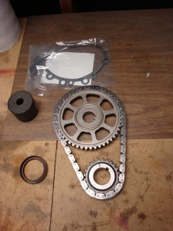

The parts, 2 gears, a chain, a new crankshaft seal and a cover gasket.

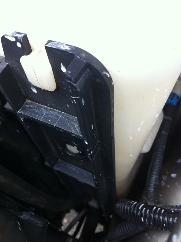

Step 1: Remove the radiator overflow container. Simply push on the plastic nub that sticks through the shroud and lift up. Disconnect the hose from the radiator neck.
Step 2: Remove the fan and fan shroud. The fan requires a big crescent wrench, quite big, looks to be 36mm. Whack it with a 5 lb hammer is usually enough to break it free. Once it is lose, remove the 4 11mm bolts holding the shroud to the radiator. There are two on each side, the bottom ones are bit of a pain but are reachable from the top.

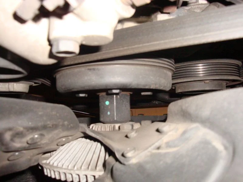

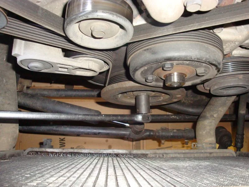

Step 3: Using a 19mm socket and a large breaker bar break free the crankshaft bolt. I have a manual transmission, so I just put the jeep in gear with the parking brake on. It broke free rather easily.

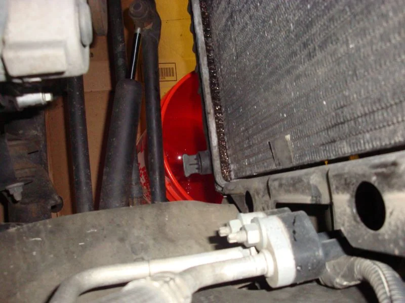

Step 4: Drain the radiator.
Step 5: Remove the water pump, thermostat, and radiator hoses. Refer to the water pump/thermostat replacement write-up.

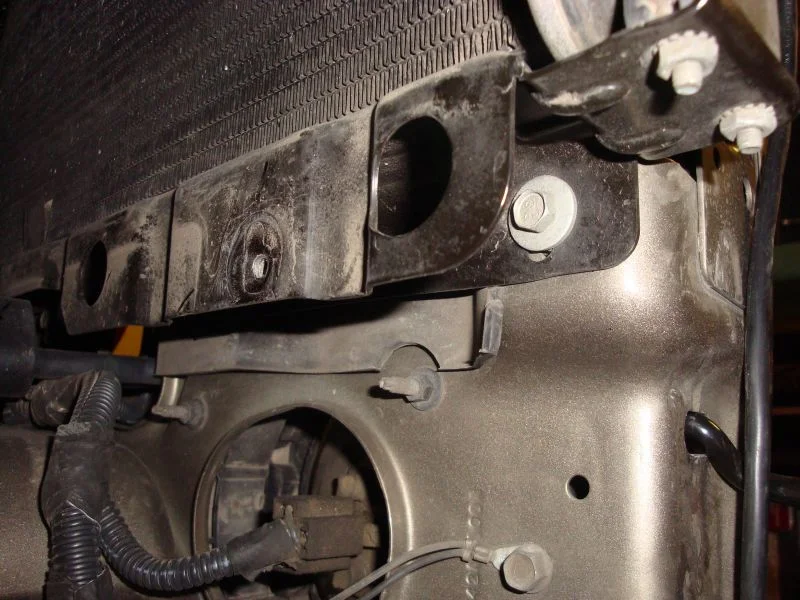

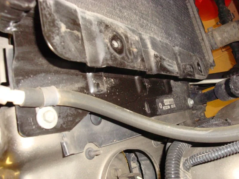

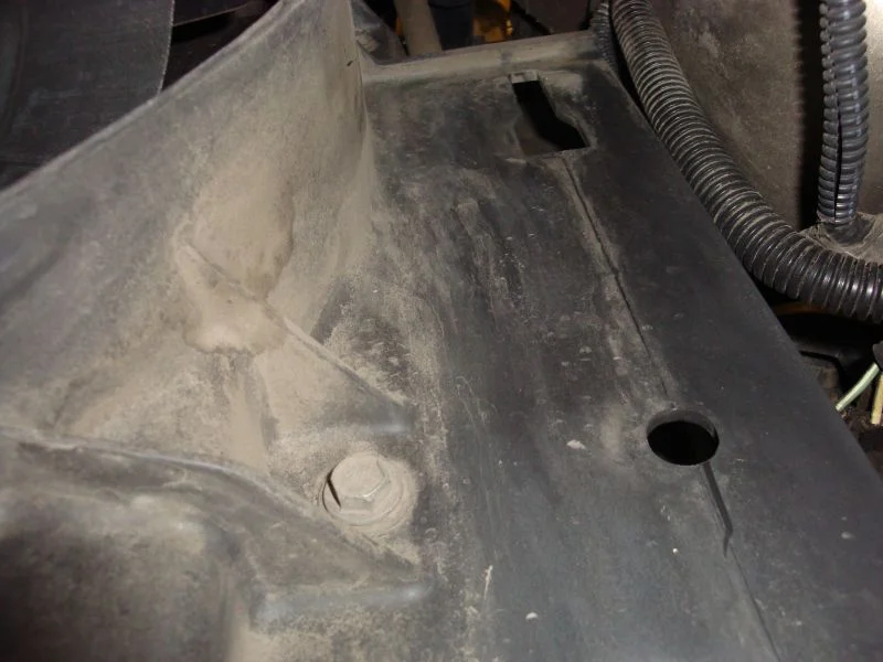

Step 6: Remove the radiator by removing the 4 10mm bolts, 2 on each side. I found a deep well worked well, a regular socket with an extension would have worked as well.

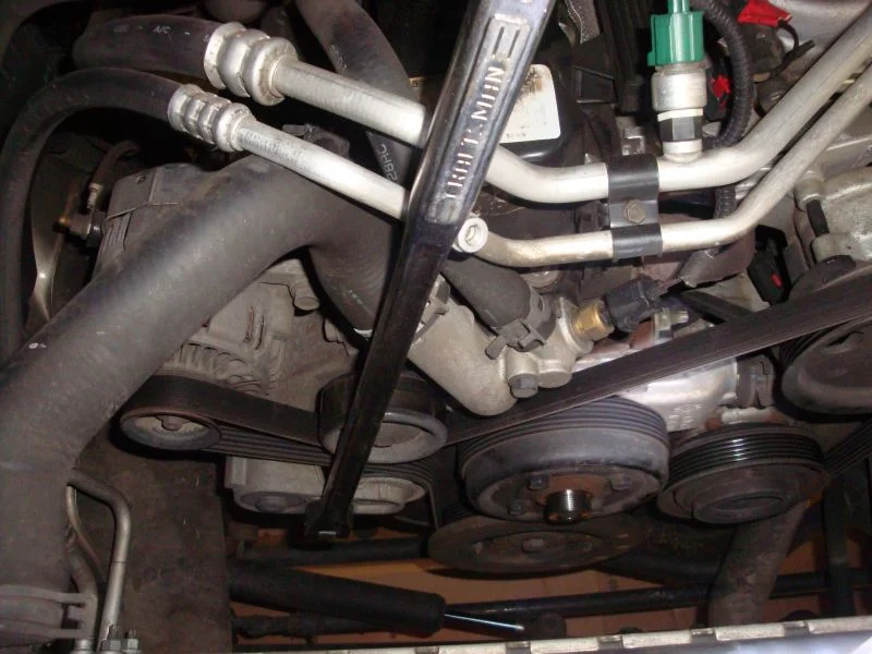

Step 7: Using a 1/2 inch breaker bar insert the bar into the belt tensioner and remove the belt while levering the breaker bar to relieve tension.

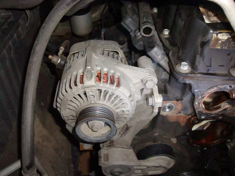

Step 8: Remove the alternator bracket as the belt tensioner is attached to it and is blocking bolts on the timing chain cover. The two bolts holding the alternator in the bracket are 15mm, the 4 bolts holding the bracket to the engine are 14mm.

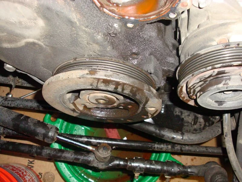

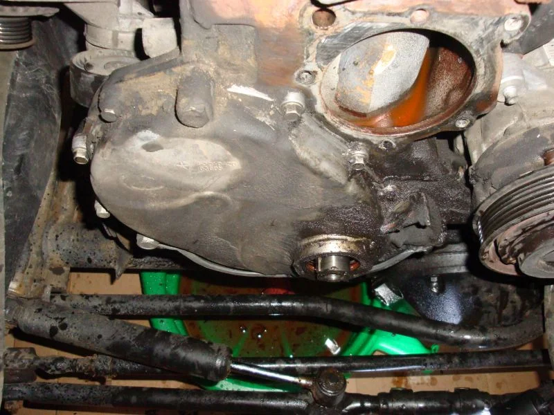

Step 9: Remove the crankshaft bolt with a 19mm socket and be sure to remove the washer or you will not be able to remove the vibration damper. Notice the washer is still on in this photo!

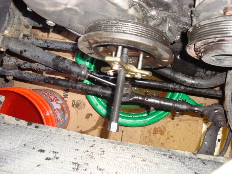

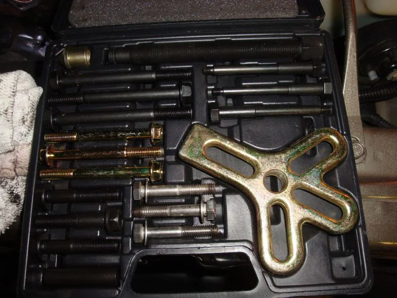

Step 10: Using the harmonic balancer remover, make sure the tip is on it it or it will destroy your crankshaft threads. Note, I missed this part , I thought the end was bigger than the bolt hole, I was wrong and got lucky and figured it out before I did much damage to the crankshaft threads. DOH! Read all directions on tools you are not familiar with!!! Remove the vibration damper with the remove and set aside.

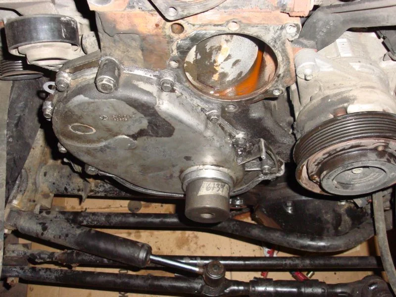

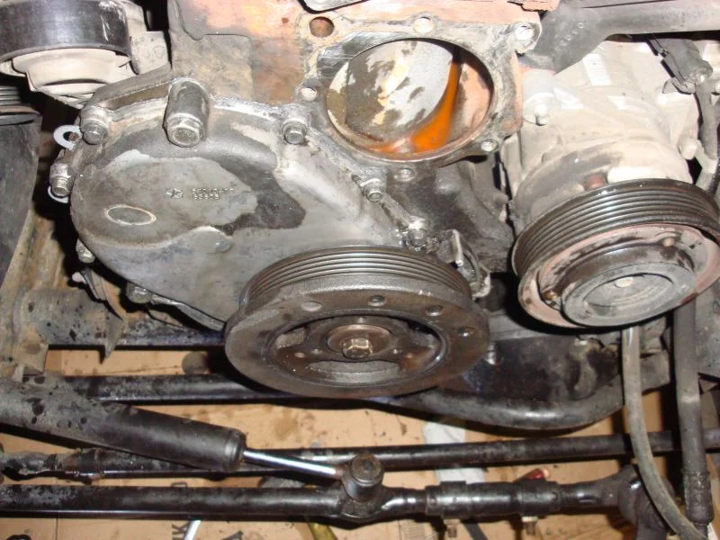

Step 11: Remove the the bolts in the timing cover, most of them are 10mm and there are two 16mm bolts, and four 11mm oil pan bolts. I use a piece of cardboard so I know where the bolts go. Just stick them through the cardboard as you take them out in the same position. Strangely on mine 1 bolt was missing, it had apparently been taken apart before and not put back together correctly. I found the bolt stuck in some engine grease on the block, very strange.
Step 12: Slide the cover off. Note the chain guide likes to slip out. Just make sure not to lose it.

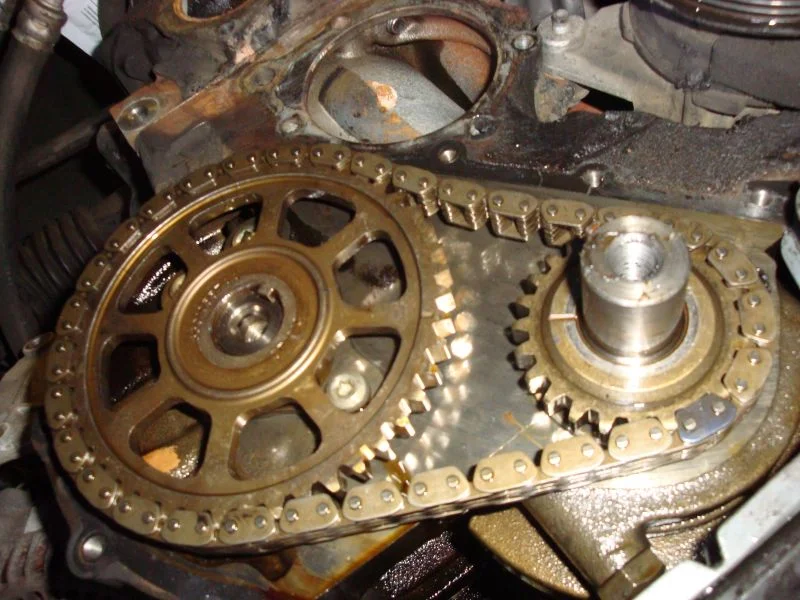

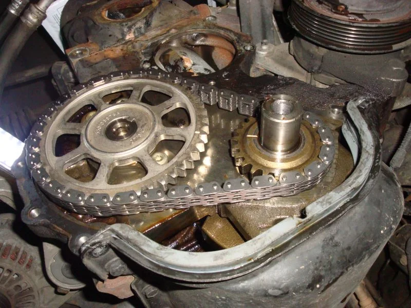

Step 13: The timing marks need to line up on both the crankshaft and the timing gears before you can remove them. You can see them in this photo near the edge of the gears, they are 2 lines.
I had to slide the vibration damper back on just a bit to turn the crank to get the timing marks to line up.
Step 14: Once lined up remove the camshaft bolt and washer with a 16mm socket.
Step 15: Remove the large sprocket and chain being careful not to turn anything. Not likely as the engine is hard to turn.
Step 16: Remove the key from the crankshaft and remove the lower gear. Note: I could not get the small sprocket off. I realized I had not removed the key in the crankshaft. But since my near disaster with the crankshaft threads I was not excited to screw something else up. I had read the gears were hardened steel so I replaced the top one only on the camshaft. The lower crankshaft gear looked fine anyways. I will be doing this on our TJ in the near future and will do both gears. I will provide an update if anything changes.
Step 17: Replace the chain and gears in the same position making sure the timing marks align. This is critical!!! Reinsert the key into the crankshaft with some RTV.

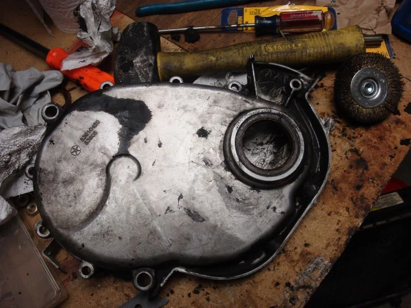

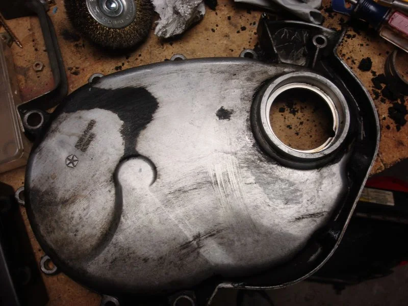

Step 19: Remove the seal from the cover with a seal puller.
Step 20: Install a new seal while supporting the cover. The FSM states to put some rtv on the outside of the seal before tapping in and to lubricate the seal with oil before installing. I recommend the mopar tool but you could just use a socket. I found the tool on e-bay for 24 bucks.
Step 21: Clean the surface of the timing chain cover and engine block
