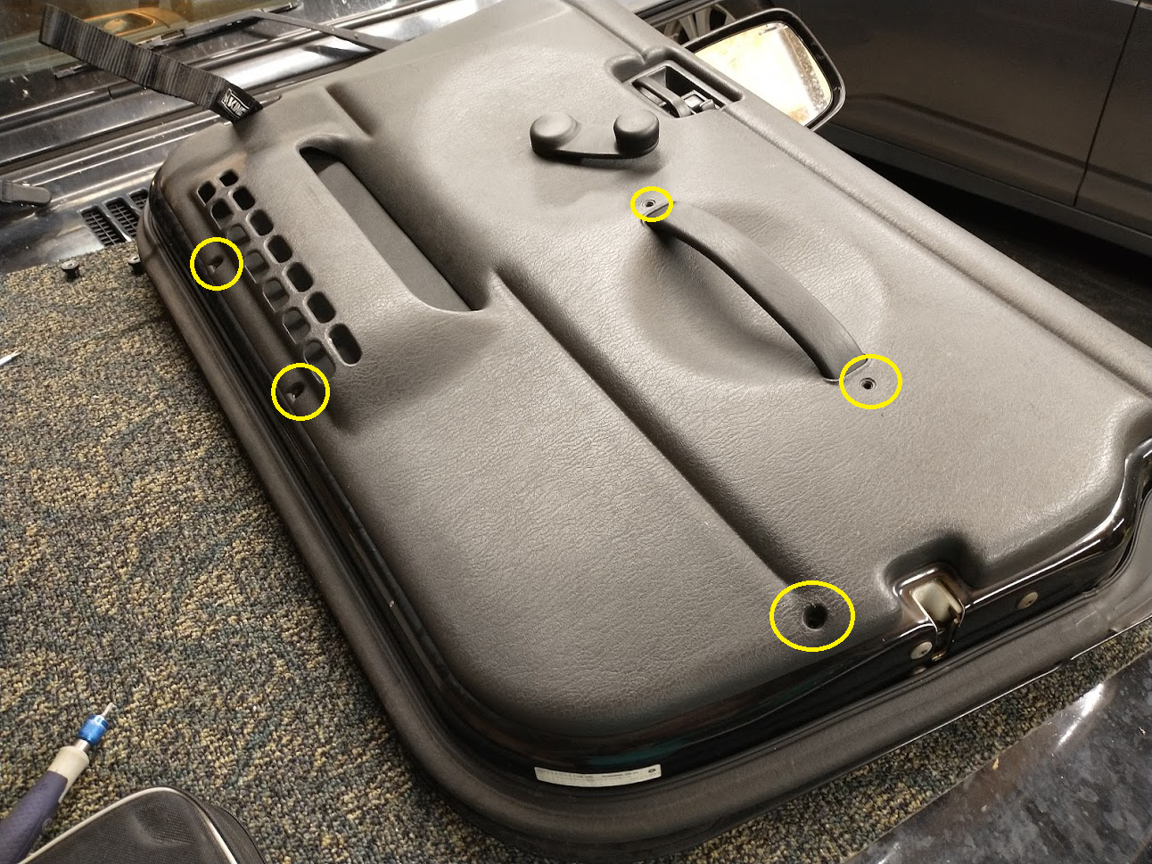

Take your door off and set it somewhere handy. Remove 5x Torx screws:

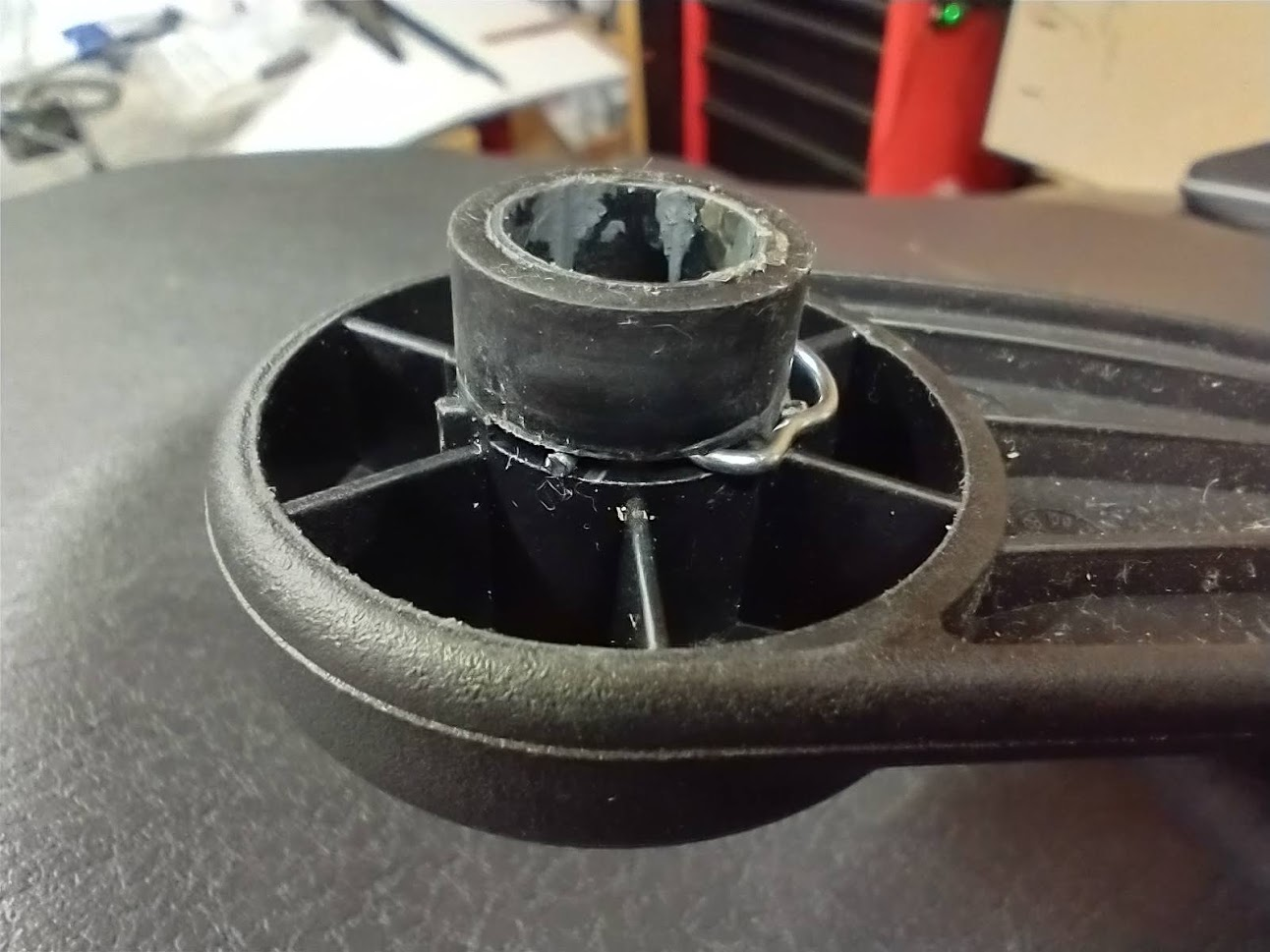

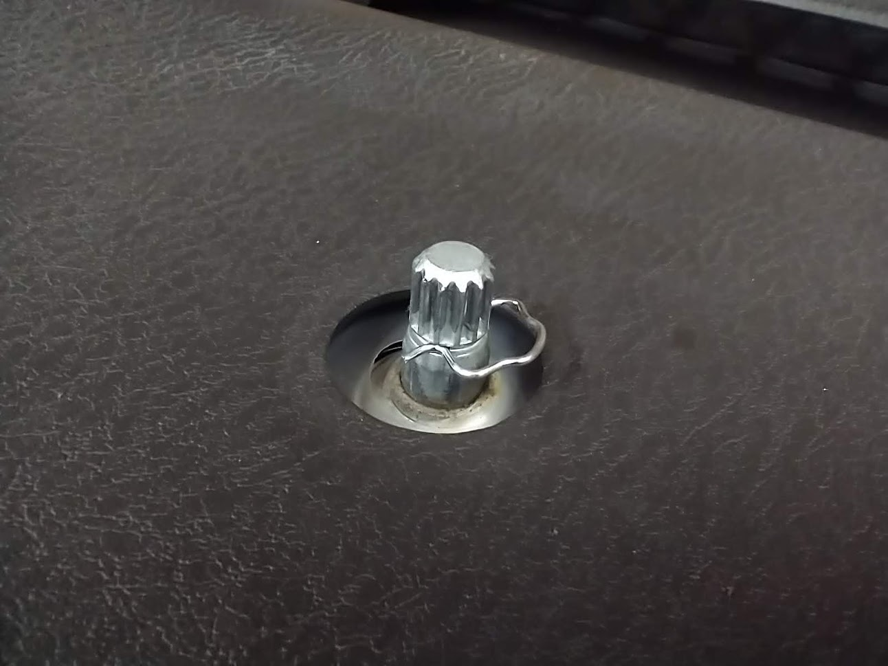

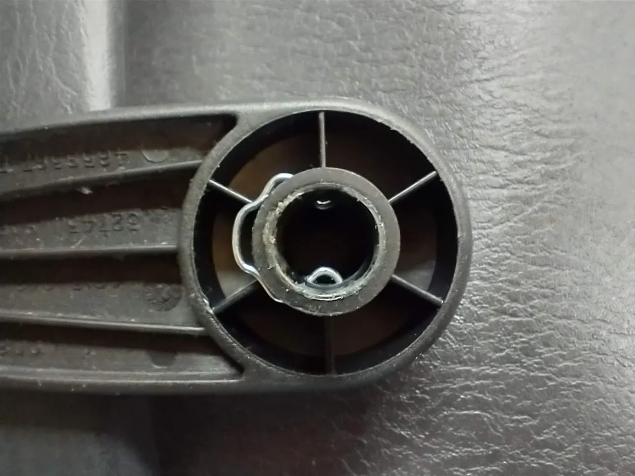

Remove the window crank. It's held on by this clip:
They say there's a tool for this that only costs $5. But I prefer to be frustrated so I just used whatever I could wedge in there and fought with it for a while until it popped out. As it pops out the clip is designed to go flying either out of sight or into your eye.

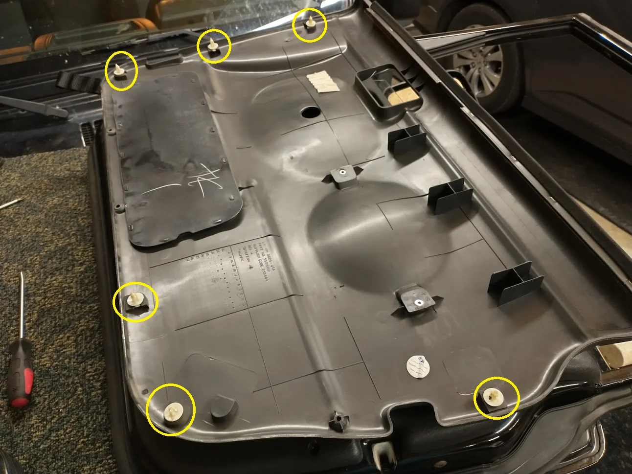

Pop the inner panel loose. It's held on by six plastic clips in these locations:

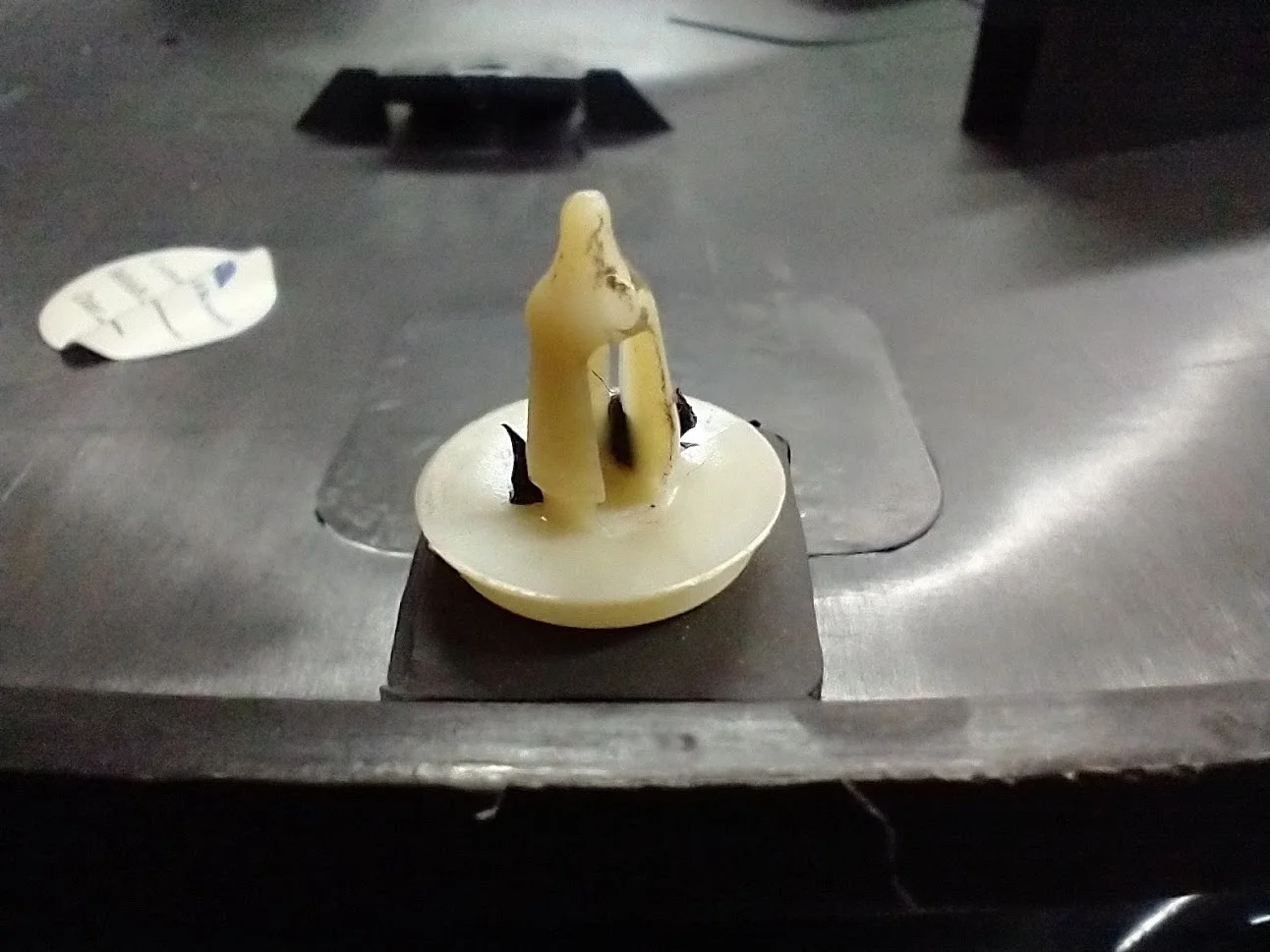

They look like this:
Don't worry about breaking them. You're guaranteed to break at least one so you're going to have to buy the replacement clips anyway. And the ones that don't break probably aren't going to snap back into place very well at the end of this job.

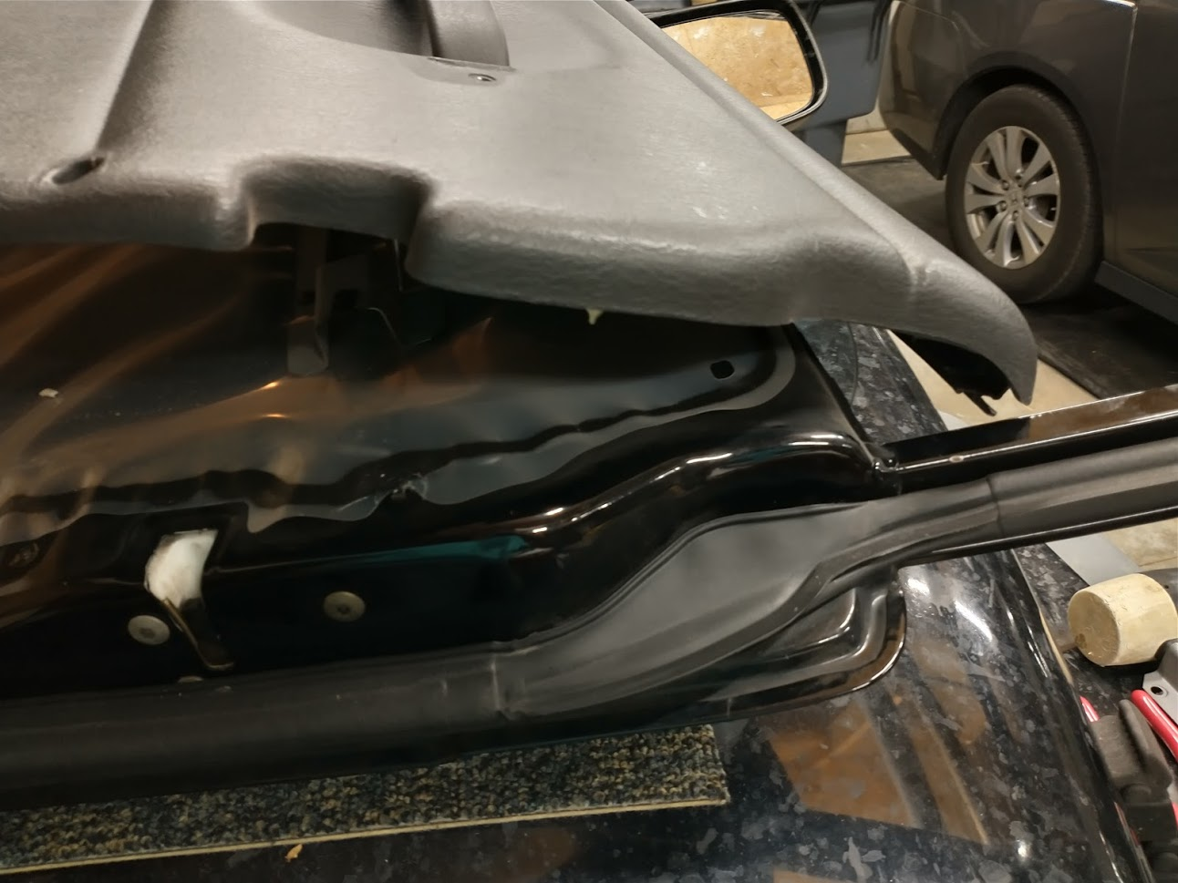

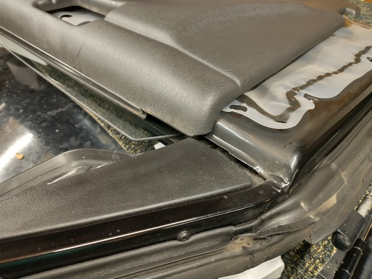

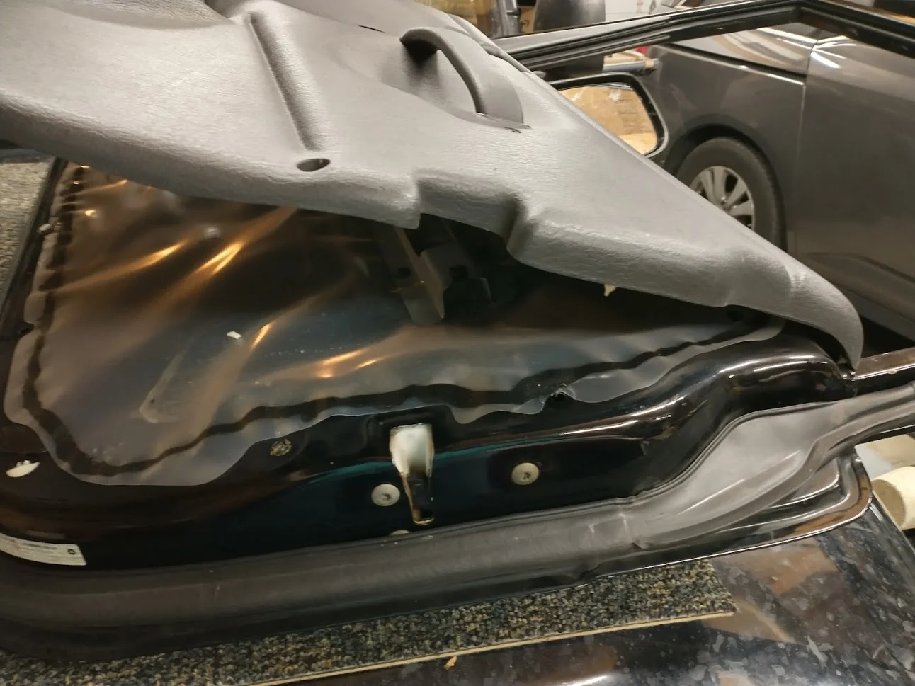

Once the clips have broken loose you'll notice the panel sort of hinges on the bottom of the window:
Slide it up:
Then slide it over away from the mirror:
And it should come right off after that.

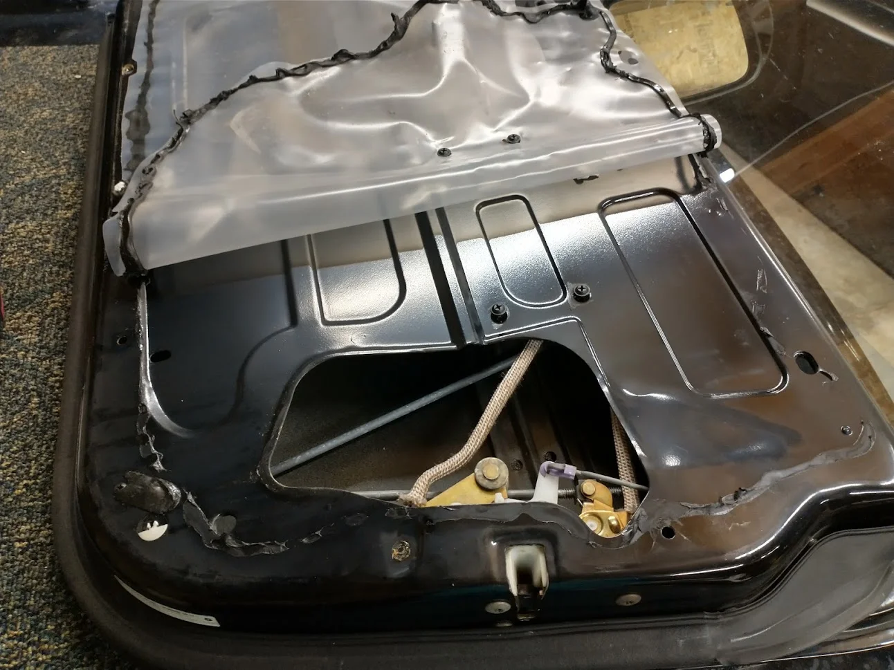

Peel back the plastic (after removing the metal frame that the grab handle was attached to):

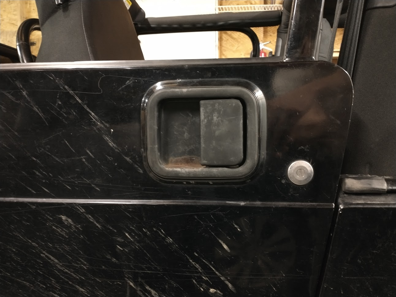

Remove outer handle​

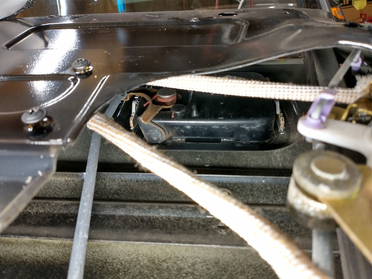

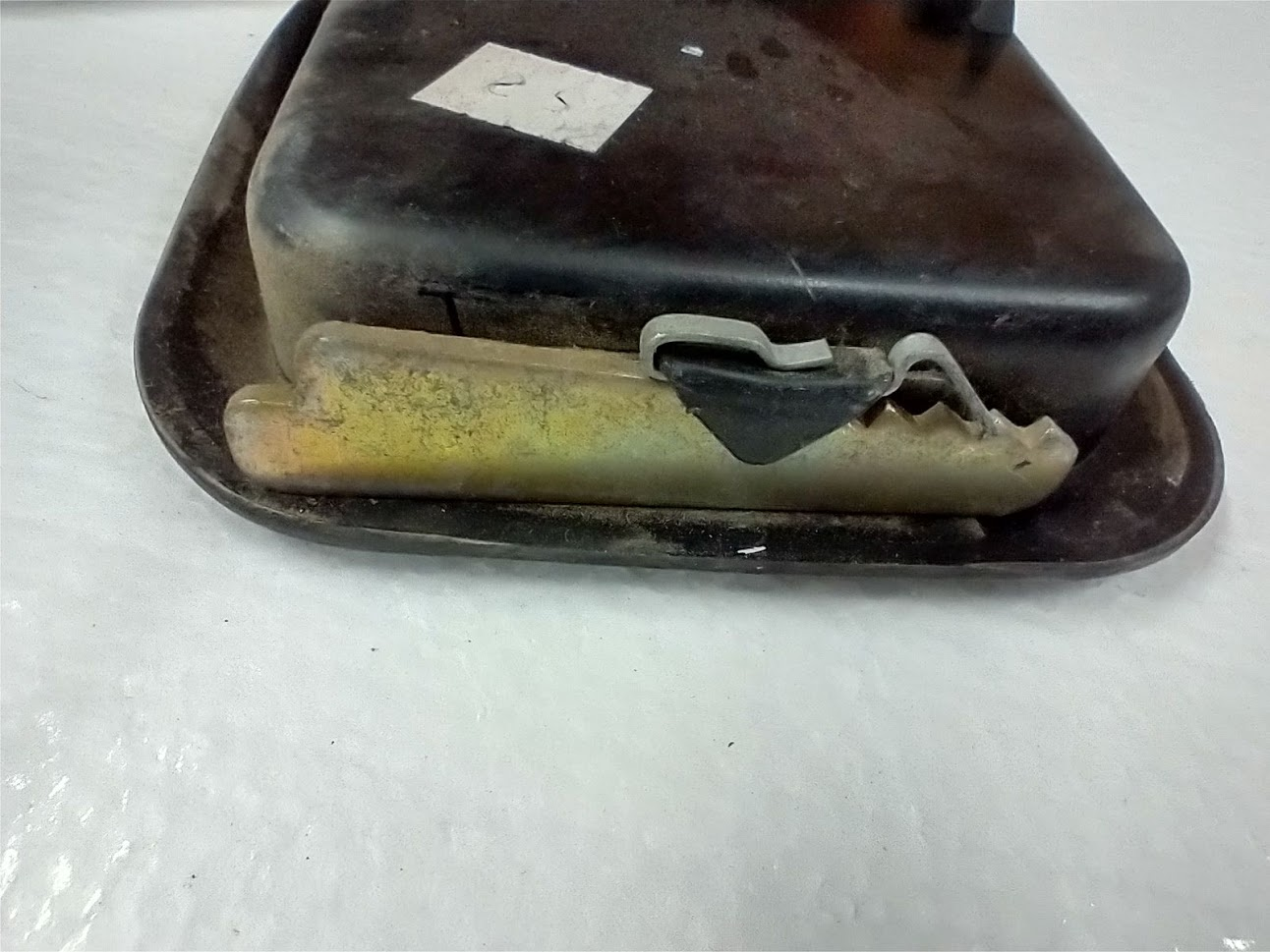

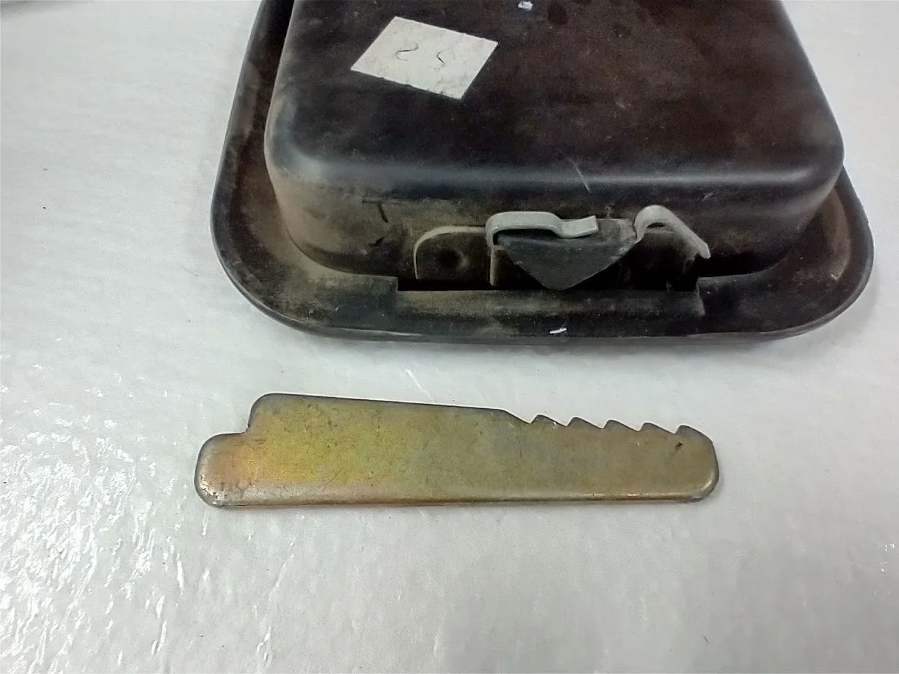

Now remove the outer handle. This part is kind of tricky. If you peek inside your door you'll notice the outer handle is held on by two keys (one on either side) that look like this:
The keys are wedged down and held in place by the little springs/clips. Here they are in situ:
You'll want to bend the spring/clips out of the way so that they don't engage the keys any longer. But be careful. Someone said they broke theirs and it was a pain to hack a repair. You get better access by rolling the window up.
Then you'll want to tap the keys gently to remove them. Getting them out once they're loose is kind of like playing Tetris in a tight space while blindfolded, so be patient.

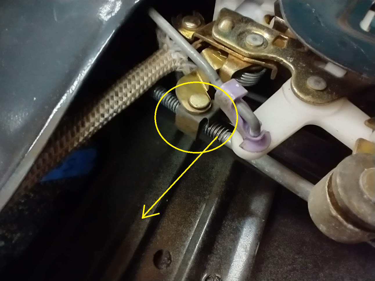

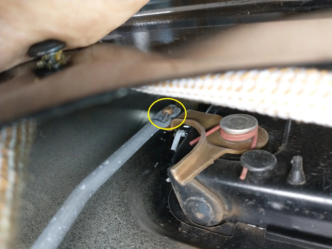

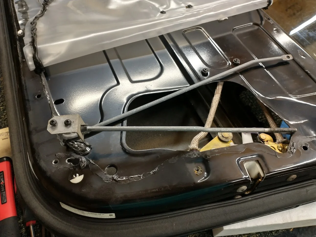

Next, remove this spring clip which secures the rod to the handle mechanism:

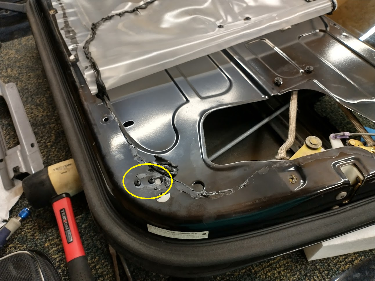

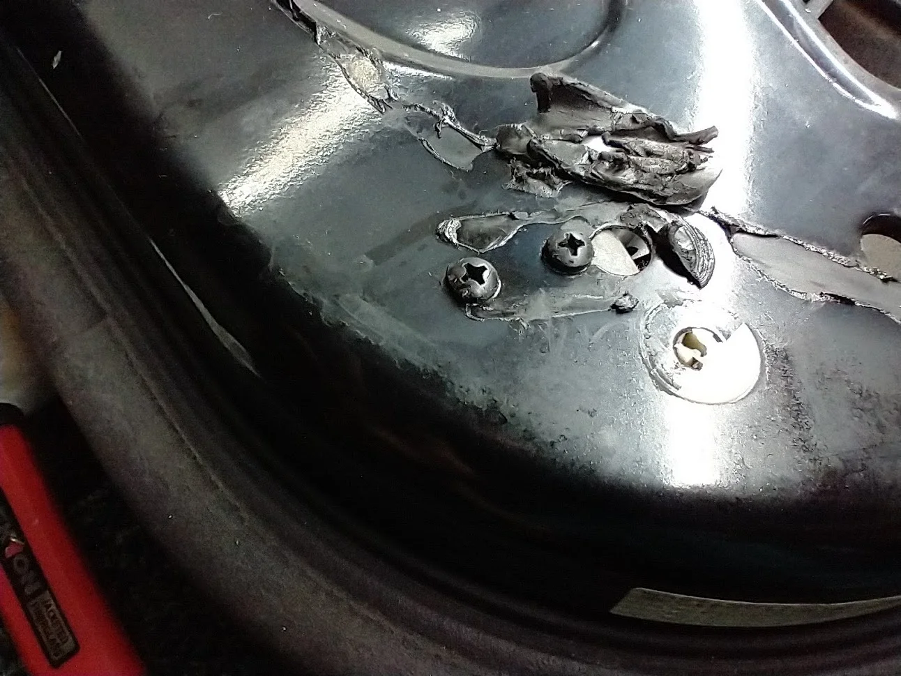

Remove these two screws. There is a piece of tape and some gooey gunk covering them. These screws hold that rod in place:
The one screw doesn't need to be removed completely because there's a slot:
Remove the rod from this snap/clip thing. It pops out when you pull the rod in the direction of the springy portion of that clip:

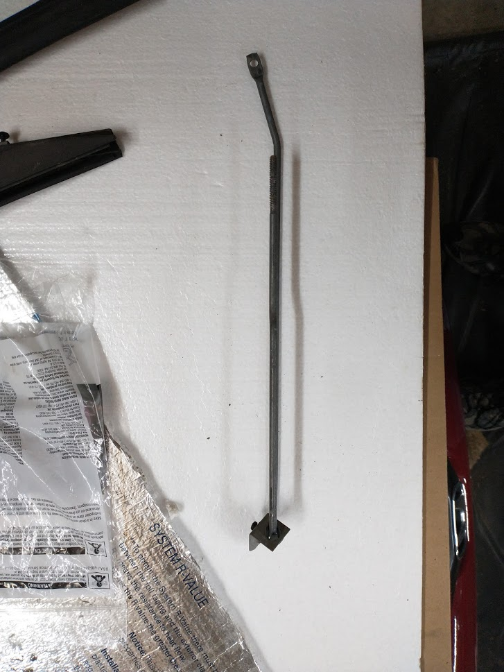

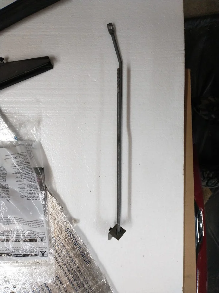

Here's the rod:

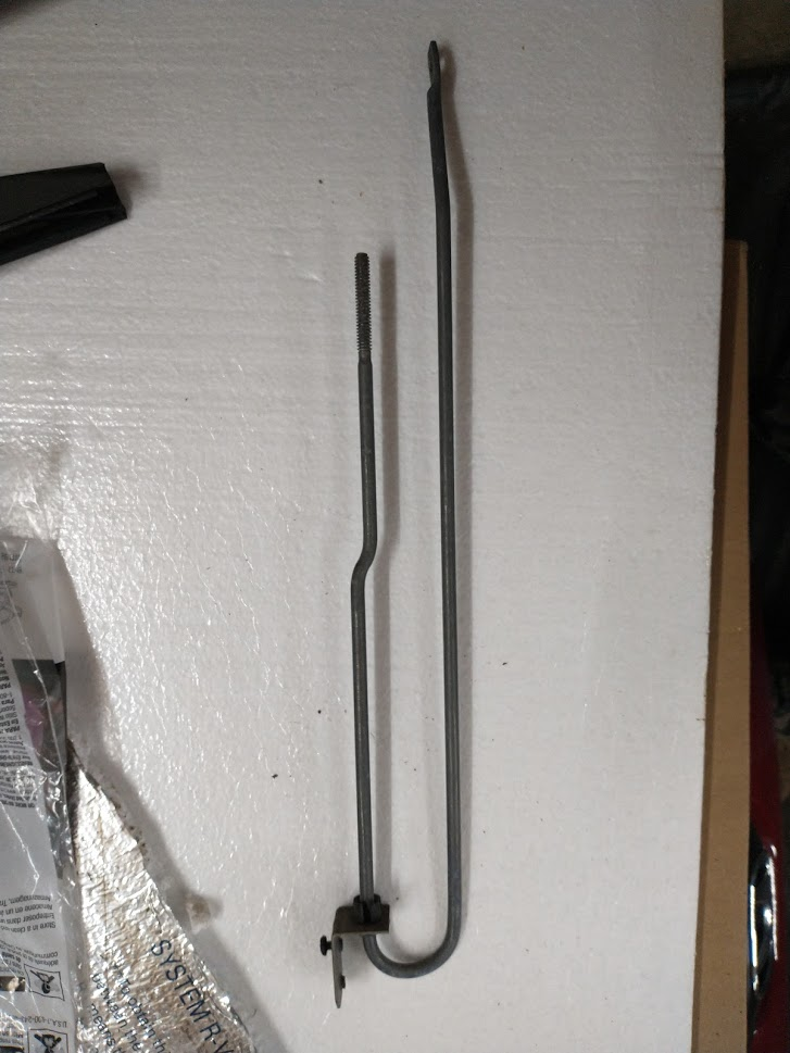

Bend and test fit the rod​
You're going to be swapping outer door handles and also the rods. You have to swap the outer door handles because the handles are supposed to push down on the rod. If you just rotate the handles in place 180 degrees then it will pull up on the rod and won't work. And if you swap the rods as well then you don't have to do as much bending.
Bend the rod so that it's basically parallel:
You'll also want to take some of the angle out of the smaller section (shown at the top of the below picture). This will make more sense when you test fit it.
Test fit the rods. Keep bending until you're happy with how they fit. Remember that the driver's side rod is going into your passenger side door and vice versa.
