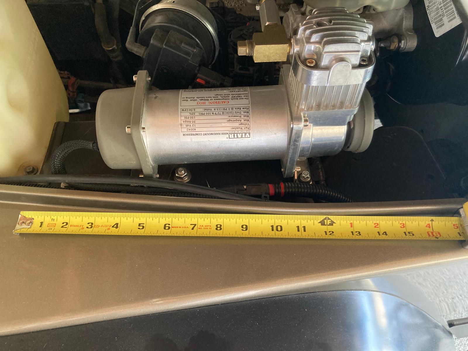

How-To: Simple Onboard Air for your TJ (Viair 400H)
Close up photo? I'm stirring up some ideas on how to mount this.
Here you an correction I only used 2 bolts and nuts I hope this help
