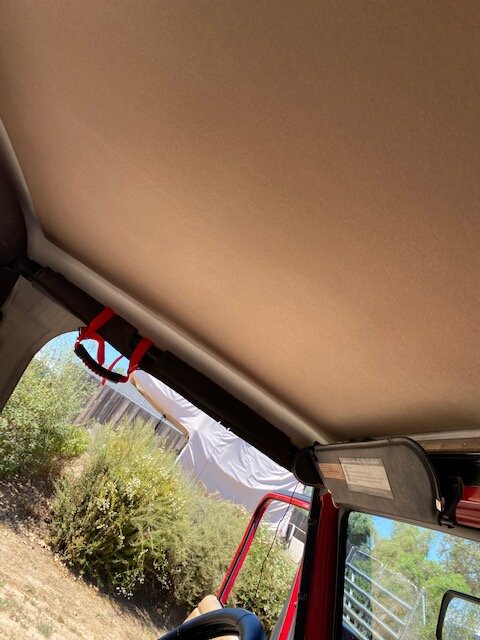

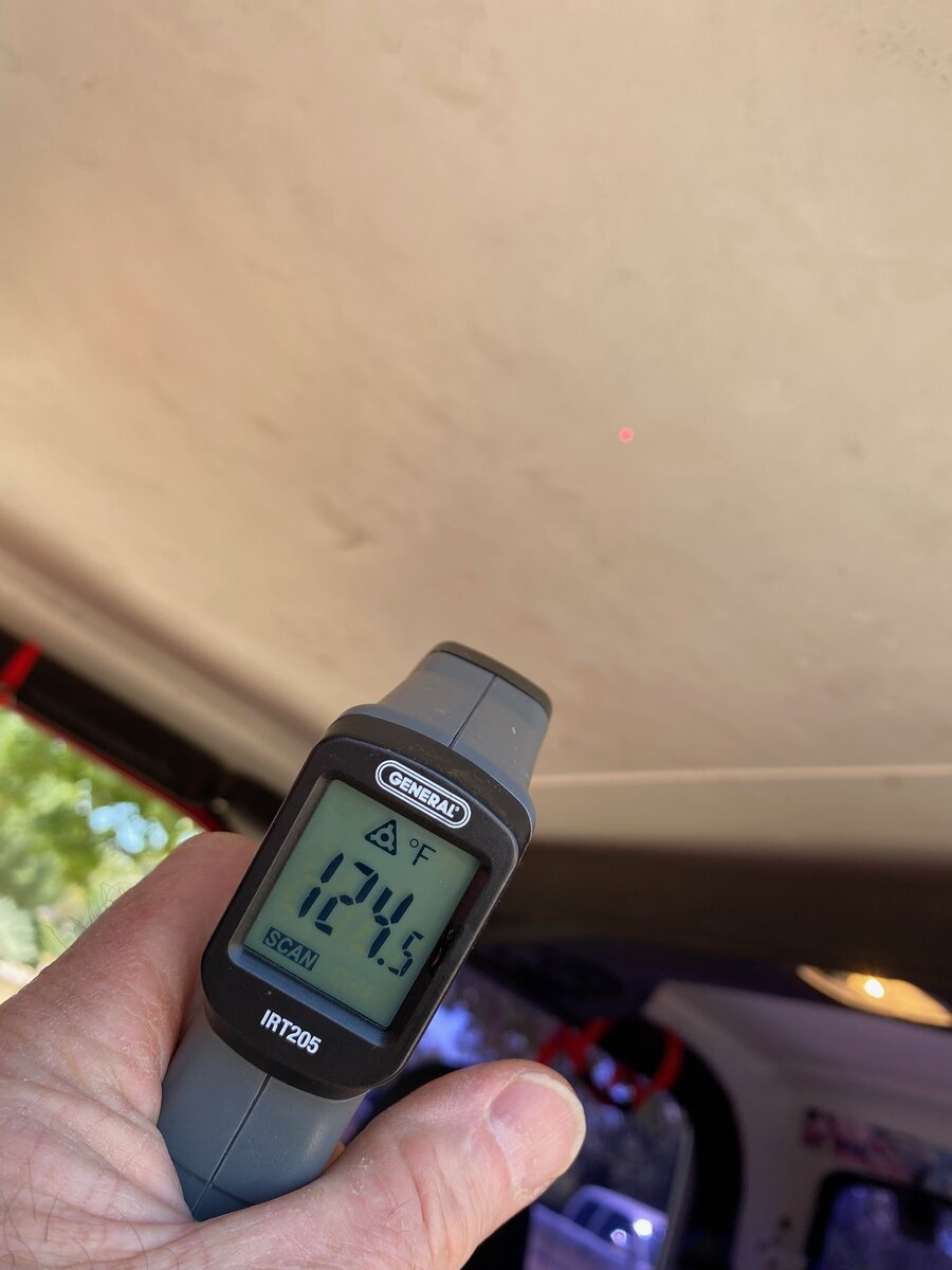

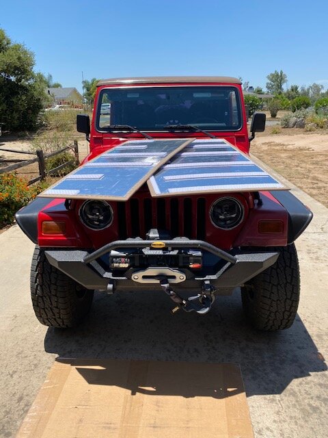

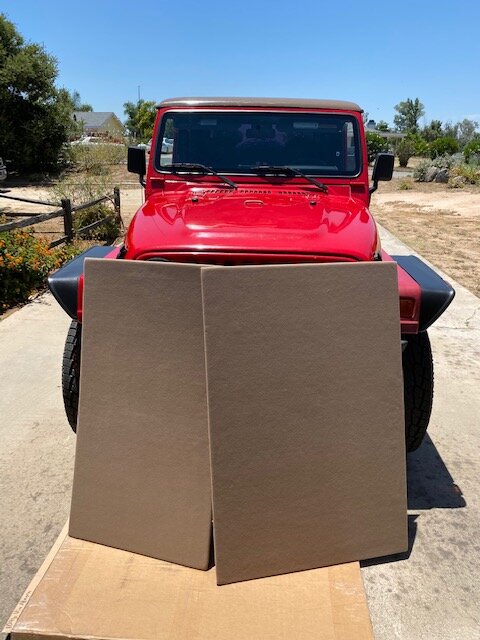

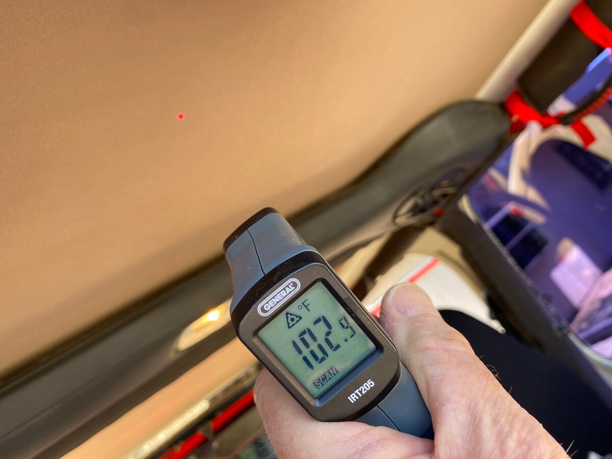

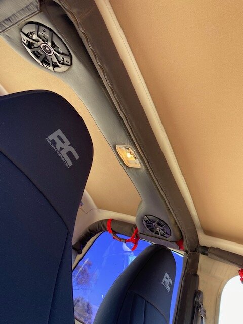

I have a hard top (had zero insulation) and installed a product from HotHead HeadLiner (see photo) and this Siless Liner 157 Mil Aluminum Foil finish car sound deadening & heat insulation throughout the cab. As you can see the headliner reduced the temp by 20 degrees and with the foil material throughout the entire floor, under the seats, under the console, in rear part of the Jeep reduced the temp by 10-15 degree but most importantly reduced the decibels inside the cab. As you mentioned my significant other also noticed how much quieter the cab is and most importantly the AC is not running on High to try to cool use off.

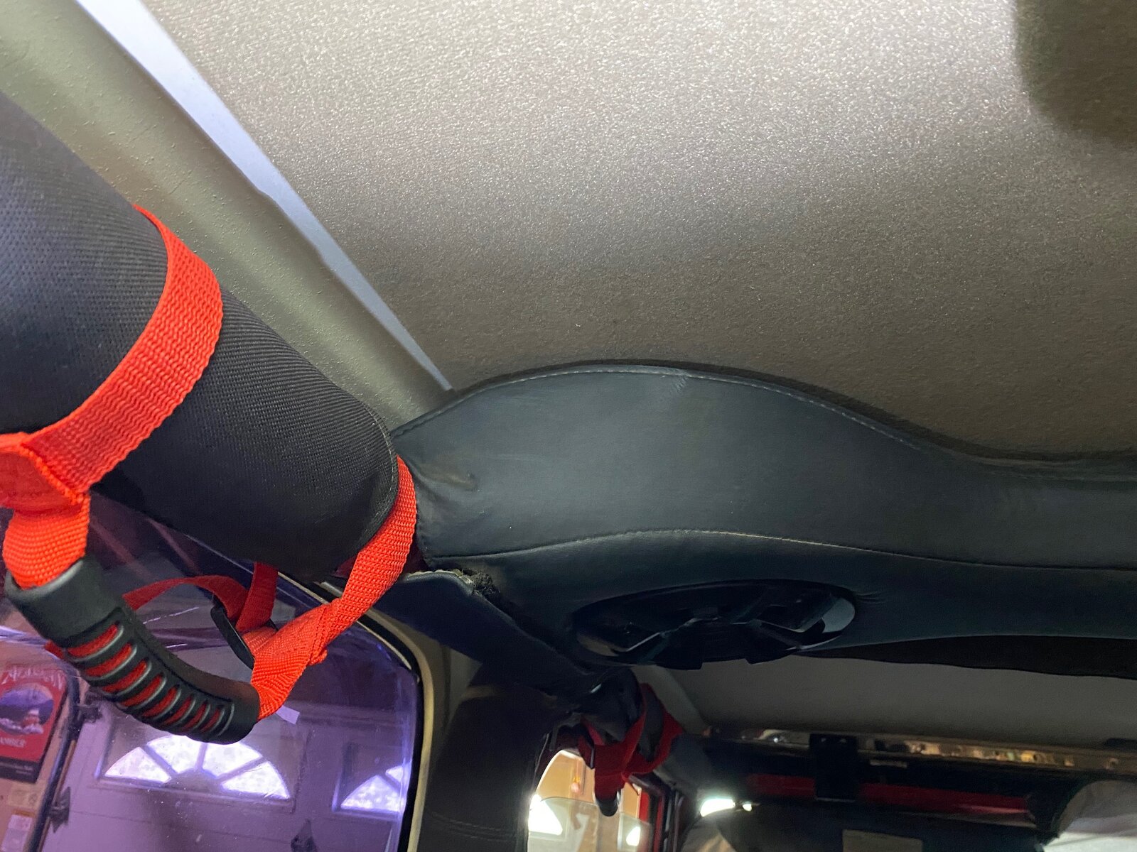

@Larry97TJ Hotheads says their headliner can be installed with the top on but on a dry fit, I can't get mine past the speaker bar. Did you take you top off to install? Any other tips? Thanks!

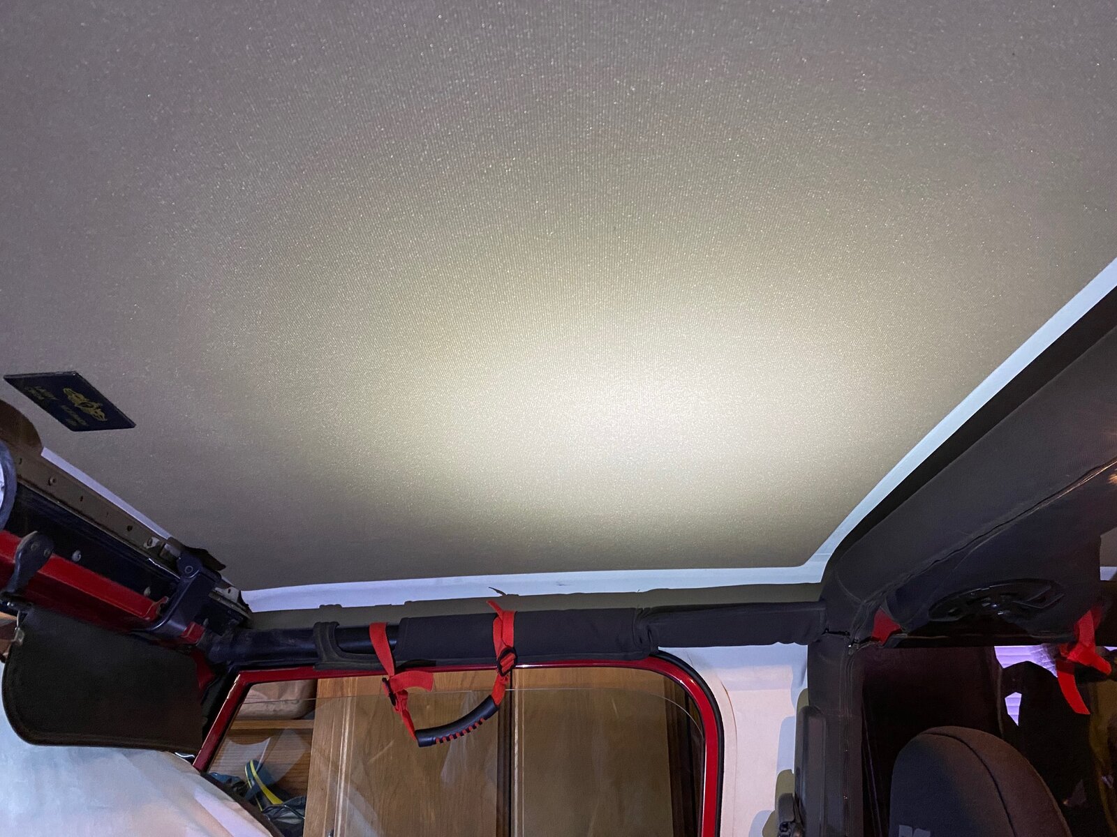

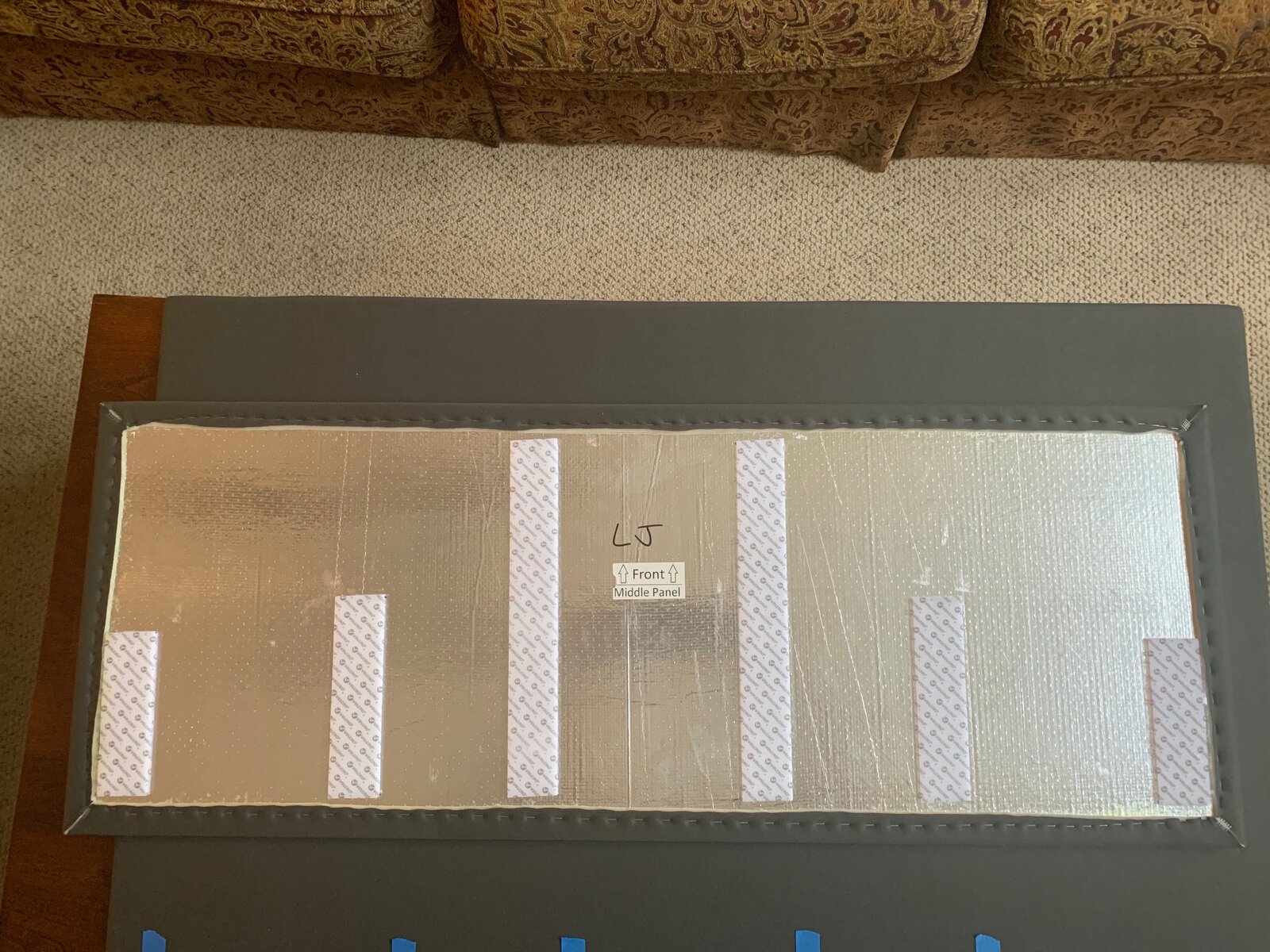

I just installed my Hothead liner in my LJ. I had my hardtop off as I was doing other work to it. I actually sent this picture to Hothead as I thought they had shorted me some velcro in the middle panel (LJ has three panels vs 2). They responded quickly saying that there was no velcro there because of the sound bar. Now that my hardtop is installed with headliner I see the headliner is resting gently on the speaker pods. It might be tricky to get it in the right spot while avoiding sticking the adhesive side of the velcro to the wrong spot on the top. The velcro hook and loop sticks much better than the adhesive in my experience. If you cant take the hard top off you might consider installing the velcro strips separately rather than following their directions.
You could also loosed the hard top and stick pieces of wood between the tub and hard top to give you more room.

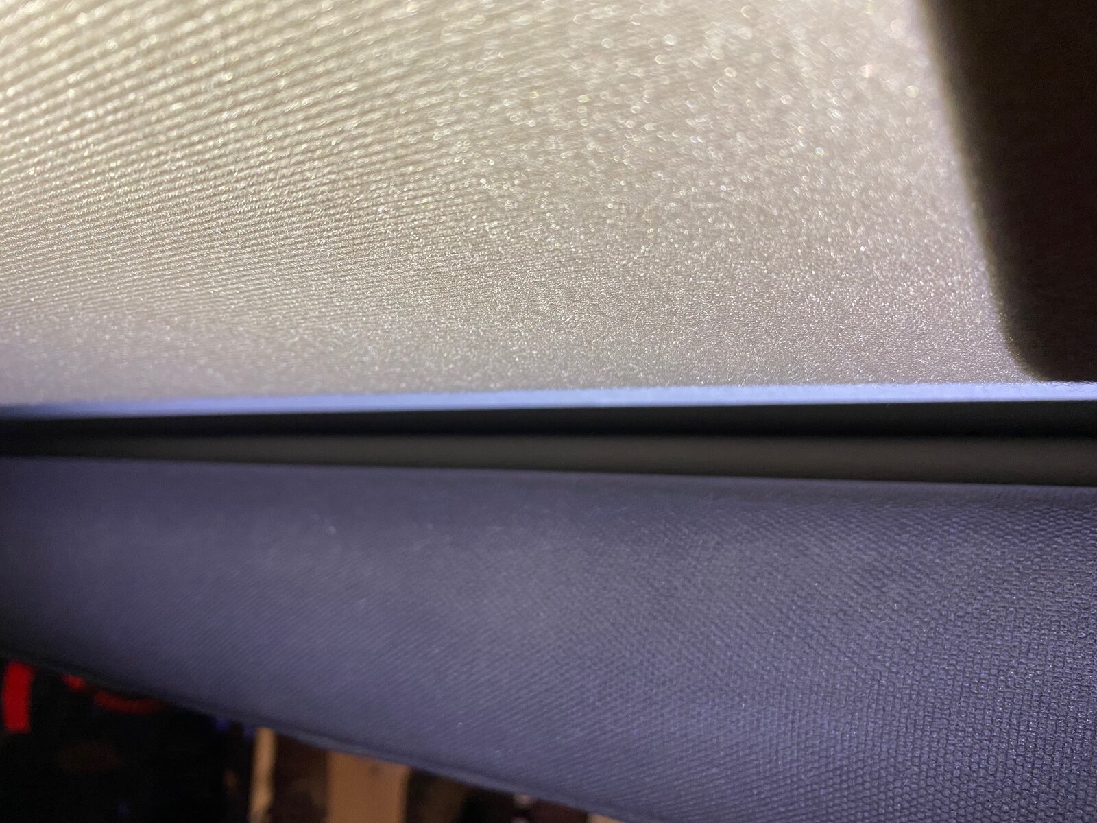

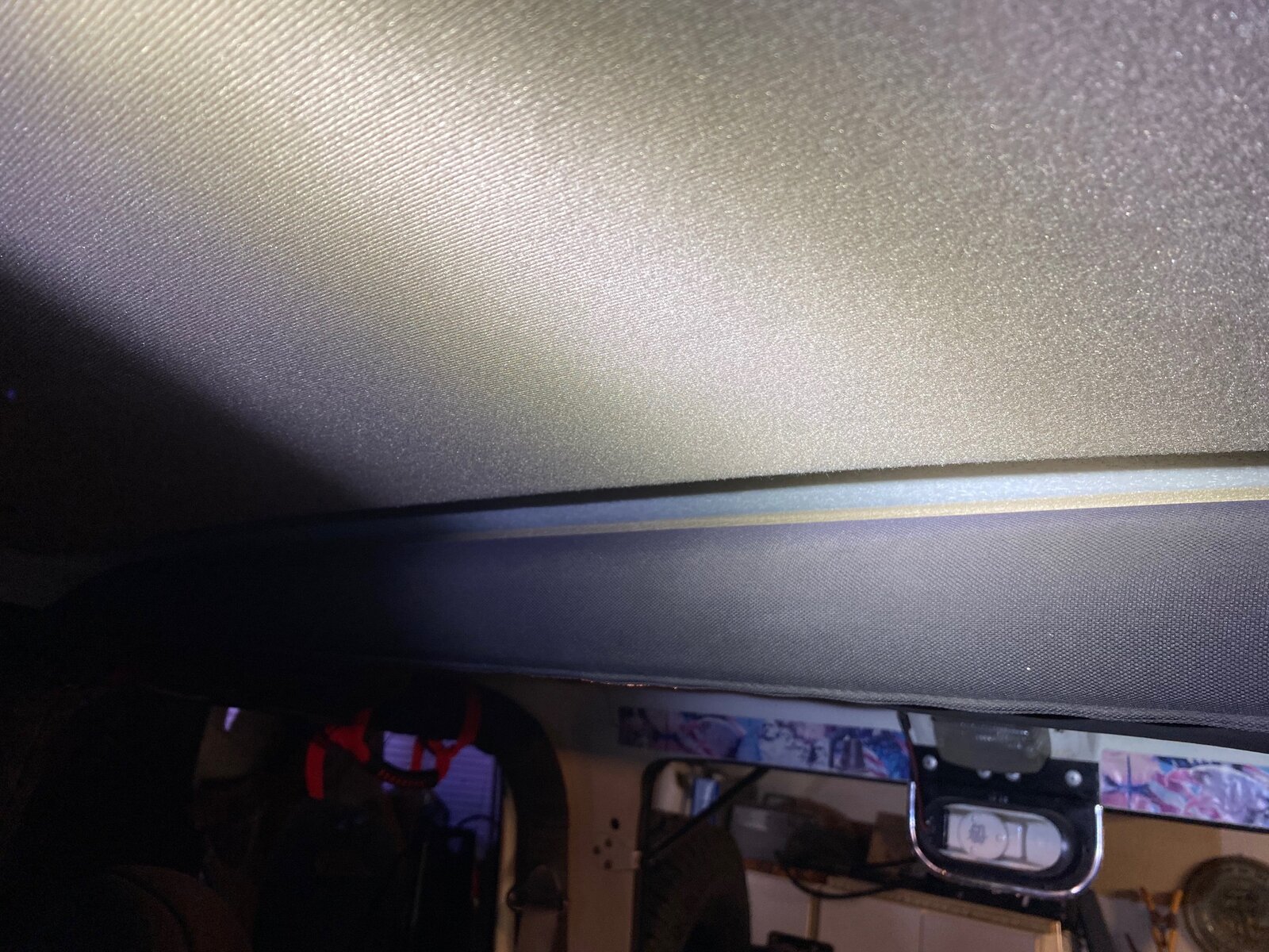

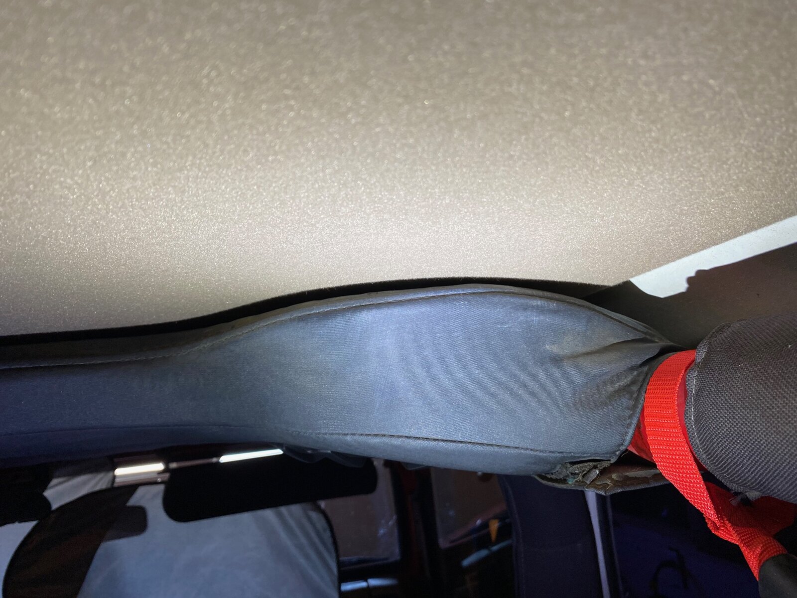

I didn't have to take my hard top off. It was a tight fit and I followed the process included in the package/box i'm pretty sure I had to slightly bend the rear piece/panel to fit up past the speaker bar (during my dry run).
Tips: Do a dry run and leave all the tacky super Velcro in place on the headliner and insert/slide under the speaker bar (it will be snug) to make sure it fit up. Use blue tape (or something similar to mark the location of the Velcro location to make sure the Velcro was positioned correctly. Once you have figured out a dry run fit up wipe the hard top down twice Or three times with Acetone.
I've attached some images to give you an idea my space between the speaker bar and hard top roof (about 1").
