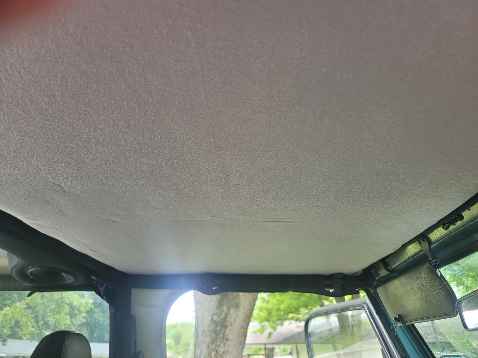

The front panel is darn near perfect. The back one's fabric got ruffled because I had to keep pulling it out and putting it back in adjusting the spacers so I'll pull it and tighten the fabric again soon. Easy fix, but I'm waiting until I get my CLD so I don't have to pull it yet again.
I did this last month and I have to say it's a night and day difference. Going to the hard top alone made it quieter, but with these headliners it's now quieter than some cars I've ridden in. Once I CLD it it'll get even better.
A wonderful benefit is how much more bass my stereo has. The hard top added 10 dB (doubled) my bass, the headliners added another 10 dB, and now I can turn the volume way down and still enjoy it.
I was skeptical when I started but my car audio buddies insisted, and now I'm blown away.
Impressive sound results

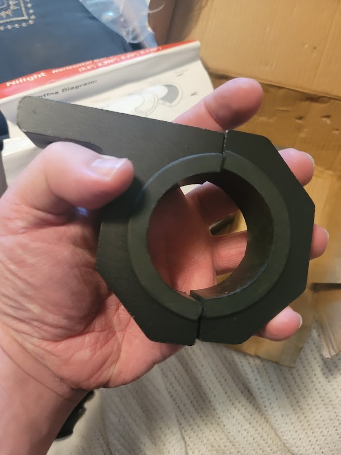

How did you attach it to the hard top??

Lots of questions! Happy to answer.

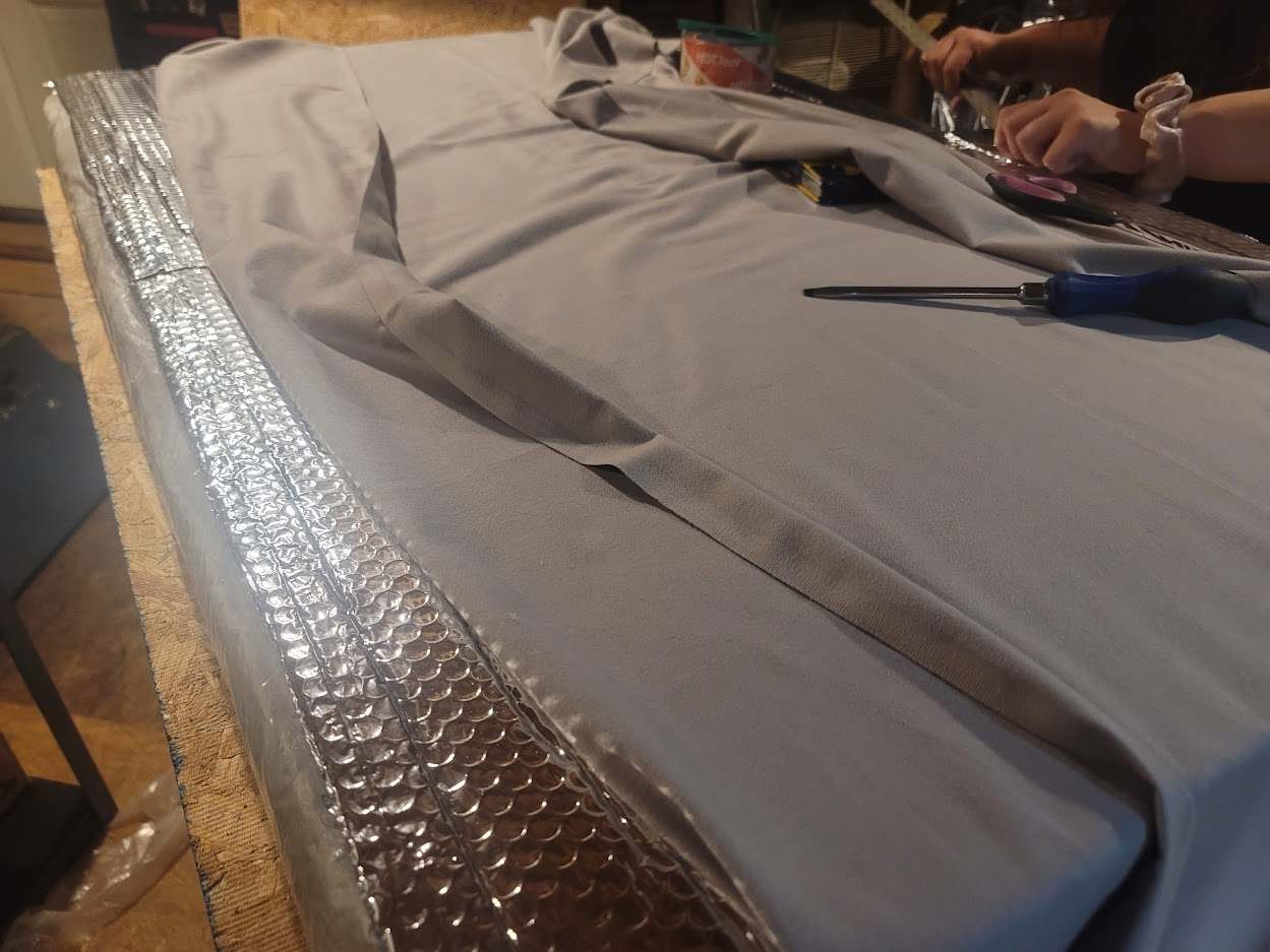

The headliners are two separate panels. I used 1/2" plywood, though at some point I'll redo them with 1/2" MDF for rigidity. The insulation is Rockwool, 3" thick (pick up the sound treatment kind, it says it on the label, got mine at Lowes), and attic heat shield which is, I think, between 1/4 and 1/2 inch.

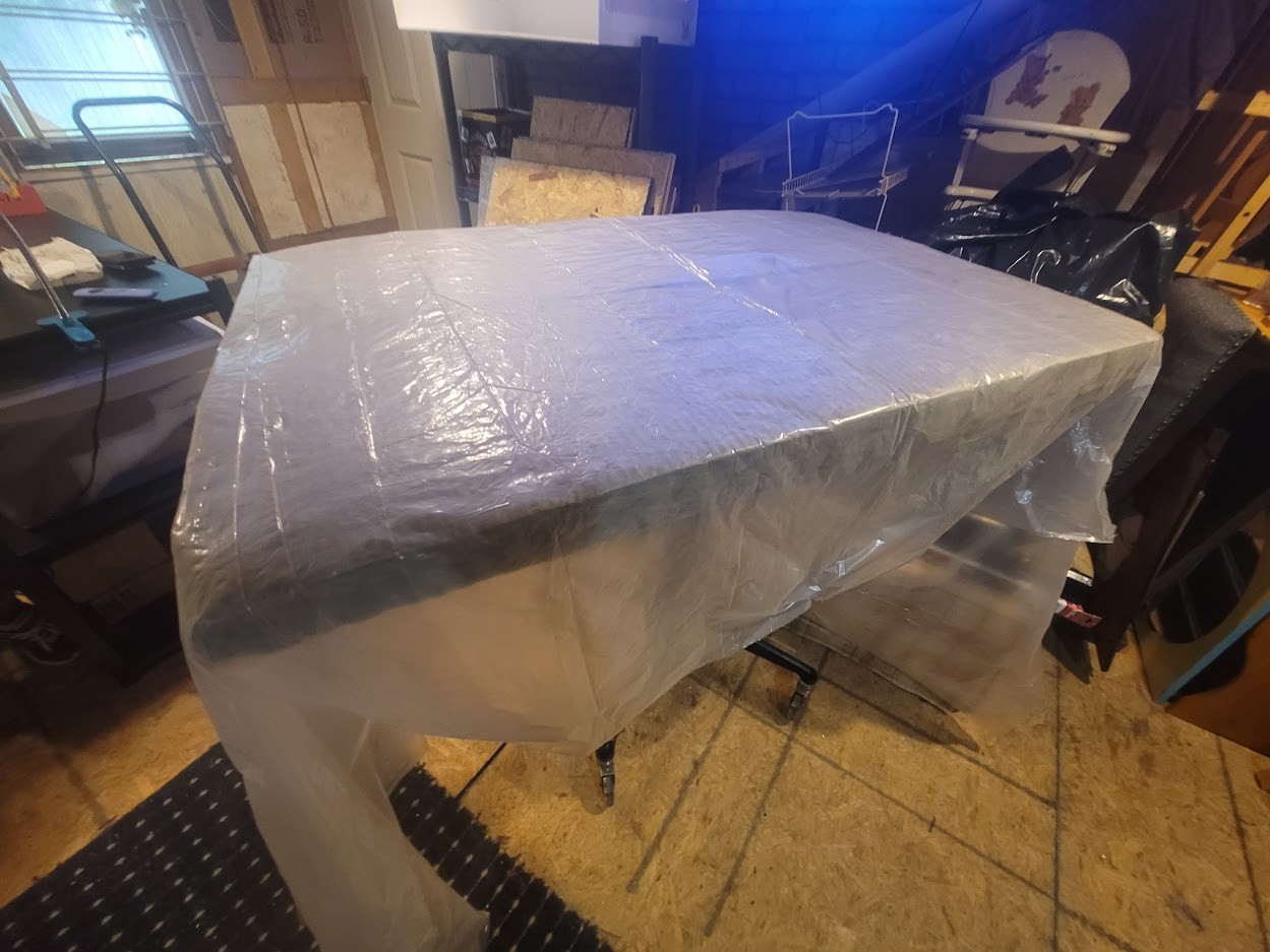

The Rockwool is wrapped in 1mm plastic drop cloth. I have the insulation spray glued to the board, then the plastic stapled down over it. The heat shield I have on top of the Rockwool and on the opposing side of the plywood. Cloth is stretched over the side opposite the Rockwool.
It's attached to the rollbars with these beefy bastards:
Rollbar accessory clamps for things like lights. They're solid, and would probably hold up my weight.
When mounted the headliners are thick enough to put pressure against the top but not so much that the insulation is smushed flat. Flattened insultation doesn't work, the more compressed the less temperature and sound resistant it is, but the more pressure against the top the more resonance is taken out. If you whack your hand against the hard top it sounds like a drum (resonance), with the headliners on it sounds like I'm thumping a table. They aren't attached at all to the top itself, I didn't want to drill holes or harm the structural integrity at all. With this setup all I have to do is remove the panels from the clamps.
I'm super tickled about how well this works out. The color almost exactly matches the original interior of the hard top which I at first disliked but now I like how "open" it makes the Jeep feel inside. The sound reduction is so drastic it actually feels like a car. It's incredible. I've always loved riding in my Jeep but now it's even more appealing, with the windows rolled up the world gets tuned out. Even the engine sound is reduced.
