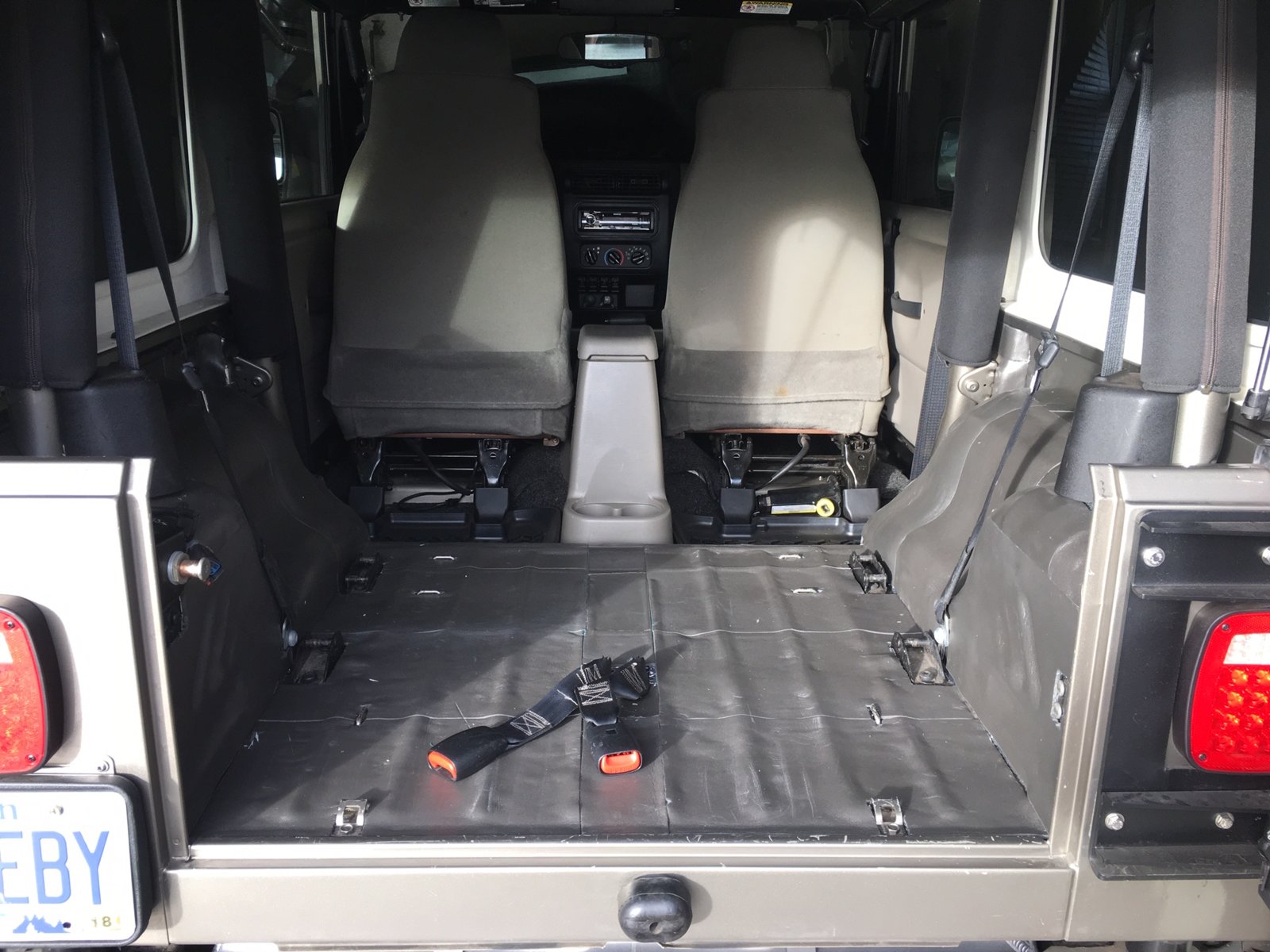

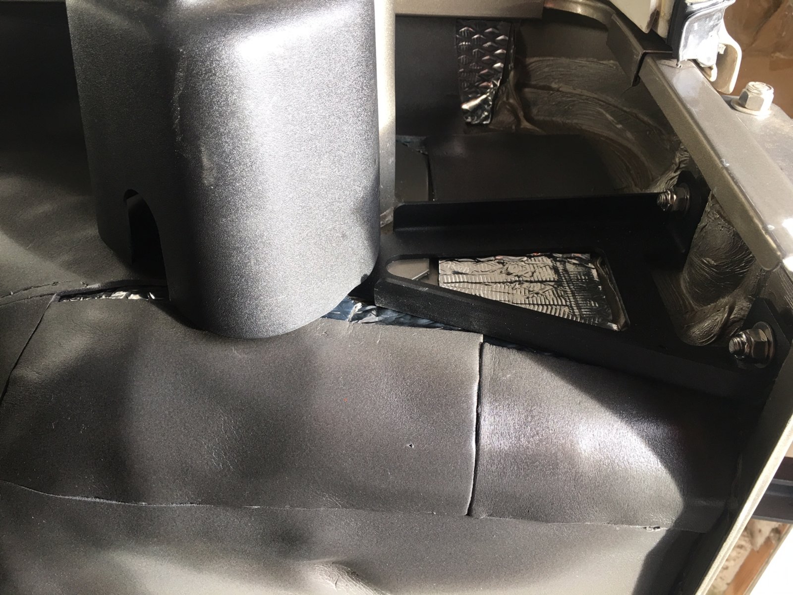

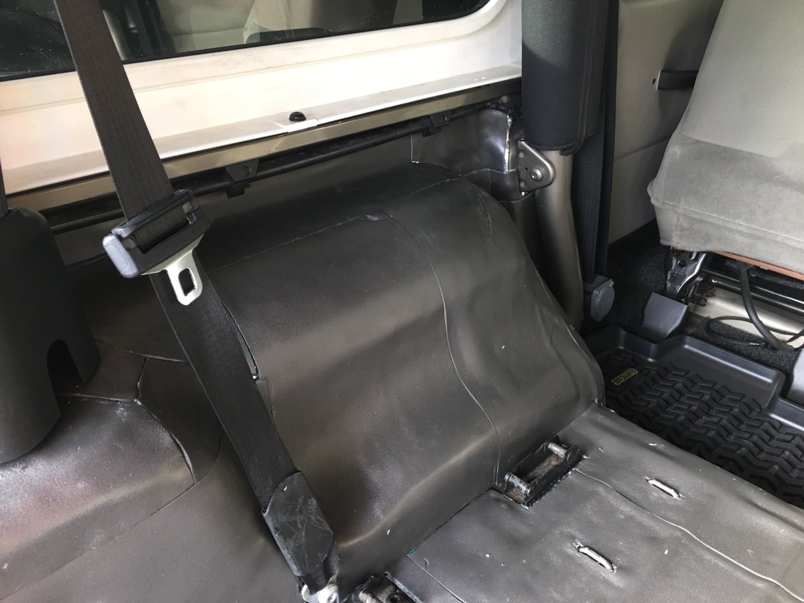

Following @mots lead, I finished insulating the rear of my TJ today.
I used the Noico 80 mil sound deadening material as the base. I went a step further than most of these other guys though and used the Noico 170 mil insulation on top of it.
Here's some photos of the finished product:
Tomorrow I'm going to do the front, which should hopefully be easier than the back. I'll tell you, even with as pliable as this stuff is, doing the rear was time consuming, and a pain in the butt due to the curvature of the wheel wells. I had to do a number of smaller pieces to fill in the areas that the material wouldn't easily conform to.
It looks excellent though, and with 250 mil of material, this should make the inside much, much quieter.

Great job! And it actually matches your interior well. I don't think I would even notice any of it that ended up outside of your carpet.
I know! That grey layer of insulation looks good enough that any of it left exposed won't be noticeable. I'm happy with the way it turned out. Time consuming for sure, but this should be worth it I think!
How long did it take you to lay just the first layer of sound deadener down in the back?
I would say 3 hours if you include cleaning and prepping, taking the seat / carpet out, and cutting everything to fit. The stuff goes on easy and is very pliable, but like I said, you have to take your time on the curved surfaces, as you don't want to do it sloppily.
The second layer actually went down a bit easier, but I think by that time I had gotten the hang of it, so I was moving faster.
The front actually looks easier mostly just because I can lay down huge strips to go over the tunnel and into the floor pans. I'll have the front done tomorrow.

I'll bet if you drove your Jeep right now. You'd notice the difference even with just the back done. I think that combo you used is a killer for sound.
I'm sure you're right. I'm also going to add the Hot Heads headliner to the hardtop, and put this material inside of the full doors. I'm going to try and get it as quiet as possible, especially with the headers going on.
