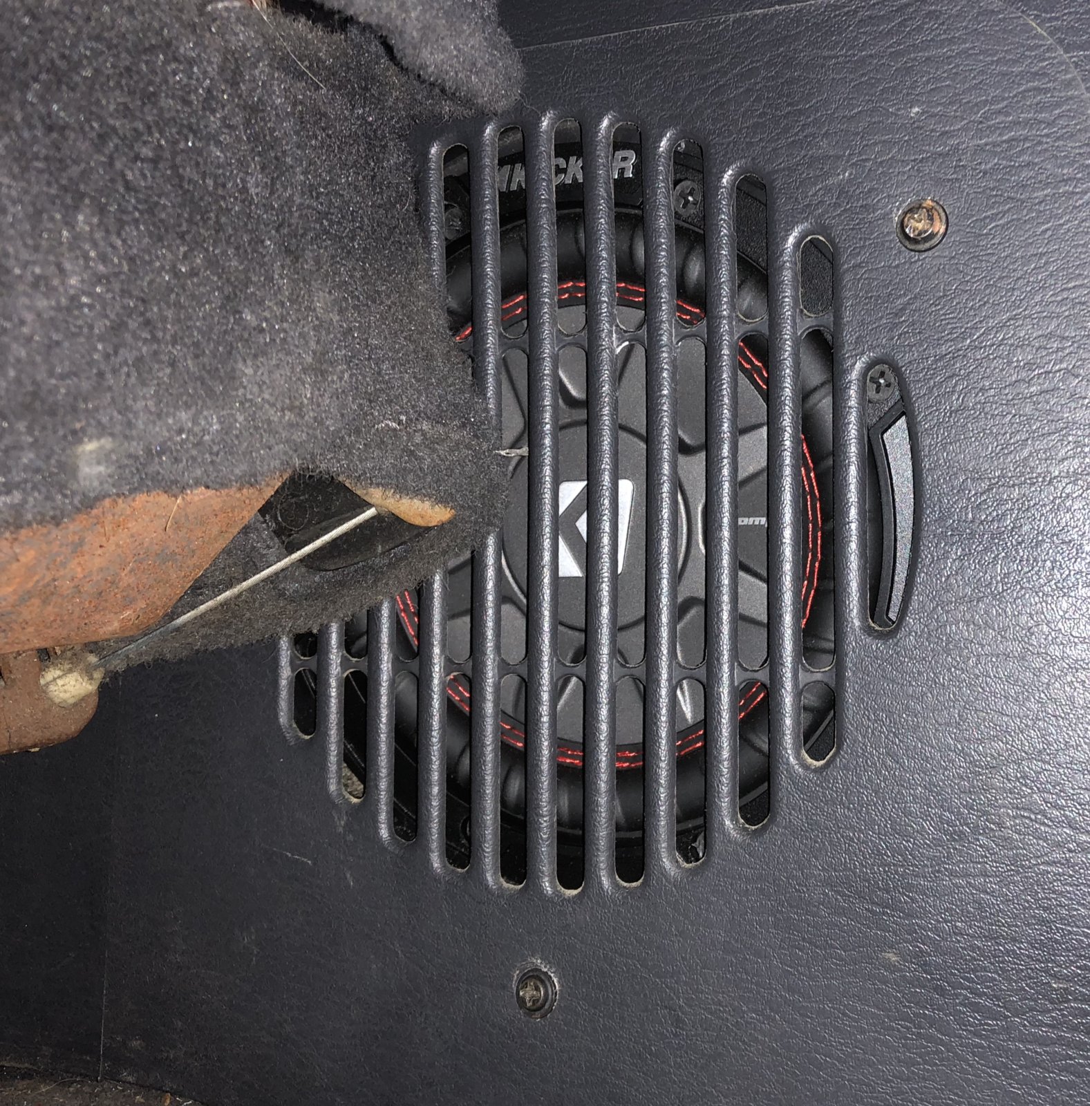

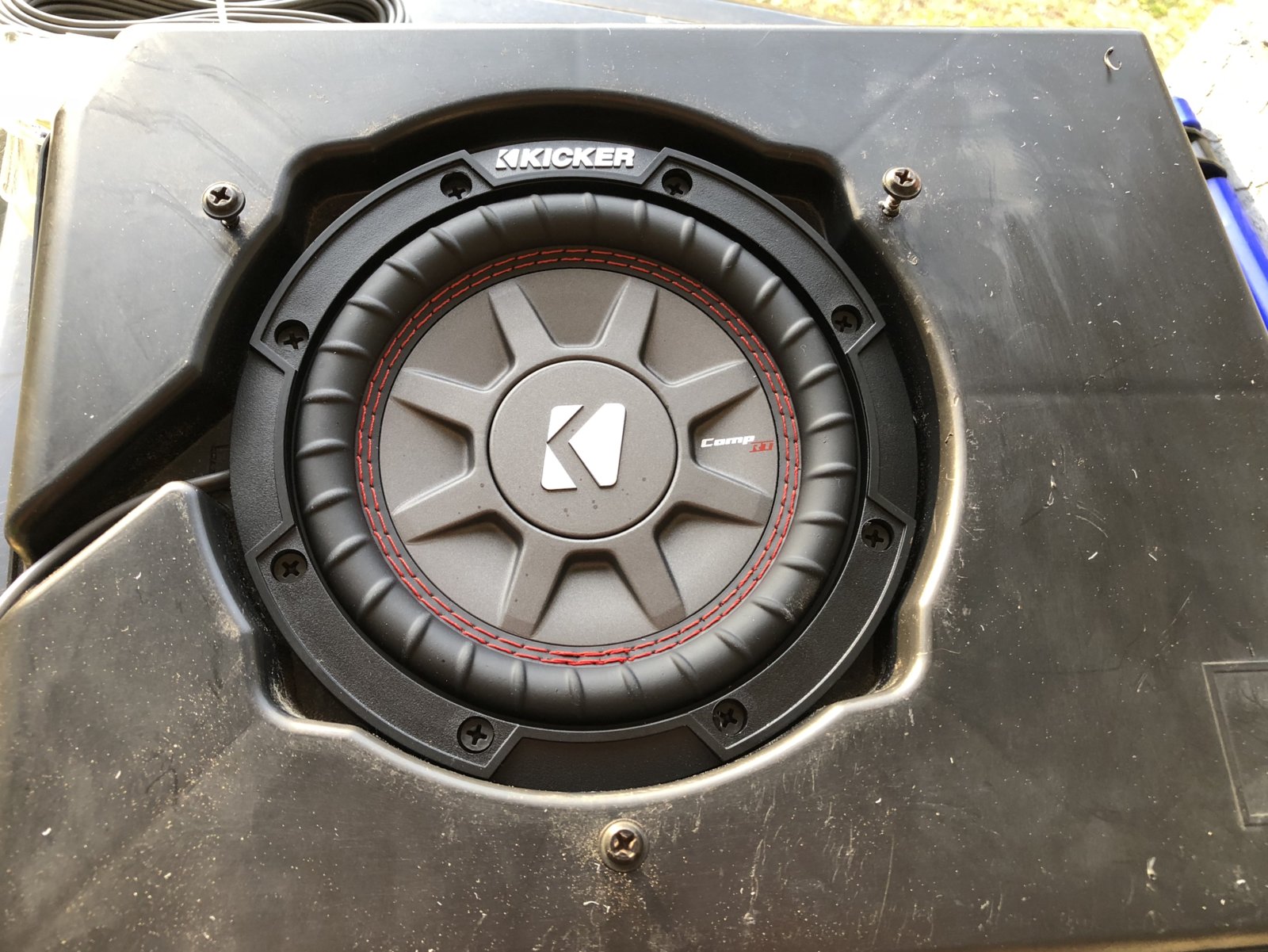

    I had the same problem. My stock subwoofer rarely if ever worked.
    After reading the various threads, I bought this amp and subwoofer. Both are currently in stock with Prime shipping. I haven't had any issues running the amp @ 0.5 ohm. it shows rated for 200 watts @ 0.5 ohm in the description. You could always use the 2 ohm sub and run @ 1 ohm load on the amp if you wanted less bass.
    Kicker PX2001 200 W Mono Subwoofer Amplifier
    https://www.amazon.com/gp/product/B0078G38YY/?tag=wranglerorg-20
    Kicker 43CWRT671 COMPRT67 6.75" 300W DVC 1-Ohm Car Subwoofer
    https://www.amazon.com/gp/product/B01BLVEZG6/?tag=wranglerorg-20
