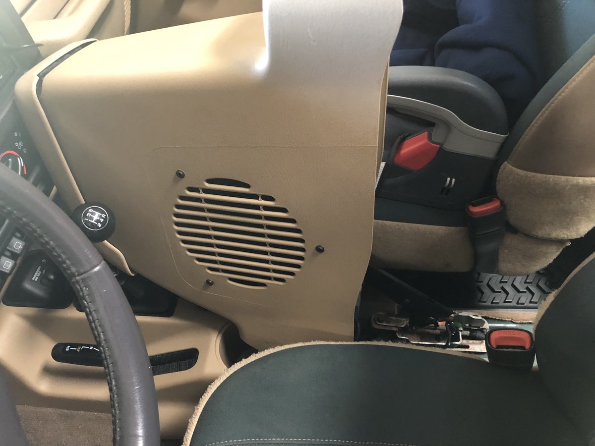

first was removing the console - pretty easy.

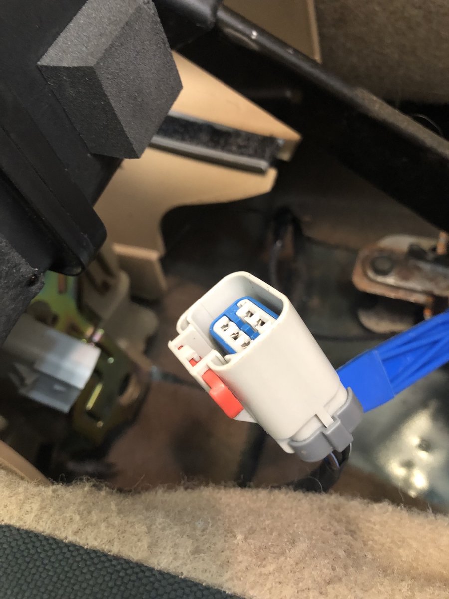

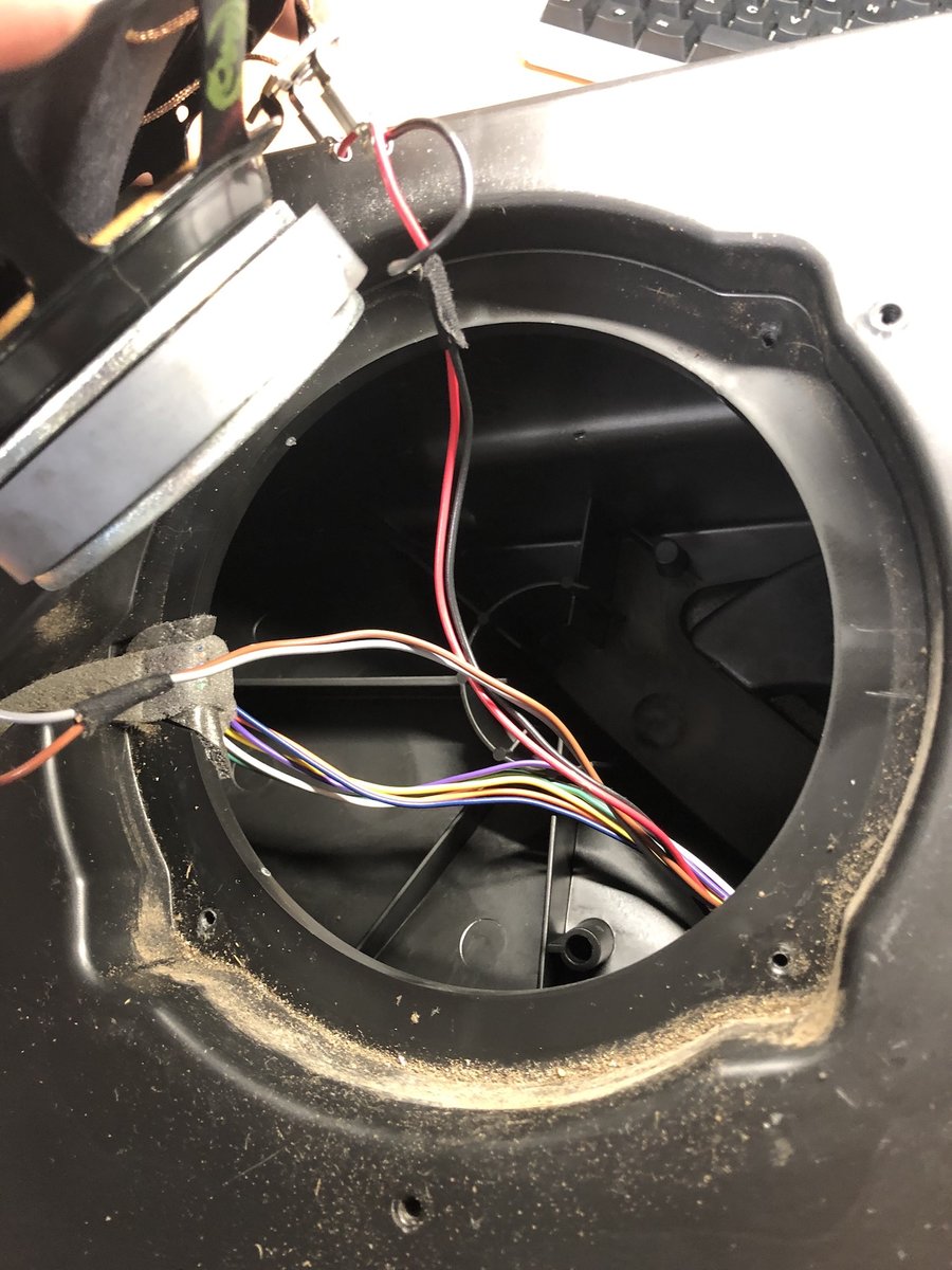

but I almost broke this connector... I was trying to unplug it at the dark grey point near the harness.

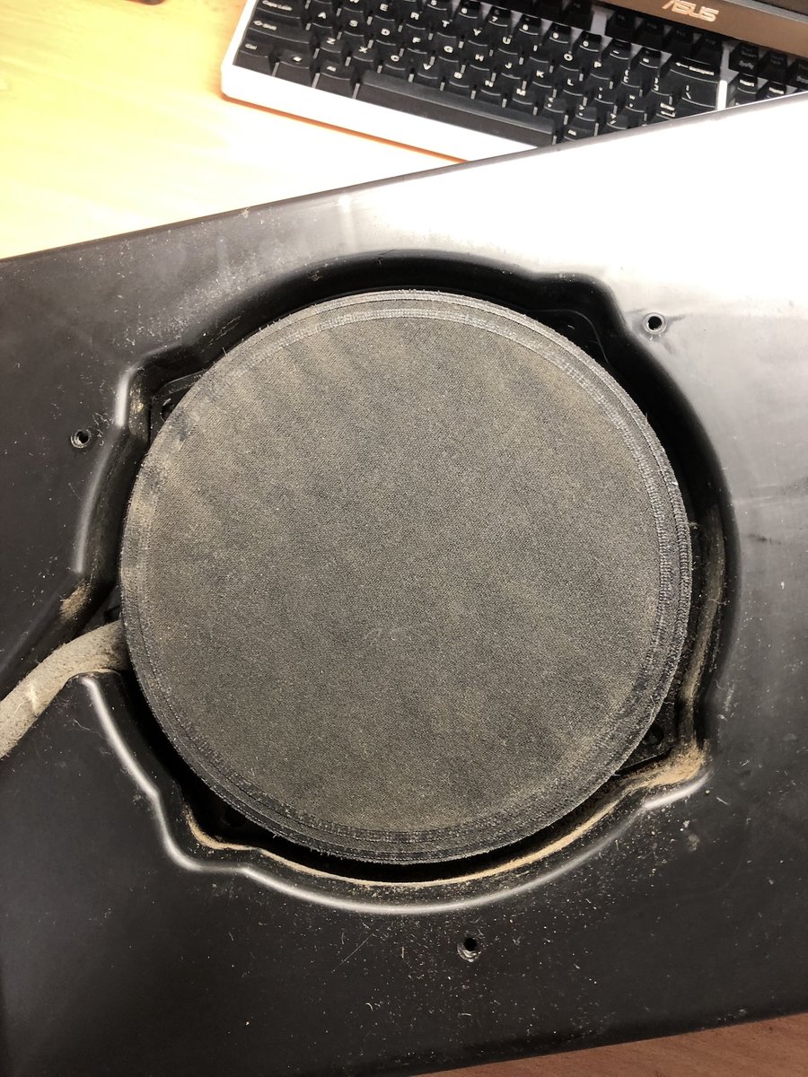

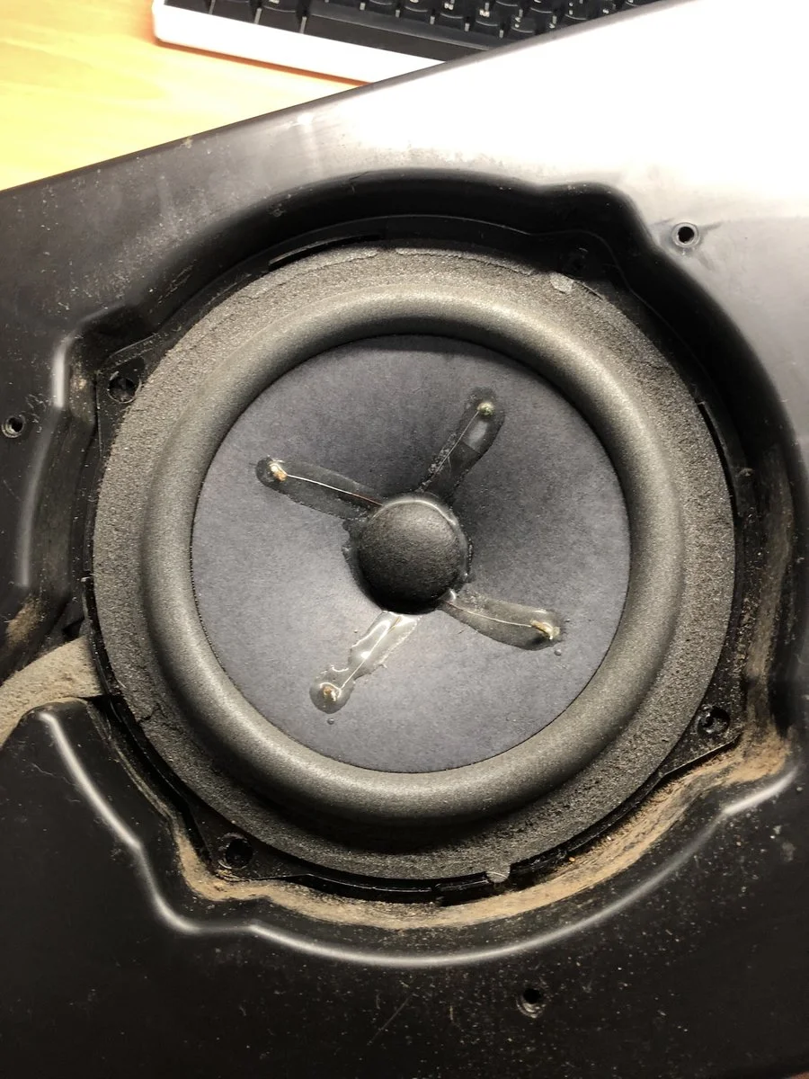

I was able to save the little washer-nuts that hold the outer console onto the inner console (or vice versa). My sub had this cover over it, which broke off when I tried to remove it. It was just glued on.
the sub wasn't damaged nor had it deteriorated like I've seen.

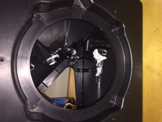

the factory sub, amp, and heatsink were all removed.

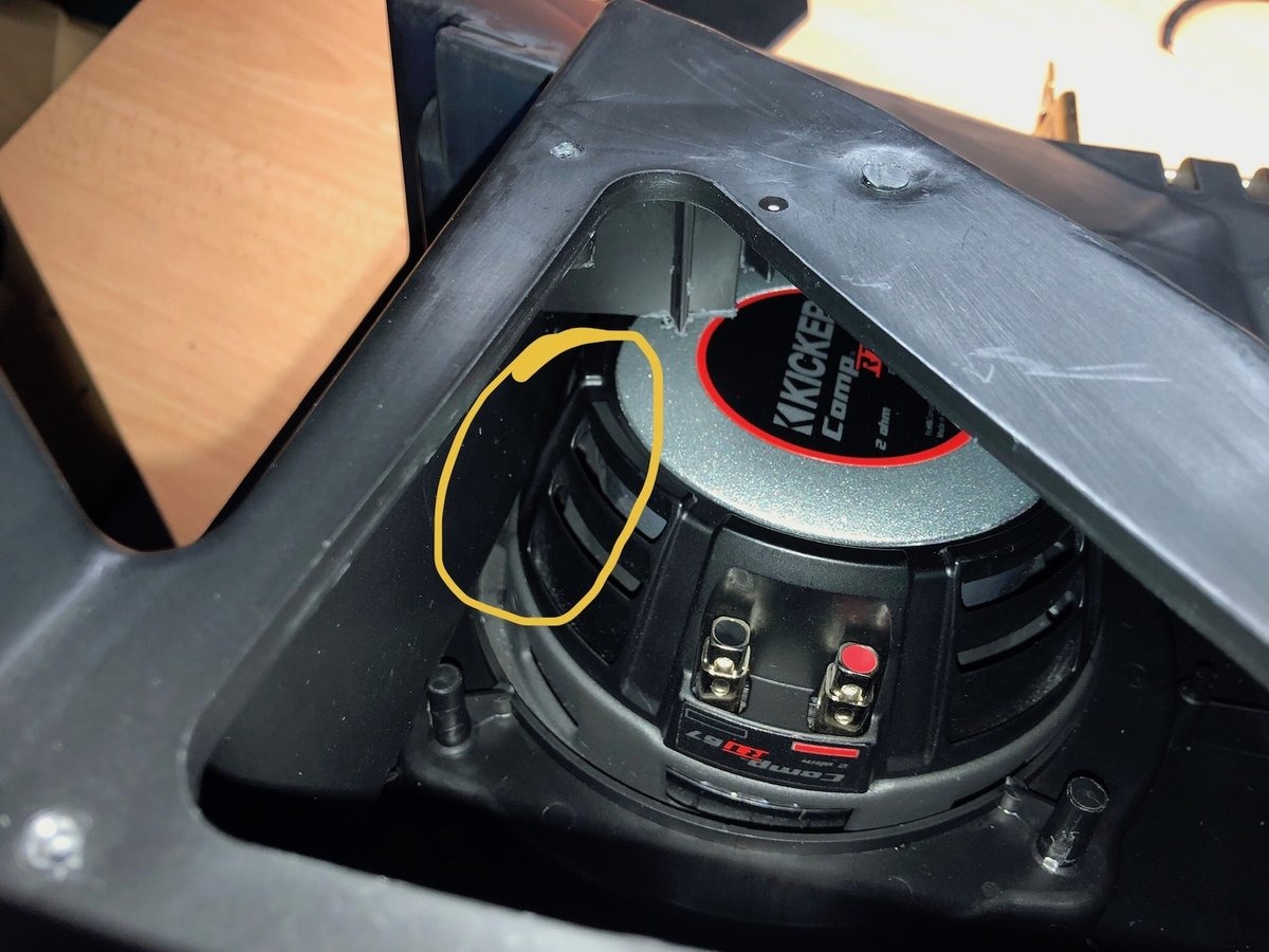

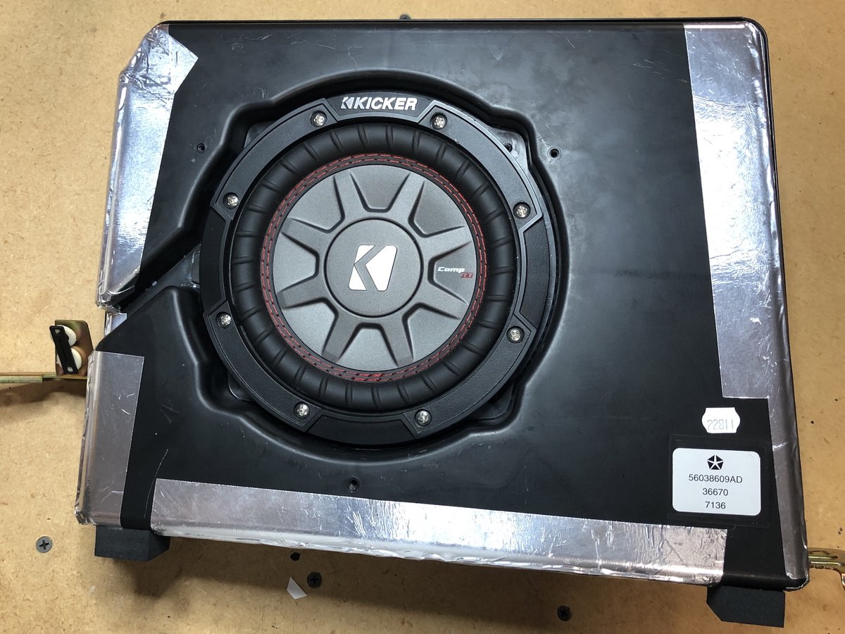

I'm using the Kicker Comp RT that everyone else has found to be a close fit...

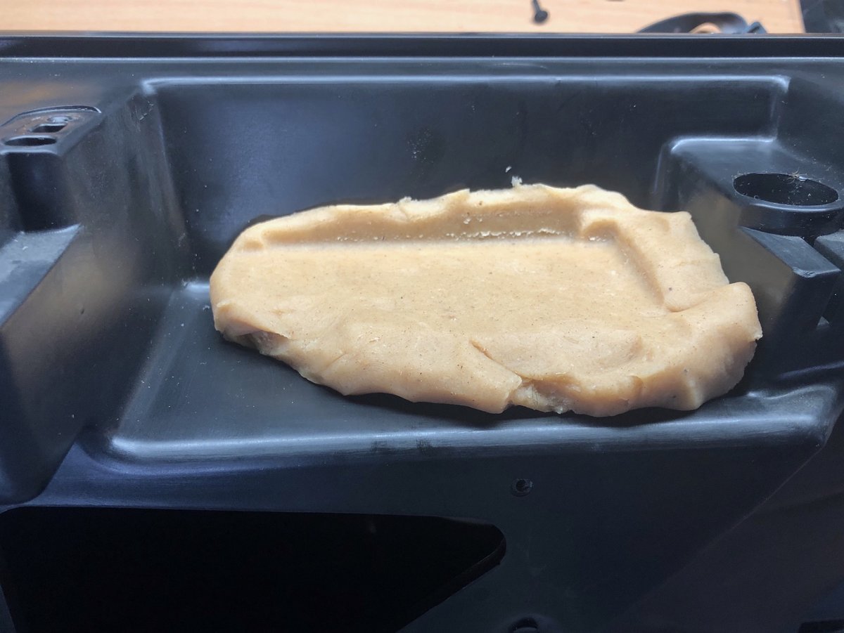

play dough was used to determine how much clearance I had above the sub enclosure.

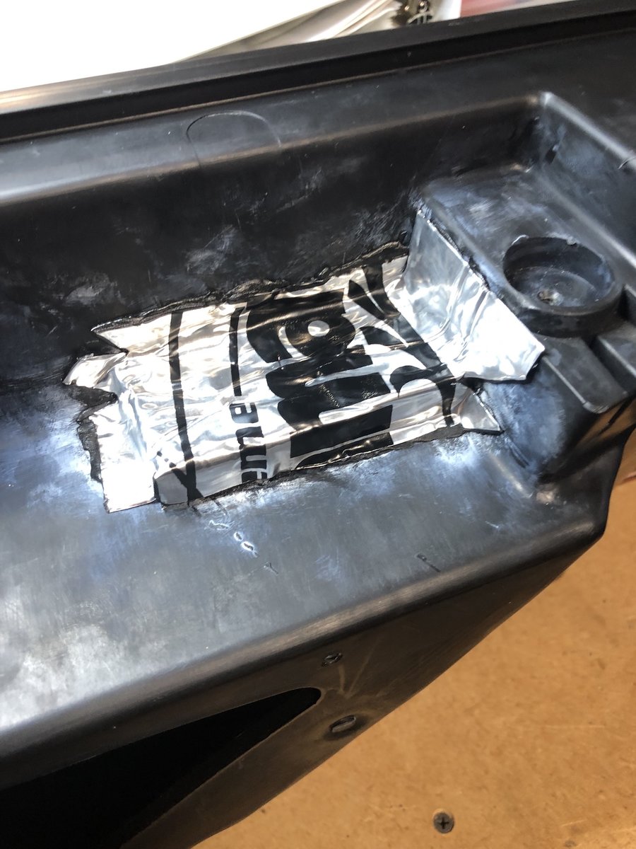

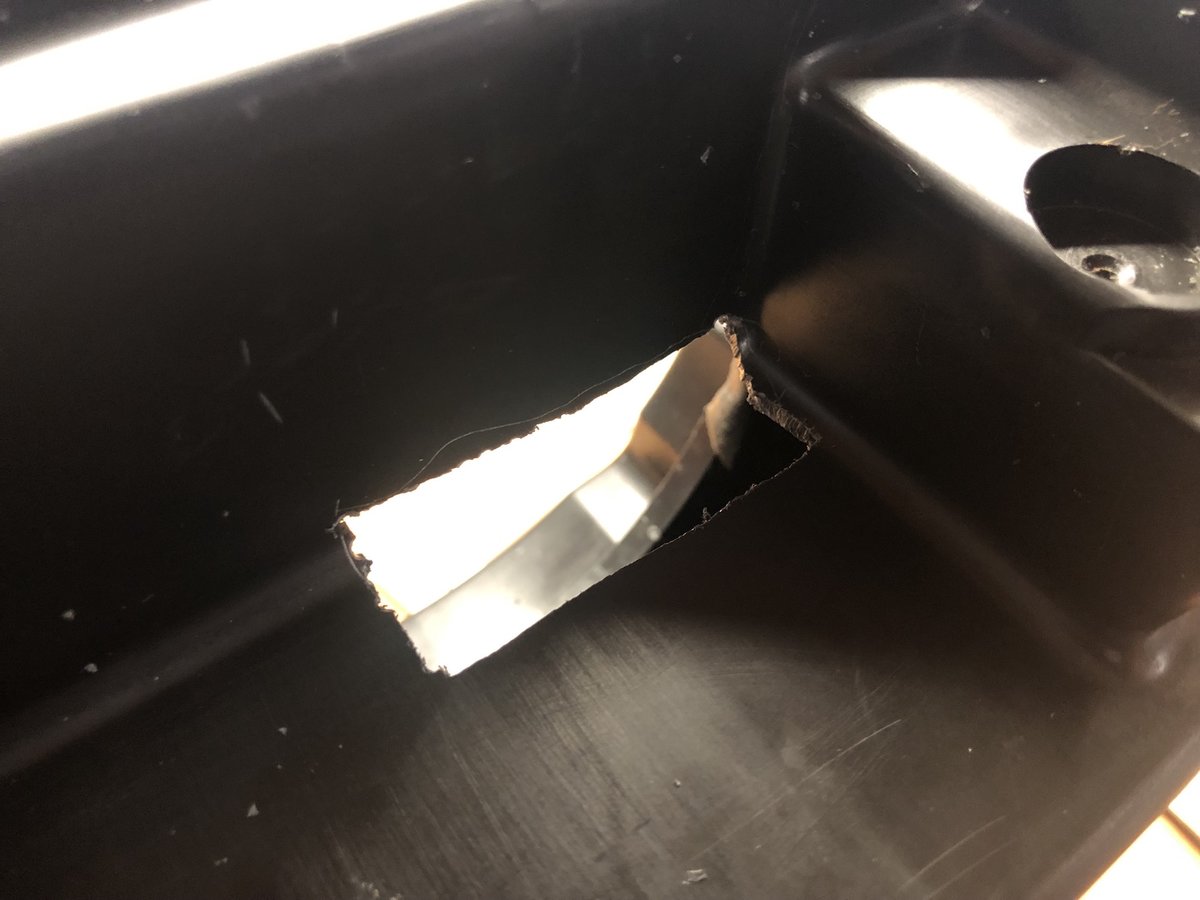

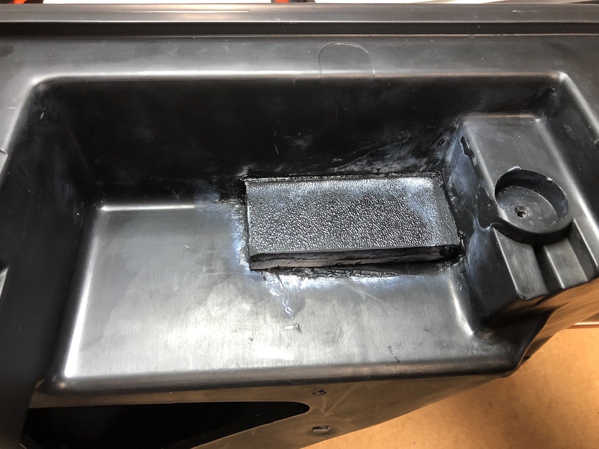

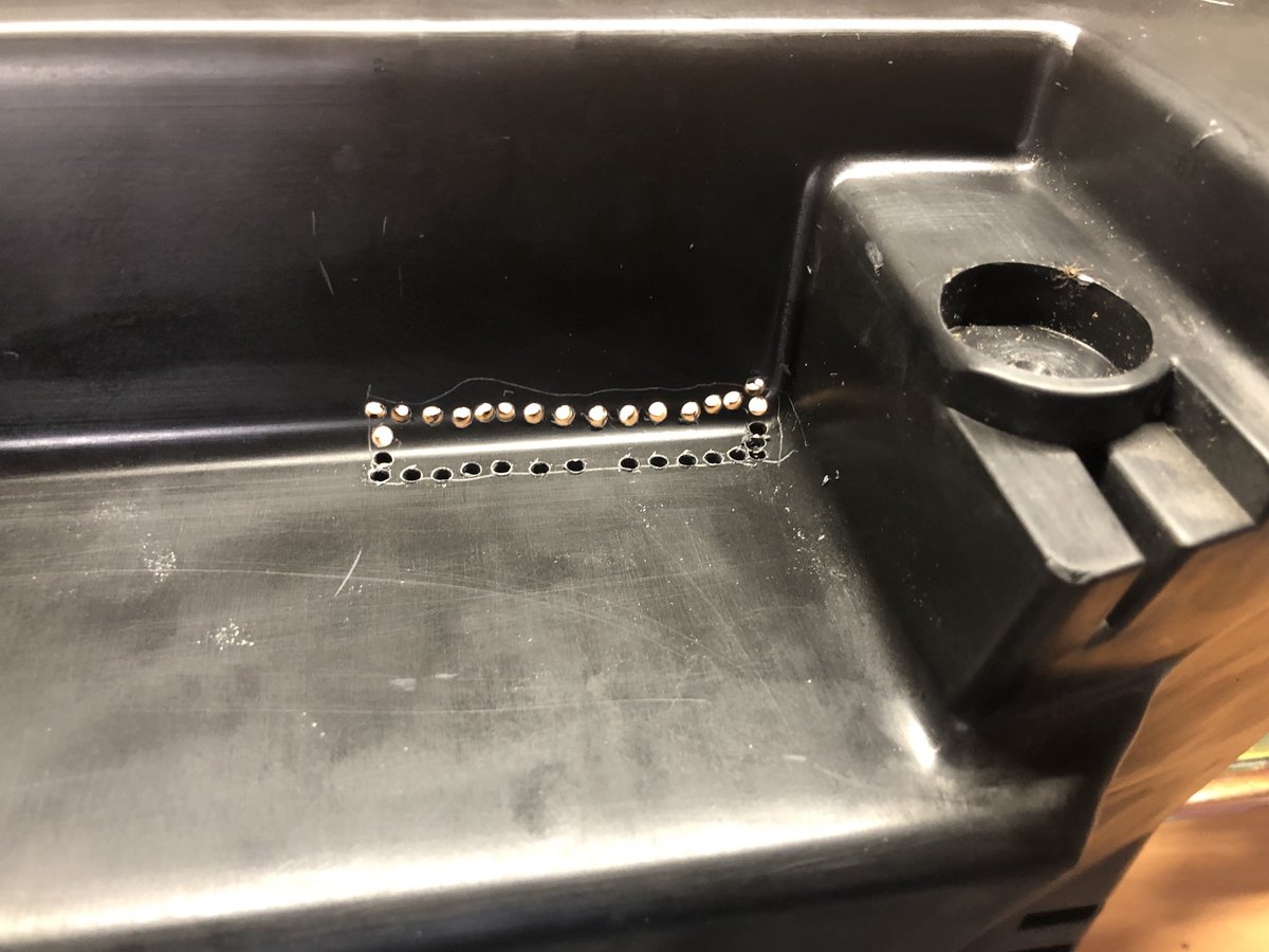

I drilled out an approximate area and cut it away. I had to do this a few times until the sub would sit flat.
I built a patch and glued it into place.
I covered it with dynamat to deaden the enclosure, but also serve as a seal in case I didn't use enough glue (I used enough glue).

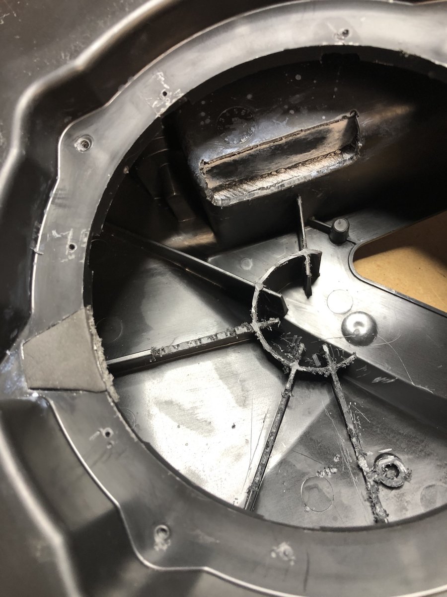

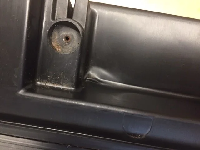

And I covered it with some foam to act as a gasket. Here you can also see the inside of the patch and the ribs that I had to grind away to get the magnet to fit. If I had to do it again, the heat gun/yeti tumbler method might be the way to go.

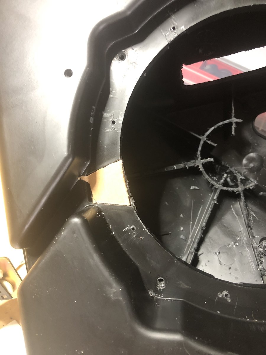

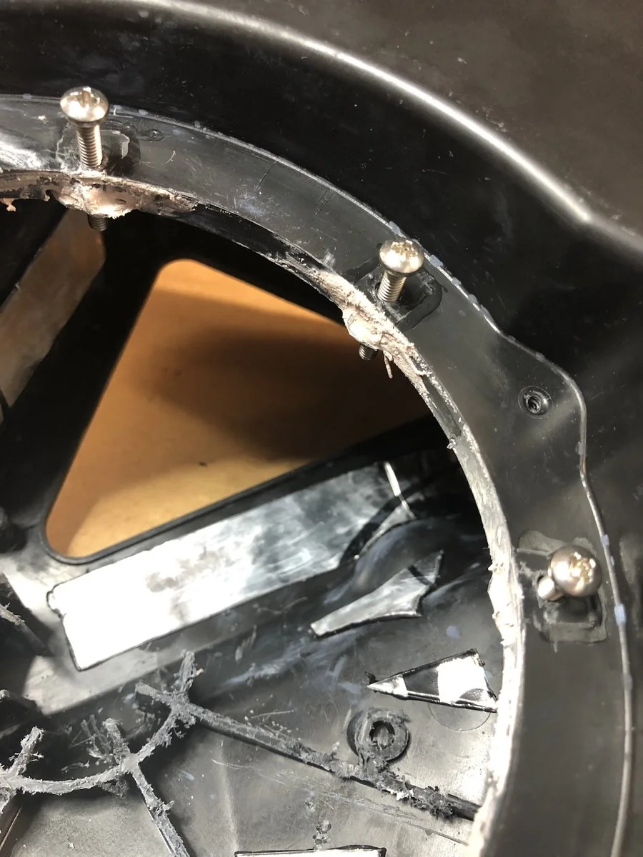

Here's where I did something a bit differently. I used a transfer punch to make divots in the enclosure that matched with the sub's mounting holes. I then drilled them out. I tried using speed nuts, but they wouldn't give me the clearance I needed - they stuck too far into the opening and hit the sub's basket. I ordered some 8-32 t-nuts and bolts from boltdepot.com and lined them up. In order to ensure that the nuts held in place when I started bolting them down, I used a bit of bondo to "glue" them in place. I covered the back of the nuts to ensure the bondo didn't get into the threads. It is ugly as can be but it works. I added some weather stripping to work as a gasket. There was very little margin for error in getting everything aligned but somehow I didn't screw things up. The t-nuts will allow me to remove the sub if I need to and re-install it without damaging the enclosure. I am also able to torque the bolts down more so than if I had just used screws. I also lined the inside of the enclosure with a bit of Dynamat.

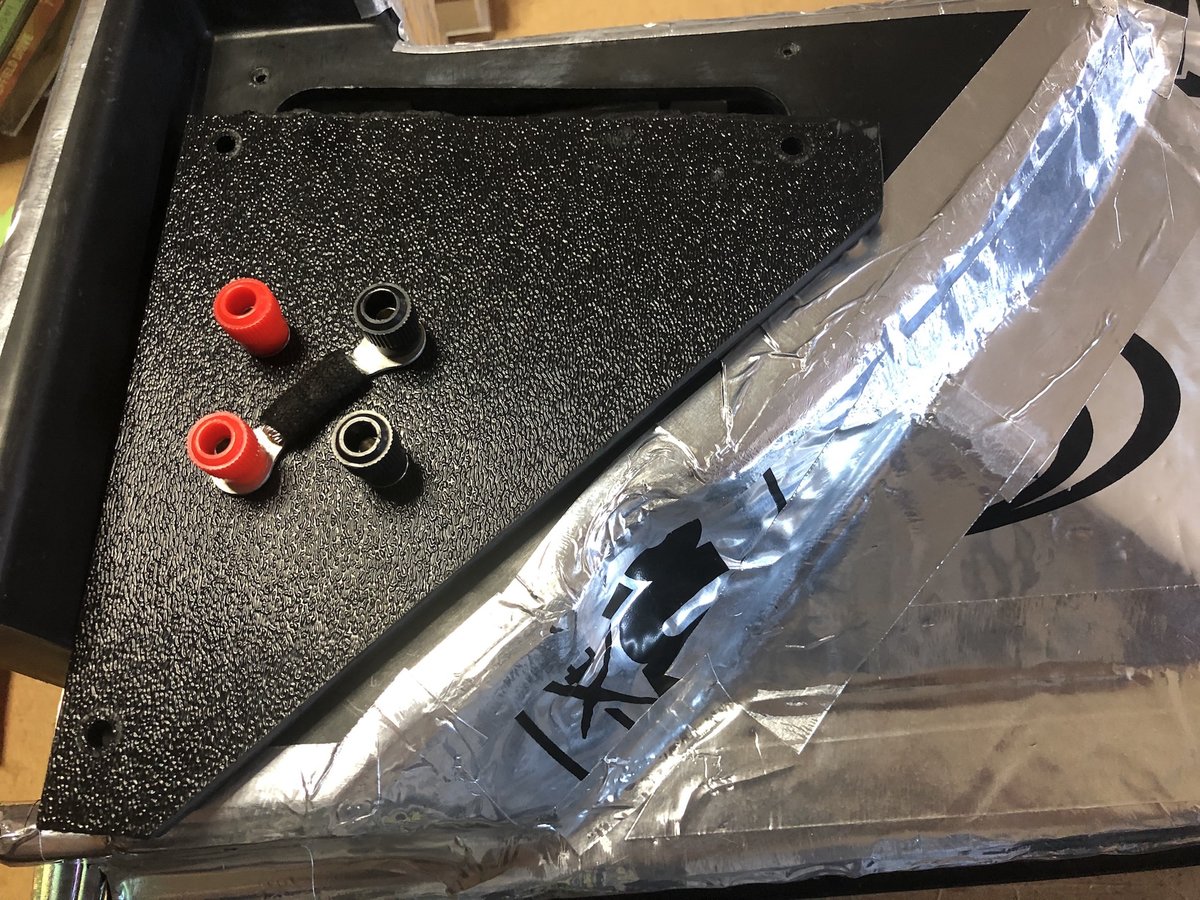

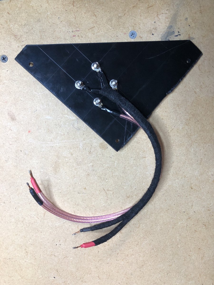

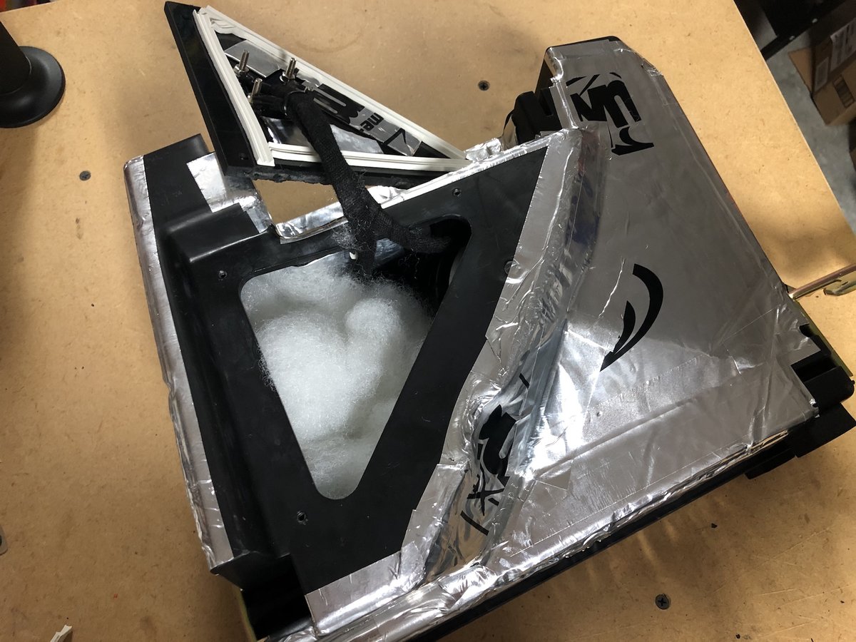

I built a replacement for the heatsink that I removed. Because the sub has two voice coils, it can be wired for either 4 or 1 ohm configurations. I ran speaker leads for each voice coil to the outside, allowing me to wire it either way without needing to re-open the enclosure itself.
Here, it's wired for 4 Ohms.
I also lined the outside of the enclosure with Dynamat. The seams where the Dynamat meet up were covered with aluminum tape. I also loaded poly fill into the enclosure itself. The white weather stripping helps seal the opening where the heat sink was. It's not as effective a seal as I'd like, so I'm going to either glue it down, or add additional screws. or both.
And that's it - here's the finished sub enclosure. It's pretty impressive on the test bench, I may decide to re-configure it for 1 ohm to get more output. I'm driving it with a Rockford Fosgate T-500BR.

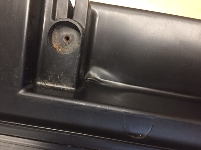

I think it’s mentioned on this thread somewhere. Basically rather than cutting out a notch to give the new sub’s magnet clearance, someone used a heat gun and a metal tumbler to heat up and re-form the back of the stock enclosure to provide the clearance needed. Would have been quicker than cutting and building a ‘patch’ like I did.
Poor pictures (one inside and one from the topside) but the heat gun and tumbler method took about 30 minutes. The white stuff is the price sticker that was on the bottom tumbler. I hope to have this finished and back in the next few days.
