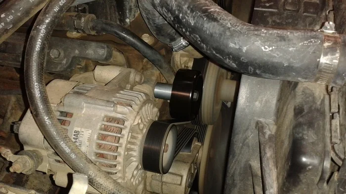

Im hearing the same noise, same symptoms

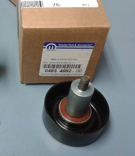

Generally an idler pulley going south. Do yourself a favor and opt for the factory Mopar one.
