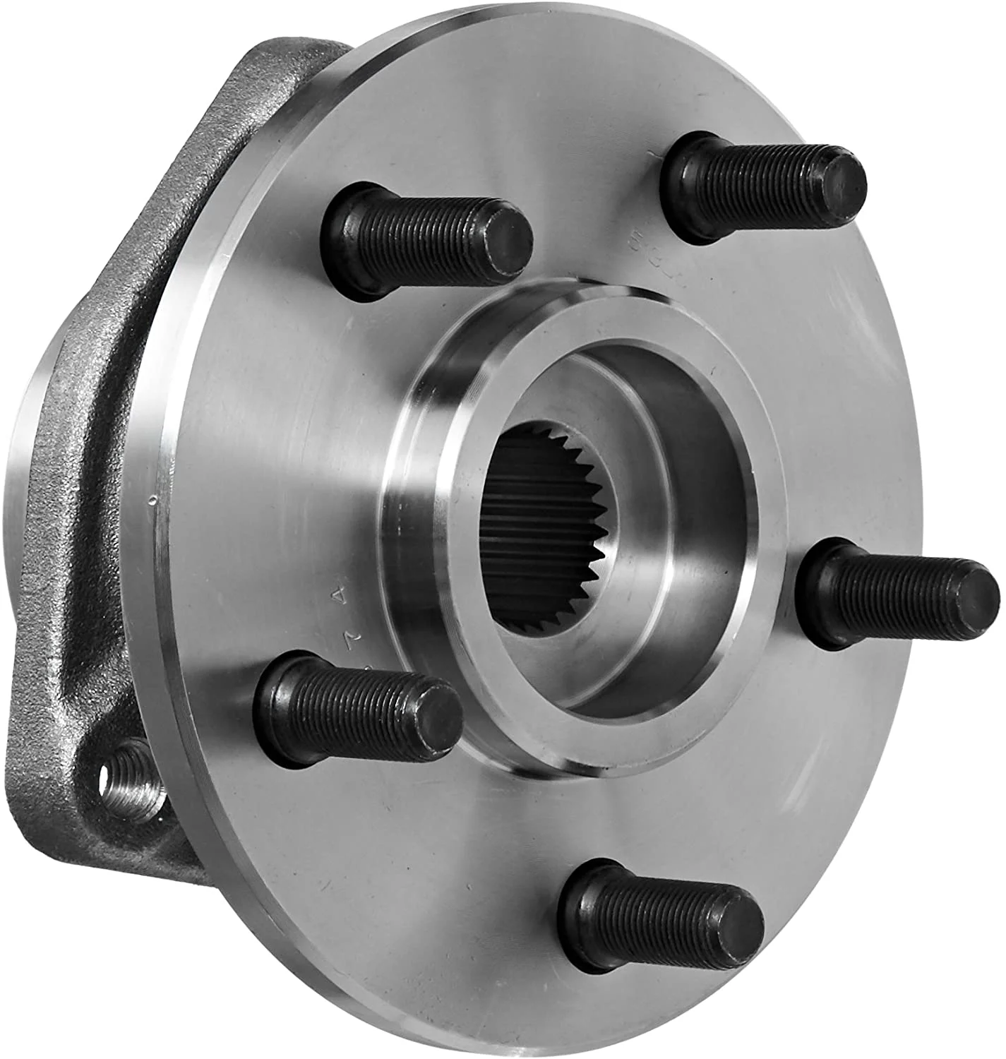

would any of you know the size of the outter hub ring where the wheel hub bore fits over? of the
Timken 513084 Axle Bearing and Hub Assembly ?​
