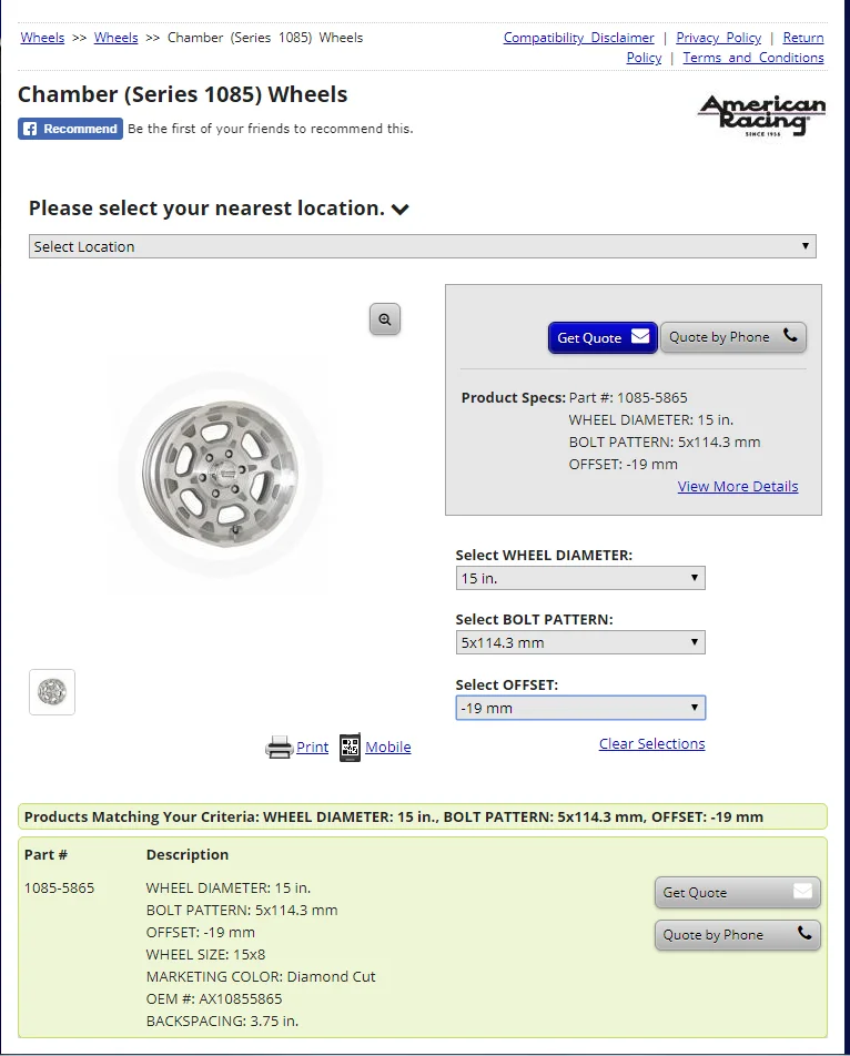

My wheels are American Racing model 1085. They are 15x8, not 15x10 like I thought. The specs I have found call for a 60 degree conical lugnut. That is what I have. This info doesn't solve my problem. The wheels do not seem to center reliably.

While researching the wheels find out what type of lug nuts it takes, there are tapered and ball lugs nuts. There should be a part number on the back of the hub on the American Racing wheels that will help you find out what kind of lugs you need. The picture below shows the difference between the two type of "tapered" lug nuts.
