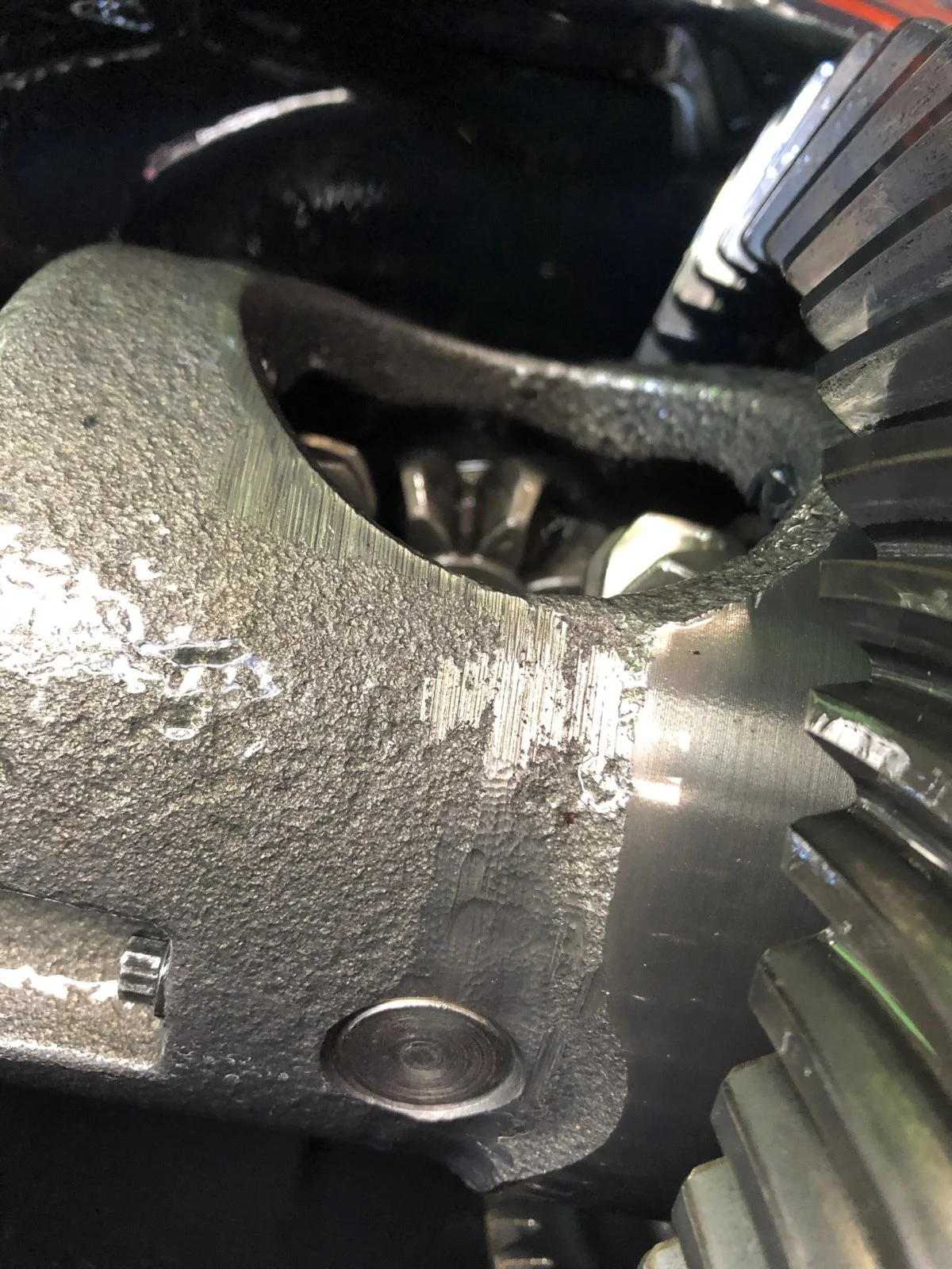

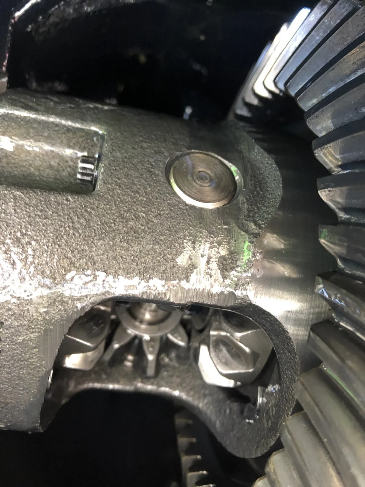

Hey all. Item for discussion is a Dana 35 with 33" tires.
Last month or so I noticed a "hum" coming from under my jeep when I drive. It's most noticeable when I'm at highway speed and I turn the wheel slightly left or right. Originally I thought it was tires/steering but upon further listening it sounds like it's coming from the rear diff. It's gotten gradually worse at slower speeds, especially driving down little hills while on a moderate turn. On these little hills I'll push in the clutch taking power from the drivetrain and the hum/vibration gets even worse until the road straightens or levels out. I've read that the LSD can hum like that when no friction modifier is added. The guy who regeared my jeep 5000 miles ago put in the LSD (dana/spicer brand) so it's hard to imagine he wouldn't have added a modifier or used the right gear oil with one in it.
Anyhoo...I drained the oil yesterday (looked clean, no shavings), cleaned everything out good, and put in Lucas Oil 80W-90 that has "great for limited slips" stamped in big letters on the bottle. Today I drove it to work and WOW what a difference. My ride was significantly smoother and quieter than I think it has ever been since I bought the Jeep stock. However, I still hear the hum on the normal curvy areas of my drive. It's not as loud or "grindy" feeling, but it's there.
Is this normal for an LSD on pavement use? Or are my clutches toast? Do I need to buy a new one, say a brand new Powertrak no-slip that a friend is willing to sell me for $200 that he no longer needs since he swapped in a 44???
