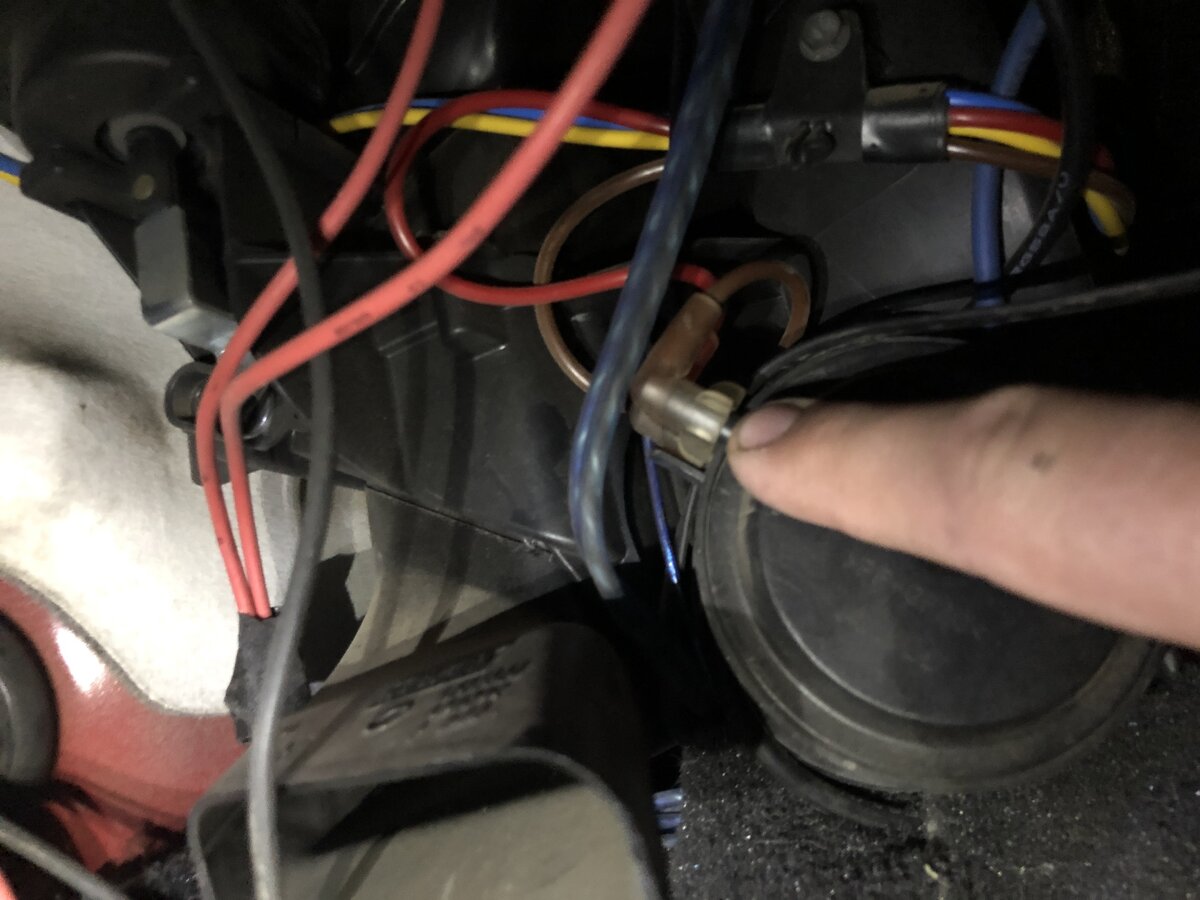

Mine was this little vacuum line disconnecting, this is in the center console just next to and above the skinny pedal.

When you say, "disconnecting", was it loose or something? How did you fix it? Did it just slide back on, or did you need a new connector?
I had a vacuum line fall off near the drivers side firewall area. It fit very loosely on so I was not sure it was right but it has not fallen off again. I probably knocked it off doing something there.
I think @Viking Jeeper covered it, they just slid back on. There’s actually 4 there, but for me only the further out ones slipped off.
