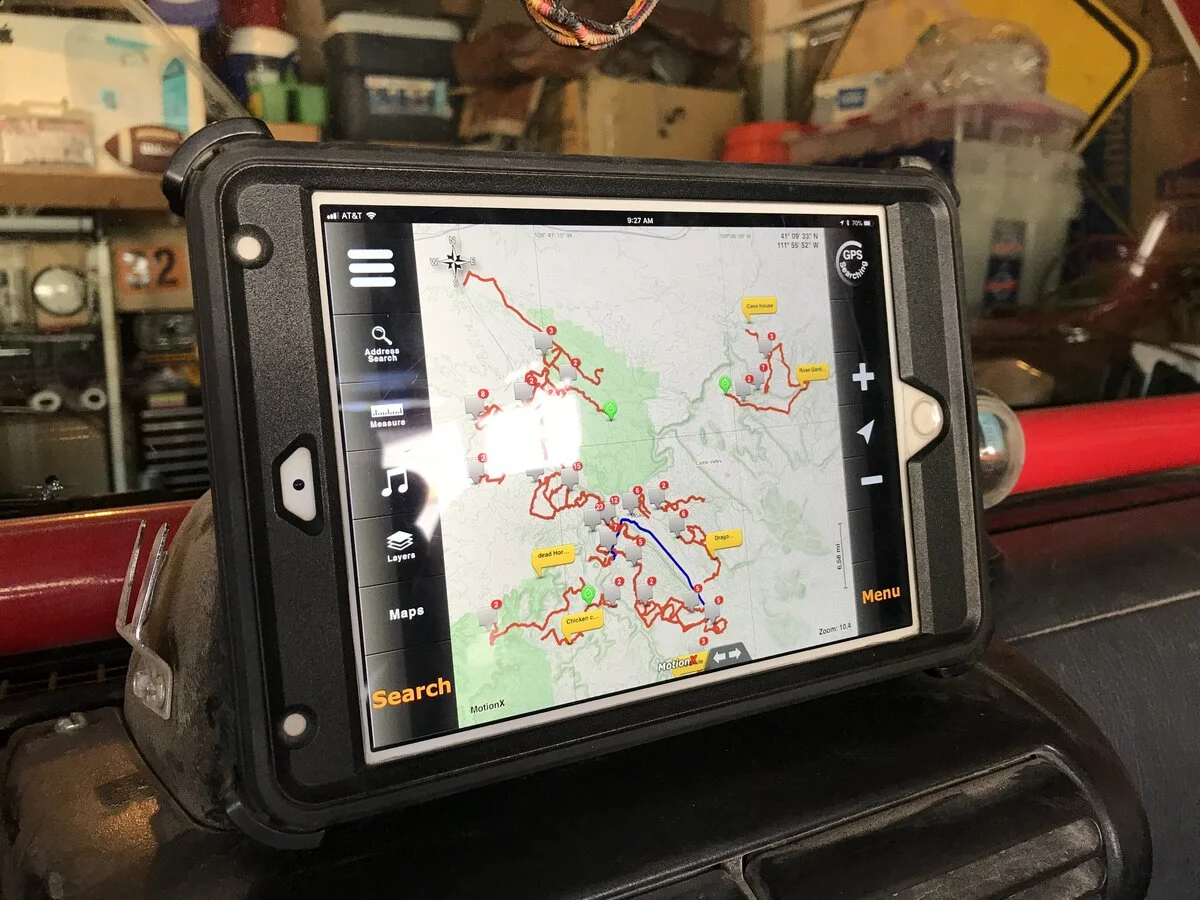

I was looking at ways to mount an iPad Mini in my Jeep and came up with this idea that has been working great for the last few years - and a couple of rollovers! I replaced the top of the console with a gauge cluster mount. Then I attached a Gorrila Case mount to that. Then I covered my iPad Mini with the Gorilla Cage case. It holds the iPad very securely and has a perfect line of sight. I can take it out when I want. And, it has survived 2 rollovers without falling out! I used MotionX GPS for my navigation and it played sound through Bluetooth in my jeep stereo.

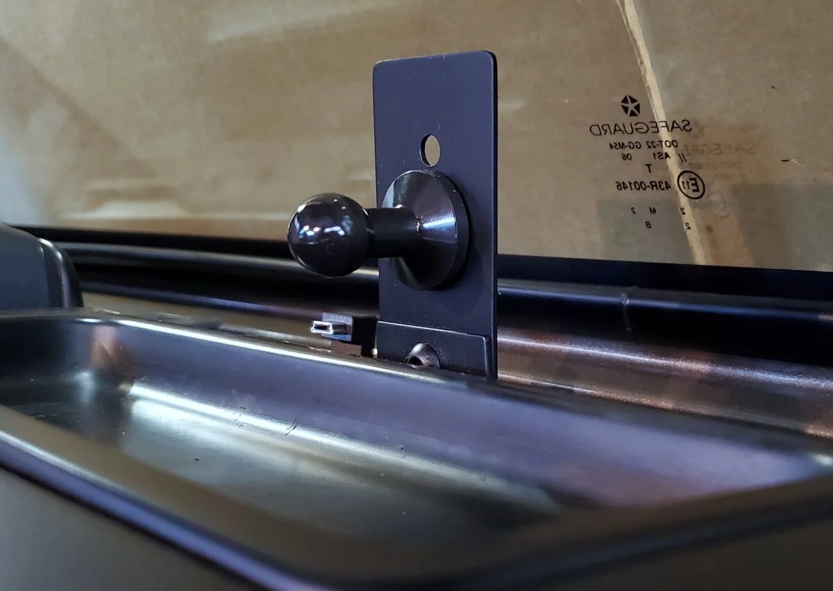

I also didn’t want my tablet to block vision. I ended up putting a mount on the grab bar. I would prefer closer to center, but didn’t want to block the controls or vents.

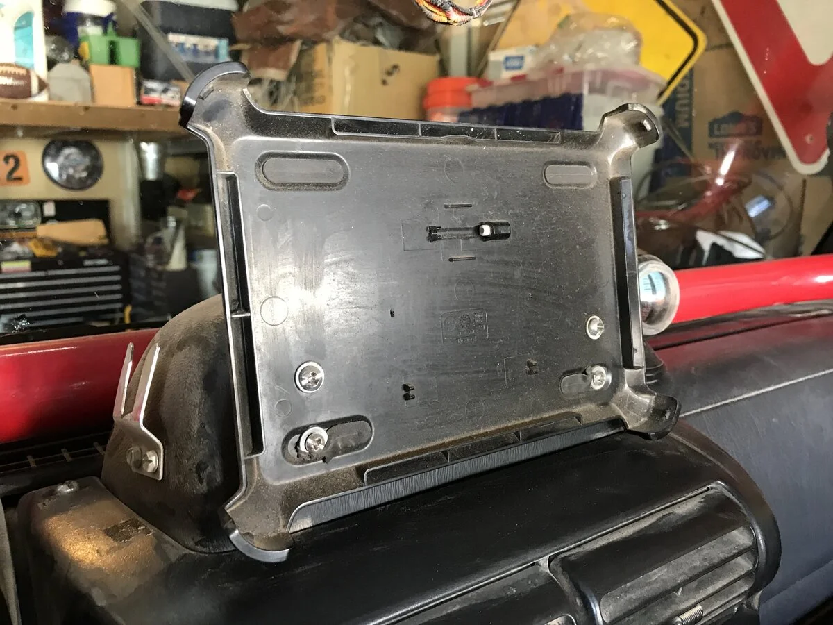

4) Mount the back of the Otterbox to the gauge pod. First, remove the foldable mount that is on the back of the Otterbox. Looking at the picture you can see that I used 4 small screws towards the bottom of the Otterbox. This just gave me a solid connection between the two.
