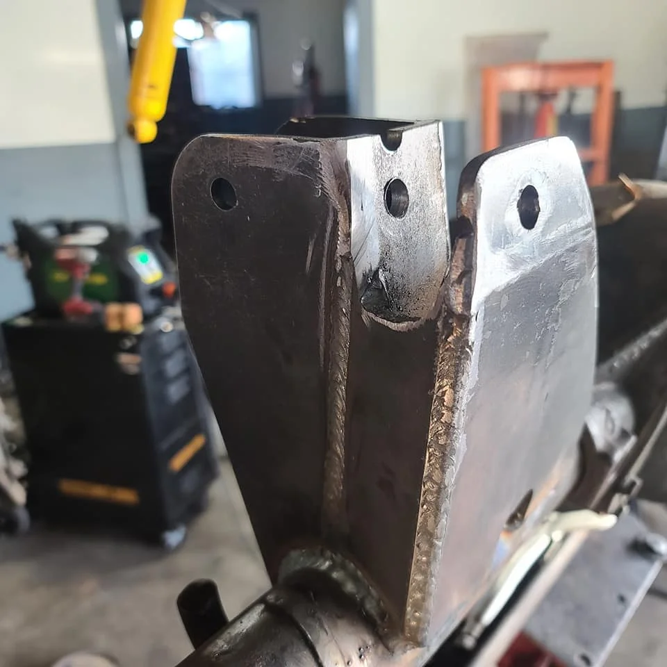

My rear suspension set up is Currie arms, 2" OME springs, 3/4" spacers and shocks mounted in the factory location. I have re-located my upper perches to the center of the frame arch. I also created my own track bar mounting bracket on the axle side to help with uptravel. The JKS relocation bracket I was using caused the track bar to crash into the fuel tank cross member. My new bracket is forward from the old JKS angled relocation bracket about an inch and a half. No bind on the frame side bushing.
I have moved my anti rock links from their softest setting to the middle point. That made it better, but still not great. Any other ideas before I change them out for something else?
