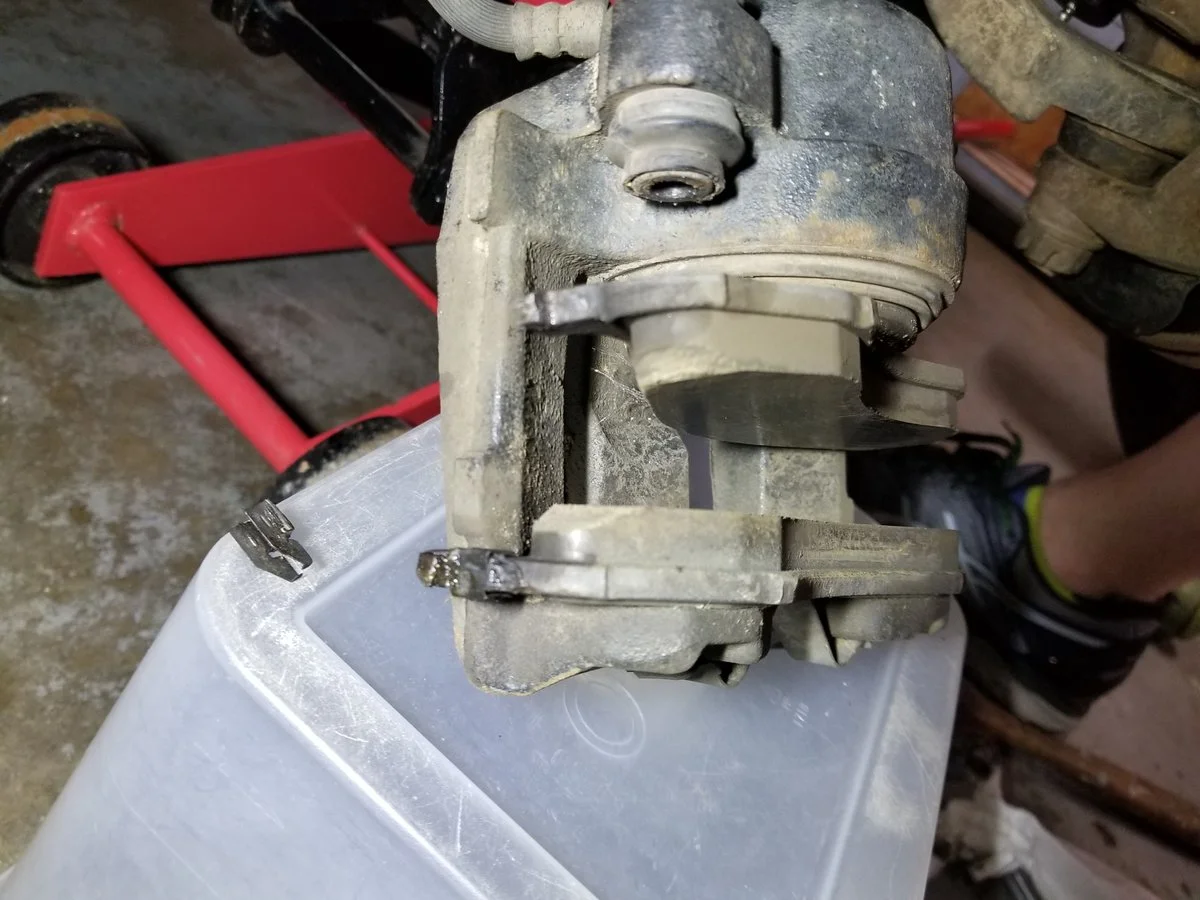

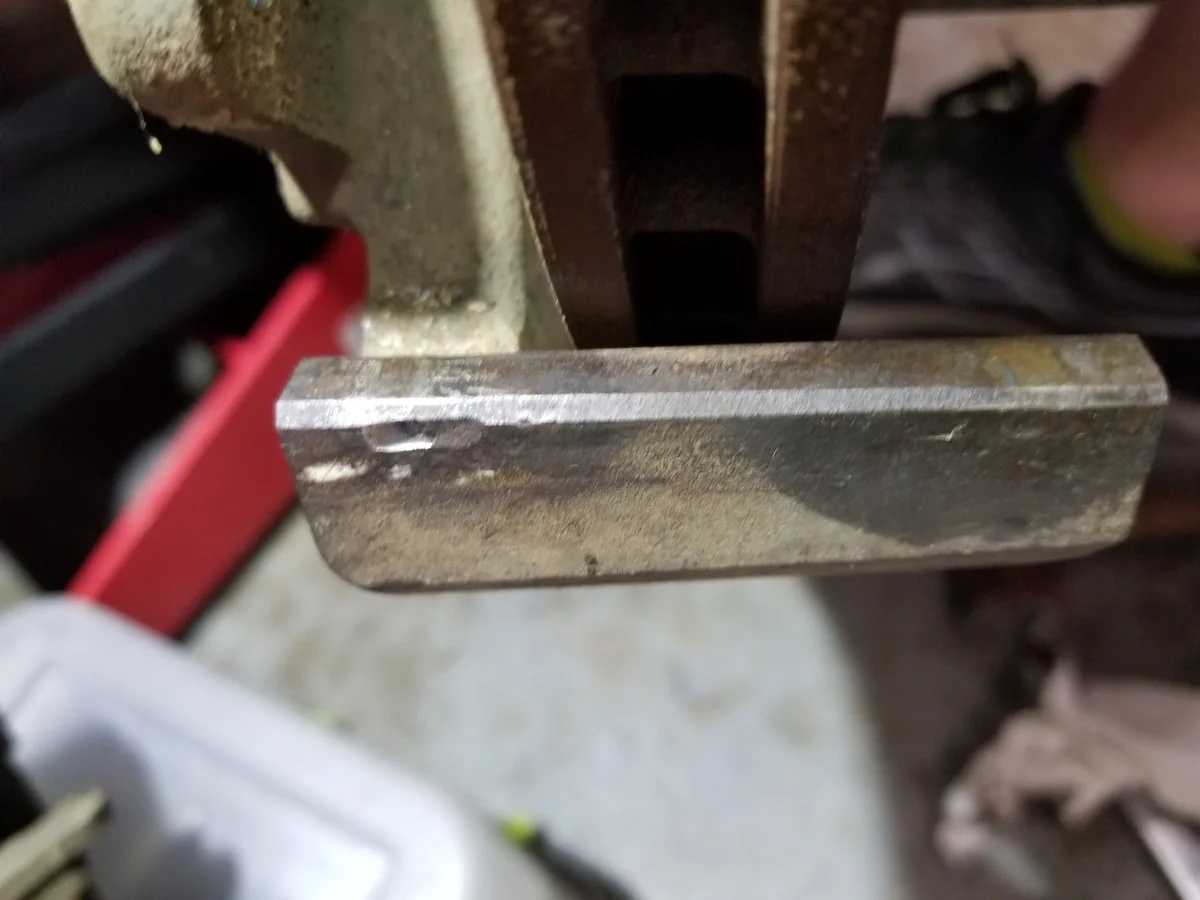

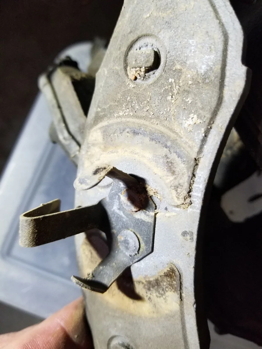

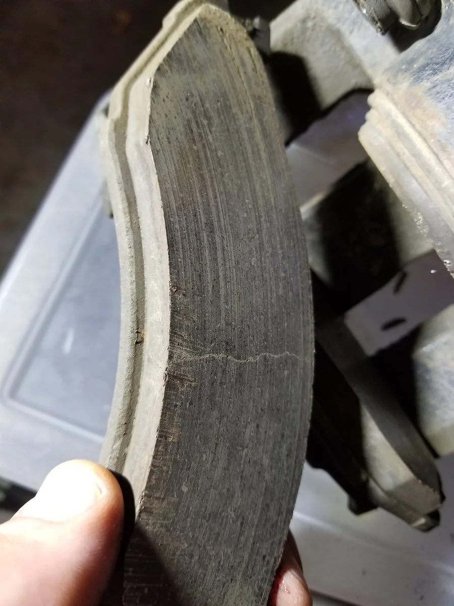

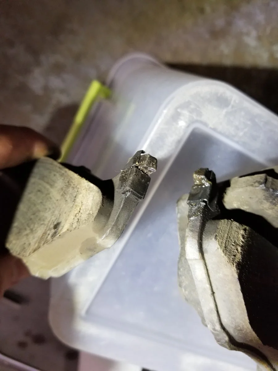

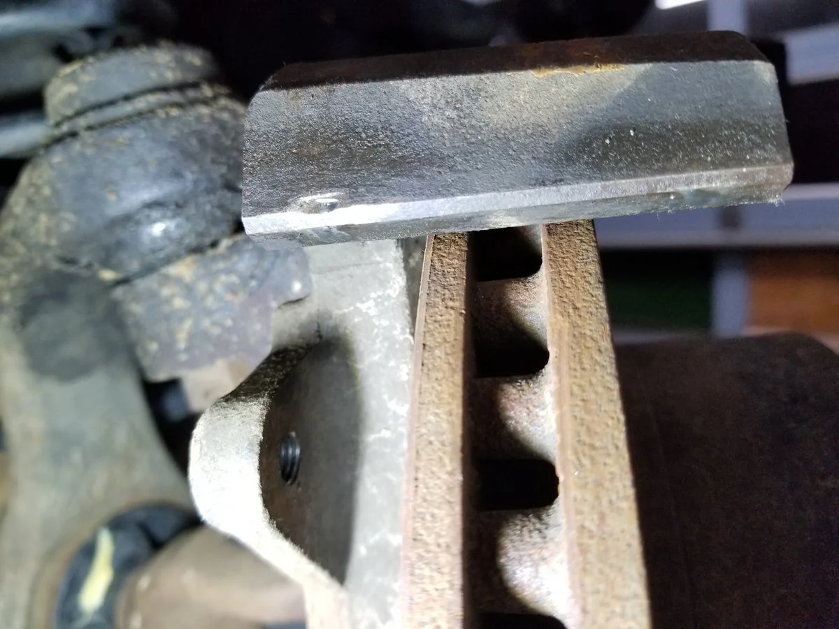

I finally got a chance to use mrblaines kit to fix a long stripped knuckle bolt. Doing this fix meant I got to take my Front/right brakes off and put brake grease on them. I enjoyed perfect silence for one day. Now my squeaks are coming back. Is the damage already done to the current pads/rotors/knuckles? The front/right was the worst offender and the only one with the stripped knuckle bolt. See attached pics for more info. Thanks,
John
Man your pad is completely cracked in 4th pic down.
Yea. Toss them. Be sure to use brake grease on the new ones. I don't see any on these. And be precise on pad break-in.
