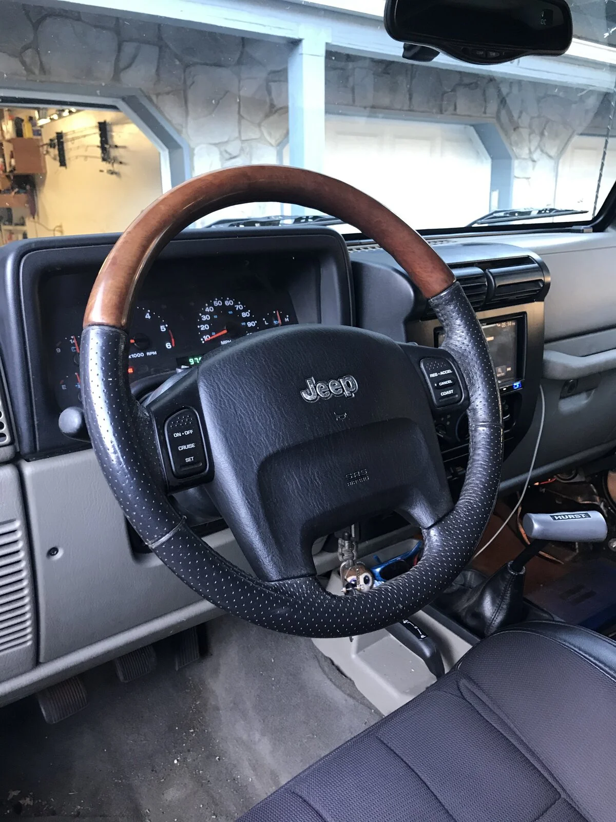

I put a steering wheel from a WJ Overland in mine.

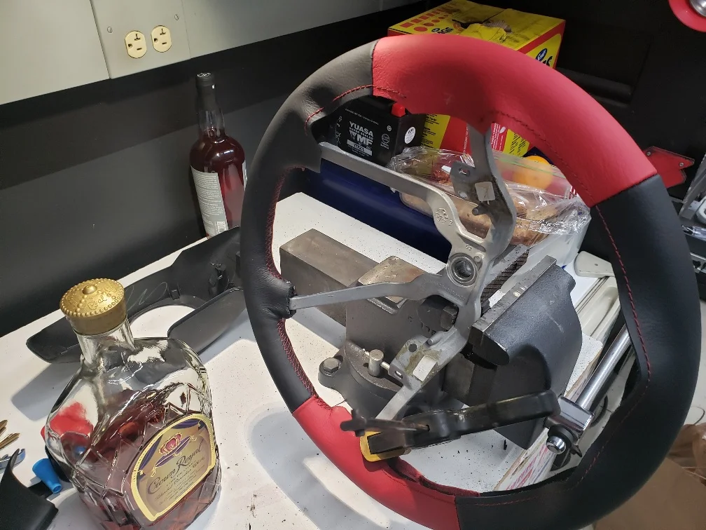

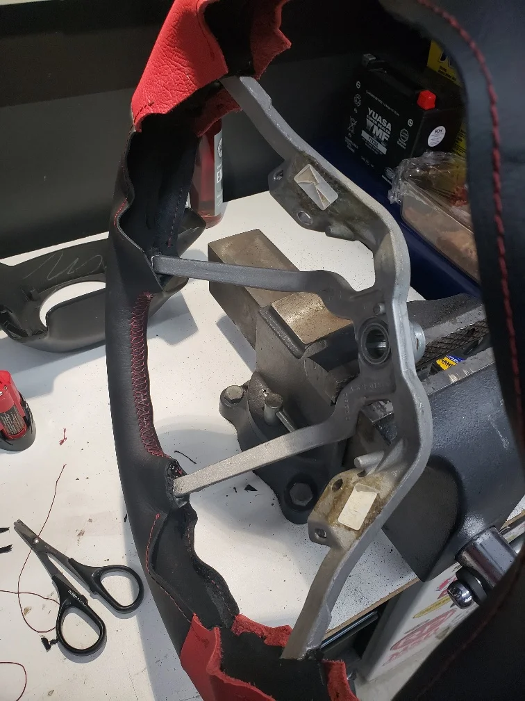

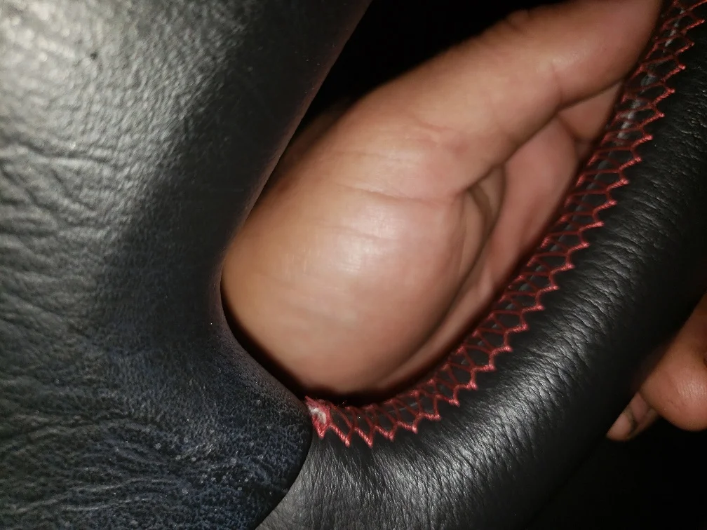

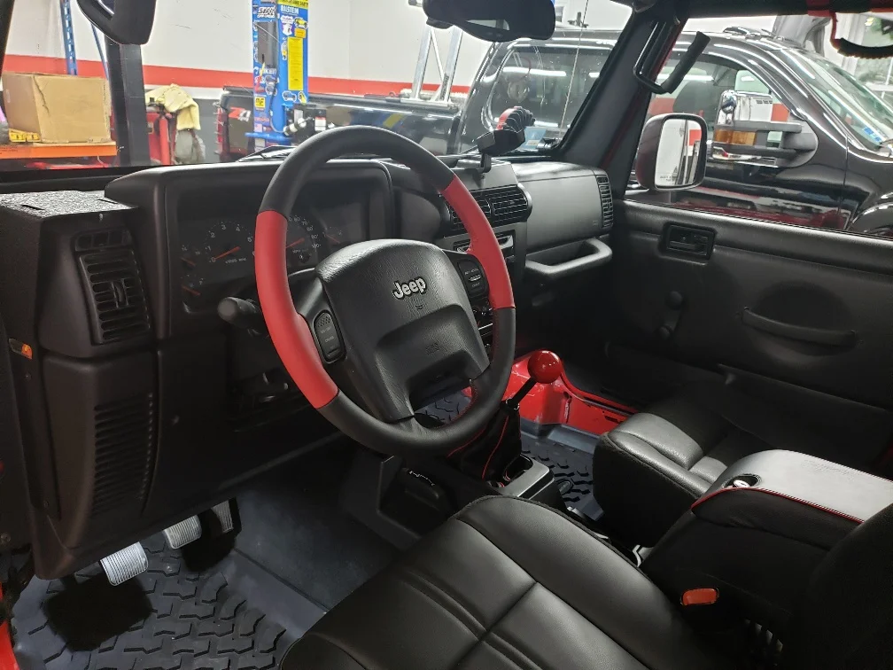

Redline goods makes a good wrap kit for both the leather and rubber steering wheel. The company is from Poland, too. For roughly $100, they send you the leather wrap, new padding and heavy Duty waxed nylon thread. You can also opt to have thicker padding or thumb-grips, 2-tone, center stripe, and more. Patience is a virtue when installing. From dismounting my factory wheel, removing the old leather/padding to installing new then re-installing in the Jeep, I had spent about 4.5 hours total. Maybe 4 hours without drinking whiskey during the install.

really nice work!
I gotta get me one of those steering wheels first. How hard was it removing the air bag?

Not hard. Don't let is scare you. Two bolts and two electrical connections. Disconnect the battery and after removed, place face up in case of accidental discharge.

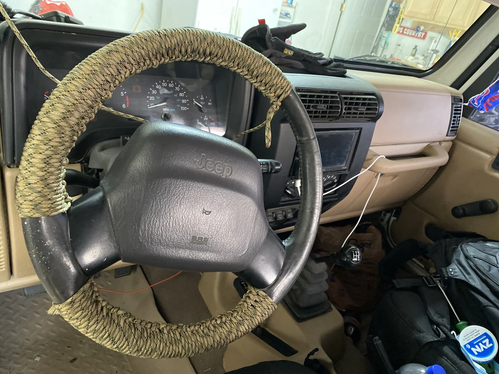

Wrap it in paracord. This seemed like a good idea when I started. Now I’ve rubbed all the skin from my fingertips.
