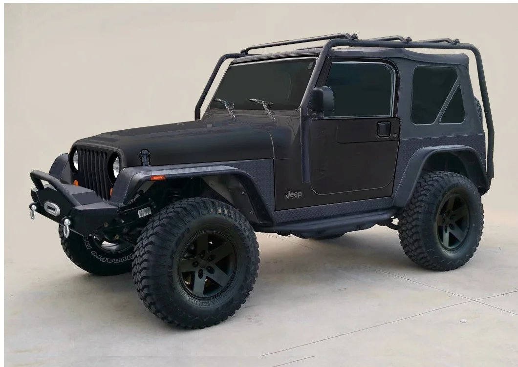

Hi All,
As the title suggests I have a road map that I am good with as a starting point. There are a few DIY projects that I will need to take on but I feel everything is doable by spring.
There are two option for tire size that I am still deciding on.
Please forgive the hack photoshop job (shown with the 33” option) but it gives you an idea where I’m heading.
SUSPENSION (33.1” Option)
Old Man EMU - 2.25” Lift
Savvy - 1.25” Body Lift
JKS - 1" MML
TJ - Moab 16” Wheels
DuraTrac - 285/75R/16 (Load Range E) Tires (deflated to 26 psi off-road)
ARB - 12V Twin Air Compressor
ARB - EZ Deflator
Or
SUSPENSION (31.7” Option)
DuraTrac - 265/75R/16 (Load Range C)
BODY
TJ - Rubicon Diamond Rock Guards
Smittybilt - SRC Rocker Guards
Smittybilt - SRC Roof Rack
Bushwacker - 6” Flat Flares
TJ - 03” Mirrors (relocated to window frame)
TBD - Halo Headlights
INTERIOR
Tuffy - Center Consol
Best Tops - Instatrunk
Smittybilt - Hand Grips
Smittybilt - Cargo Net
TBD - 2 pc Hard Top
DIY
JK - Front Turn Signals (mounted in grill)
Diamond fender armor (blocking out TJ turn signals)
Diamond rear quarter armor
Smittybilt Style front bumper (with built on winch cover)

3.07 gears... oh man, those have to go. Literally the worst gear ratio offered ;)
New gearing will happen when I do the lift:
As of now:
OME 2.25” SL
Savvy 1.25” BL
JKS 1" MML
Goodyear Duratrac 285/75R/16
I think I'm holding off on Discos or Antirock at this time.
Also as i'm planning the MML I will not be doing a TCD

That tire is designed to carry up to 3750 pounds per tire. As such, it's heavier, and has more tire plys to carry the load - making it not very compliant for bumps or able to conform to rocks, terrain, etc.
Something load range C is much better for our weight Jeeps. Unfortunately, that usually means a 15" wheel, or a more rare tire in 17" wheel diameter.
Reactions: Neil Sears
Not many, if any C options left in 16 inch wheels. I’m on the same tires your looking at now and they ride nice, aired down to about 26 pounds each.
If/when I replace these tires I’ll be getting a set of 15 inch wheels and C Rated tires just so I can have real life comparison.
A few really good forum posts here on the difference in sidewall ratings between Cs, Ds and Es.
Thanks.
How rare?
What 33” inch tires are out there with a “C”?
You’re problem is the 16” Moab wheels. That’s a weird size rim. I know Jeep did it, but it is. You’re tire options drop severely. Try a similar 15” wheel, something like the Quadratec Rubicon or Mammoth Boulder’s. Then your tire choices skyrocket
I see now why some threads I have read dropped the Moab’s mid build!
As I will be driving to my destination (often hundreds of miles away) or going to our mountain cabin (that gets snow in the winter) the DuraTrac’s are actually a good fit for me because they do both of those things well.
When I’m done with this build I have a feeling I’ll get a Rubicon and on that I’ll put a better wheel size.
Although nothing is written in stone 😎
