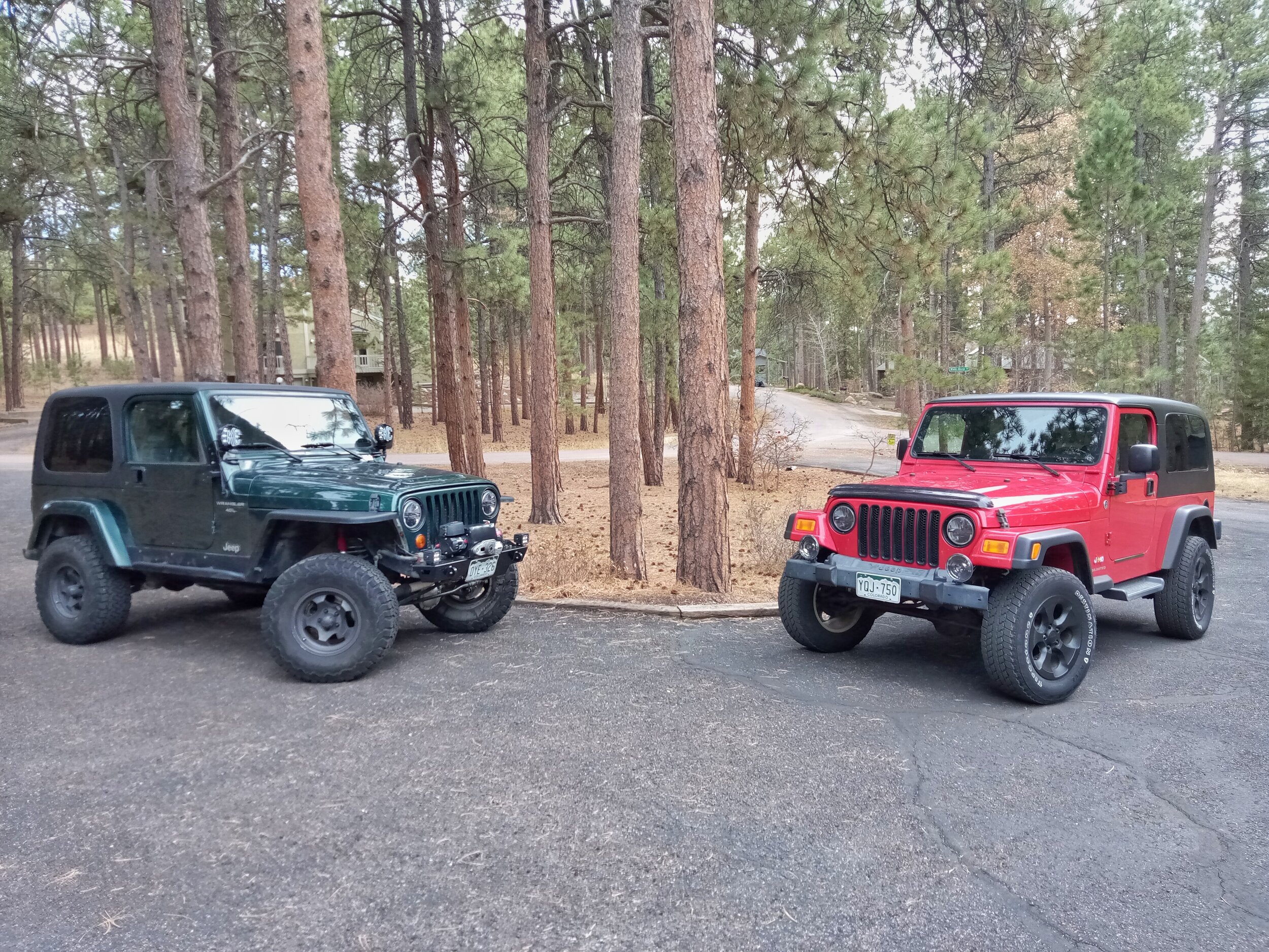

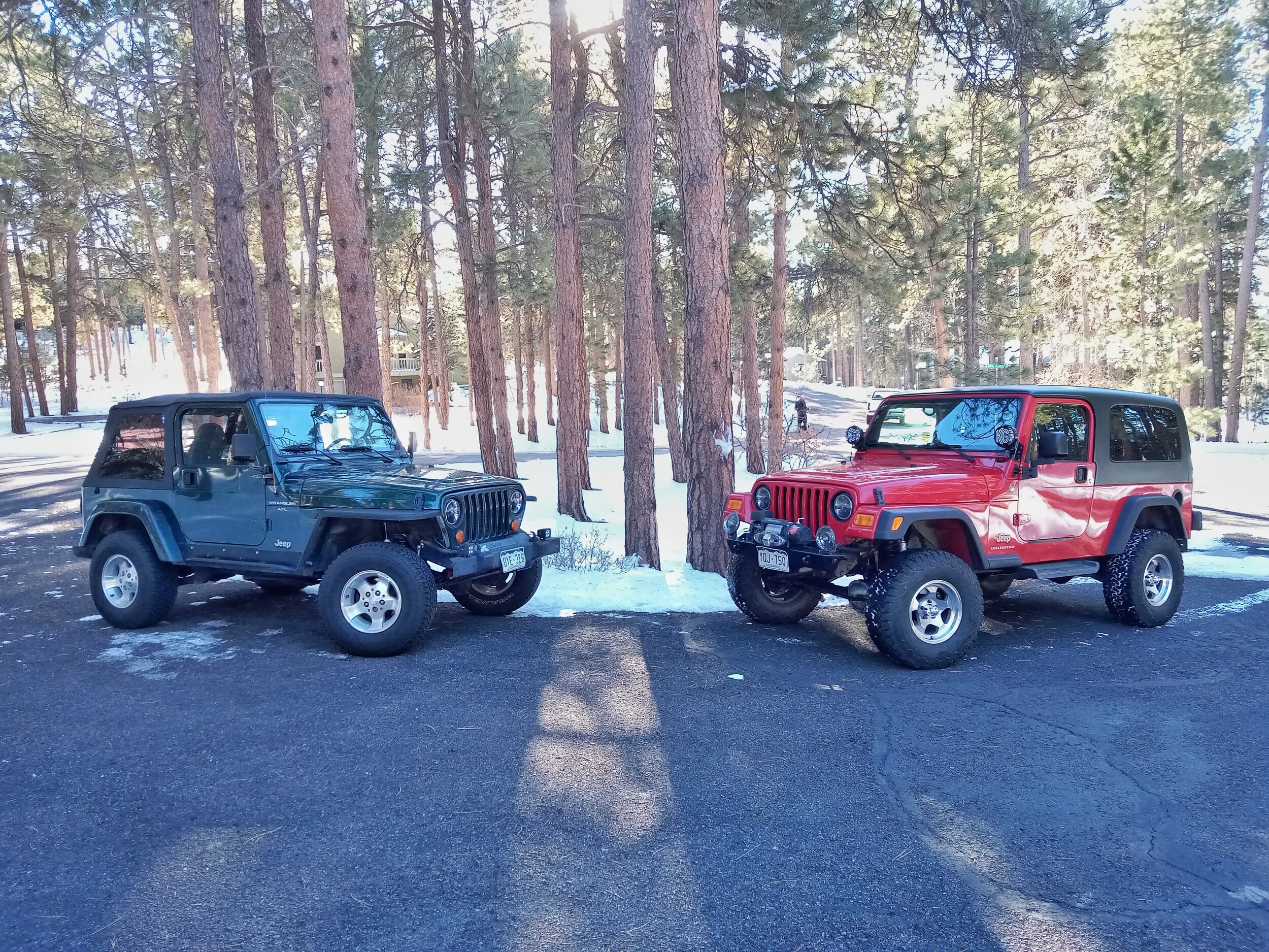

@zachpeakee if you haven't already, and it's not too late, take a before pic of both rigs. I like having mine both as a reminder that for about 3 months I owned two TJ's at once, and seeing them both before and after.
Nov 6, 2020 (the day I bought the LJ)
Feb 6, 2021 (the day I posted the TJ for sale)

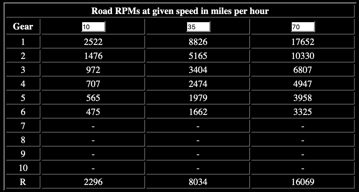

I think the biggest drawback to that is having 4.88 gears with stock size tires (maybe they're 31's?) and the NSG370. Here's the numbers from Grimm Jeeper for 29's. I think that would be an annoying rig to drive. If it has 31's the rpm's in 6th at 70 are 3110.
