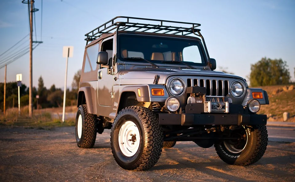

Good point. My inspiration has been this Jeep. I know not everyone will be a fan, but I think it looks neat. If only I could track down those wheels...

If I remember correctly, when the owner posted that pic on Expedition Portal, he said they were from Stockton Wheel.
