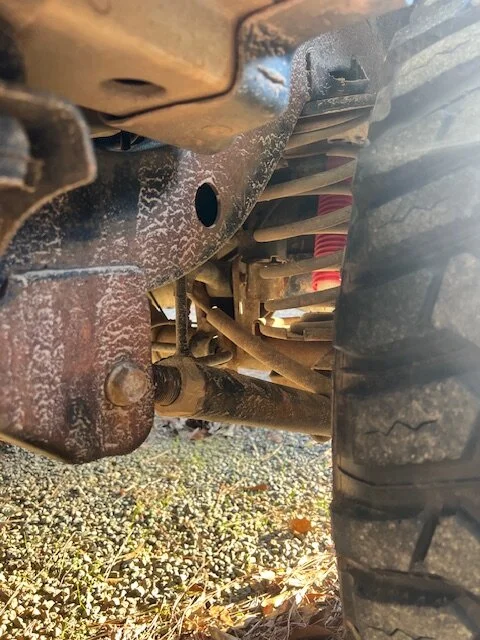

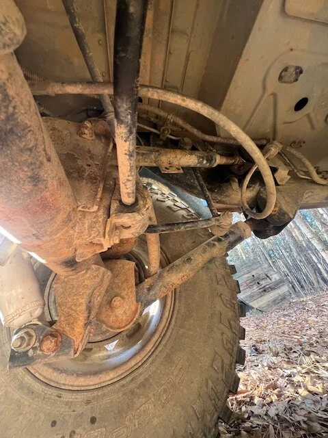

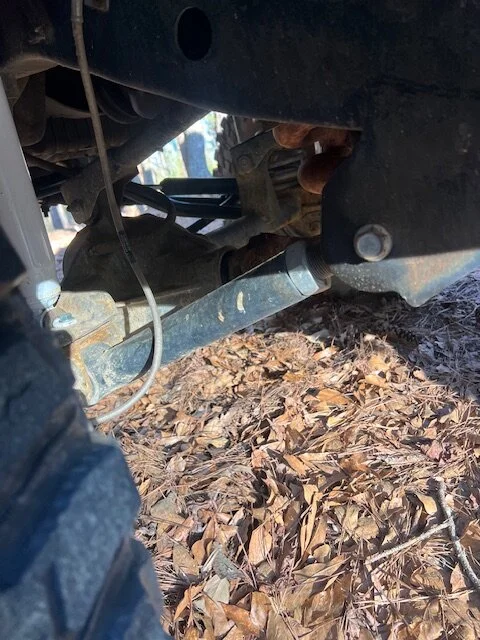

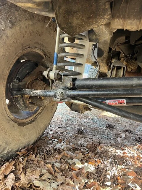

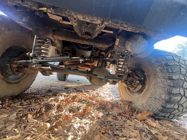

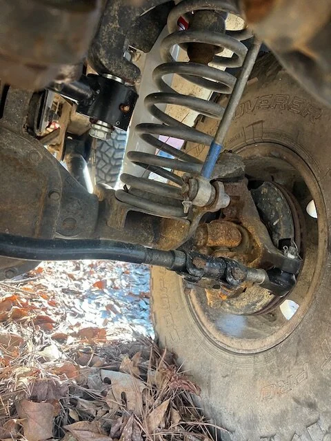

you got a photo or two of that front end/ control arms- pitman arm. Sure somebody with some more experience can ID what you got going along with the simplest way to get A to B. I will say I have been pretty happy with the 33’s and the 6 speed manual

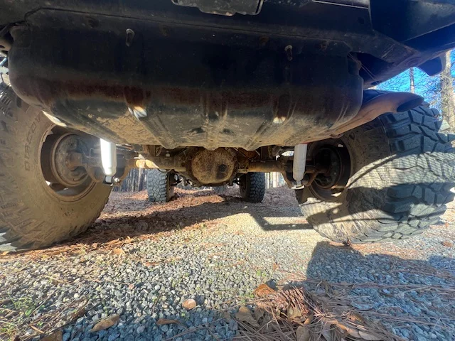

Well it's not the end of the world lol. There's an upgrade for the Dana 35. I'm not a fan personally but people on here like them and it should be okay with 35s. But yeah get a pic of the front axle and of the rear.

More info about and pic of your setup will be needed. It should not drift or dart when driving, something is obviously off.

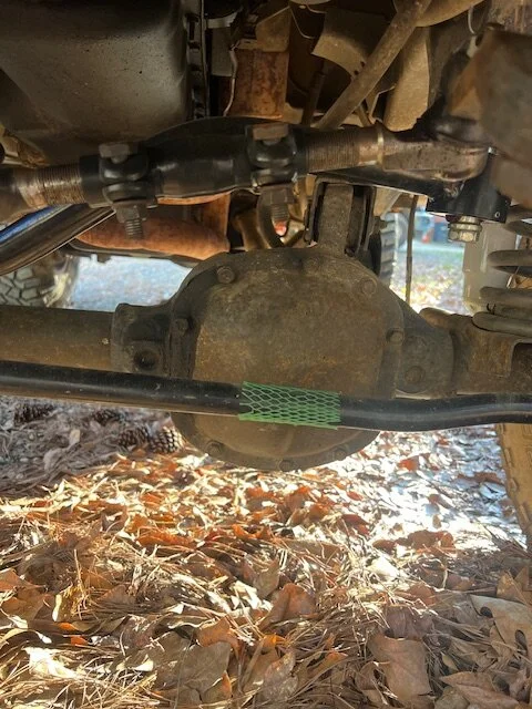

Front end looks to be stock steering with JKS track bar, stock upper arms and some replacement (adjustable?) lower arms. Is that correct? If so, do you know your caster, or have you ever had it aligned?
Yes this is correct. It has been aligned. I do not know the caster.

Since you have adjustable lowers up front with stock uppers, I suspect your caster is off. You can go about this a few ways. 1 - you could throw a set of stock lower arms on and see if that helps, 2 - you can start extending the lowers to add caster, or 3- you can get a set of adjustable uppers and dial it in right.

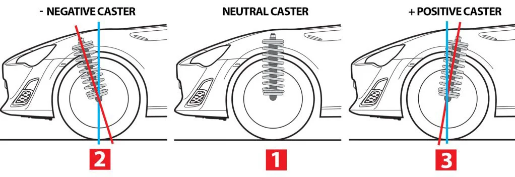

Why wouldn't longer lower CAs result in positive caster. Isn't that the purpose of extended lower CAs?
Diagram 3 above.
