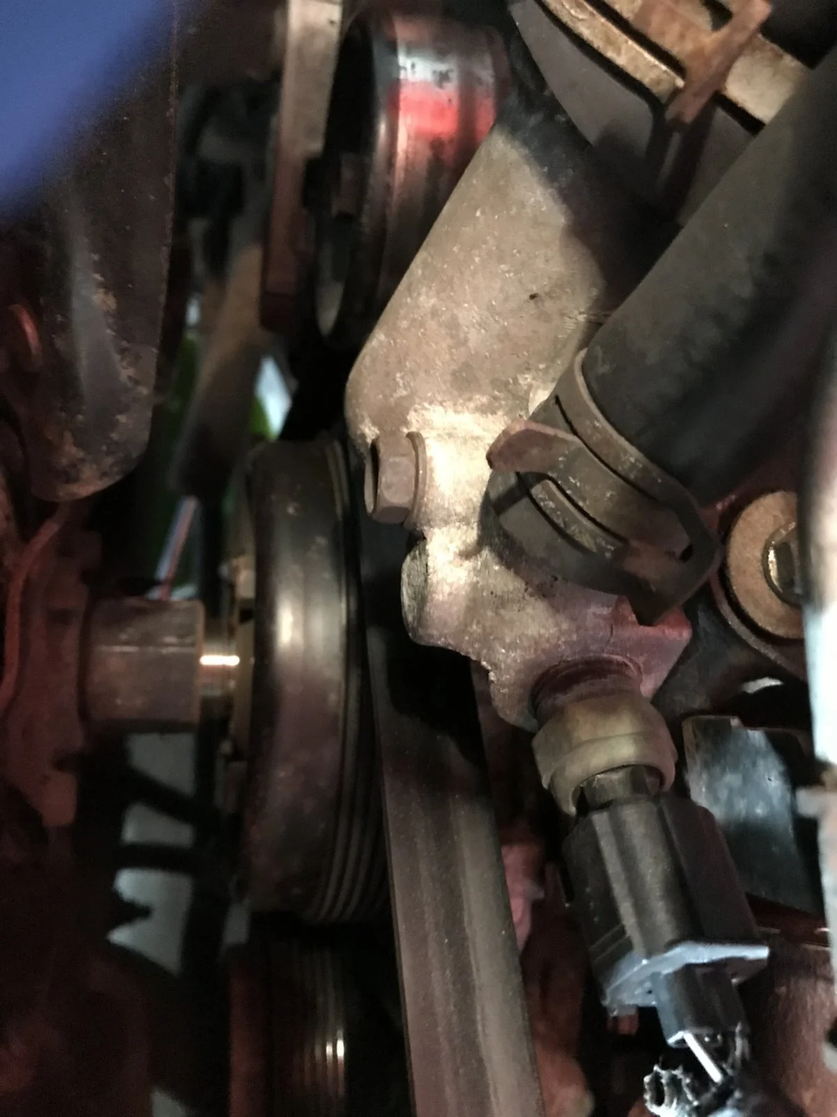

There’s the big bolt I struggled getting loose and the sensor plug I nearly broke trying to disconnect. Dave to the rescue, again .

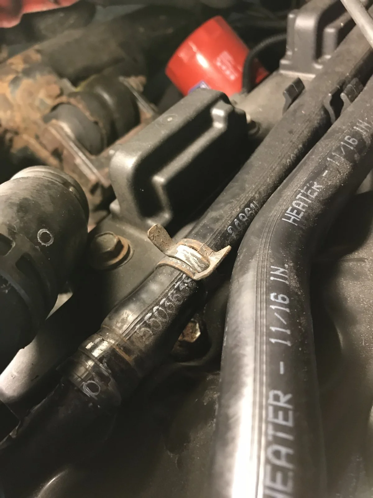

Even getting these rubber tubes off was a feat for me until I watched a video that showed an easy way. I have zero common sense when it comes to this. It really helps me understand families I work with and how they can’t get their lives together and do basic life skills. If they were never taught, or exposed, it’s not easy.

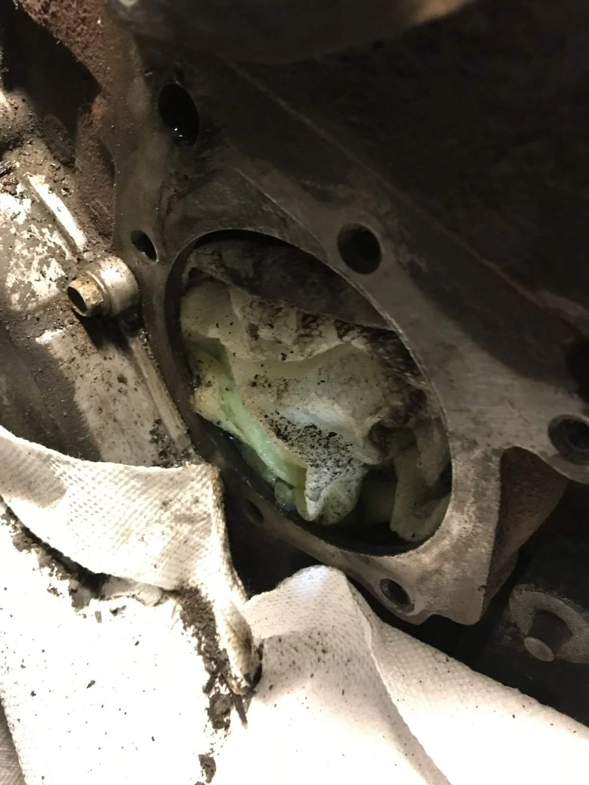

I got it off. Now the cleaning began.

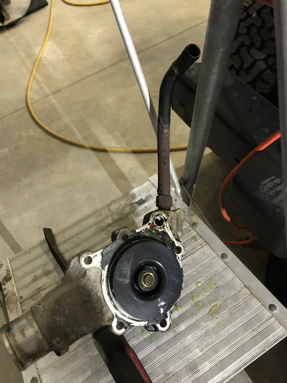

I had to remove that long piece to install on the new pump. That was one of the only things I was successful at doing alone. Using the vise and kroil helped a bunch.
Thanks to dave got both all cleaned up. The pic of the thermostat surface was not completed. Dave did more scrubbing .

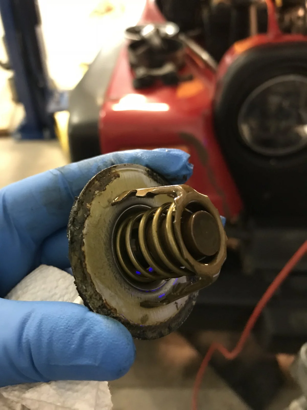

The old thermostat which was still good was also a 195. Now I have a spare.

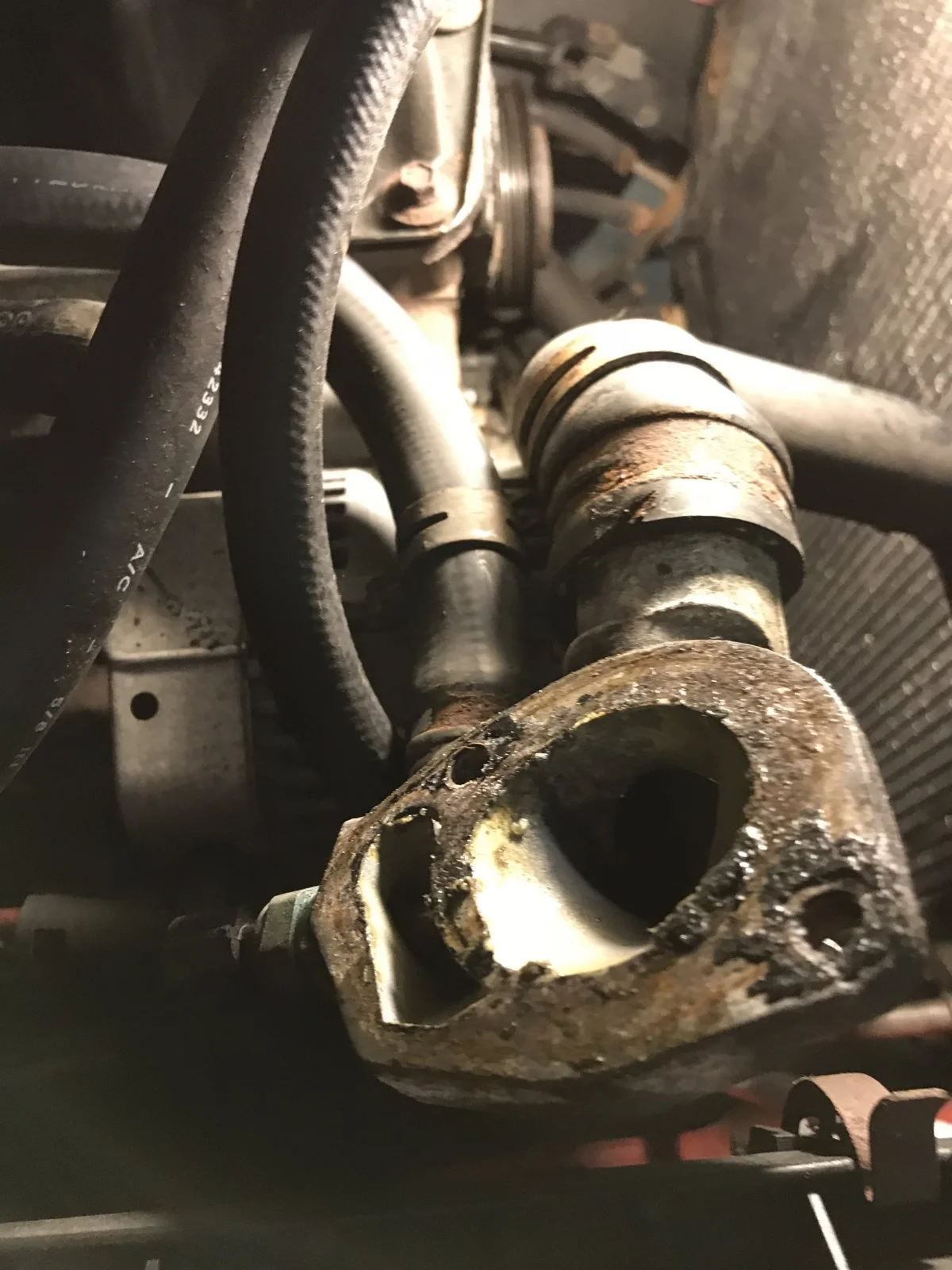

Here’s what the thermostat surface looked like when I started. Yuck. Scraper, razor blade, wire brush, wire wheel. More scrubbing than I’ve done in the shower for the last month!

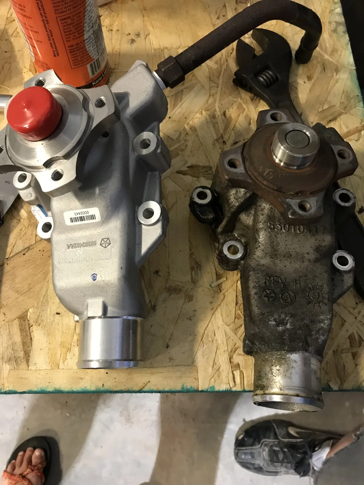

Here’s where I thought I got the wrong pump. Dave reassured it was the same. If anyone begs to differ I would love to know before I ruin my engine.
