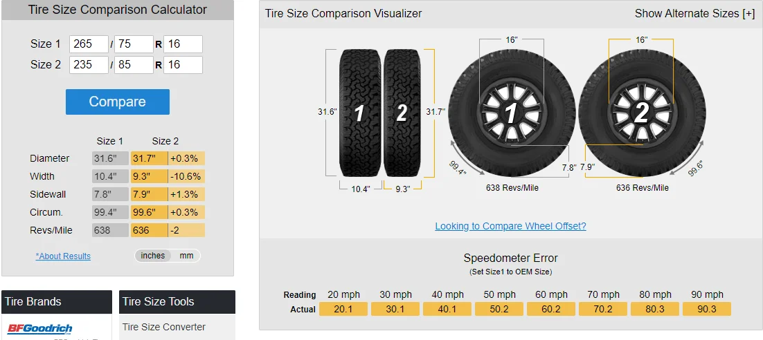

I have 235/85 R16 Duratrac tires, tire size calculator shows them at 31.74" high by 9.25" wide so they round up a hair to 32"
Maybe installing them on stock wheels is more like an extremely mild build but it's all I've done. I've have had no rubbing and it does pretty well climbing hills, crossing creeks, and going through mud sometimes deeper than I think I should be in.
I have 265/75R16s currently and I have already decided to get the 235/85R16s when these wear out even though they are E rated. I like the skinnier footprint better at this size.
