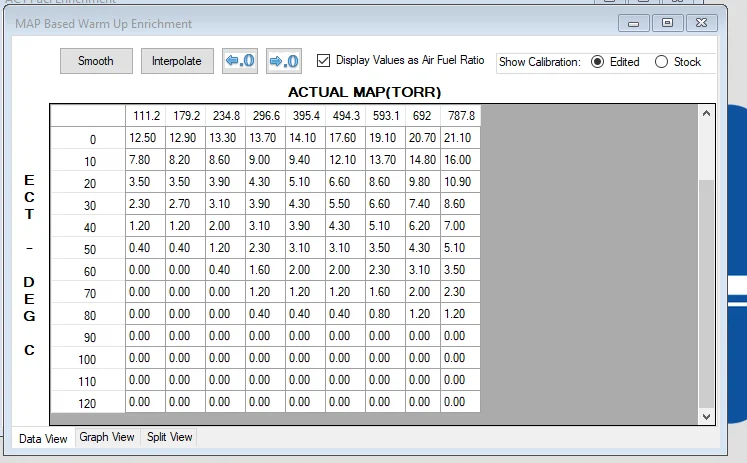

There should not be any extra fuel added with a 180 degree thermostat. I run a 180 degree thermostat and runs 182 to 185 degrees according to the ALDL.
